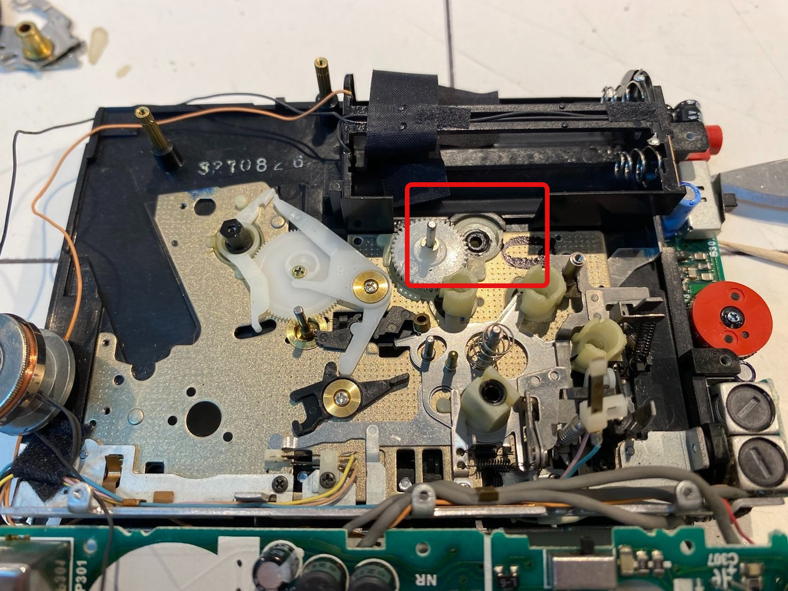

    I've recently made a very good bargain with a WM-D3, and am repairing/replacing its center gear. In the process of doing so, I realized that the gear for the supply reel was broken, hence removed it for replacement.

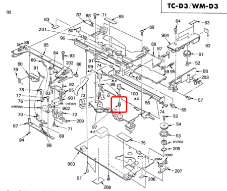

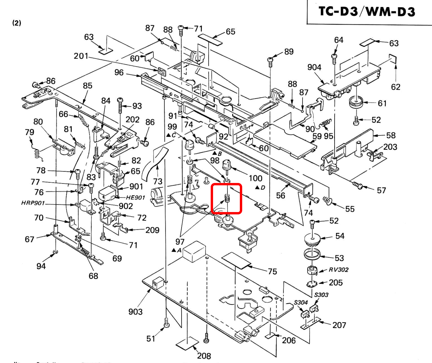

    Unfortunately, while consulting the service manual to re-assemble, I see that there should be a spring going between the reel and the gear:
    This spring is missing, and I'm 95% sure I didn't loose anything while dissambling the reel.
    Is this spring essential? Could it be missing from factory? What would be the impact of re-assembling without such spring? I'm a bit confused …
    Assuming I need to build a new one, I was think of something made out of a guitar string (e.g. gauge 8), any other advice?
    Then, I also have a question regarding lubing:
    I see some old black goo there, and am wondering what kind of grease I should put there.

    I can't remember for sure if I have seen any D3 to have that spring, but I incline to say WM-D3s don't have it installed.
    The spring's purpose would be for backtension.
    But there is another source of resistance in the gear connected to the supply reel and in the WM-D3 there's also resistance from the coutner.
    So that spring is not really needed.
    Won't take the manual as a 100% correct reference as there can be minor changes between the design phase and the production phase.
    For example I remember another forum member pointing out that on the TC-D5M service manual the picture is showing 3 washers on the capstan/flywheel assy, when in reality there are just 2 of them.
    About lubrication, I recommend cleaning the grease and using watch oil instead (any watch oil will do).
    The only points where grease should be used are the following:
    - buttons (where they contact the mechanism and also below)
    - plastic slider;
    - center gear magnetic clutch (where it rubs against the plastic hub);
    - center gear claws (the 3 ones that engage with the plastic slider);
    - on the back of the flywheel thrust adjustment screw;
    - the ball bearings that hold the head carriage (if you remove it to replace pinch roller/adjust alignment);
    On everything else, use oil instead.

    Thanks Valentin! I'm relieved, confirms my feeling that I didn't loose anything as I was pretty careful and almost certain I didn't.
    Regarding the manual, I can indeed see at least another gap - e.g. it says the PCB board should be secured by 5 screws when actually there are only 4 (as confirmed in https://stereo2go.com/forums/threads/reassembling-the-sony-wm-d3.1708/) - so can be confusing for newbies like me.
