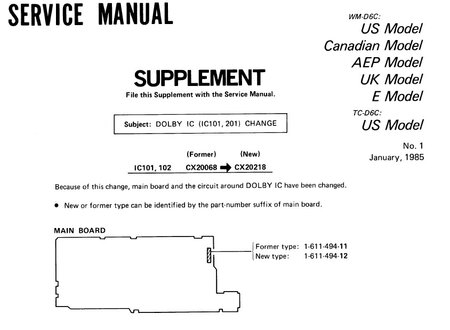

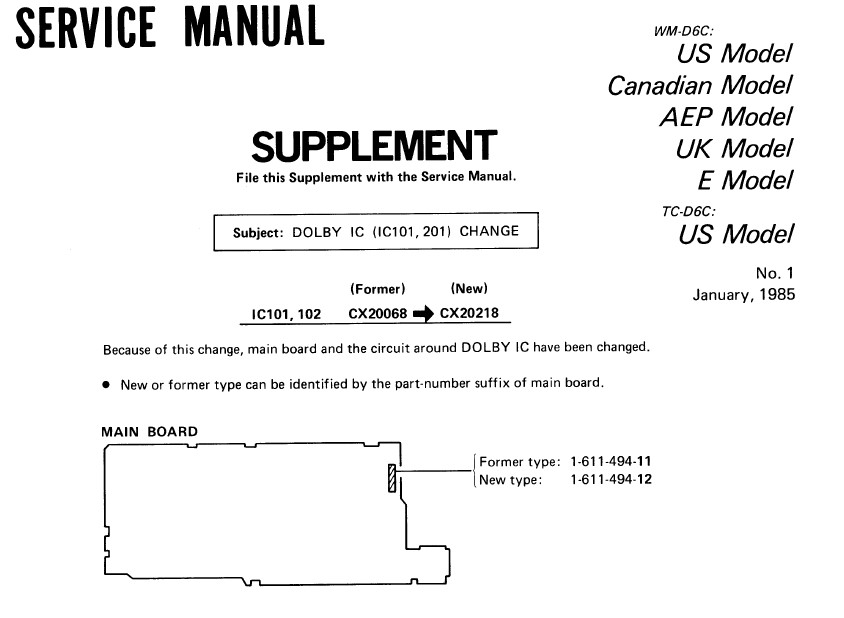

    The later series (as indicated by SONY's service supplement 2 attached) did have an entirely different PCB: double sided, mostly SMD components, muting modules and EQ modules, DC-DC converter are part of the PCB, a lot less wires.
    It is indeed less prone to component failure, especially the potted modules (CP301 and CP302). However, these modules are available as a replacement module, built with discrete components (which won't ever fail again).
    Regarding capacitors, it's not a common problem in this unit.

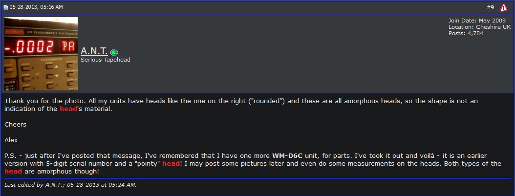

    I also want to make some clarifications on the versions of this device, especially aboout the amorphous/permalloy heads, as there is a lot of confusion created around this topic.
    It seems that most people seem to believe that only the very early versions (pointy head) have amorphous heads, despite SONY kept the markings.
    The truth is quite the opposite from my reasearch on this topic: only the very last models (which only include part of the serial #267201 and above) had permalloy heads.
    This was discussed previously on tapeheads and Alex from A.N.T. drew this conclusion: he's an expert on the field so I really doubt he's wrong in this statement and also doubt SONY could lie so obviously with the markings and get away with it.
    Here is the link to the original thread (the relevant posts also attached as screenshots): https://www.tapeheads.net/showthread.php?t=25815

    The first SONY service supplement (January 1985) indicates a new Dolby IC at some point (CX20218 instead of CX20068). This change likely happened somewehere at point 2: early units are fitted with the former IC, latter witht the new IC.
