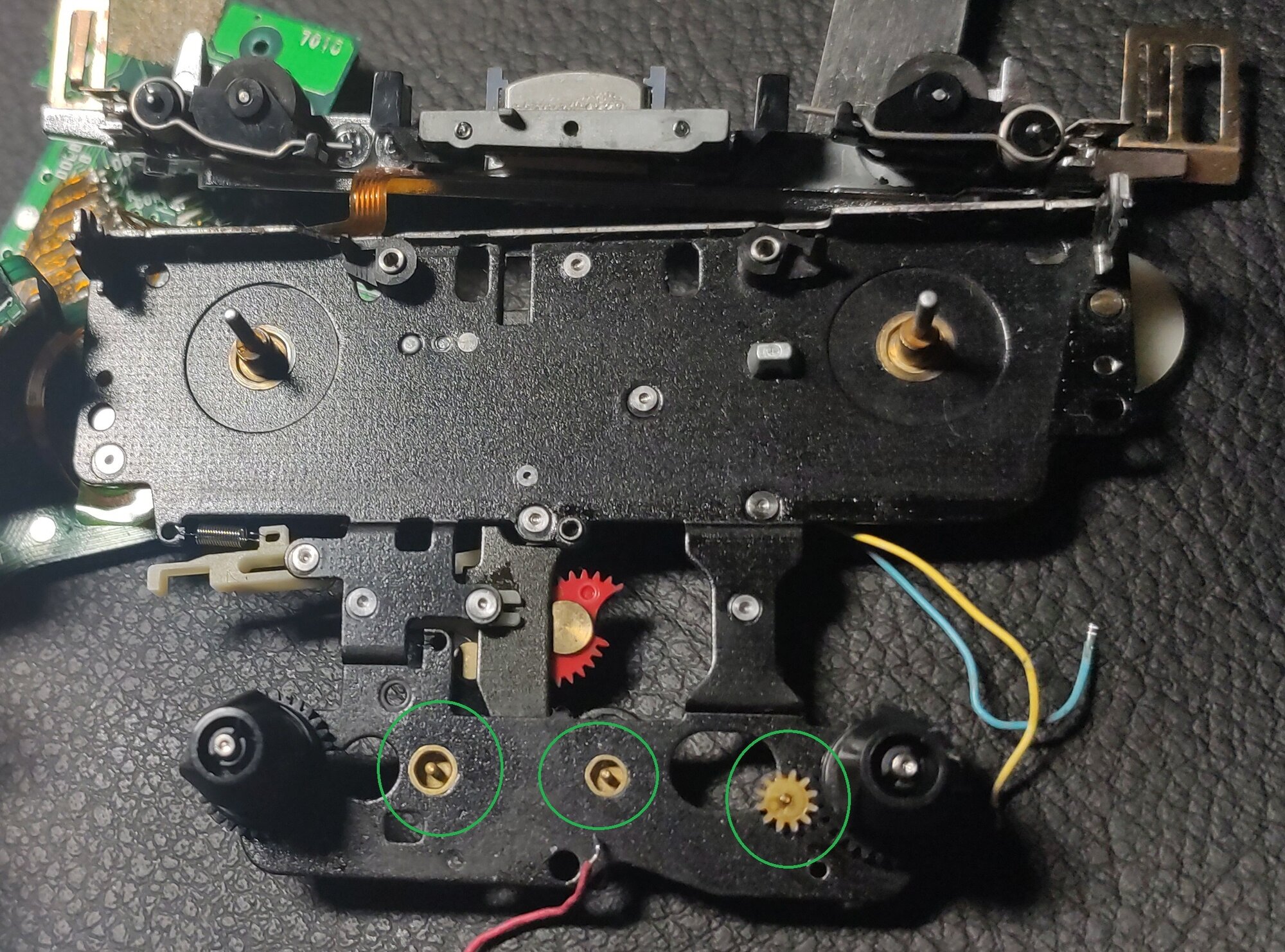

    Apart from the belt and pulleys, would check 2 common problems on these mechanisms:
    1. The main pulley: the grease on the shaft thickens, making it hard to turn.
    2. The 3 gears that drive the table reels (see picture attached): grease on these typically hardens.
    These items I do as maintenance since it's a problem on the majority of walkmans having this type of mechanism.
