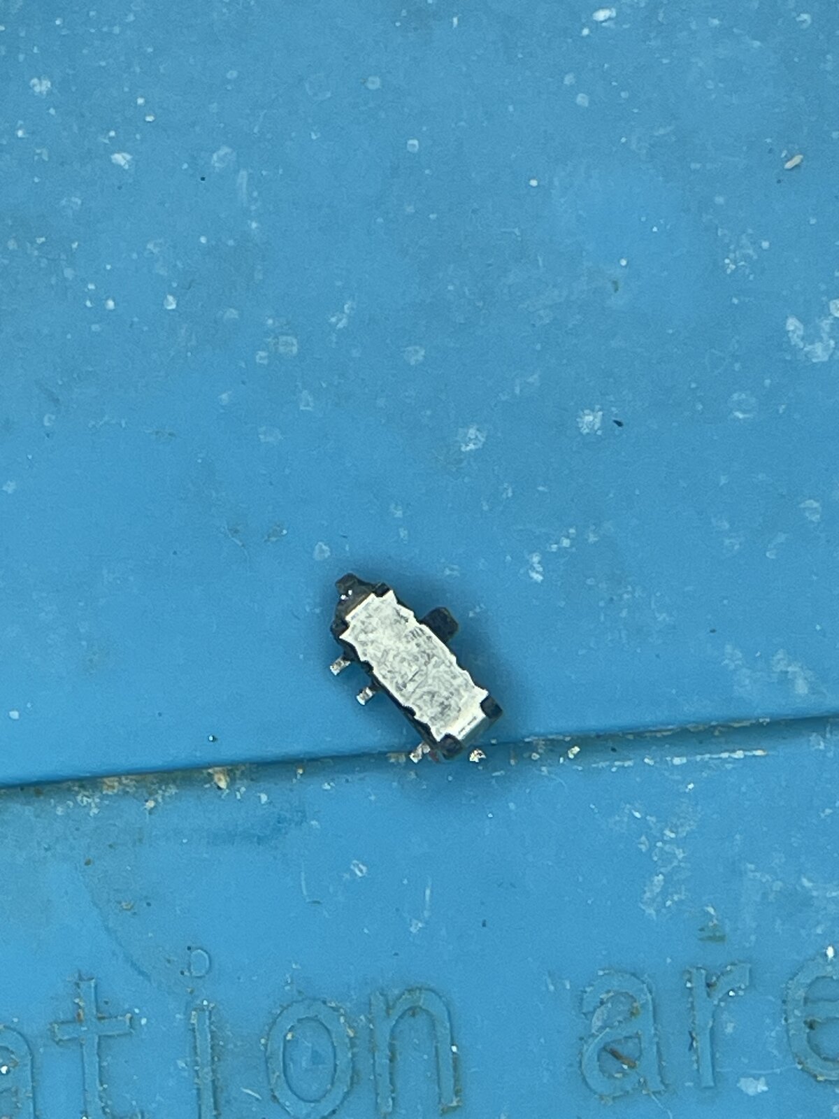

    Hi, I made a bit more progress and found the Dolby switch no longer working. I tried deoxit and finally took it apart to find it was overly corroded and broken. Does anyone know if there are replacements for these? Thanks in advance. IMG_2445.jpeg

    A quick update for anyone interested. I did find these mini slide switches at Digikey and replaced it - works perfectly. It is running very well but I did note audible W&F in one direction so refurbed the motor as per Valentin (Which certainly won't hurt either way). The issue remained but I noticed that it went away when out of the case. There is one gear in there that is very close to one SMT and 2 Horizontal electrolytics. I had replaced these previously but used PTH ones lying down for the Horizontal caps (which are difficult to find). They looked about the same thickness but that gear is so close the even 1/10 of a mm seems to matter. I did find a solution but had to put back one of the used 3.3uf horizontals. The other one I could move out of the way enough. Maybe there are some slightly skinnier PTH ones I could find, but overall pretty happy with it now.

    Please post the part number of that switch you bought from DigiKey for reference.
    About the horizontal caps, I replace those with small 4 x 7mm THT ones instead on which I bend the legs. Those are much easier to find and work just fine.

    The switch I purchased was:
    PART: EG5720CT-ND
    MFG : E-SWITCH (VA) / EG1215AA
    DESC: SWITCHES 1.42000 2.84
    FYI, the metal/normal switch is more complicated (6pin, they call it 10 pin with the gnds), harder to find and I don't think available on Digi-key but it could be found on AliExpress. I didn't buy one but thought I would share. Same with the 3 position megabase switch.
    Valentin, I did the same thing initially lying down the THT parts but I guess they were not perfectly flat or something. I did redo them all and it is fine now. It did take a but of luck to find this issue as there was no real grinding noise or anything. I was worried one of the capstans was slightly bent as the the tape on these units needs to be nicely seated or the capstans take some abuse closing the door. Anyways, all good. I have a fully restored f2091 now - Belt, caps, clean, lube, gear, motor lube, etc. Moving on to D6 now.
