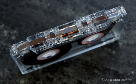

    As I pointed out in the last post, I'm not impressed at all, but annoyed of the scratches and lack of a proper case. But let's look at the very tape.
    Well, at first sight it doesn't look like the extraordinary tape it's supposed to be, because I can see some rails on it...

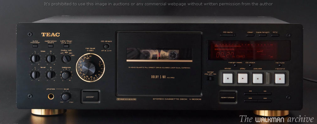

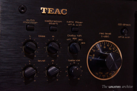

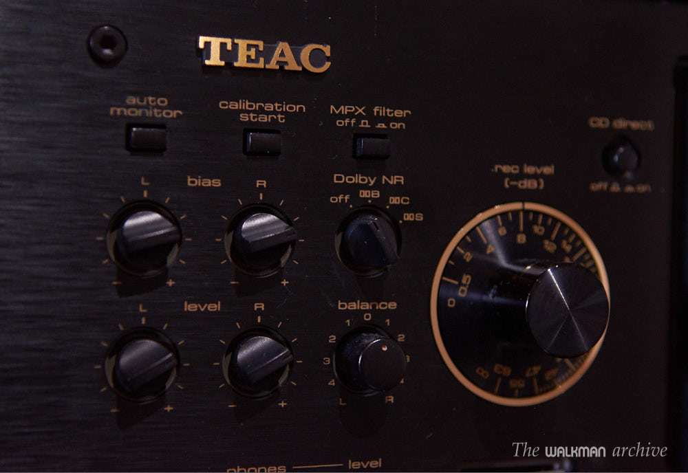

    Yes, here they are. Rails. And the tape doesn't look very plain. There's something that it doesn't look good there. Let's look at the performance. I've choose my trusty (and profesionally-calibrated) TEAC V-8030S for the testing:

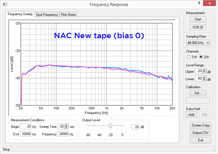

    So I started DSSF3 and measured a sweep at -20dB with both bias knobs at 0, so we can see how well -or bad- does it perform in a standard deck with no calibration facilities at all (the most common by far, BTW):
    As you can see, the response is not flat at all. There's a loss of about 4dB between the low and midrange and the highs. Worst of all is that this loss starts well early between 1-2 kHz so ALL the treble and even some mids are affected.
    This means that even considering that most of all, tape fans, are well above the age of 40 and can't hear above 15kHz, will hear the lack of treble in the Ferromaster when recorded in a standard deck or a D6C. Not like other good old tapes, where the effect is usually present above 10 kHz so the effect is much lower. But it's not the case.
    If I adjust the bias at -40% like this:

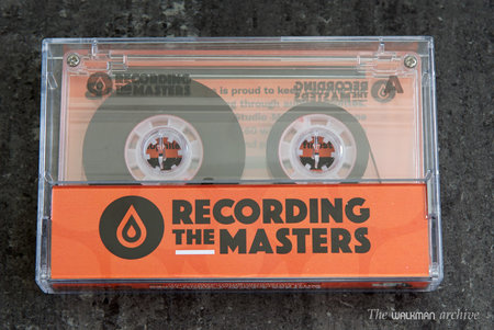

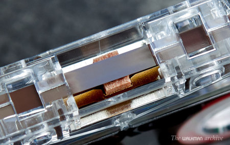

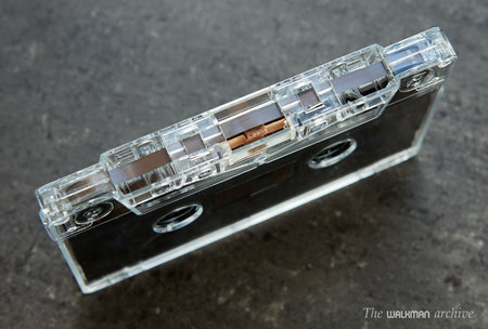

    Let's look at the very magnetic tape:
    It looks fine. Let's look closer:
    It looks way more polished than the Ferromaster, definitely.

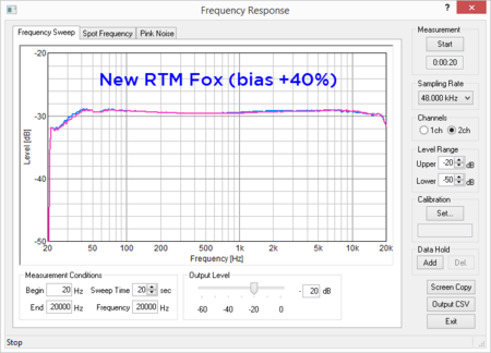

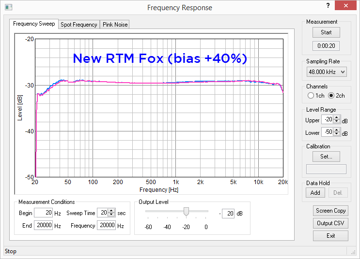

    The testing deck is the same: my TEAC V-8030S. After measuring with DSSF3, I found the optimal bias setting at about +40%.
    Yes, it's 40% again, but this time is positive, not negative as with the C456.
    The frequency response of the new Fox is close to perfection in my TEAC 8030S.
    Not only the response curve is very flat, but it needed more bias than the prerelease, what makes me think that they have improved the formula so the tape needs a more powerful deck to record it, like in good tapes. it also makes it more resistant to residual magnetic fields that can erase it.
    Regarding the background noise, it seems more or less the same than the C456 but there are no strange noises, even with Dolby C/S. So the uniformity is way better.
