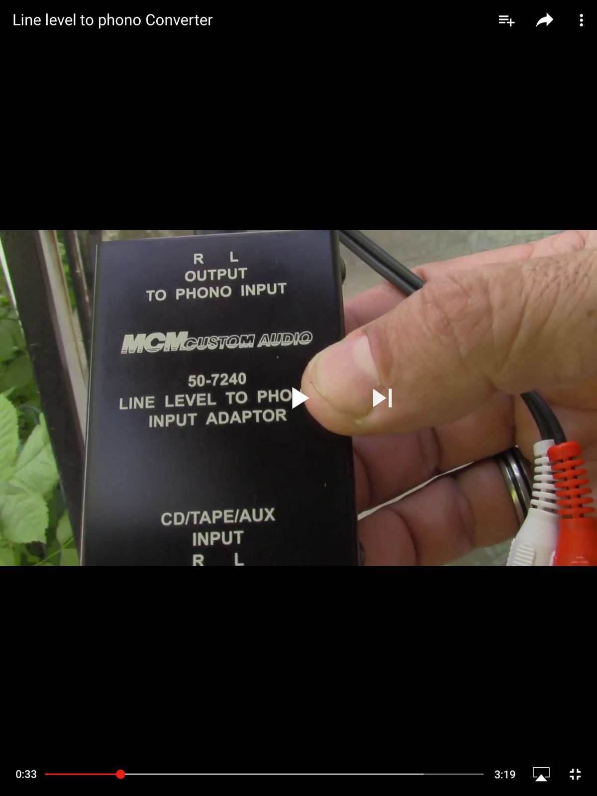

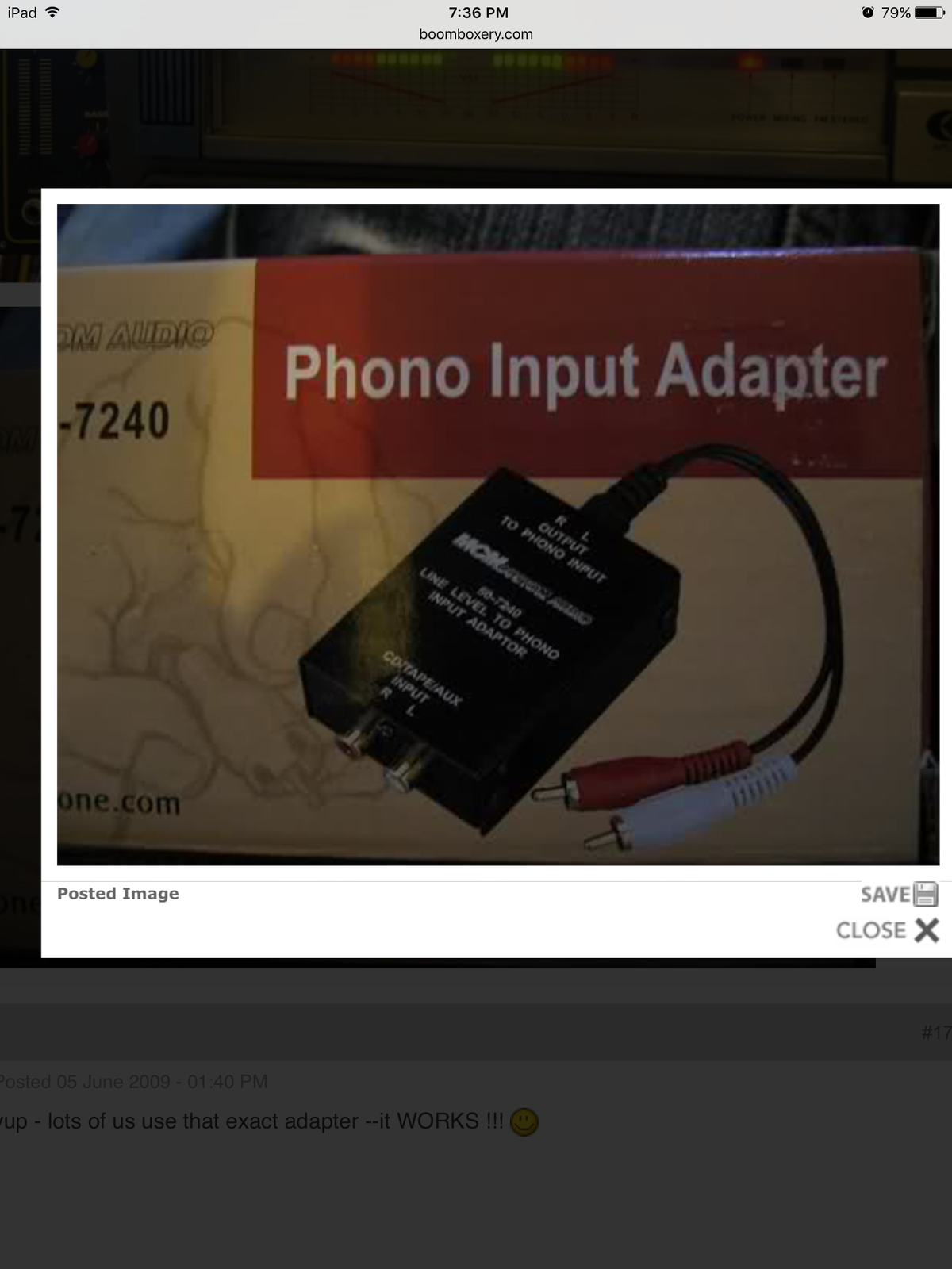

    This device reduces the phono inputs which are very strong & creates that disturbing distortions our boomboxes hate. I have a boombox that has phono input only so using this device I can plug my IPhone & sounds nice and clear just like Aux. One end plugs in the phono & the other to the IPhone & Whalla.

    Hi Longman, I think the device u showed us is for turntable to run them through auxiliary. Is to increase the signals on auxiliary. I can be wrong.

    Its an adapter to phono not a phono preamp.
    This is the reverse of the "phono preamp"
    so no battery or power is required.

    Yes Transwave that is correct.

    I have been using these ready made attenuators for years but have found that sometimes the attenuated level is too low and that i have to crank the boombox it's connected to way too high to get a reasonable listening level. Would anyone know how to make this either a little bit less attenuated or variable? I did find someone selling home-made variable attenuators on Ebay a couple of years ago and i bought one but while it gave the levels i needed, it sounded awful! I think the components that were used were sub-standard.
    I would of thought that an enterprising clever person on here might be able to make a variable attenuator that does not colour the sound and sell one to each of us!

    I bought a variable homemade looking one and it was terrible. I bought several of the MCM ones when they seemed to be running out...I use these and find them good :)

    Thanks for the explaining what the box does. If I had looked more carefully "Line Level to Phono Input Adapter" is written on the picture on the box.
