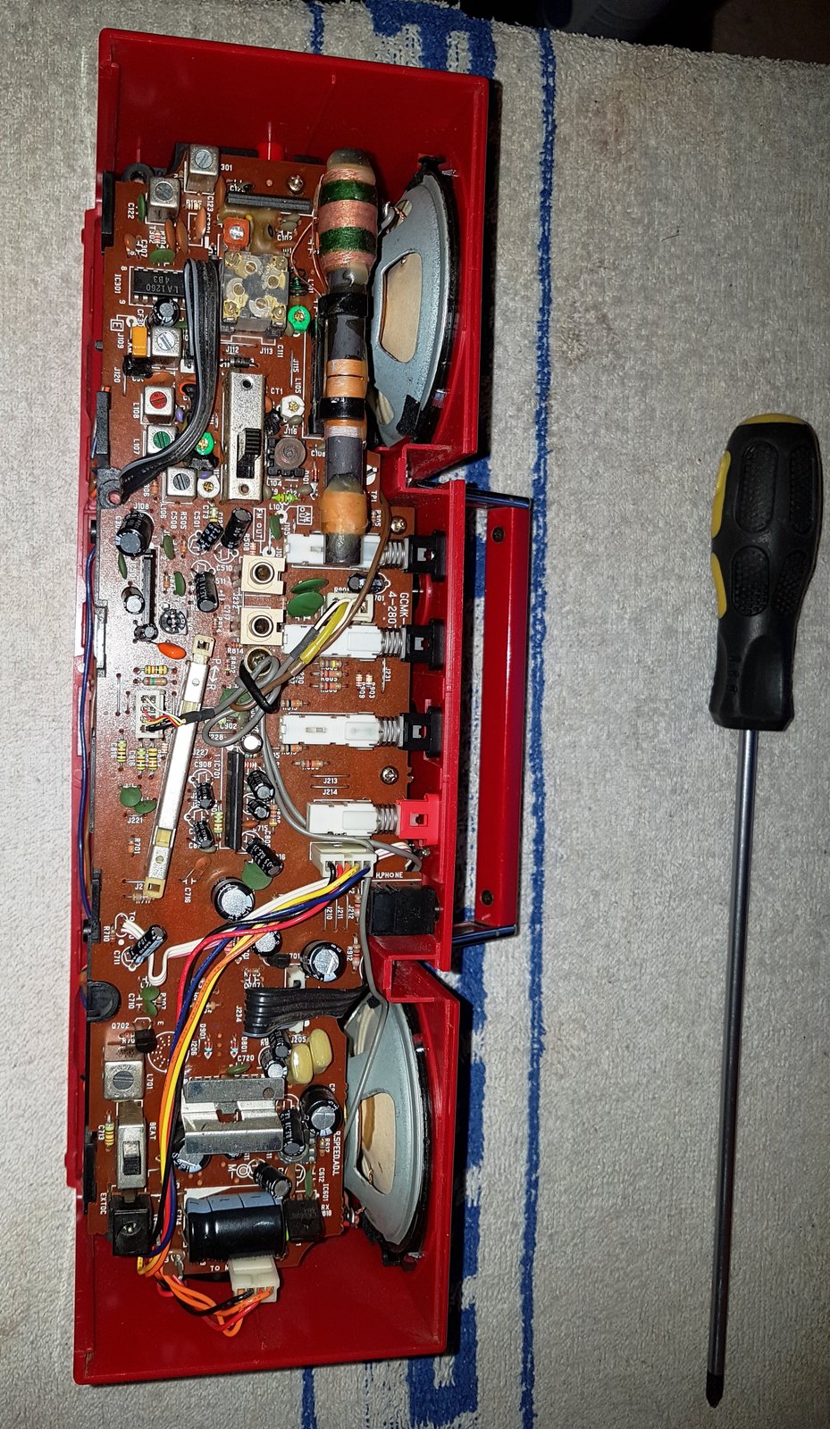

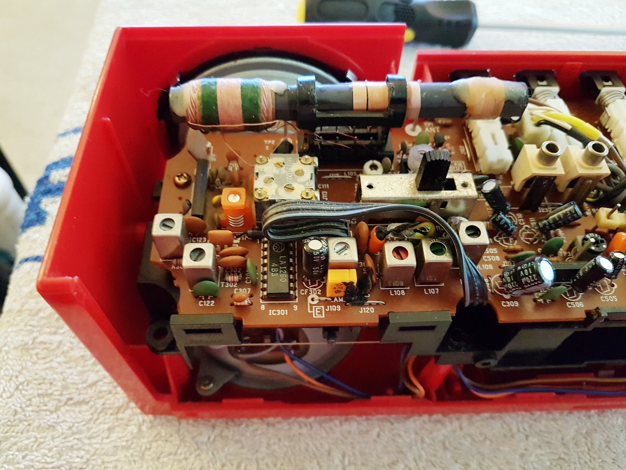

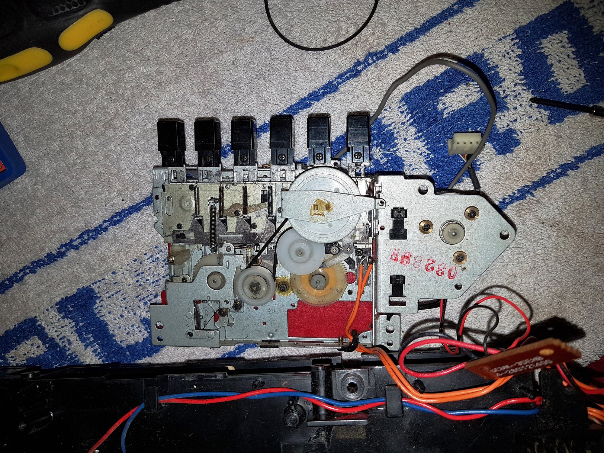

    Today saw me rebelting this tiny little Sanyo M-S400L which I have had a while awaiting a proper service/repair!!
    Very dirty controls all round & a very worn out capstan belt.........
    These machines are tiny so no surprise that the tape deck is really compact & I am always wary of taking these out & apart [​IMG] & this was no exception!!

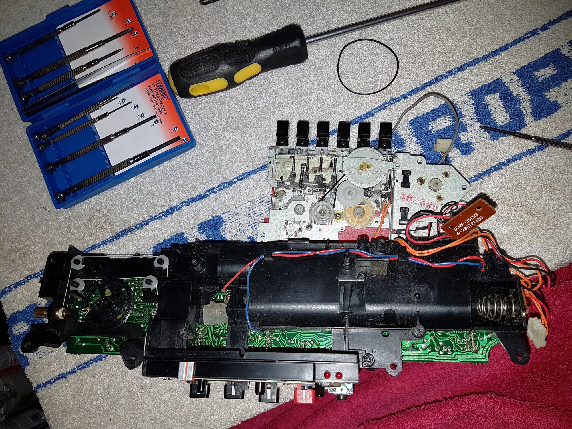

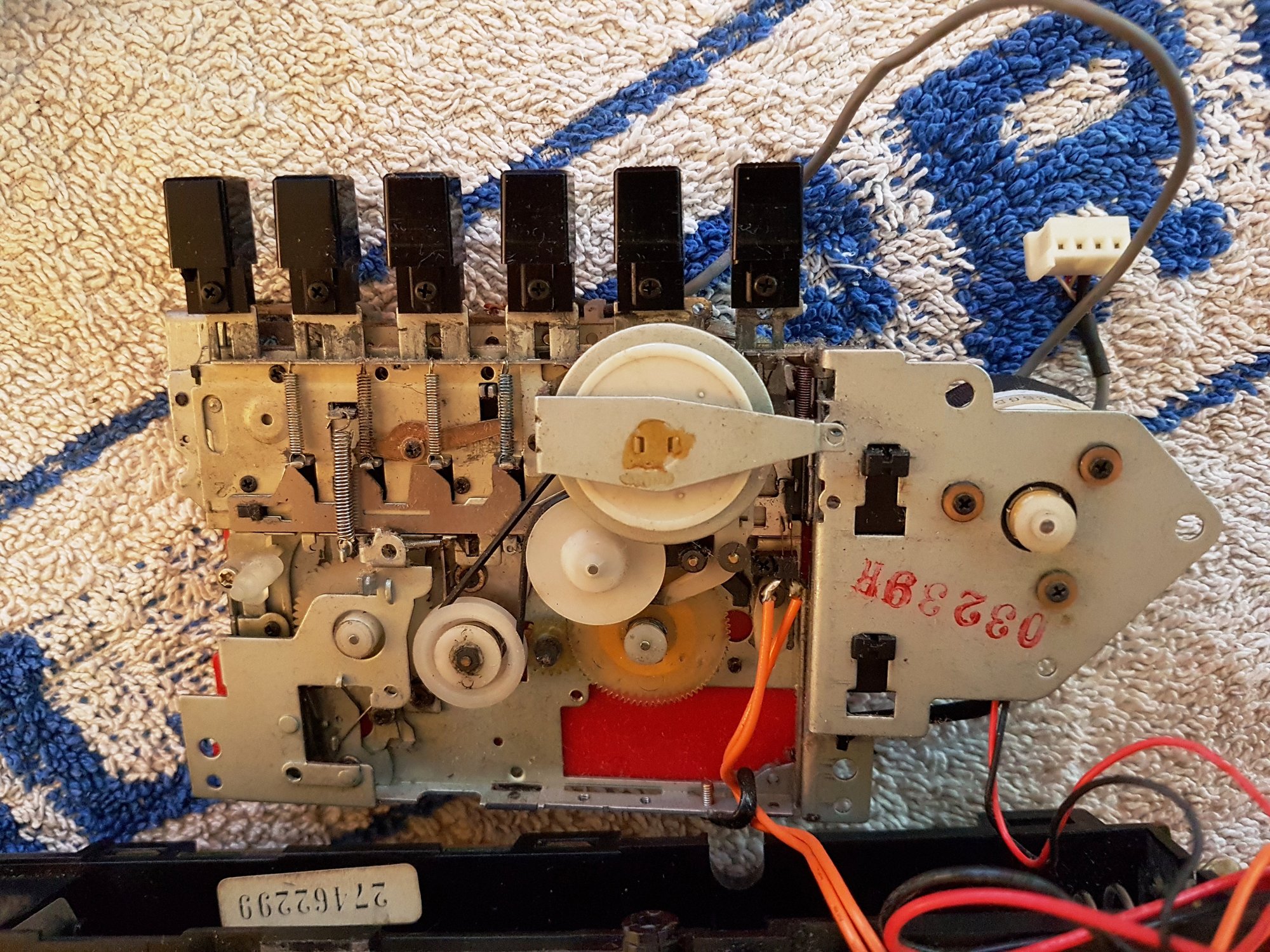

    In proper 'Old Skool' Sanyo style, the whole thing is pluggable so really easy in fact to extract the whole mechanism [​IMG]
    One wonders how can this thing play cassettes so well with no quavering or wobbling - The flywheel is so tiny & the belt has to be just right, something I learnt in the early years of cassette deck servicing!! A quick search in the 'Belt Bucket' produced the two tiny sqaure belts which were carefully replaced & the capstan shaft oiled as well as the roller & heads being cleaned until like new!

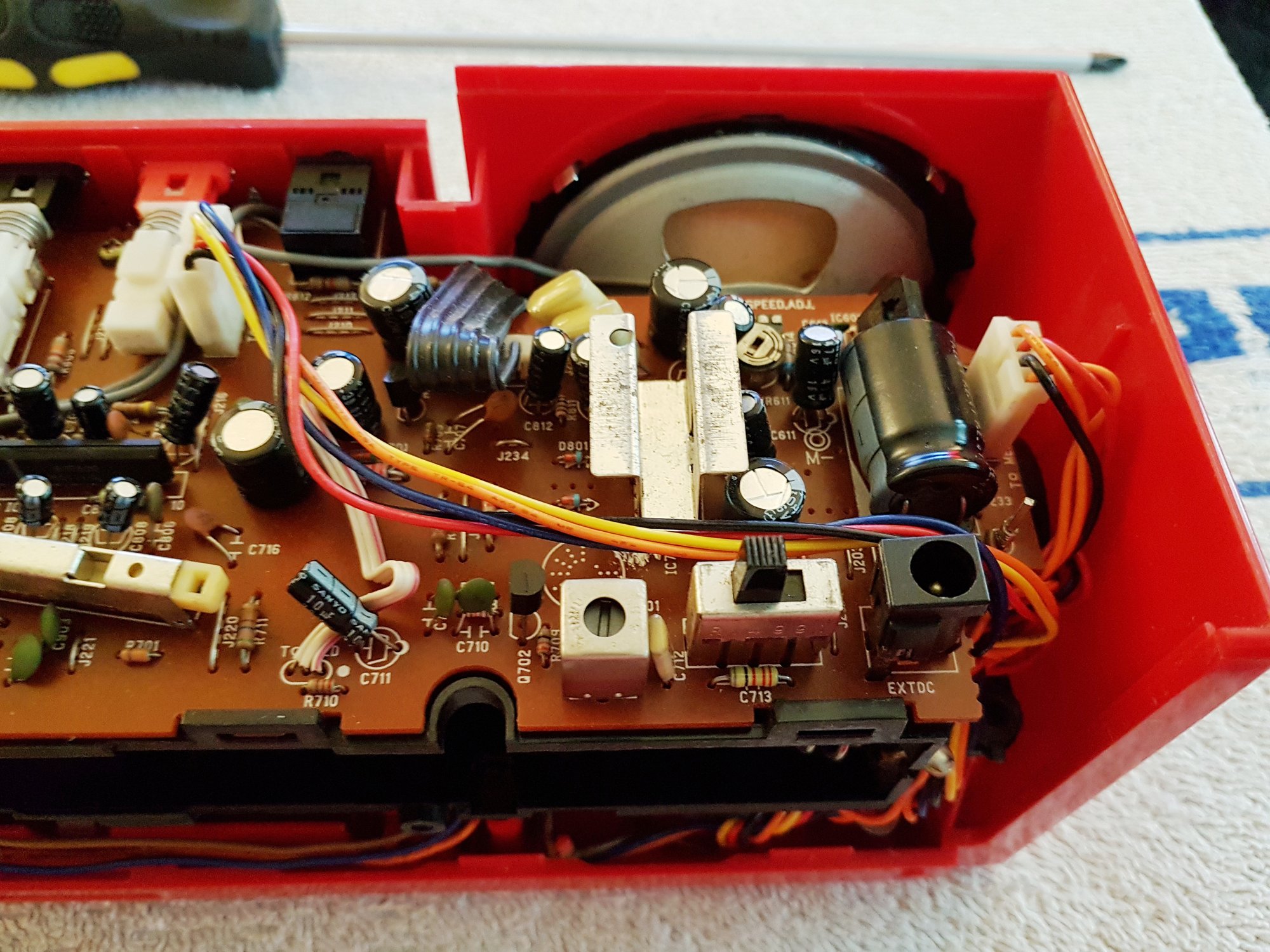

    Now before I started today, this really struggled to do anything including listening to the radio as the controls were so gunked up - The balance & tone controls simply didn't function & volume pot was so noisy it was a wreck!! [​IMG]

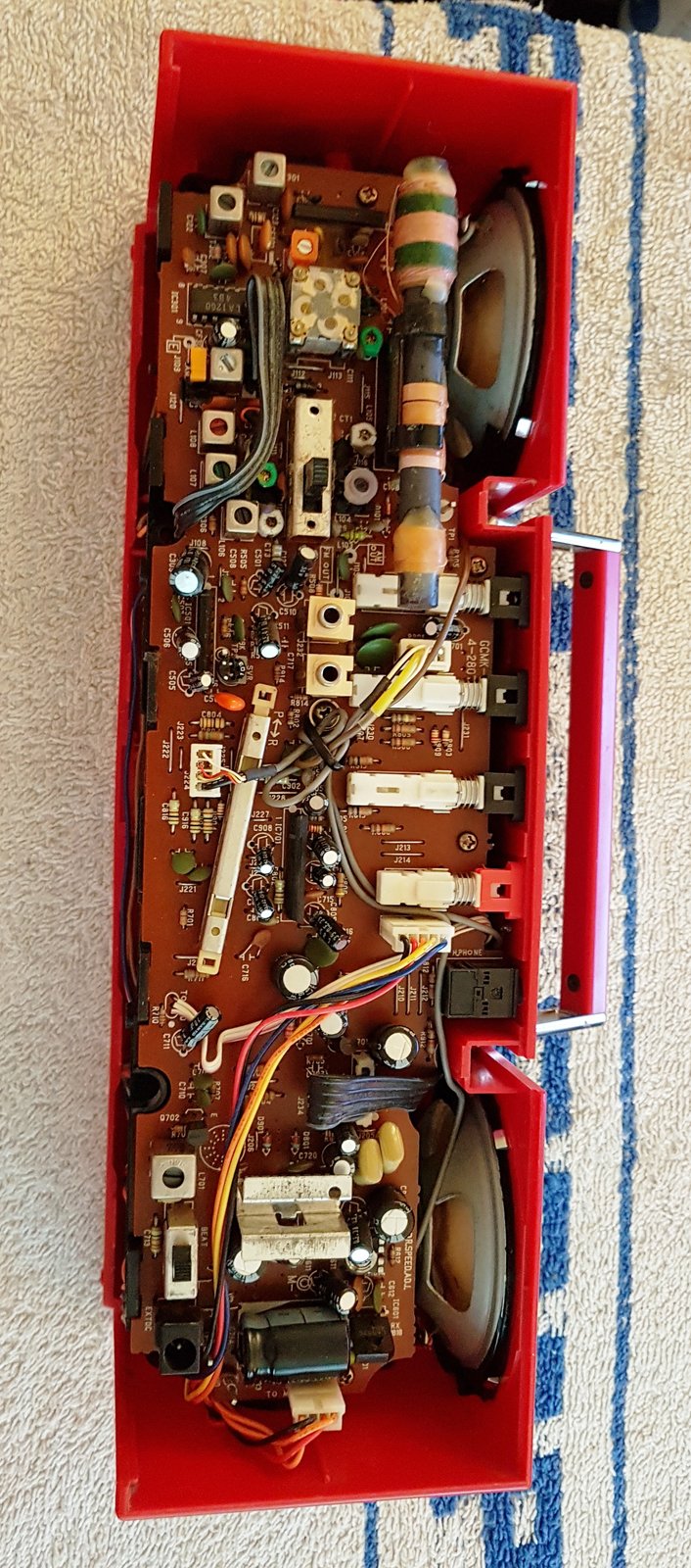

    After a really good switch clean it was time to put her back together & test everything......
    Et Viola!!
    Everything worked 1'st time, I had thoughts that other problems may arise after it had been so neglected in it's life, but no such worries - It sounds amazing on tape & radio, as I say, these things are really really tiny & with such a tiny flywheel you would not think they would produce a stable & powerful sound..........
    Happy Days
