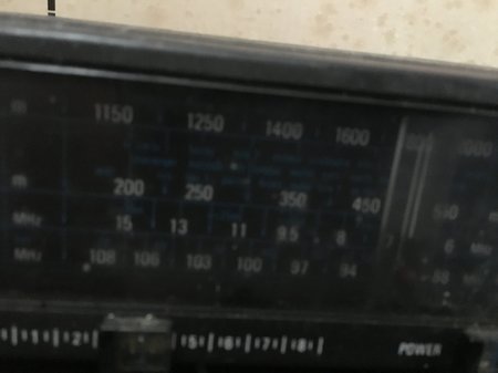

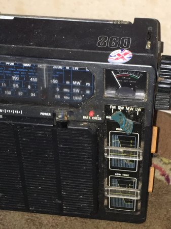

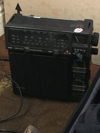

    Just found my grandmother's old Philips 860. I think she and my grandad owned it from new as my mum remembers if from when she was growing up. According to radio museum.org it was produced in 1977/1978. I know my gran was very fond of it but it stopped working a few years ago. Unfortunately, she passed away earlier this year so I would like to restore it so I have something to remember her by, I'm sure my mum would appreciate it too.
    I've turned it on using the mains lead and it sounds fine but it's stuck on a single station because the tuning knob isn't working properly. I suspect there's a string inside that's come loose or frayed, haven't opened it up yet. Also, there's a LOT of rust in the battery compartment, not really sure how to clean it.
    Oh, and it needs a damn good clean.
    Any advice would be greatly appreciated.

    Taken it home and given it a bit of a clean.

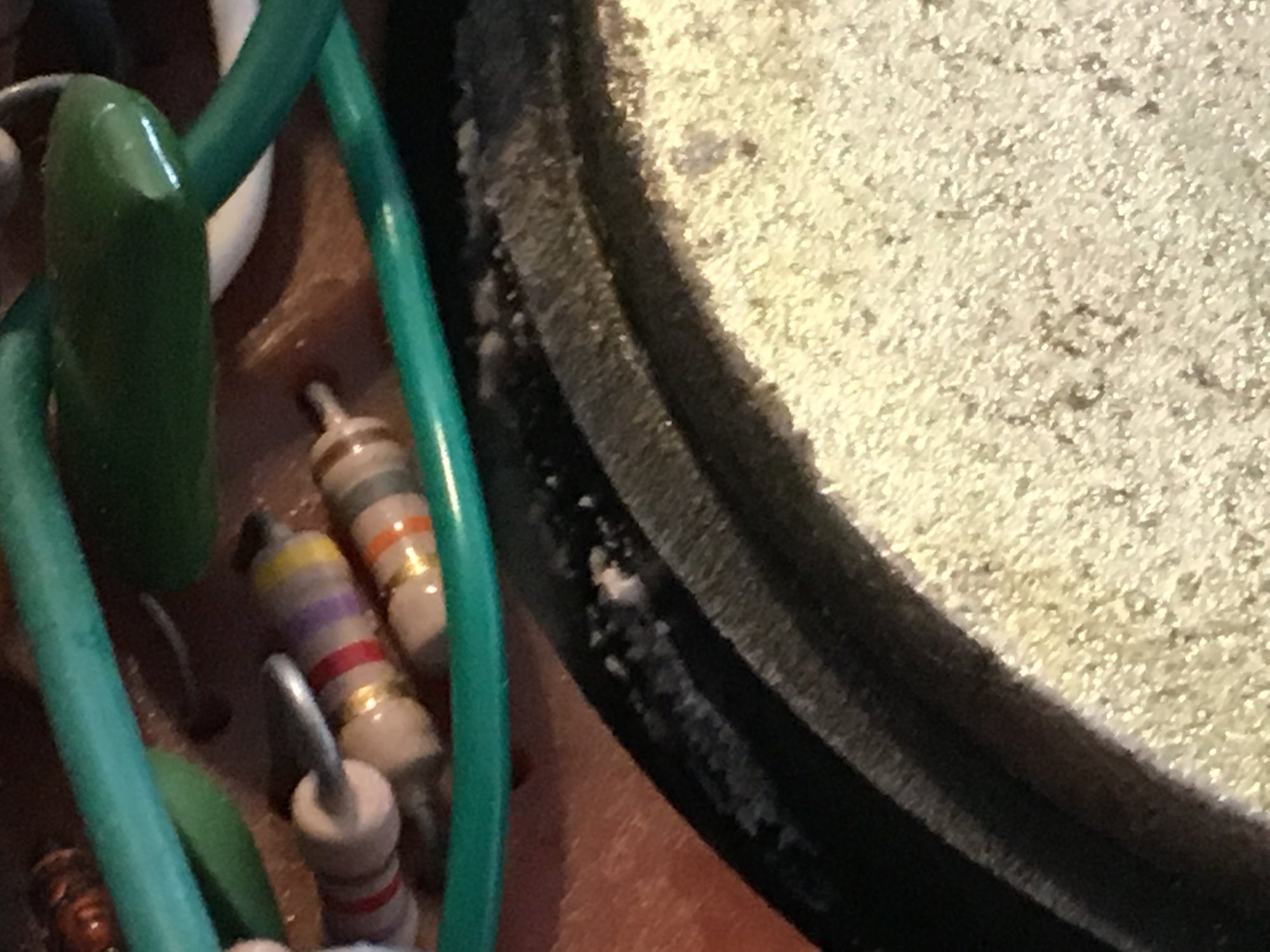

    I opened it up to look at the tuning mechanism but it's behind the circuit board which I'm struggling to remove (can't find a service manual anywhere). Not going to risk breaking it.
    There's a lot of white stuff around the speaker, not sure what that is.
    The battery compartment is very rusty on one side and corroded on the other.

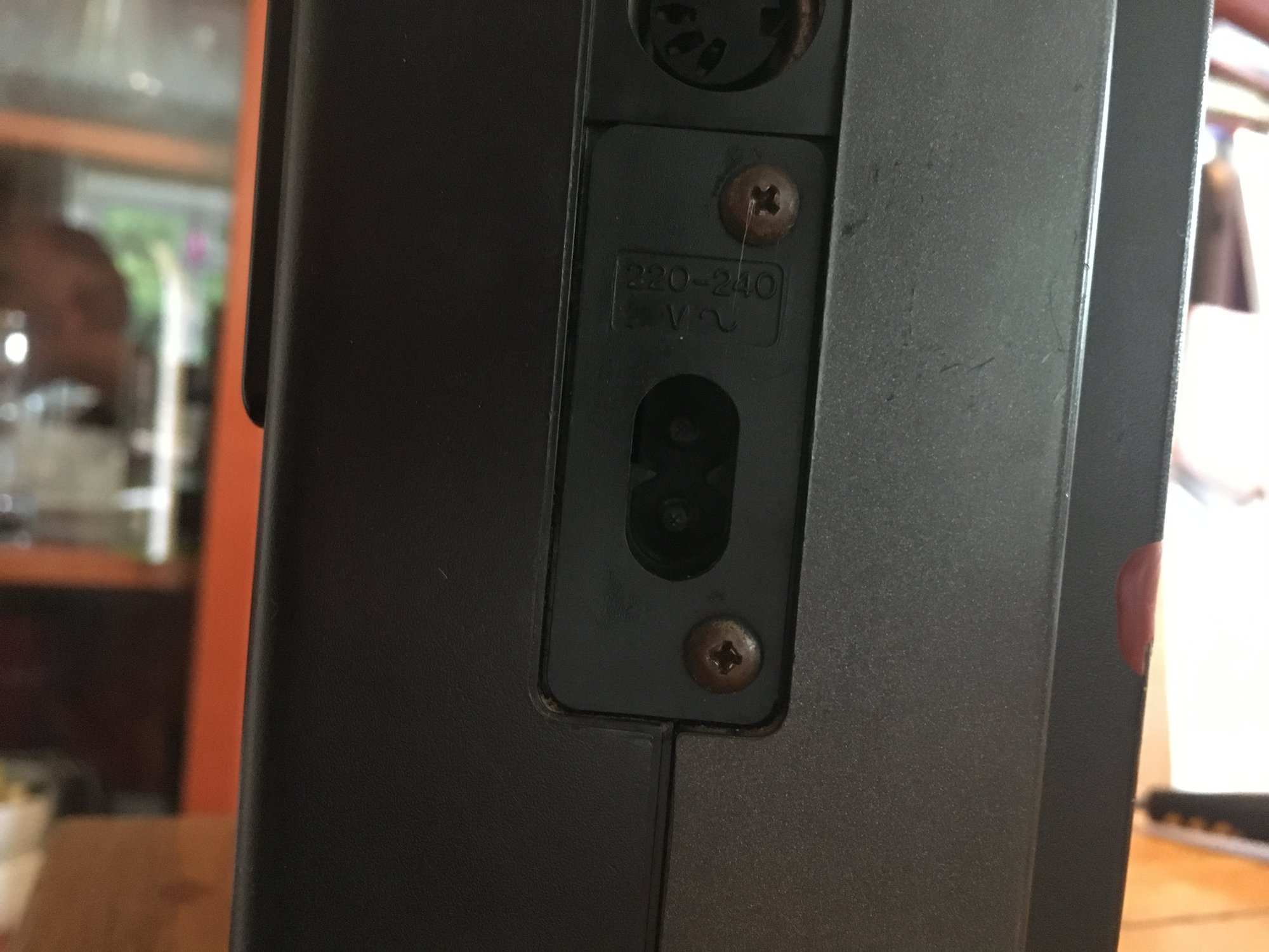

    There's also a bit of plastic that covers one of the mains lead prongs meaning you can use a 240V power supply or a 120V. I suspect this is because it was also sold in the US and Philips wanted a single model for both markets.
    Anyway, I hope to find a service manual soon, so I can fix it. If not

    It sounds as if the dial cord has broken. On the back of the square white Variable Capacitor next to the Ferrite rod there will be a big pulley.
    There should be cord around that, probably with a spring to tension it, which goes around other smaller pulleys and the shaft attached to the tuning knob.
    This is all shown on page 12 of the service manual.
