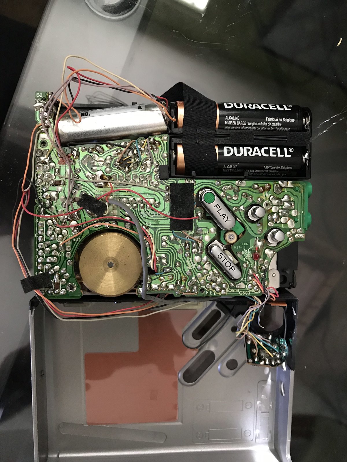

    So I just ordered a Sony WM-2 off of eBay, and it just came in today. I knew I needed to replace the belt, which I did. To do so I lifted the circuit board to access the drive system. After changing the belt, I tested the power to make sure everything was still working and then put the board back in place. But after doing that, the power doesn't work anymore. I checked all of my wires and contacts and all are connected and making contact properly. I don't know what to do. This also happened to an old WM-DDII I had a few years ago. I'm getting really frustrated with this issue. Any advice?

    can you post a good photo of your open unit here ?

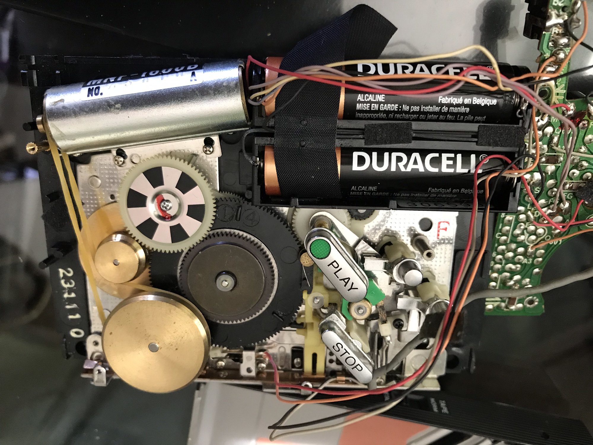

  9. autoreverser
    1,758
    when you lift of the mainboard again, somewhere there must be a tiny little switch (like feathers) wich starts the motor - make sure it's in the right position !
    i don't have any open wm-2 here, otherwise i could show you...
  10. autoreverser
    1,758
    ...whenyou check your first pic: that switch i mean is visible in that gap on the right side just between the play and stop- button - make sure it can move easily, once you press any button besides stop, it must give contact. you easily bend this thingy when reassembling your unit...
