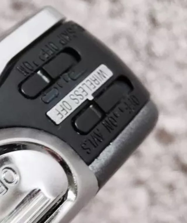

    I just bought a WM-WX1 from EBay at a auction, thing is... it comes with no remote control.
    My question is that this unit has EX EBB and I think this function is only available by using the remote.
    Anyone can help me out? Or anyone has a remote to sell?
    Thanks.

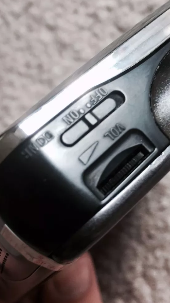

    Hello, I understand that. This model has a standard 3.5 mm plug and operation buttons. All functions are featured on its body, only the EX DBB isn't.

  6. Silverera
    Silverera Active Member
    368
    MEL
    Hi Costa,
    These WX1's are in my opinion the best wireless Walkman ever made but were Japanese market only released in September 1995. Documentation assumes you have the remote and the EX DBB instructions/description refers only to the remote. I assume that when standard headphones are used the unit defaults to Normal rather than Mid or Max DBB modes. No mention of it in the English part of the documentation which is at best very limited the bulk of it is in Japanese. I have both the charcoal and silver WX1's in my collection both with working remotes. Have never seen the remote for sale separately but regret to advise you that the remotes are paired. The silver remote doesn't work with the charcoal player and vice versa. I must admit that surprised me and I tried playing around with the channel selector on both but it didn't make any difference. They only work with the unit they are paired with. Now these a radio frequency devices so Sony must have used a limited range of frequencies for the remotes. It must be possible to find a remote with the correct RFQ for your player, The trick is finding out what the FM frequency is for left and right channel on your player and getting a remote that matches. There is a small label in Japanese on the rear of both my MDR-EW1W remote units. I can try to get a friend to translate it but it may not give any information on the frequency the unit is set to. Sorry to be the bearer of bad news.

    My doubt is:
    Is the EX DBB only being done in the Remote? I mean, the audio comes from the player with Flat sound and then the remote applies the DBB itself (DBB Effect only comes from the Remote and not from the unit itself?)
    If we activate the DBB and connect headphones directly to the unit can it be used too? Do we notice the audio enhancements directly from the player alone? Or only through the remote?

  15. Silverera
    368
    MEL
    Well having dismantled the remote I can see there are 2 PCB's in there and it looks like one of those has an audio function. The other remote only receives the sound from the Walkman and you can't change any settings on the Walkman with it or start ,stop, play functions. Plugging headphones into the audio jack disconnected the remotes and the player reverts back to no DBB on. Sorry but it looks like the DBB circuit is not on the Walkman PCB but in the wireless receiver. It's a function of the receiver and not the player. The WM-EX1 must have a different PCB to the WM-WX1.

    Its a thing that wont affect me so much, i use the walkman on my car radio Line In input so the more flat is the better to tune it in the radio equalizer.
    But, can you provide some good photos of the switches on the remote? Some details?
