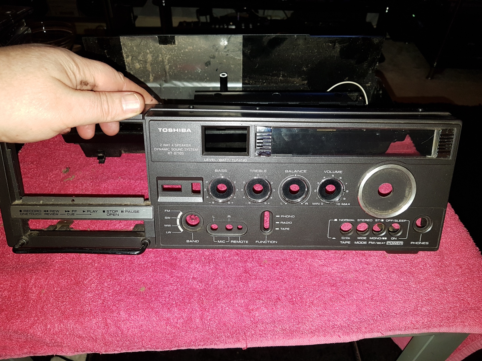

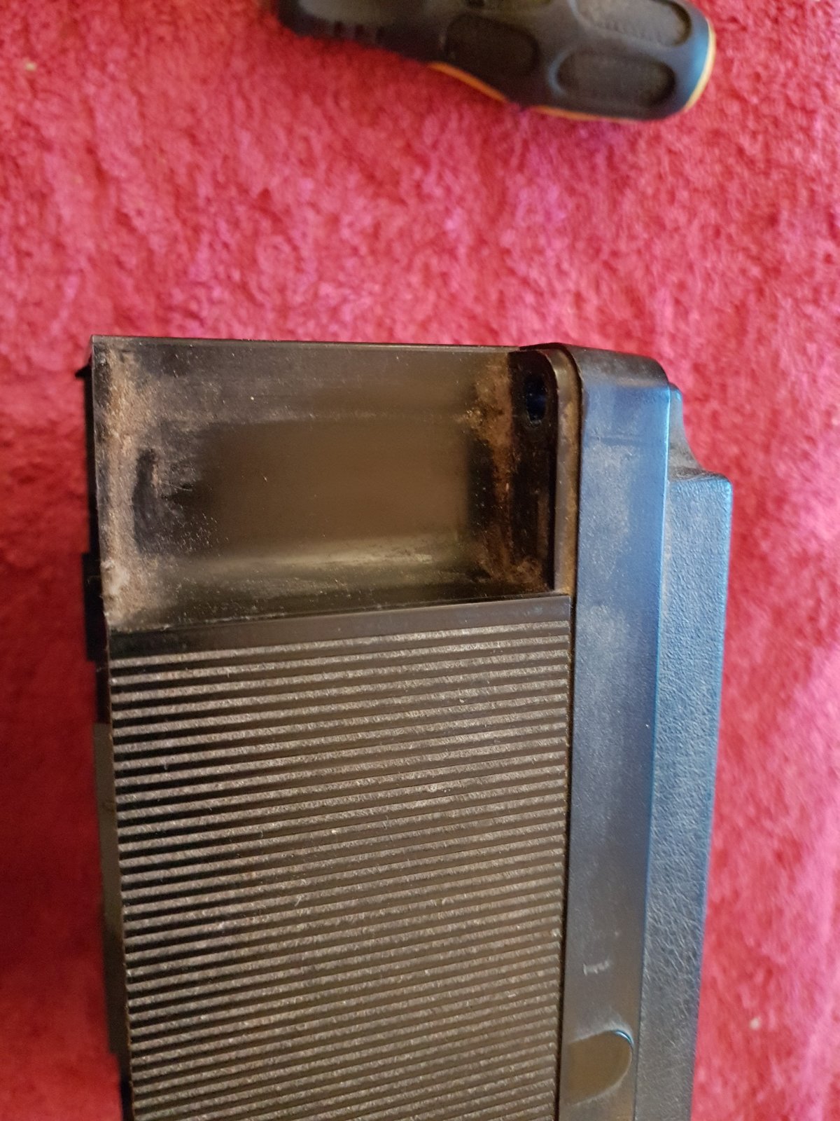

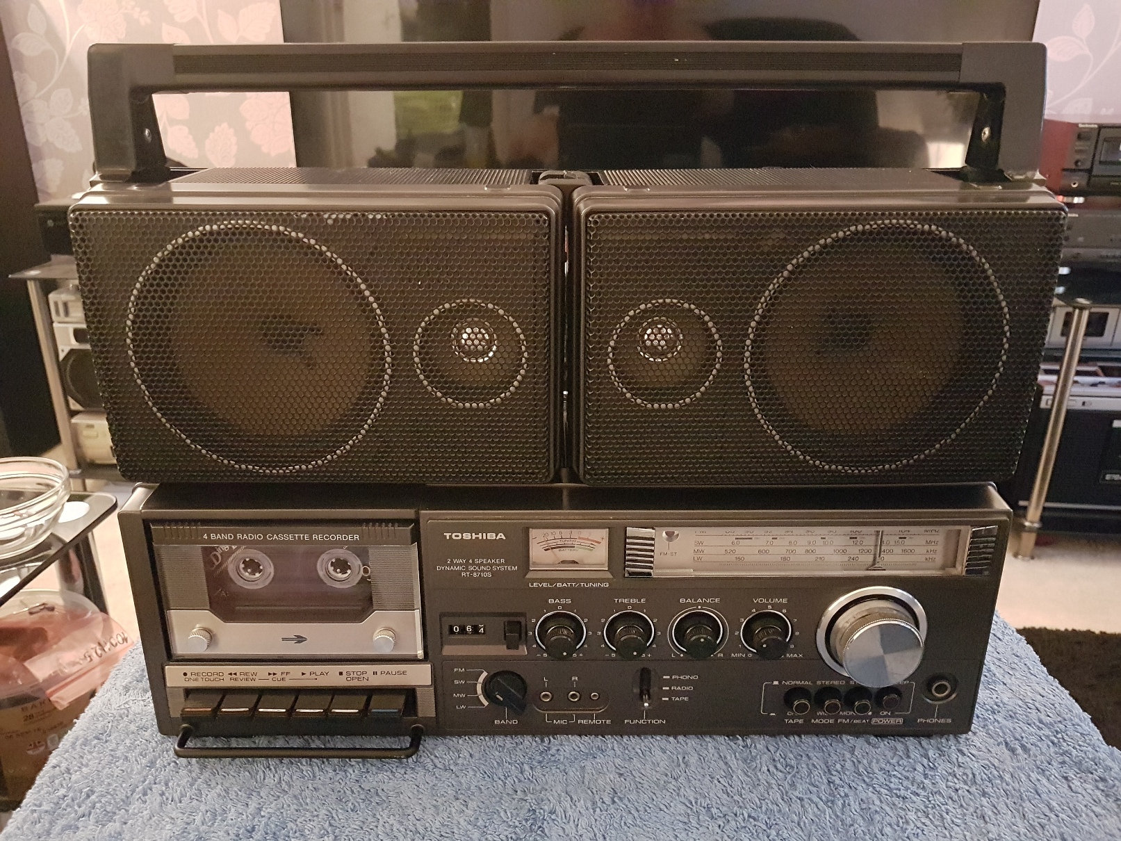

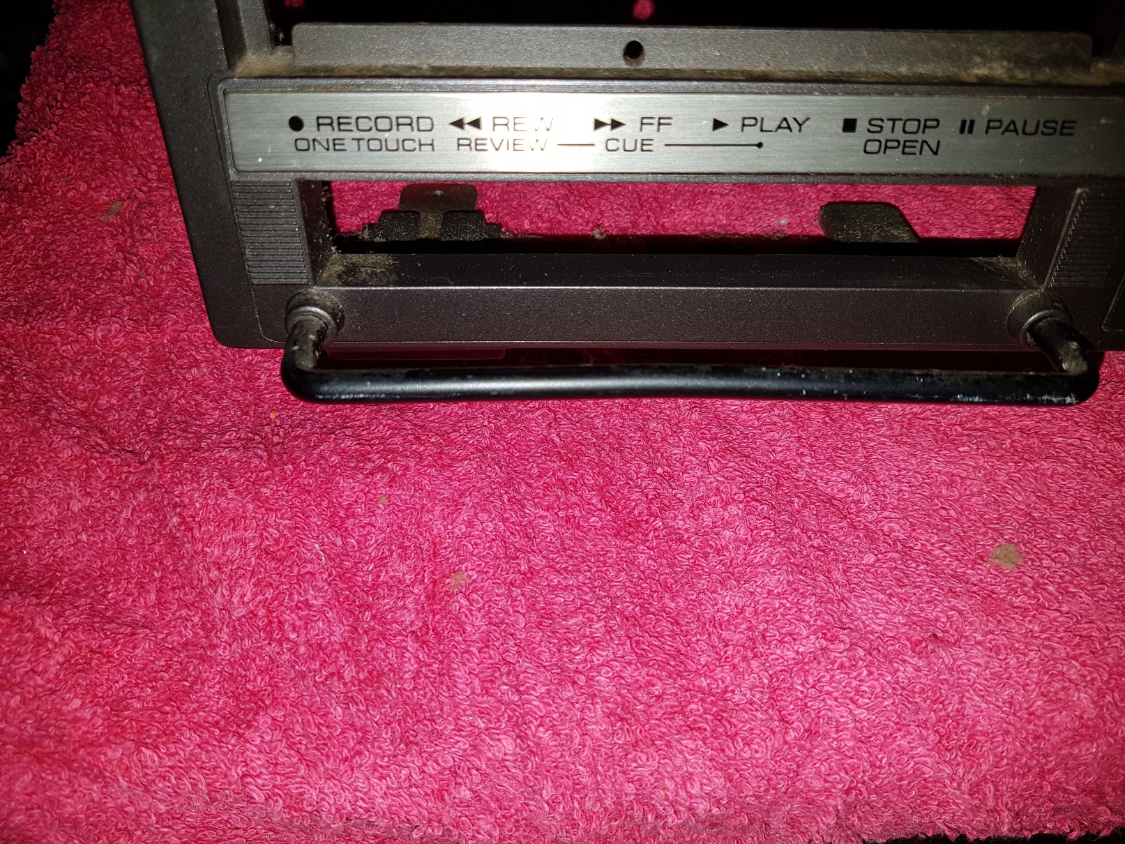

    All good so far & I knew that the cassette deck was not working & the radio only just working which was due to the usual filthy dirty corroded pots & switches so I wasn't too worried about that!! What worried me a little bit was the state of it - It looks like it has lived in a catering or pub environment as it was shocking dirty & coated in what looked like grease & the usual tobacco staining :( :(
    This gunk whatever it was had also penetrated all the switches & pots heavily as they were very hard to move let alone turn :O :O :O The aerial was the worst I have seen so far - Complete & unbroken but very heavily stained as well as almost seized solid & bent :O
    Oh shit I thought - I have got myself into a right gherkin here, this will never clean up let alone work again properly!!

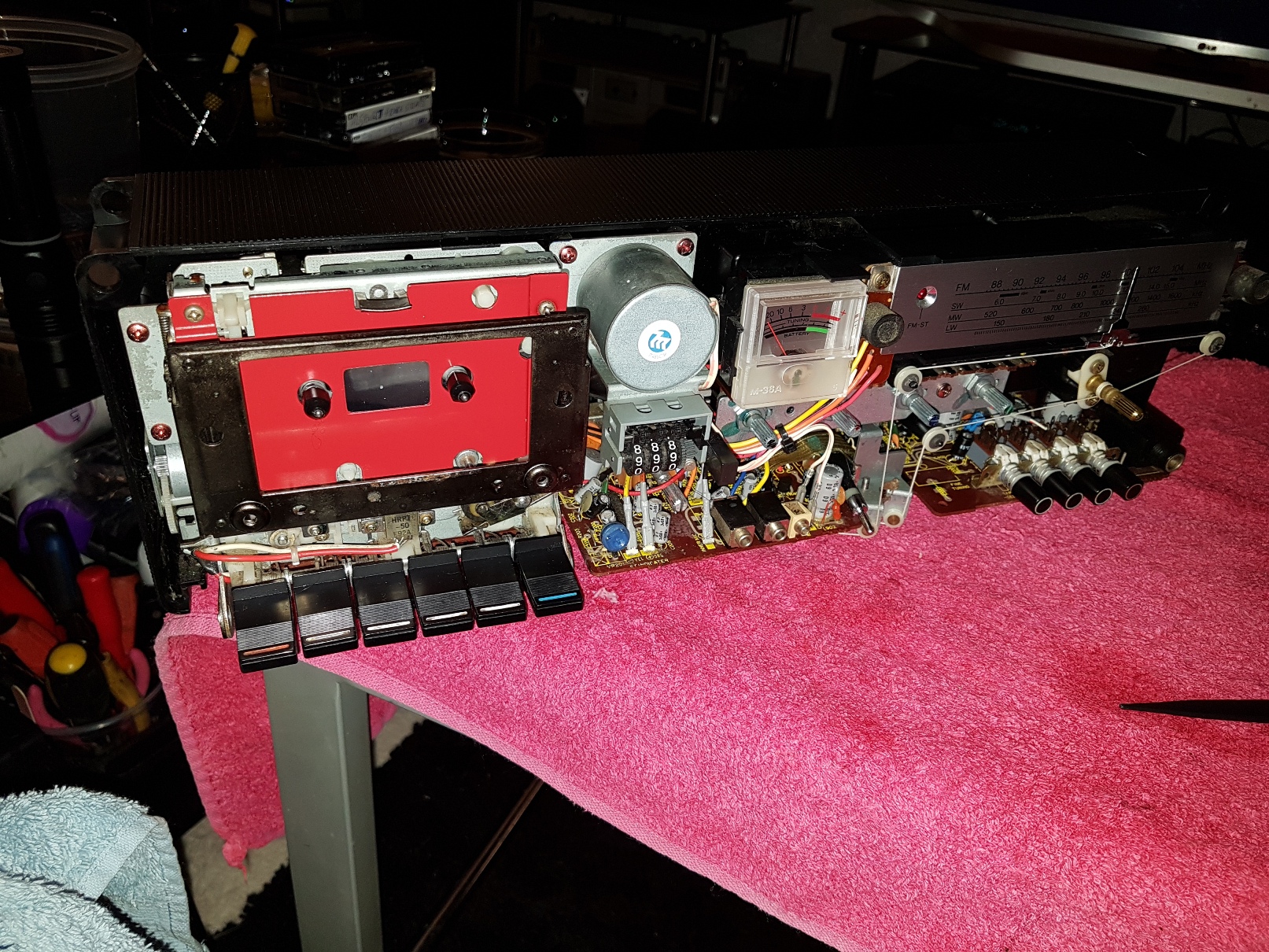

    I thought back to early 2017 & my Hitachi TRK-8290 that contained more than one dead cockroaches & quickly realised that it was bath time for all of this Toshiba except the electronics & cassette deck & began to strip it down ready to clean & restore it!!
    I was a little concerned that the speaker leads were missing - They connect using short phono to phono plugs & I had already ordered 2 of those for this stereo - Until they arrived, a cursory quick test using headphones revealed that both channels were working with a lot of messing around with all the dirty switches!!

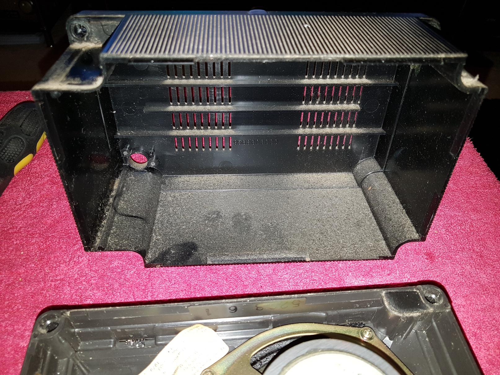

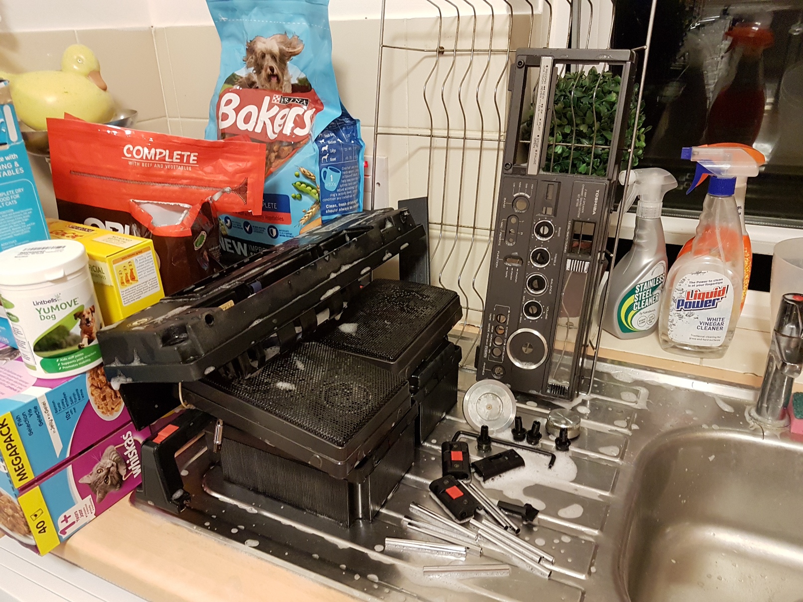

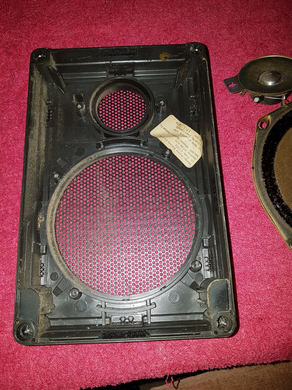

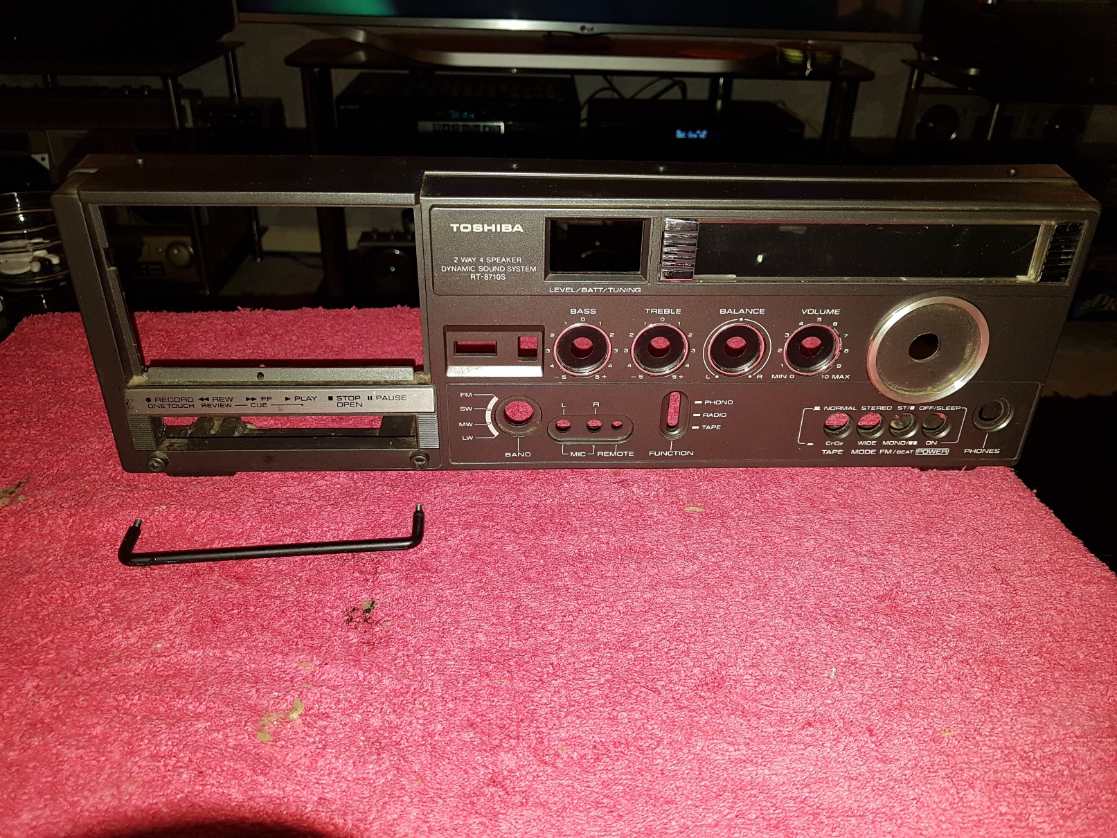

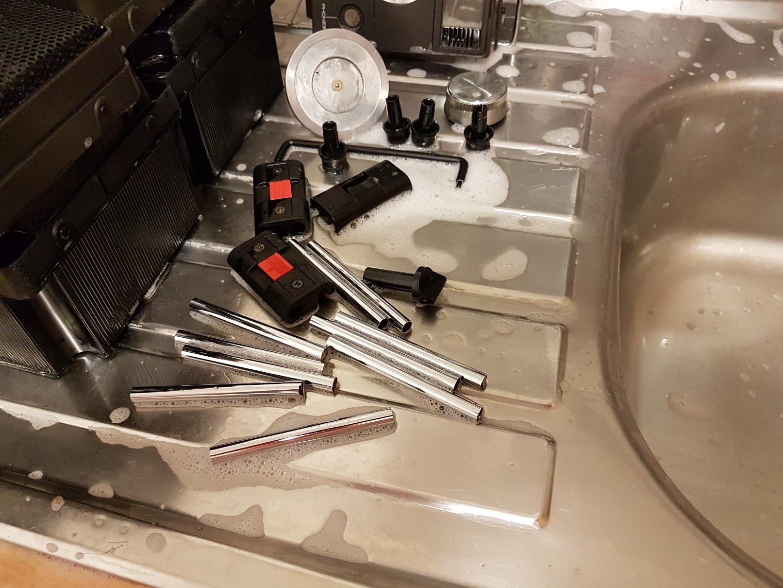

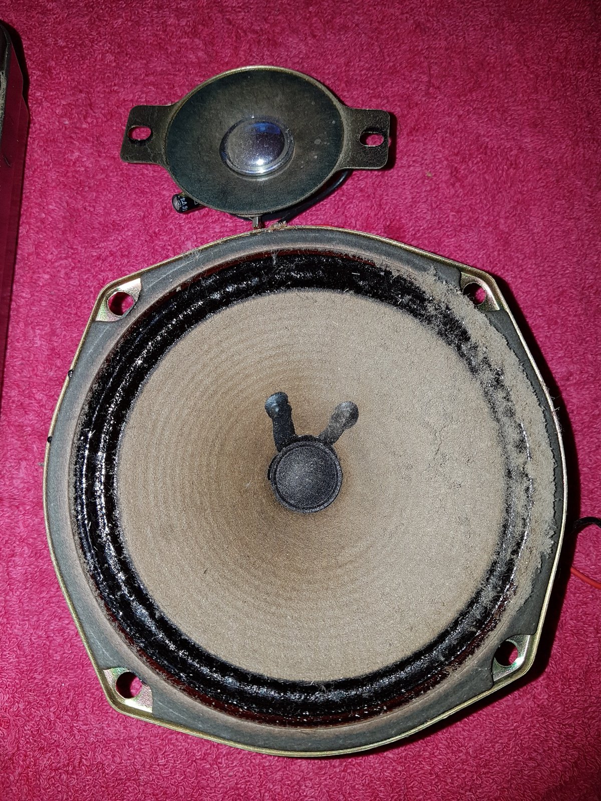

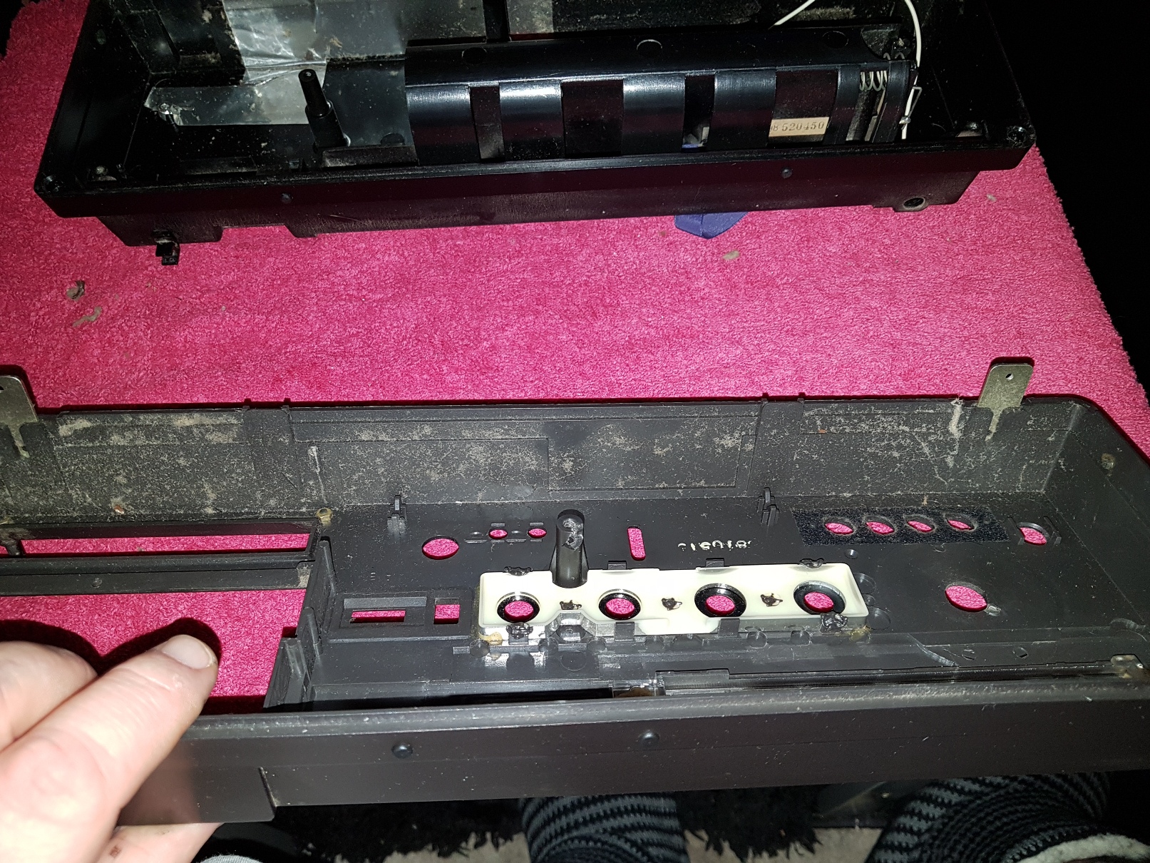

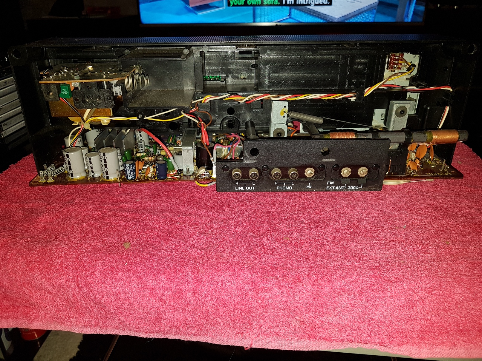

    Next after removing the front & rear casing of the main unit & speakers & wiring from the cabinets, I dumped everything to clean in a sink full of hot soapy water & left to soak! The water was changed around 7 times & left to re soak - I wanted to lift as much of the grease & tobacco stains making the clean process less gruelling :) :) :)

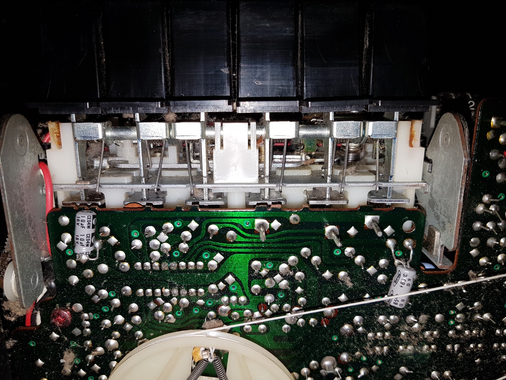

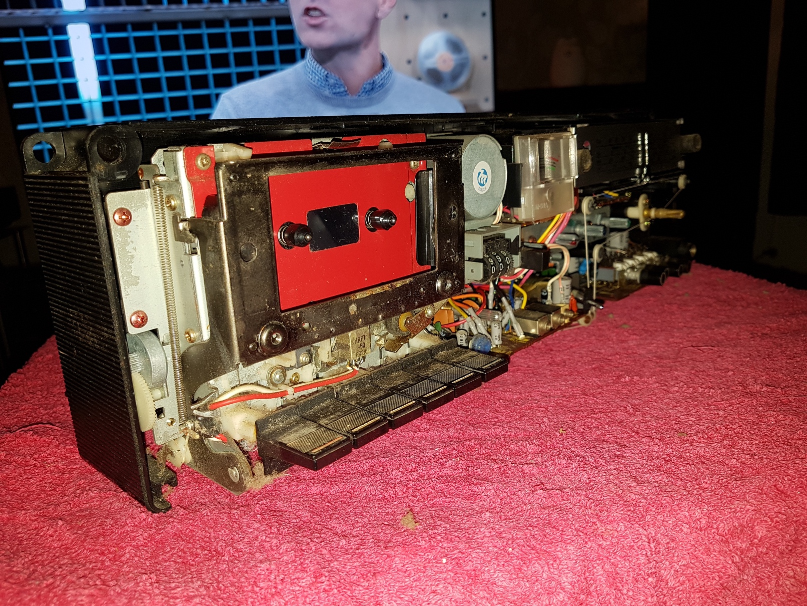

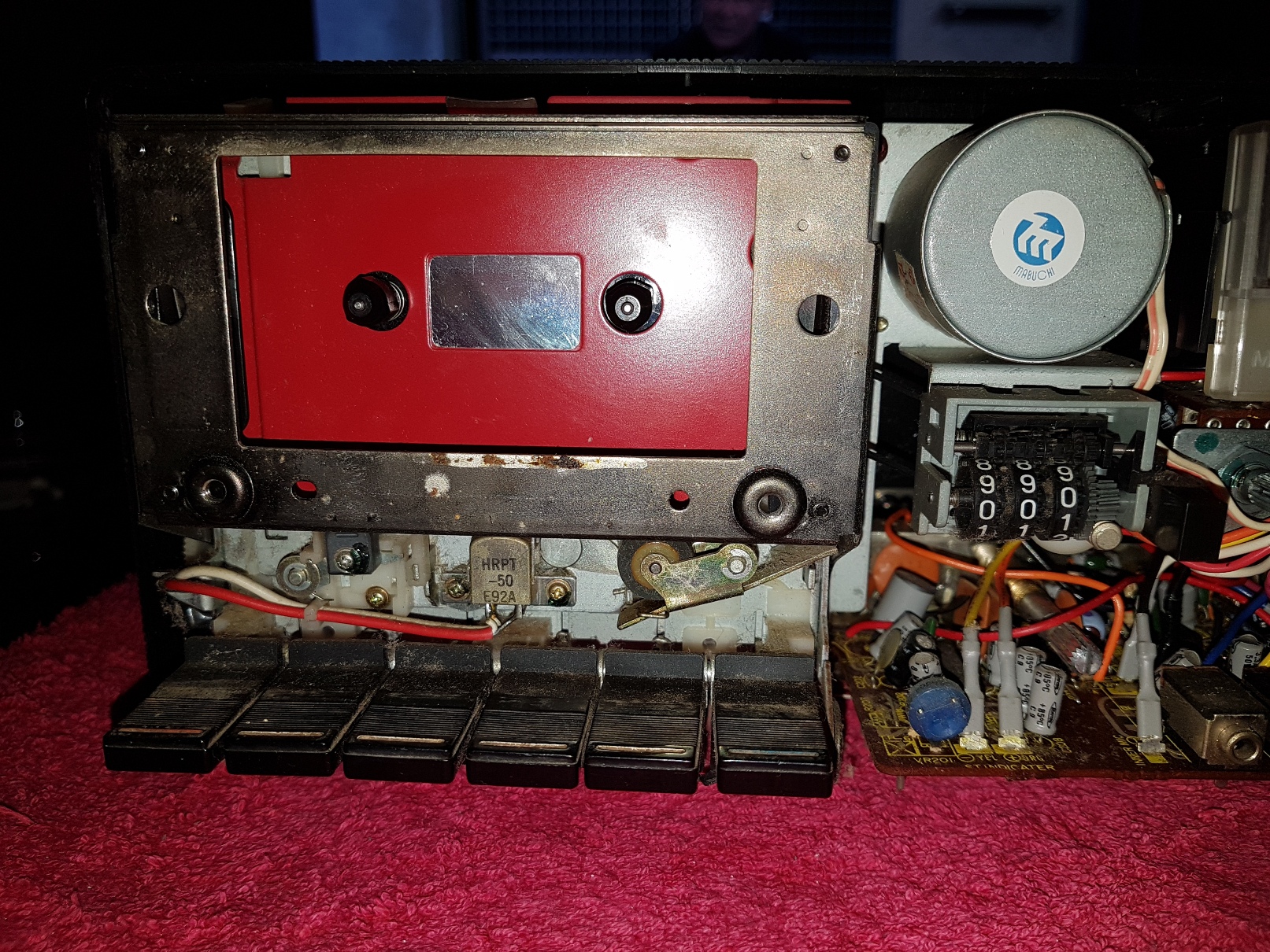

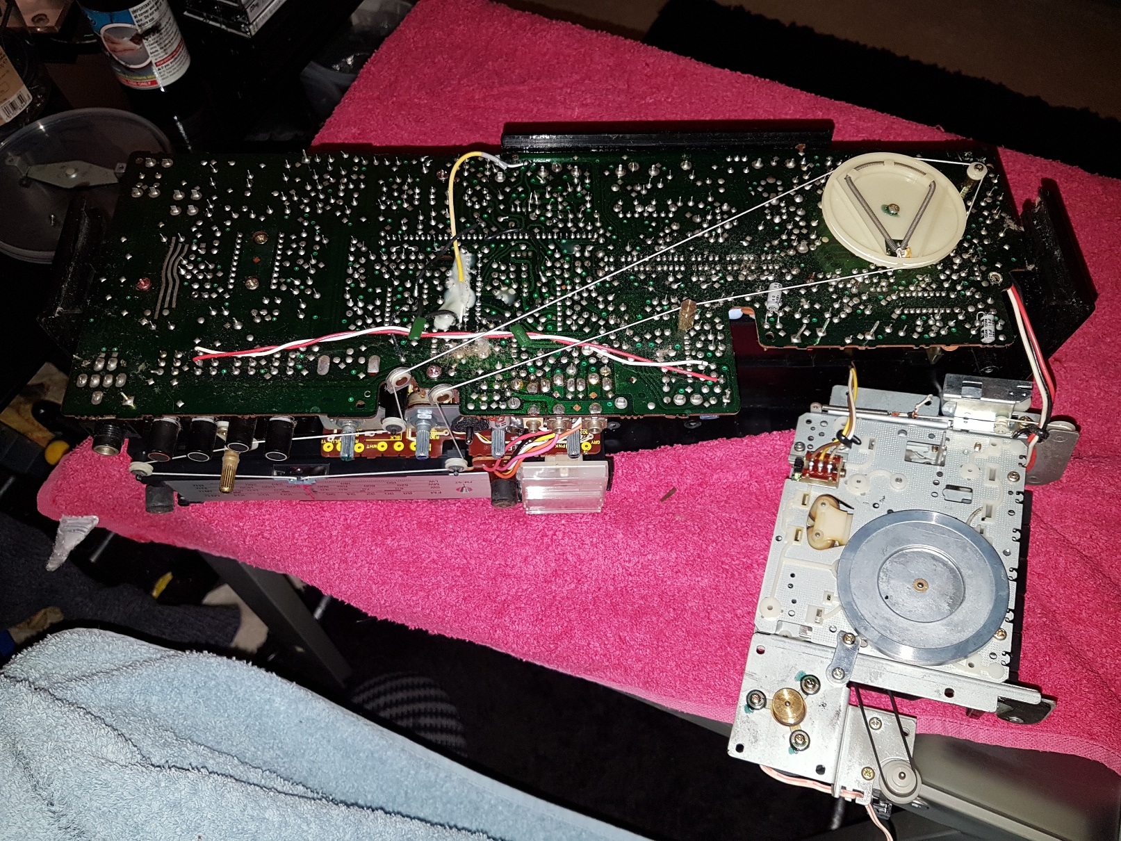

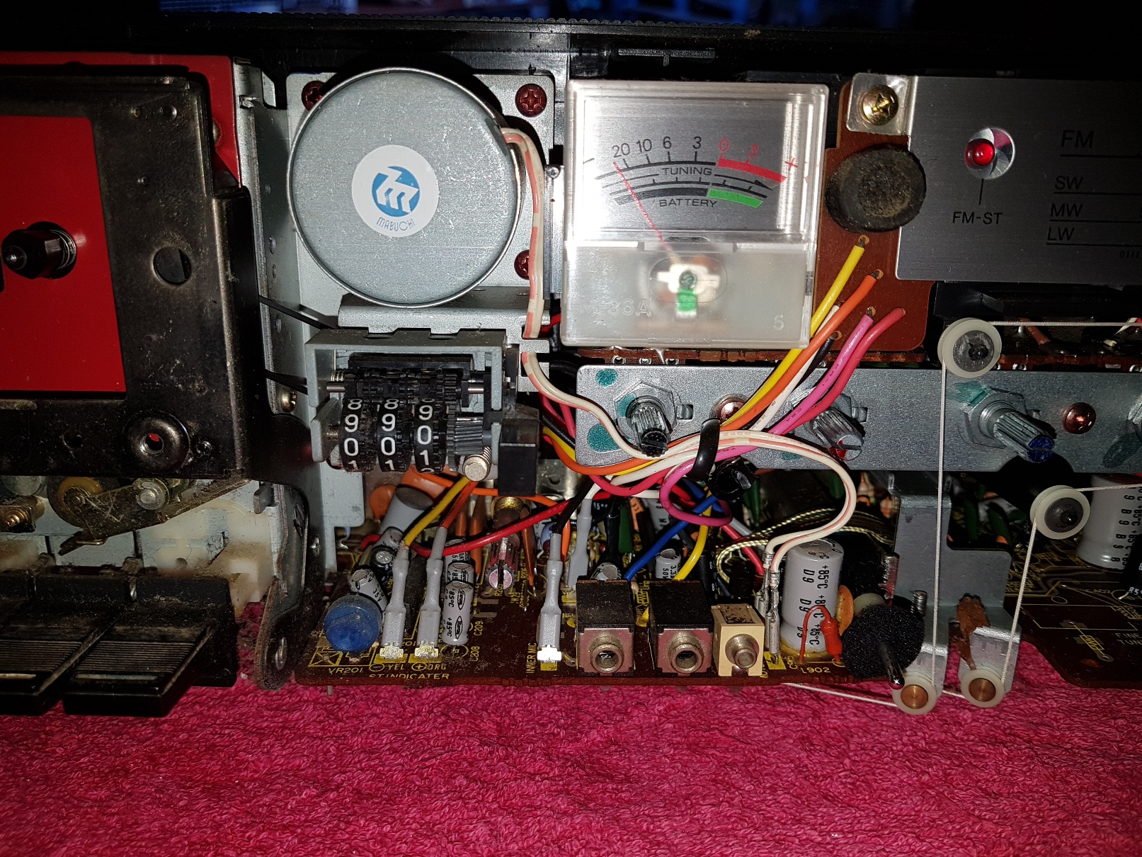

    Time to be a soldier on & the cassette deck was removed fairly easily, this stereo uses solder tags & wires that have a female version of the tag that push onto the male tags soldered through the board - Take tons of images from every possible angle so you don't end up the boat without a canoe..........Confusion could easily reign here if you don't keep a proper record of what goes where :O :O
    I was greeted by a cassette mechanism of excellent quality, One big flywheel driven by a large flat belt & changing the belt is a doddle as the images show!!
    But first, of course the dreaded black gunk from the remaining belt had to be removed from just about every part of the deck (& casings) This took absolutely ages yesterday & kept me up late to clean up!! A new belt completed the cassette deck repair, it now did what it should do with manually turning the flywheel including the autostop function :) :)
    Another 2 hours in kitchen washing all the contaminated parts & leaving to dry overnight, the water was black! :O :O

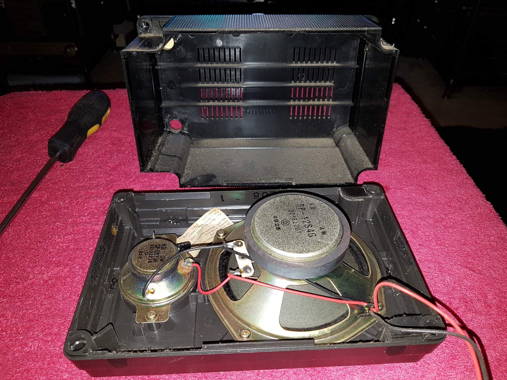

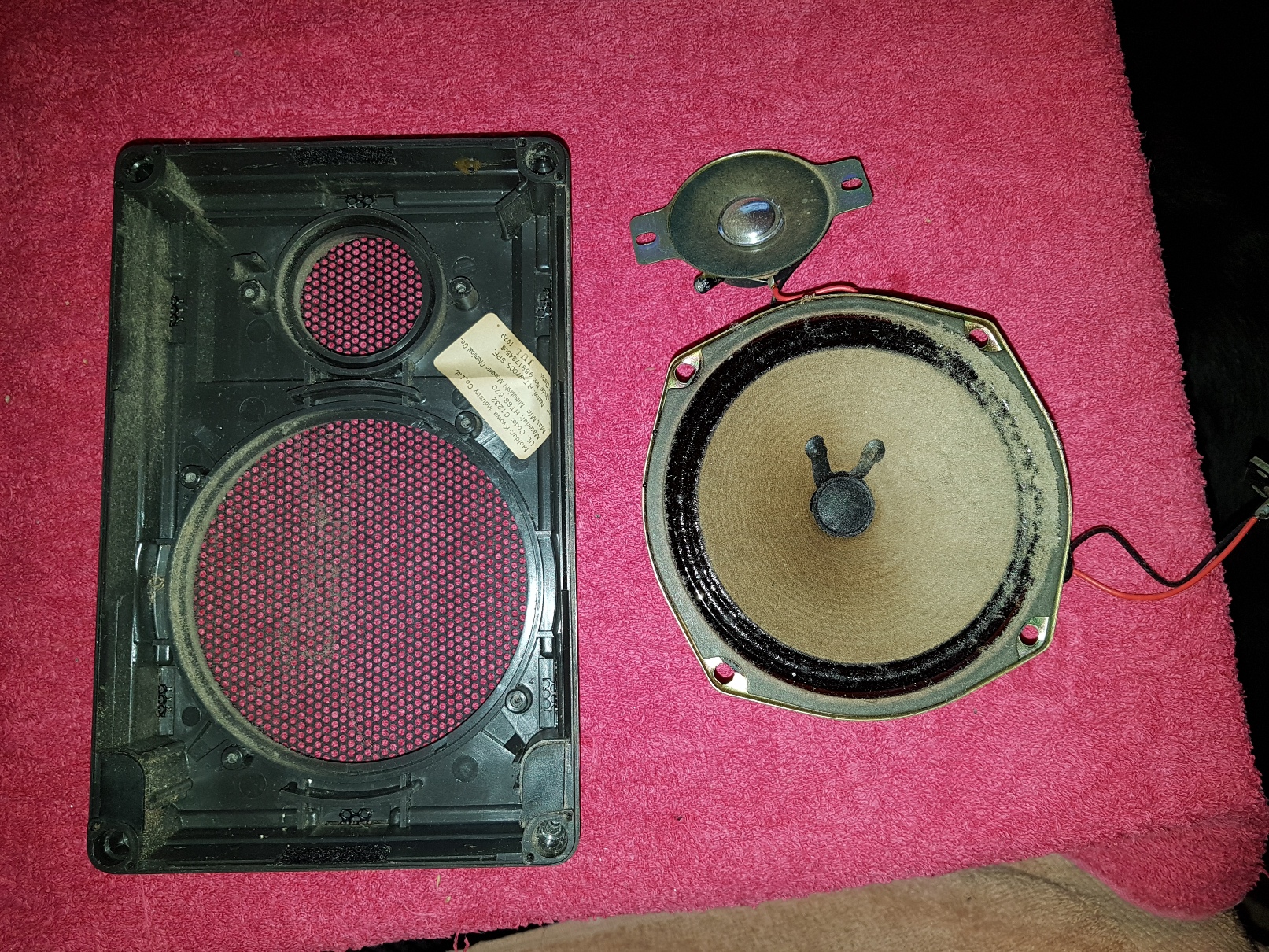

    Just before settling down for the night, I used a couple of soft brusshes to clean the woofers & tweeters which were all in great condition ready to go back in their clean cabinets the next day :)
    A quick word about the speakers - the cabinets are made of extremely strong injection moulded black plastic/polymar with a beautiful steel grille & very strong mounting points for the two drivers! - I think these would be well worth upgrading with better drivers & a little acoustic wadding! They are very simlar to the "Realistic Minimus 7" speakers sold by Radio Shack/Tandy for many years! the Minimus uses real aluminium cases & a soft dome tweeter - that's why they are better but these speakers are rock solid build quality wise! I love them............

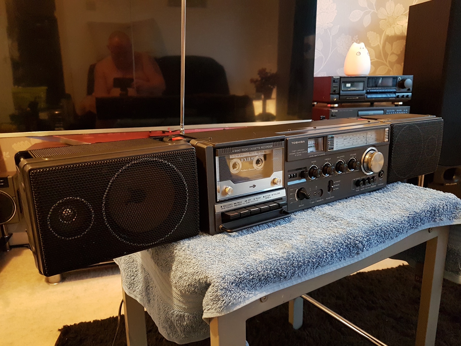

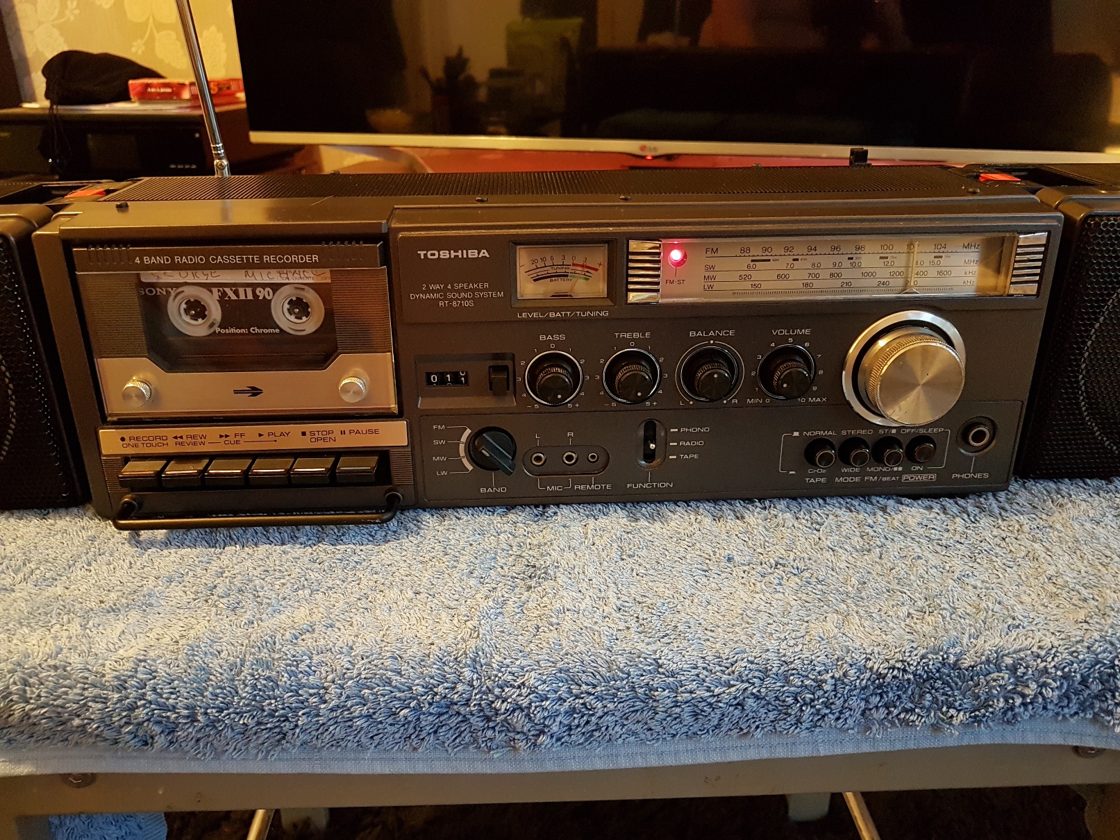

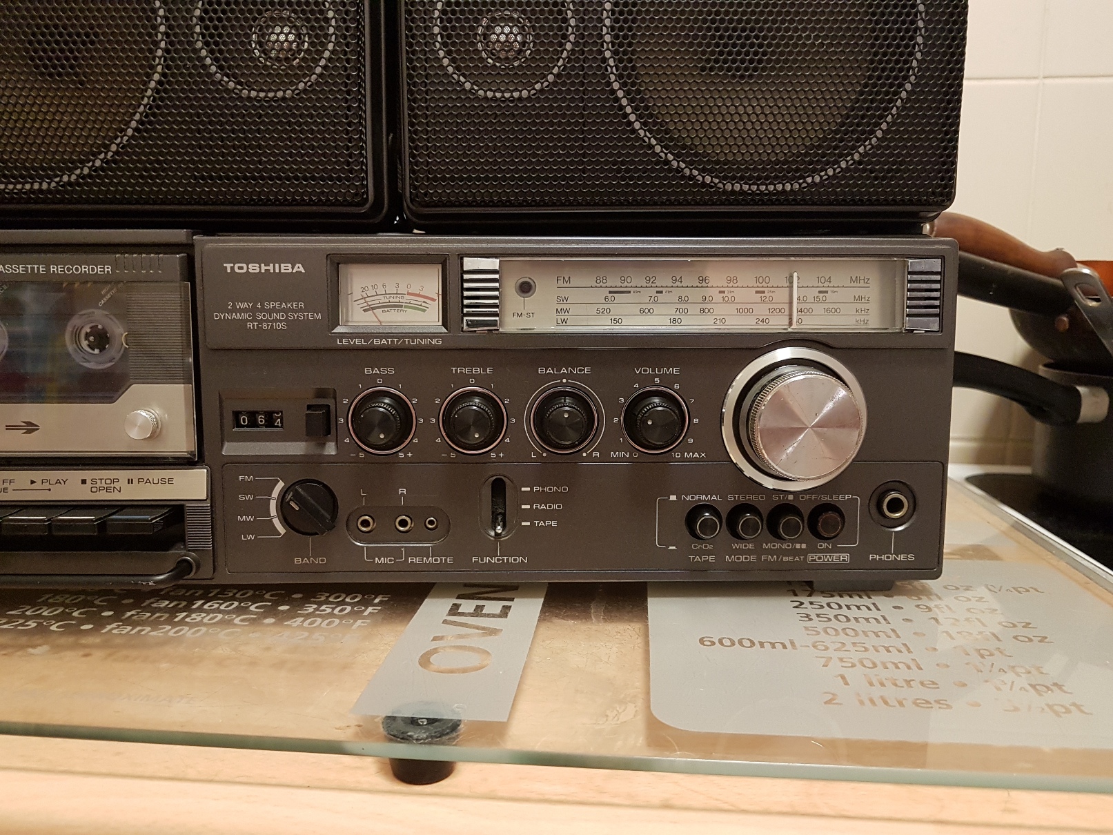

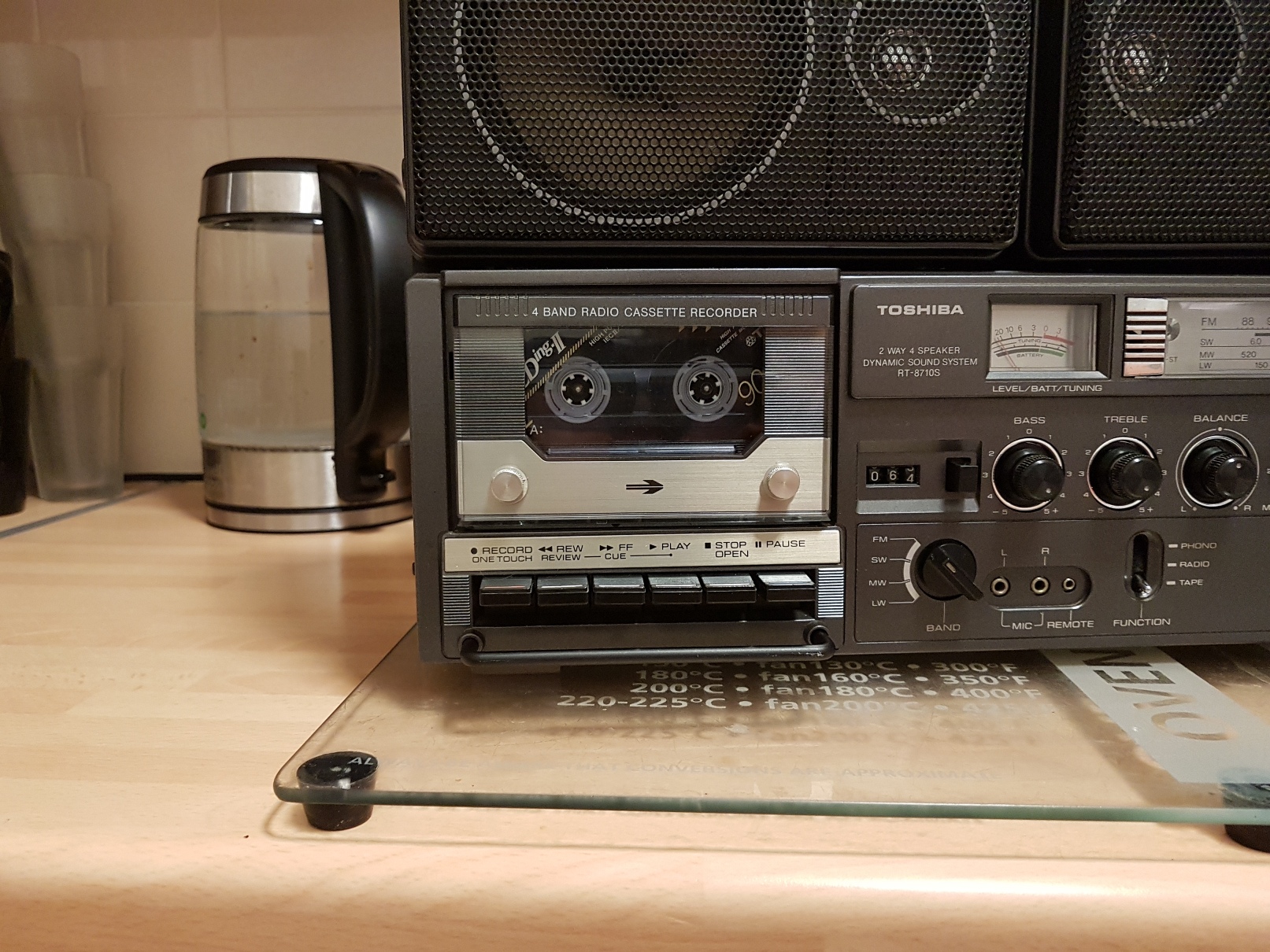

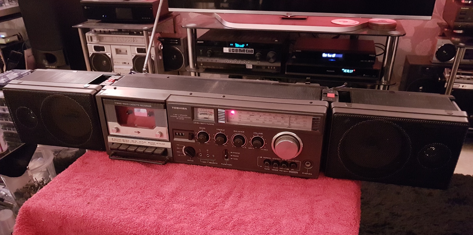

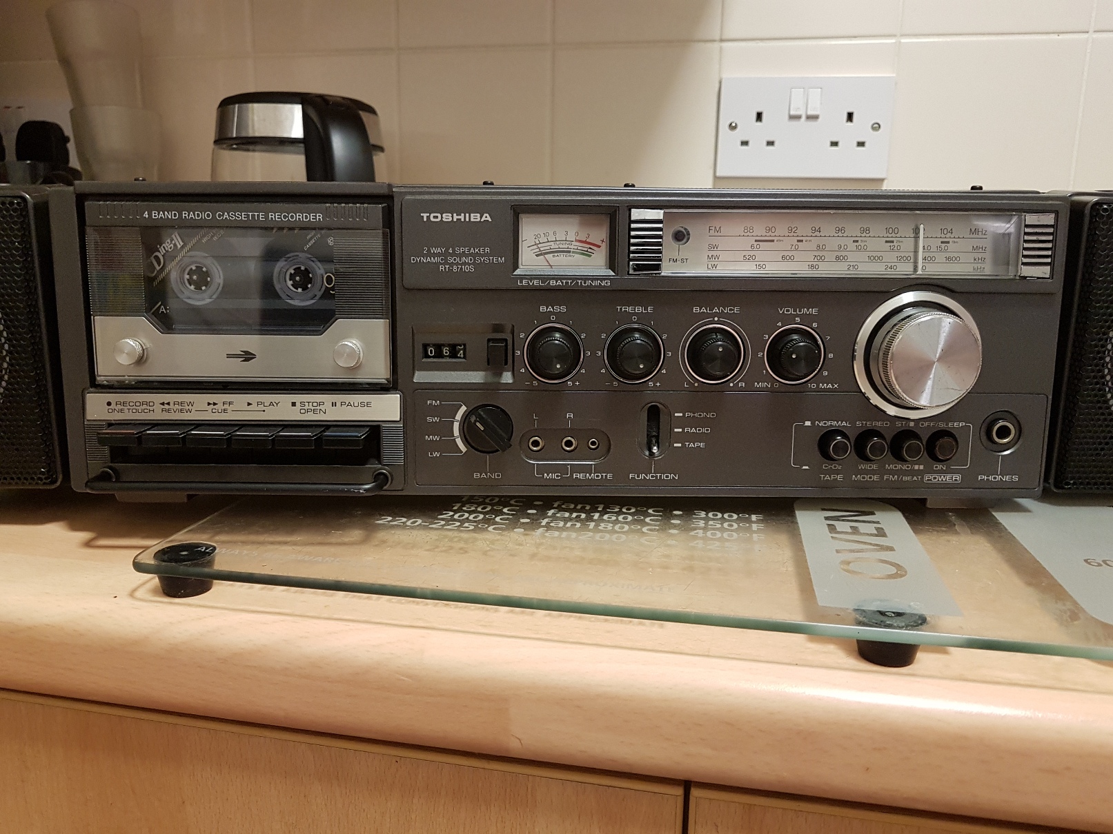

    The clean up had been a complete success!! Everything was pretty much like new with very few marks & scratches on this almost 40 year old stereo!! Even the antenna now straightened was gleaming :) :)
    & So began a very long reassembly process - everything double cleaned & polished as it slowly went back together, it took pretty much all day today until dusk to complete & I am worn out now!

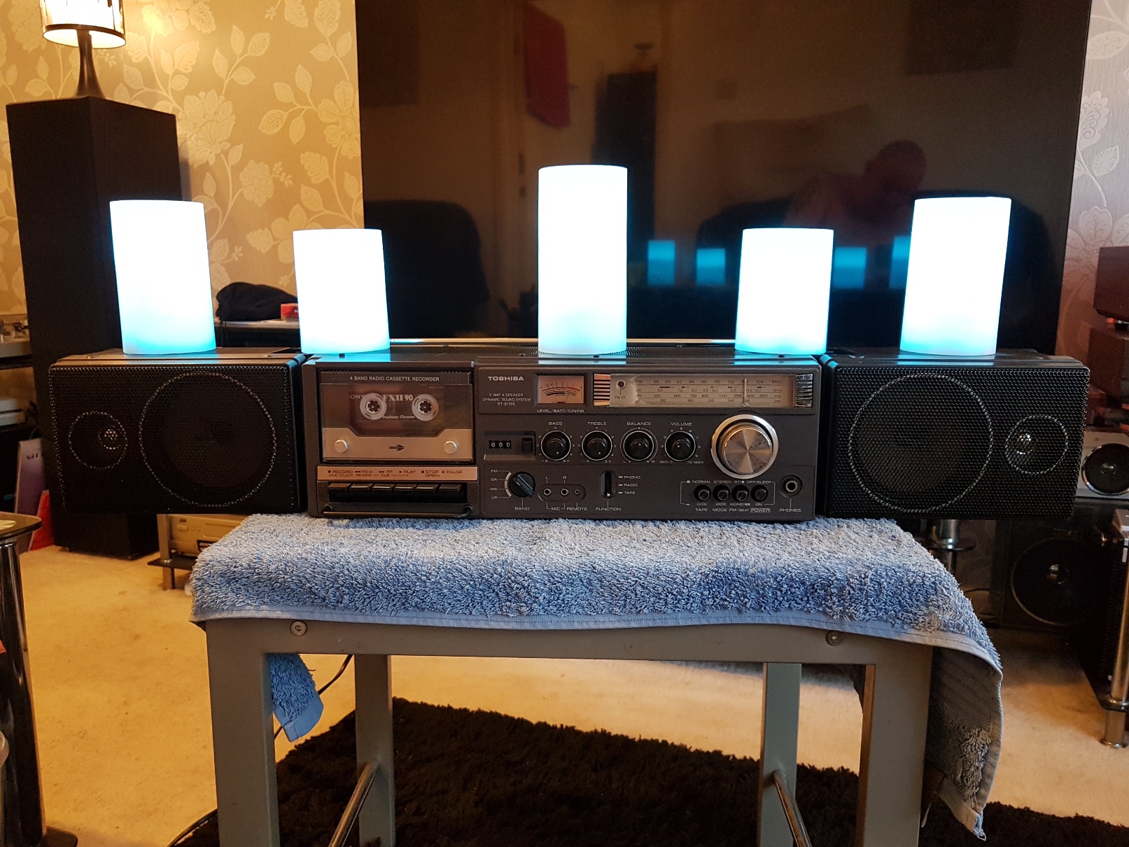

    Does it all work?? - !! 100%
    Does it sound any good?? - Yes It Does!! :) :) :)
    I was so pleased I hadn't bitten myself in the leg with this stereo & it now performs very well! I wish I had owned one back in the day now as it sounds so good :)

    Almost over engineered cassette mechanism with bulletproof mechanical controls & build quality designed to last & it has!!
    Autostop only the basic lever between the two heads, but who cares? It works everytime & the transport keys cleaned up like new too! They now look very smart against the red metal cassette mech cover inside the tape slot...........

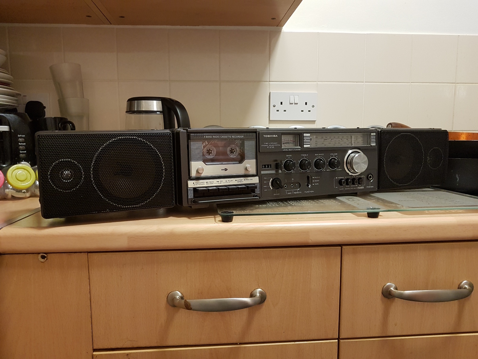

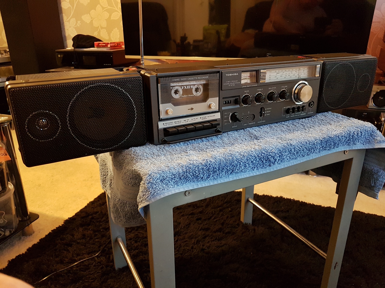

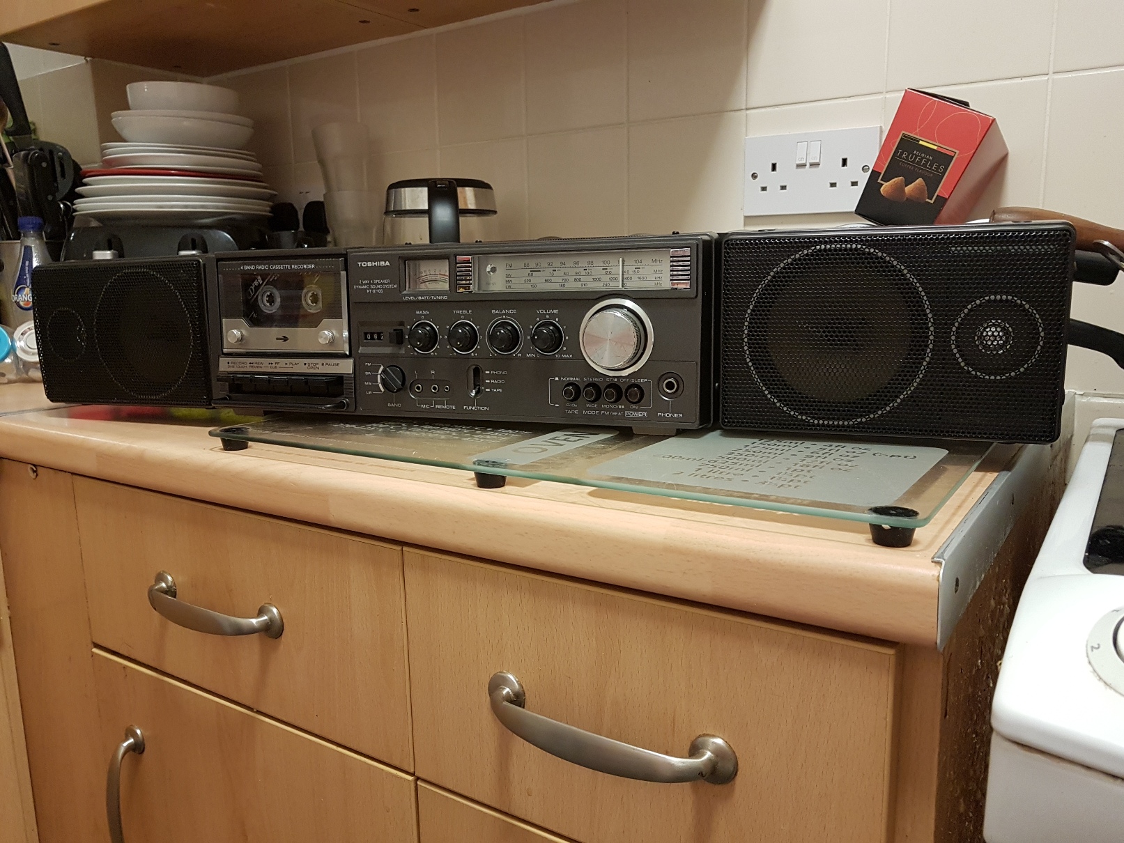

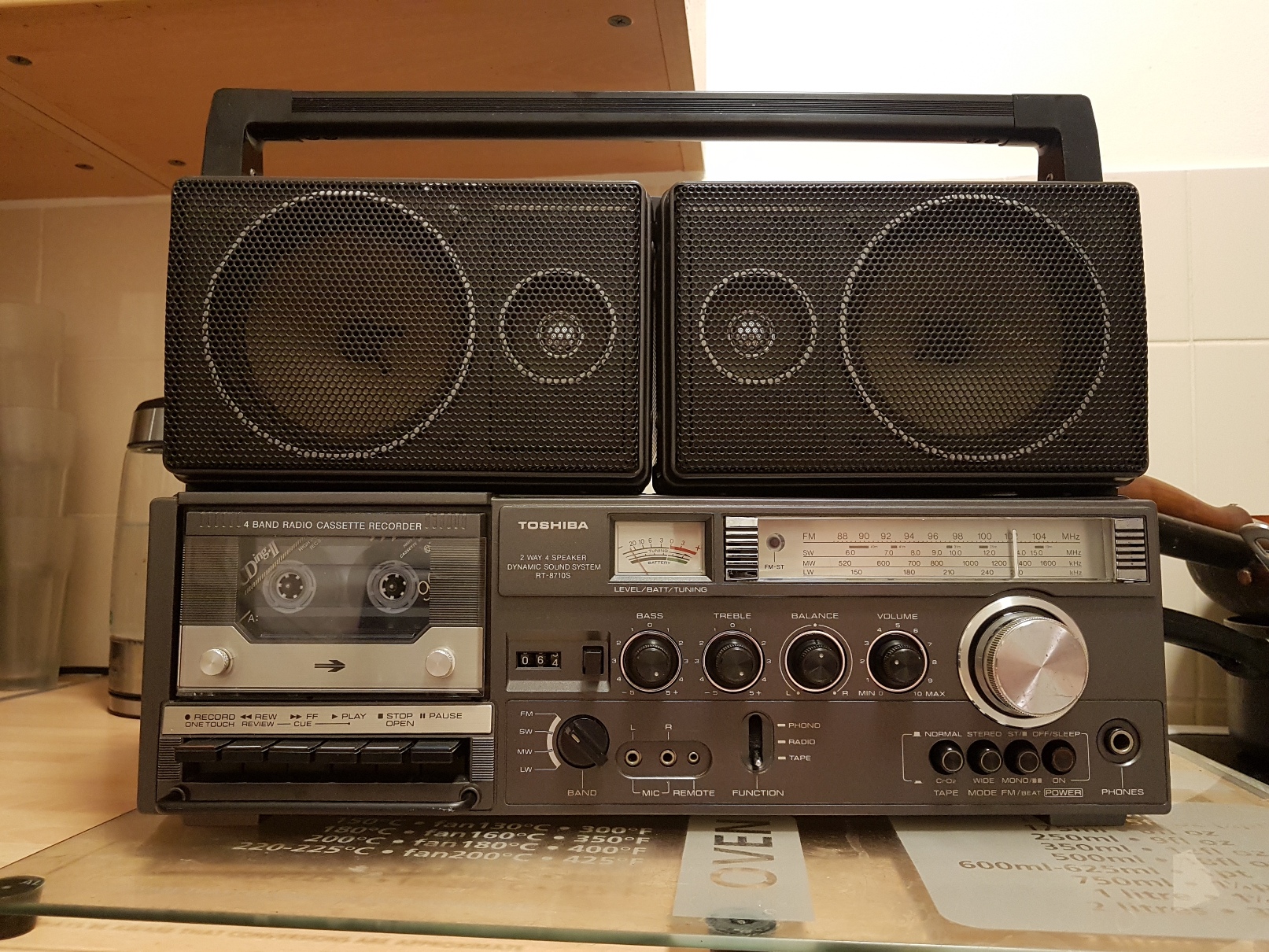

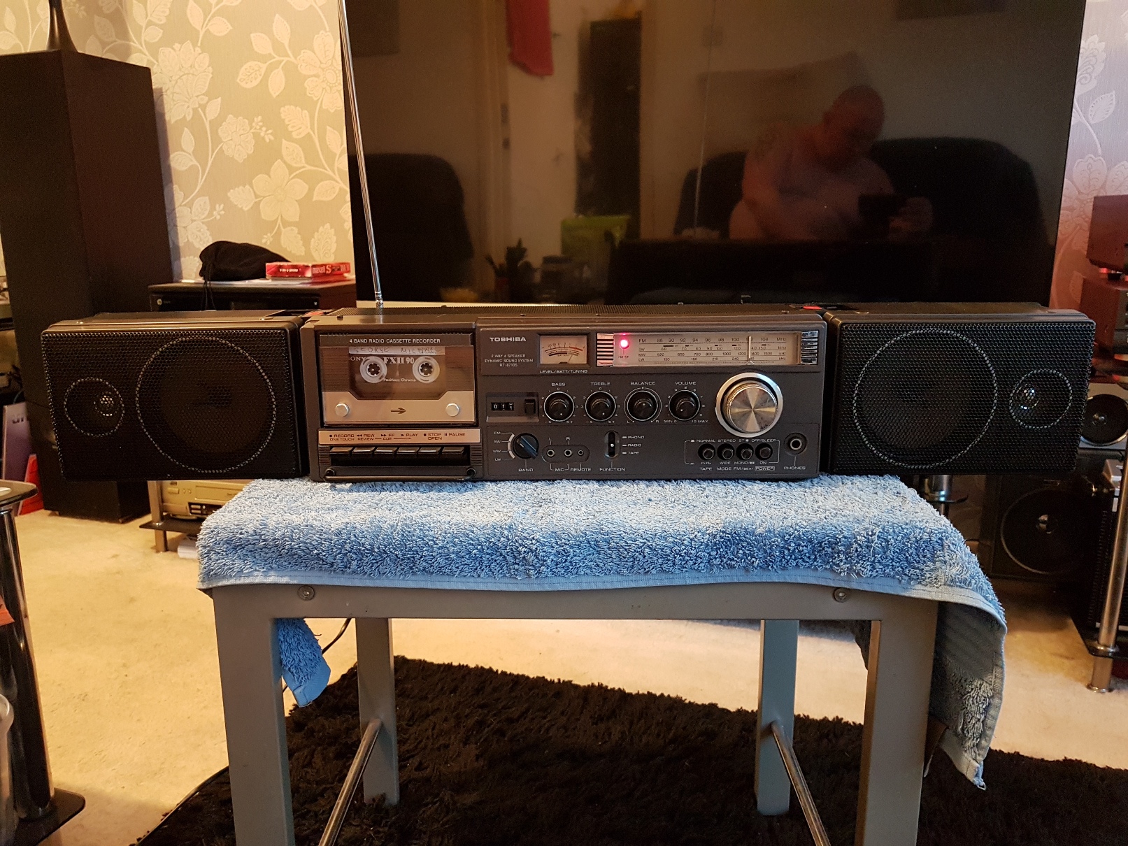

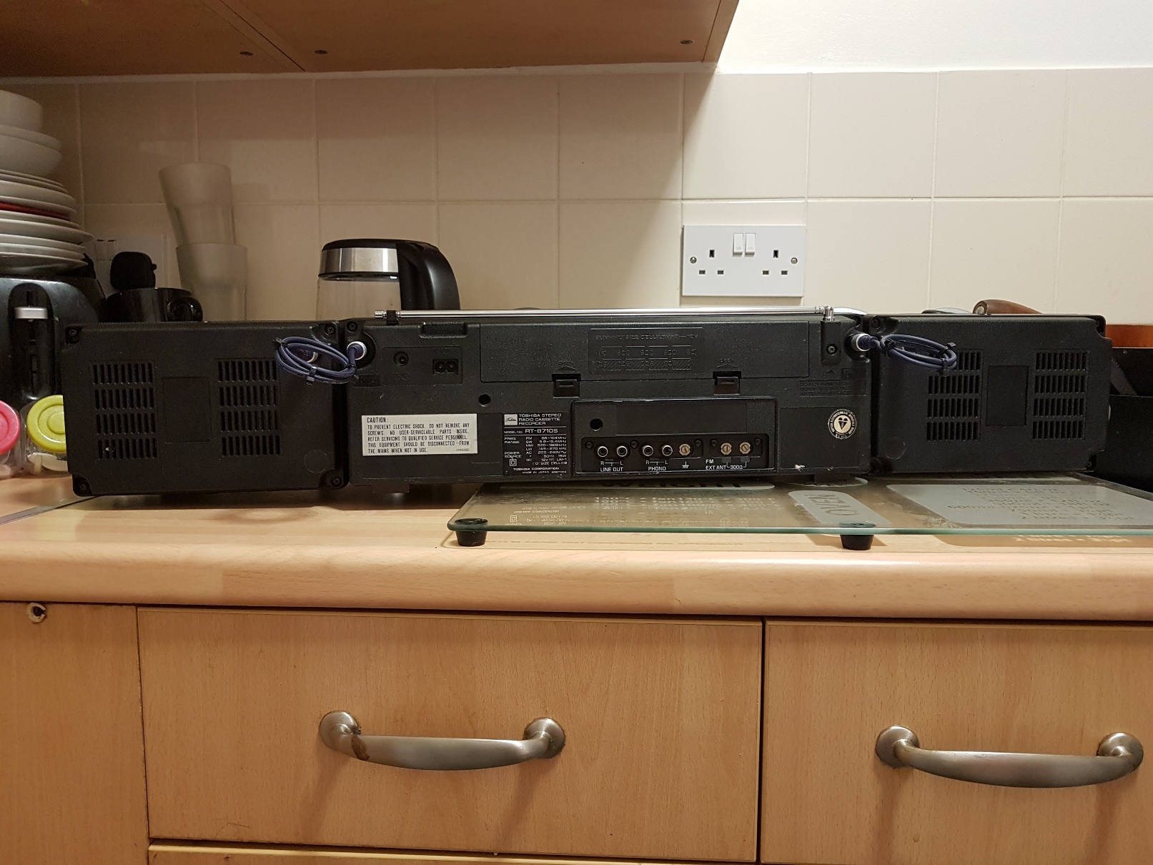

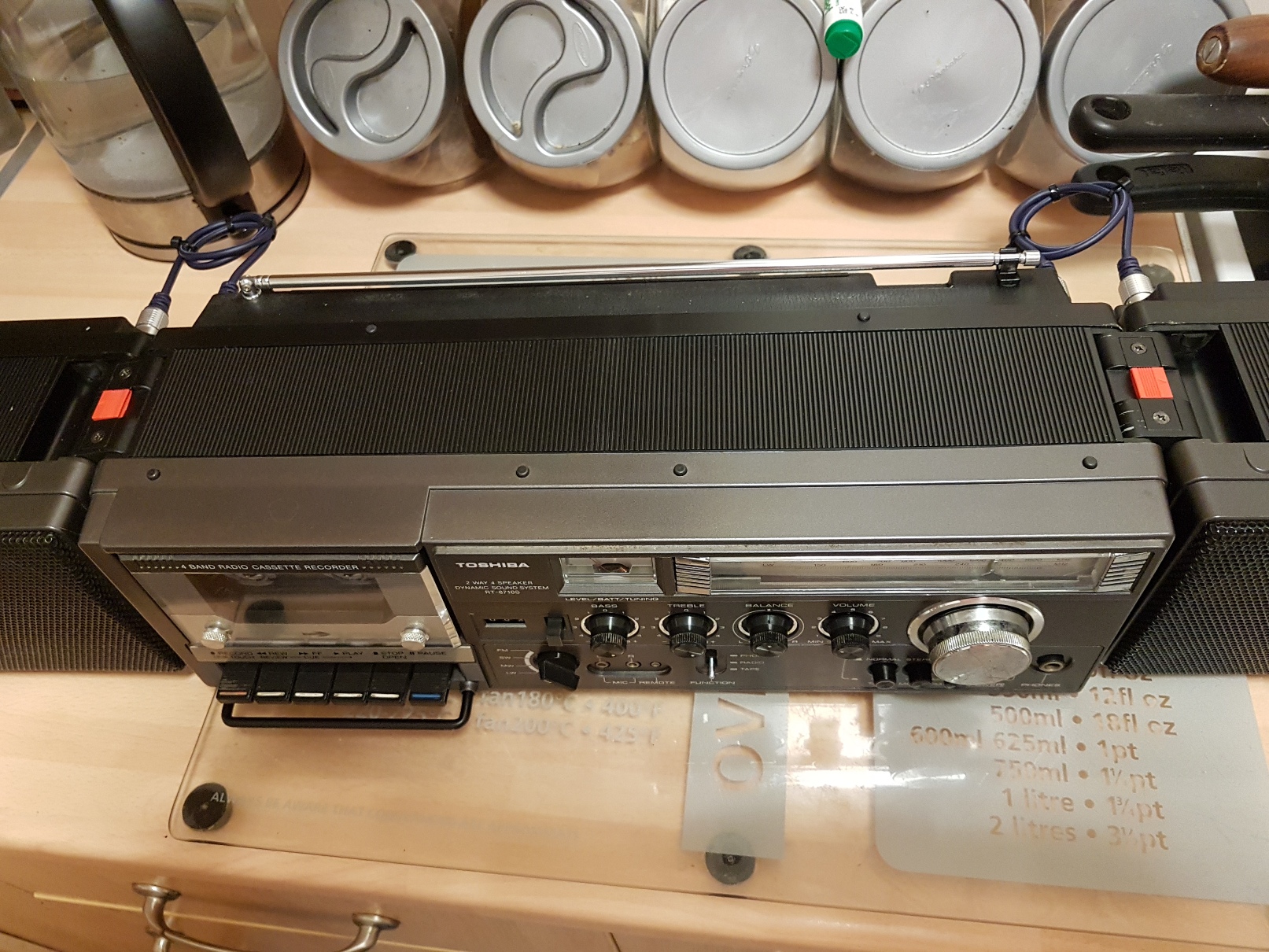

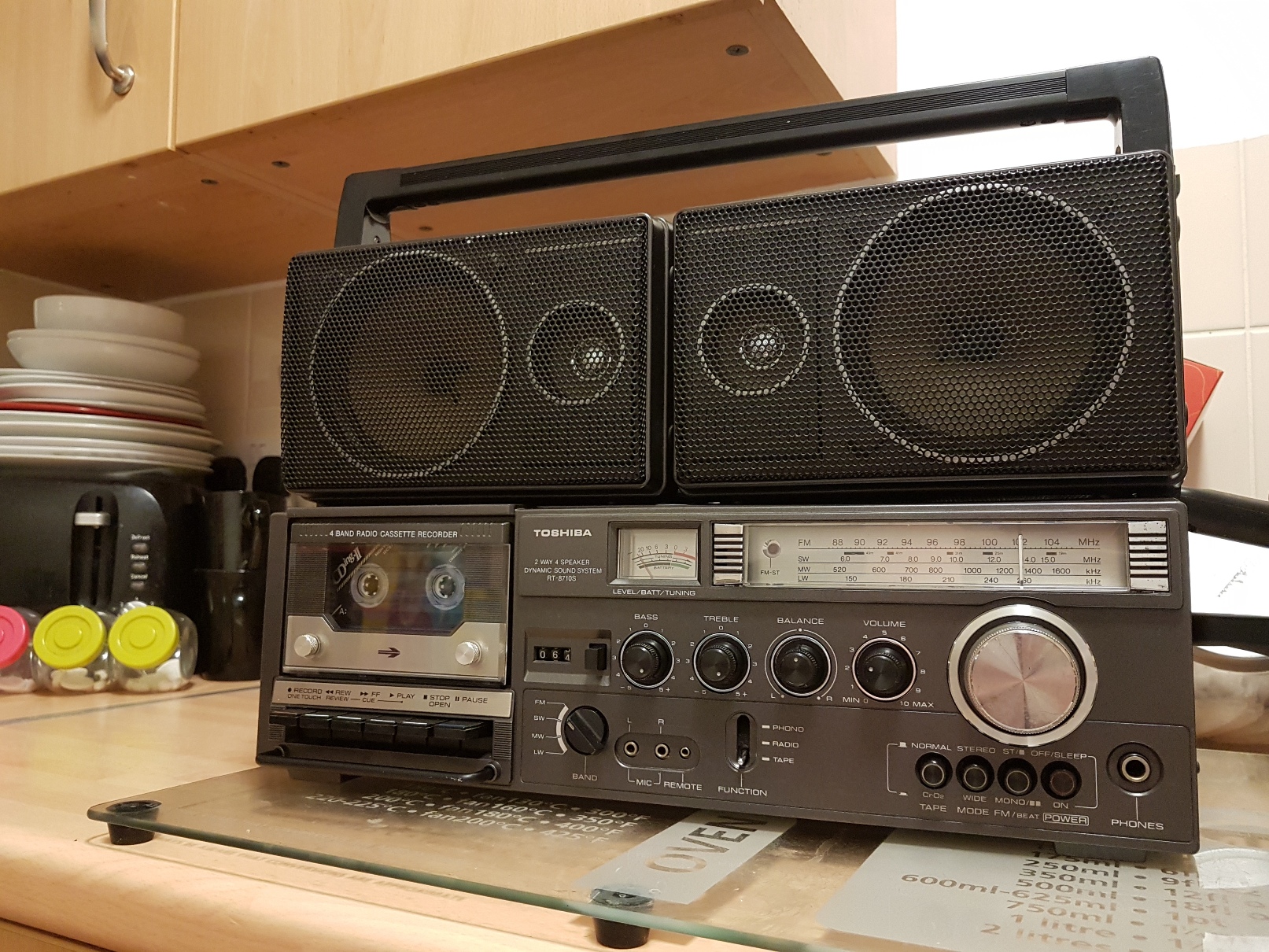

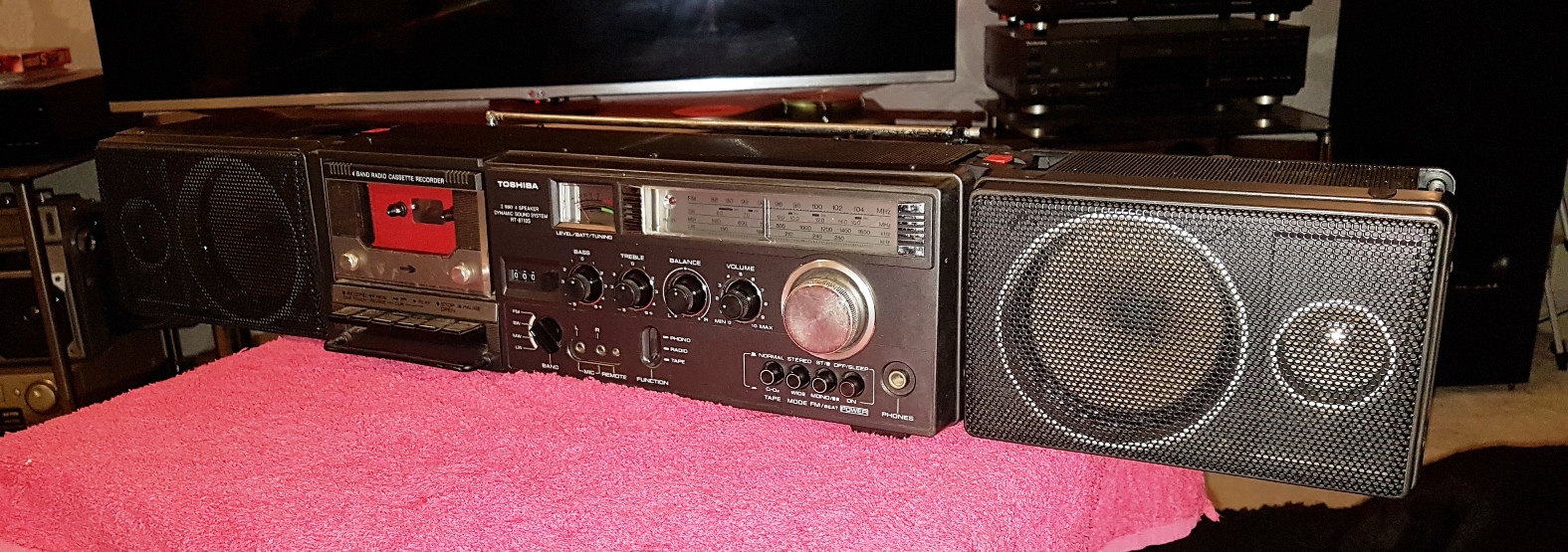

    So there we are - The Toshiba RT-8710S is indeed a very nice stereo radio recorder especially when orientated in the very long "Low Profile" option giving you a better than average soundstage for portable!! I suspect many only used this at home - it's big & heavy & probably better enjoyed indoors!!
    I am so glad that I didn't get caught out just like a kipper - I am delighted to present my latest acquisition the RT-8710S
    Et Viola:

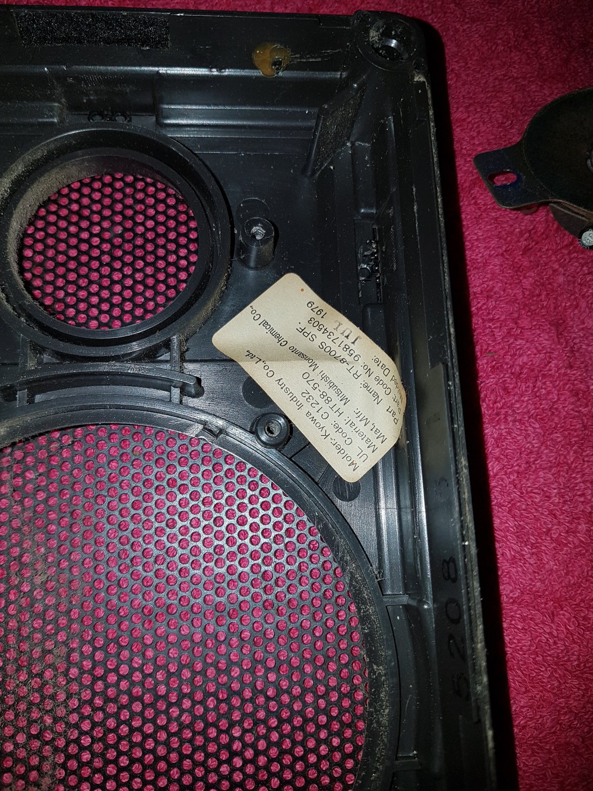

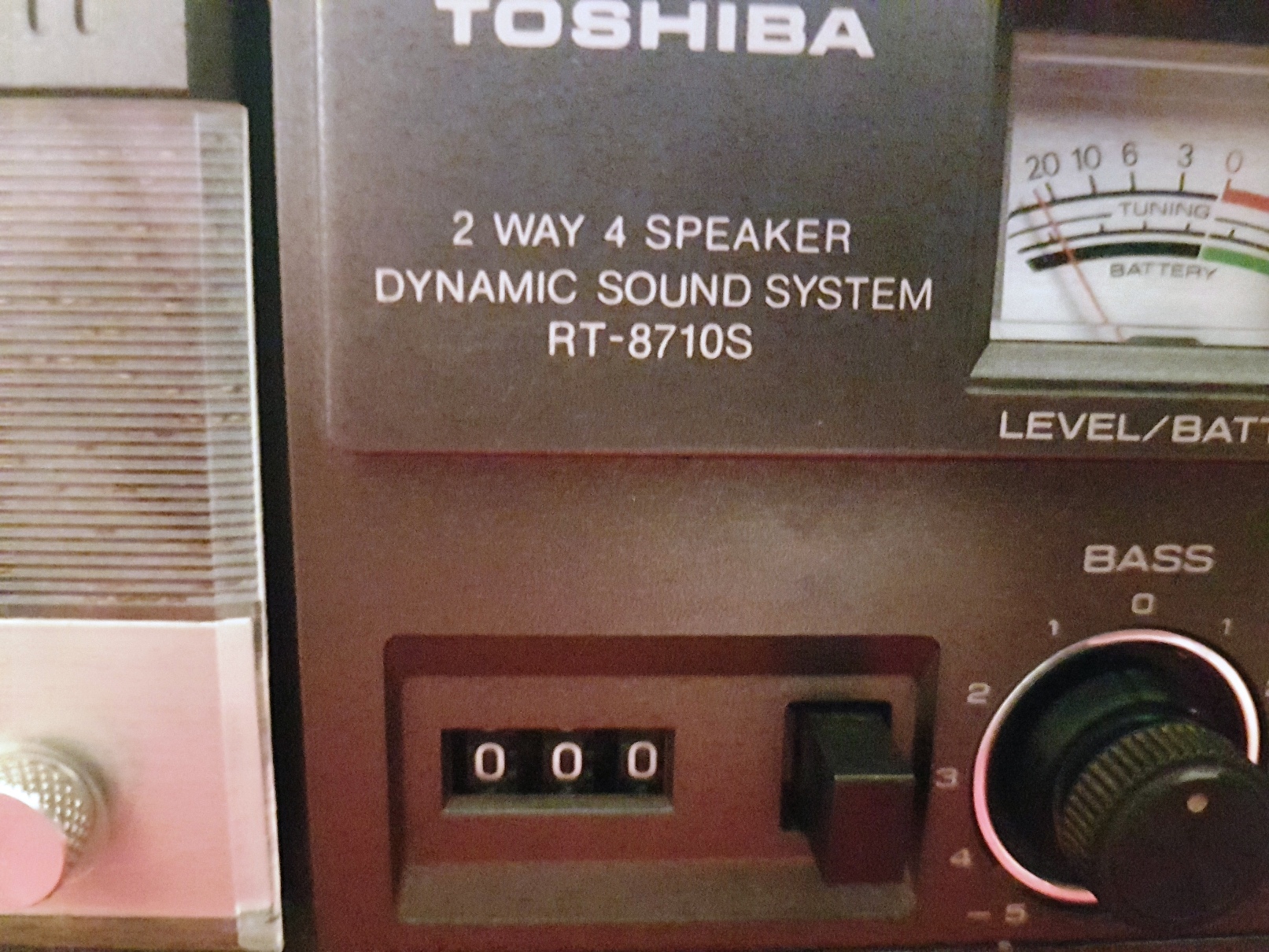

    With the helpful label no problems dating that one. I understand why you took the close up.
