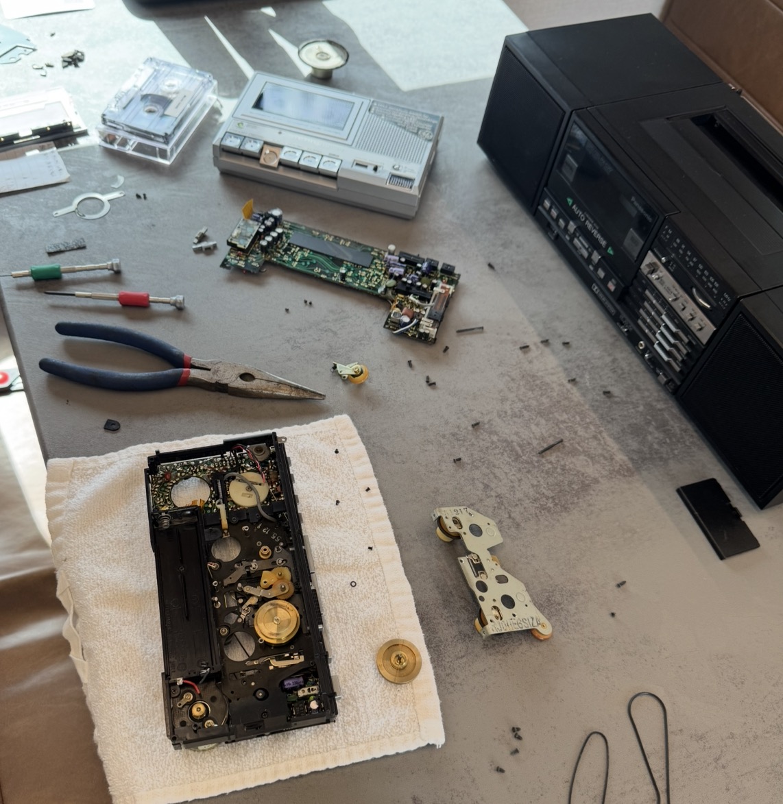

    I own several Panasonic RX-2700 personal cassette players. I did a quick sacrificial tear-down of the most damaged one and it just doesn’t seem that hard to replace the belts.
    While I am replacing the belts, what else should I do as part of a full restore? I’ve never done anything past belt replacements on my cassette players.
    I see a lot of people re-capping. Is it absolutely necessary and why? Best sources to purchase capacitors?
    Any other parts that I should consider replacing while I’m in there?
    What parts should be re-lubricated and best lubrication products?
    Any other tips and tricks before I get started? I want to do this correctly. The RX-2700 is a tedious machine to service so I only want to get in there once.
    I have FOUR RX-2700’s and looking forward to getting them all working.

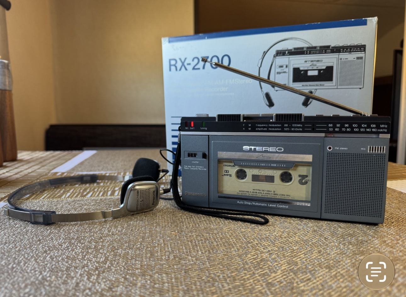

    I appreciate all the advice so far.
    I love the RX-2700, both for its historical significance and its Japanese camera-like build quality.
    I own 4 used ones and a pristine NOS unit in the original box with the original square headphones.
    After watching the Techmoan video a year or so ago, I was terrified to even touch one for repair. Yesterday, I decided to tear into the most damaged one with reckless abandon. I wasn’t worried if it ended up in the parts box - and to my surprise, it just wasn’t that hard. Tedious, yes - but not nearly as hard as Matt at Techmoan made it look. So I ordered several sets of quality belts and I’m gonna get as many of them running as I can.
