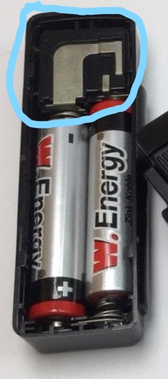

    I've lost the battery contact part.
    I think it can be made from aluminium foil or solder on a bent piece of a plastic card.
    @bub From the picture you posted, I am assuming that you made either a nimh or lipo battery adapter, with a step down converter (to get rid of that extra .7V from most available 3.7v batteries) with usb charging of some kind?
    Is is worth more for me to remake the battery contact part or make a new battery with usb charging?
    If the former, would you kindly be willing to share the dimensions of the battery contact part as well as pictures showing the 4.7uf capacitor and how it's connected?
    Figure 1 - contact with only 2 pins
    Figure 2 - contact with all pins
    Lastly, is it required that the contact rail are make contact with only 2 pins like in figure 1 or is it alright if the contact rails make contact with all 3 pins like in figure 2?
    Thanks in advance!
  13. bub
    bub Active Member
    265
    Singapore
    You can use copper sheet to make a new contact, it is more durable than aluminum foil.
    The battery adapter in my picture is a DIY solution to replace the lead acid battery using two small 1.2V Nimh cells. I'm thinking of posting that tutorial soon as well!

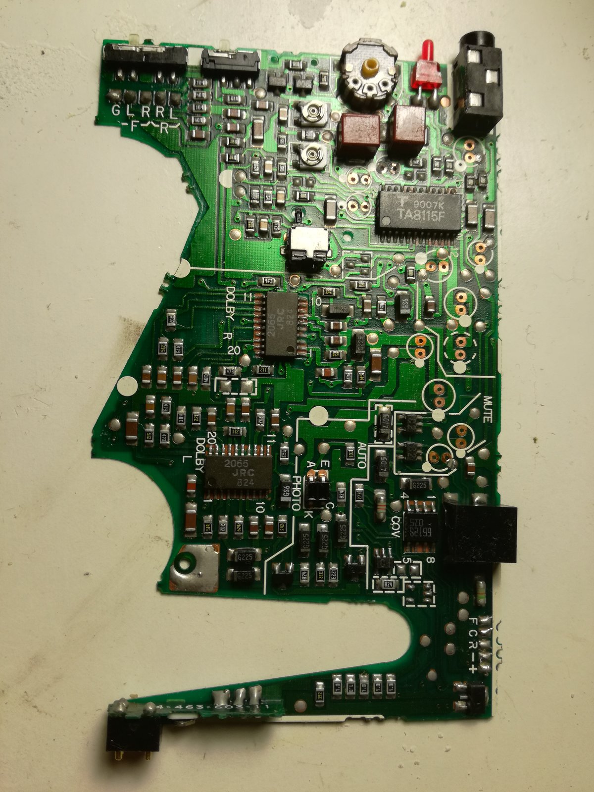

    I drew a not so nice diagram of the caps and polarity on the PCB for reference.
    Unsoldered all caps (except the blue one),
    Dunked the PCB in a bowl of water and bicarbonato di sodio.
    Afterwards used a toothbrush, IPA and dry contact cleaner to remove all residue of the sodium.
    Soldered new nichicon capacitors.
    Used toothbrush with IPA to remove flux residue.
    Another spray of contact cleaner.
    Use sewing machine oil on mechanism and gears.
    Resoldered flexboard and cables.
    Did I do something wrong? There is no audio output anymore, not even noise/hiss.
    I tried resoldering the flexboard believing it to have been a cold solder joint, but the problem persists.
  15. bub
    bub Active Member
    265
    Singapore
    Check the position of the muting switch- flip the board over, and manually press both switches with your fingers. Can you hear a hiss?
  16. Command8
    Command8 Active Member
    375
    London
    Could you show where these switches are on my donor PCB?
    If you meant moving around the Dolby and EQ switches while playing, then no, no hiss can be heard, no noise from the headphone out.
    As I couldn't find a PDF service manual of this model.

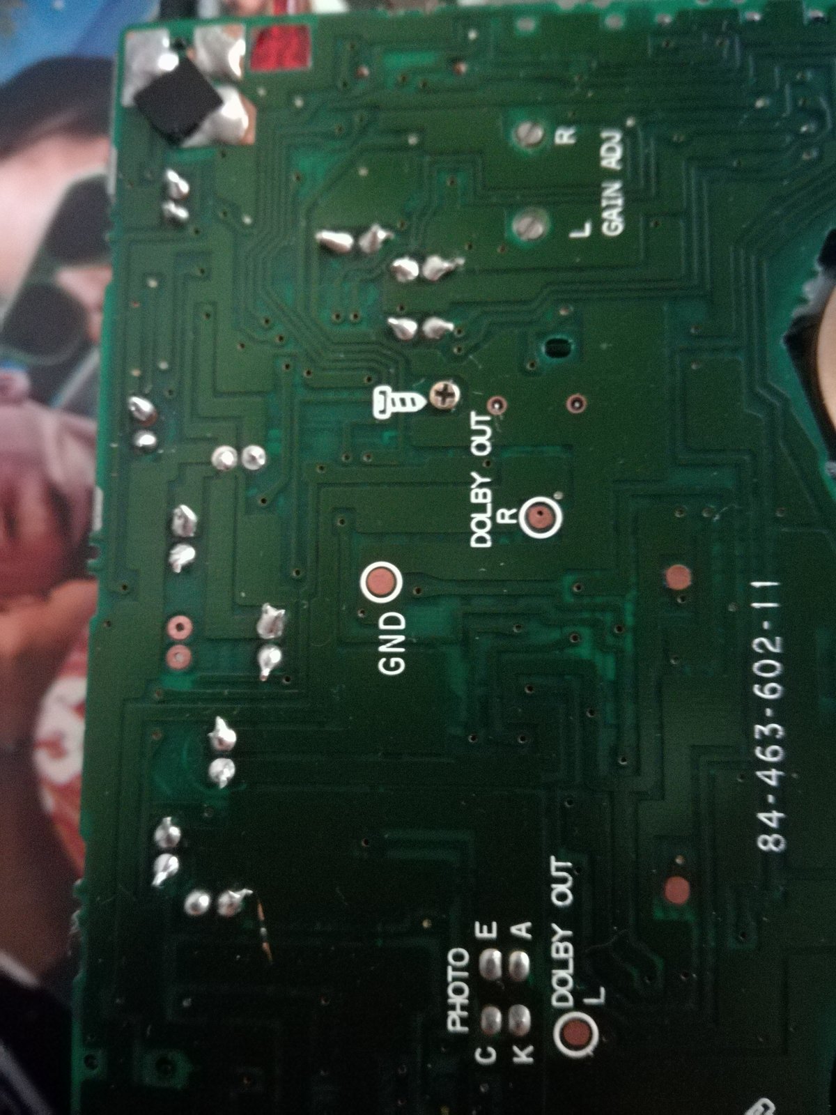

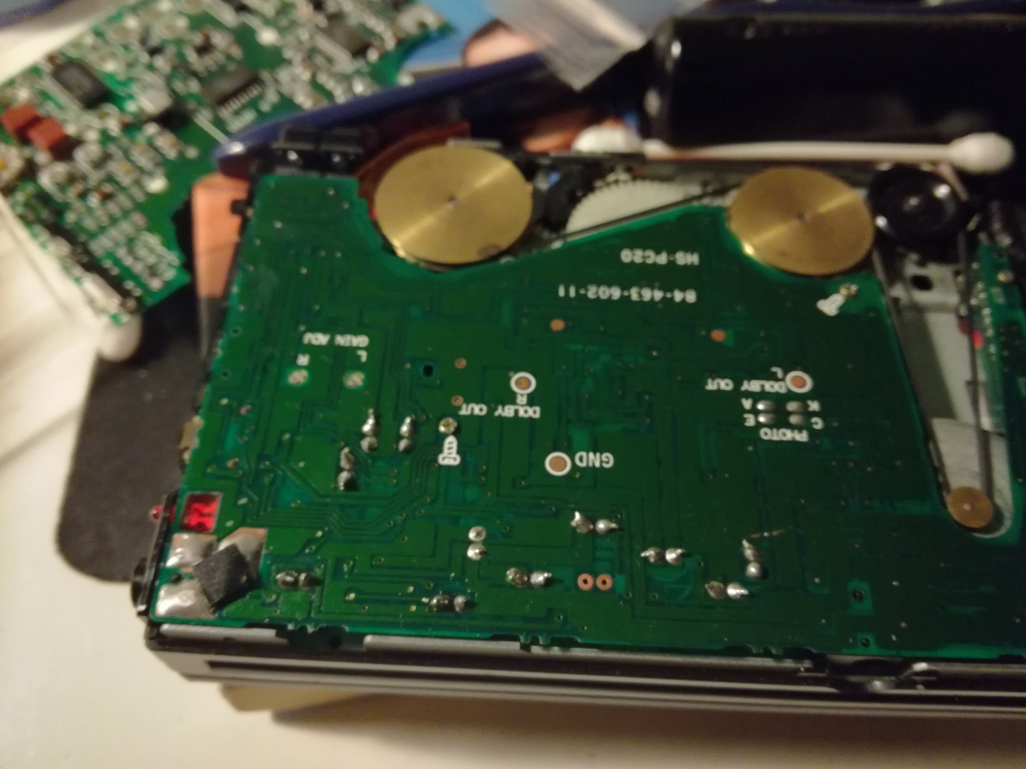

    Ah I forgot this model does not have a mute switch. Can you take a photo of the board with the new caps?
  18. Command8
    375
    London
    Of course:
  19. bub
    bub Active Member
    265
    Singapore
    I do not see any major issues. This might be either really easy for tough...
    Try the following first:
    1. Does slightly bending/flexing the board at various points bring the sound back? Bad Solder Joint
    2. Check for shorts on the legs of the new caps installed, and check continuity to their traces.
    3. Check the resistance on the vol pot, it should change when you turn the pot (rule out open pot due to washing)
    4. Look at the board under a magnifying glass/usb microscope. Look for bad traces, shorts caused by solder splatter, cold joints
  20. Command8
