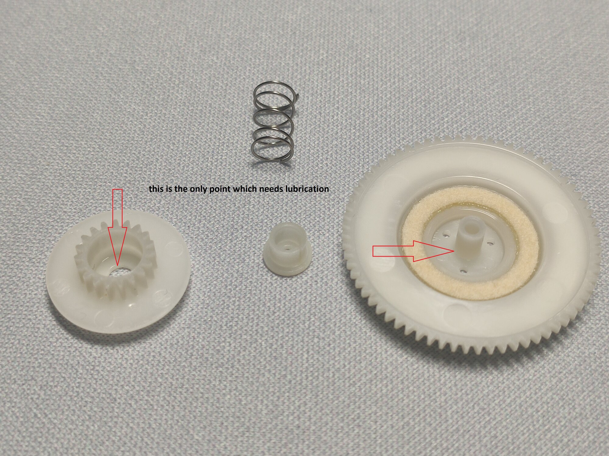

    6. Disassemble the clutch and thoroughly clean all the grease that is inside.
    7. Add oil or grease to the point of friction indicated on the picture. Assemble the 2 parts of the clutch together.

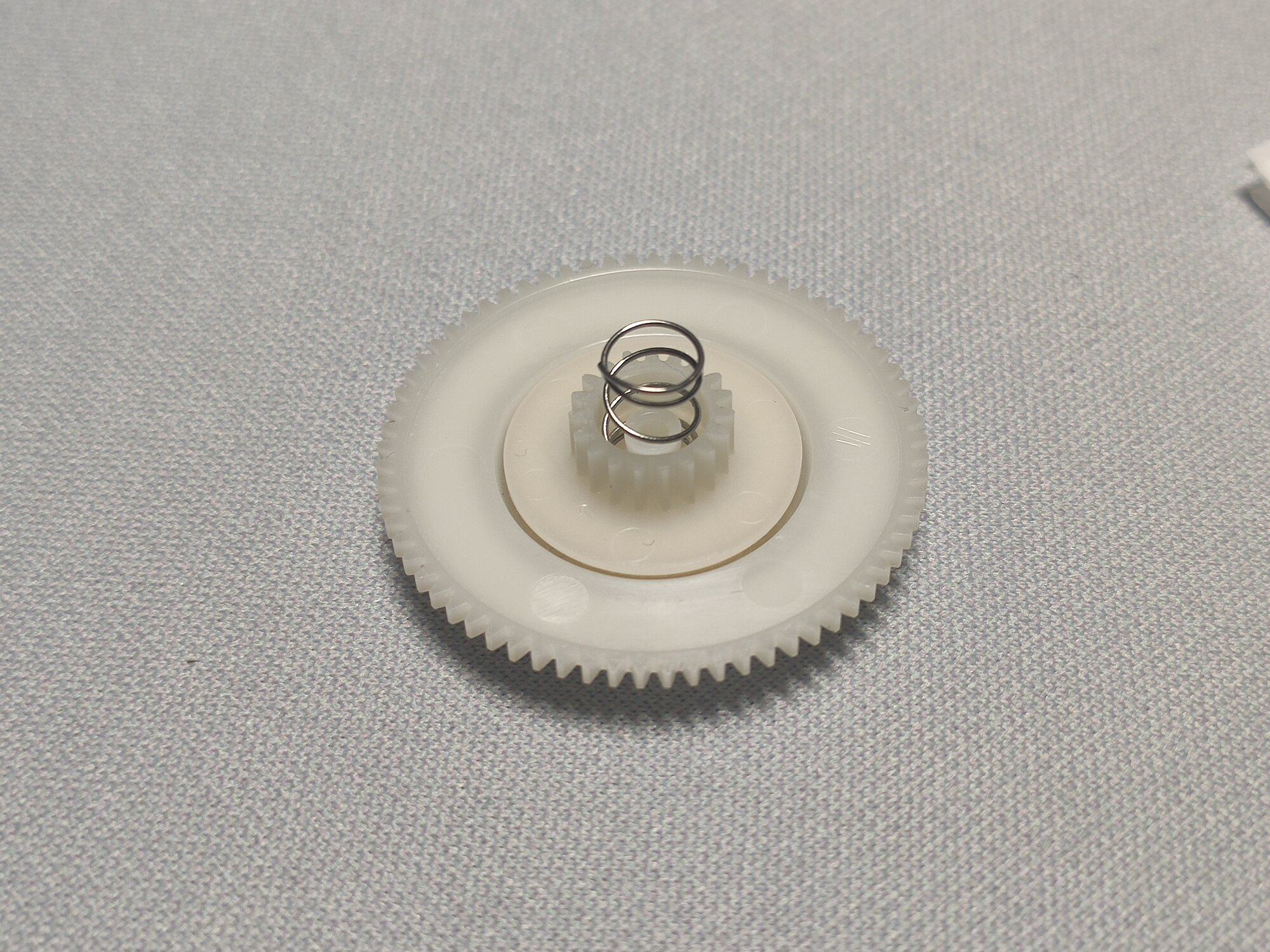

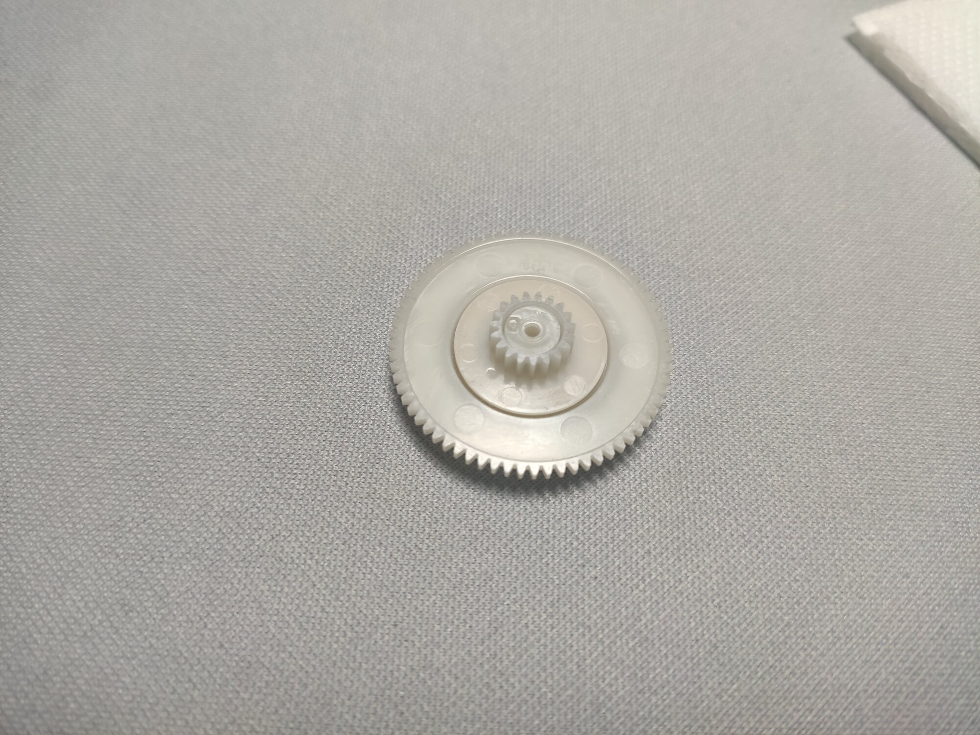

    8. Add oil or grease to the bottom of the spring and install the spring. Clean any excess lubricant which may be present on the retainer mounting point.

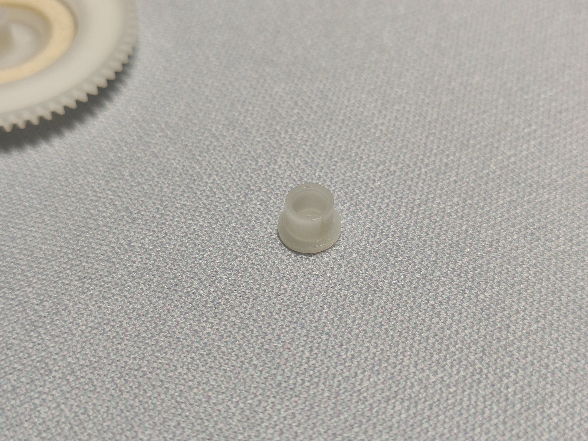

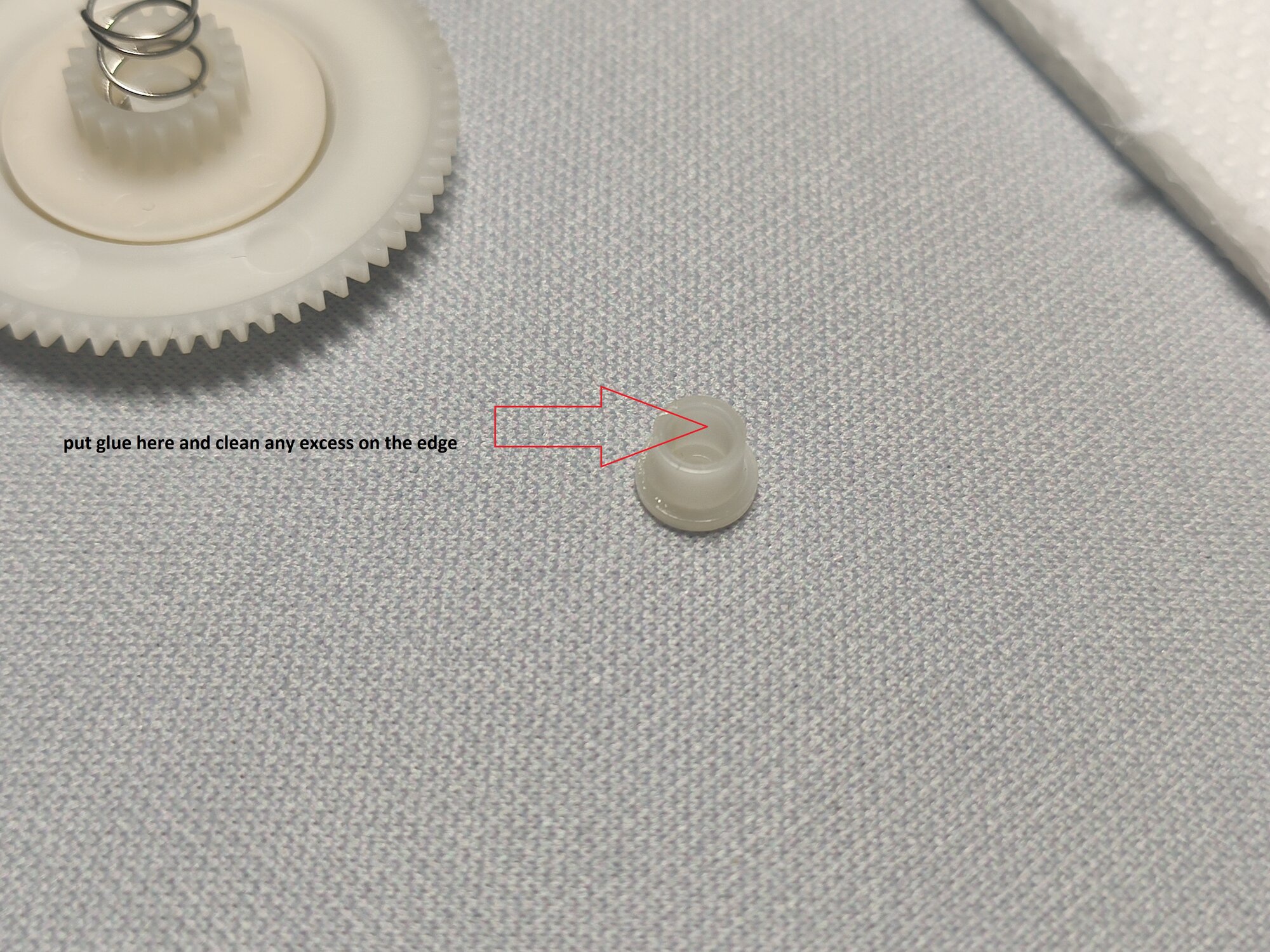

    9. Add super glue inside the retainer as shown in picture and install the retainer back.
