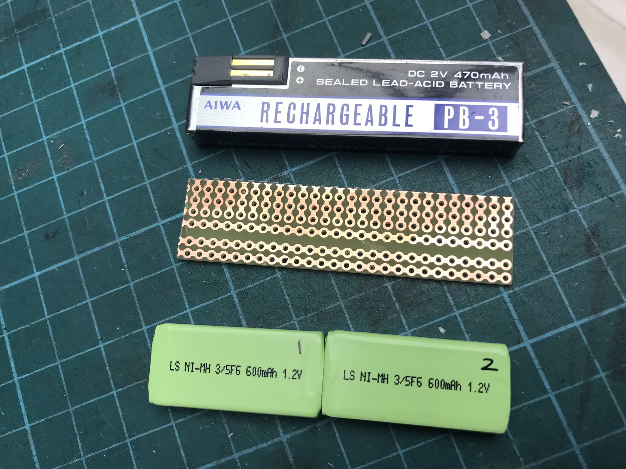

    As we all know, the Aiwa Sealed Lead Acid Batteries are no longer usable today. However, some of us don't have the AAA battery adapter, or just prefer the look of the machine without the adapter.
    This is a Tutorial on building a simple, reliable alternative (specifically for a PB3, but as long as the 2 half height Gumsticks are smaller than the original Lead Acid, you can modify it to work).
    I have been using this adapter for the past few months in one of my P202. This was inspired by a thread on Old Stereo2go where someone made a similar battery holder.
    You'll need:
    Basic Soldering Supplies/Equipment
    Veroboard/Stripboard with at least 2 horizontal rails
    Copper Sheet, .5mm thick
    2X Half Height Gumsticks, Size 5F6
    Smart Gumstick Charger (Or Smart Nimh Charger)
    Copper Wire

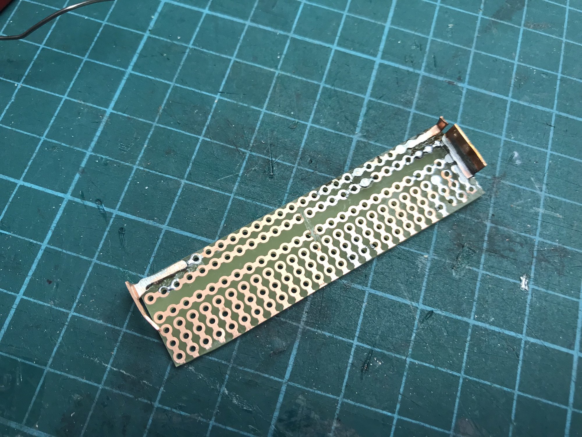

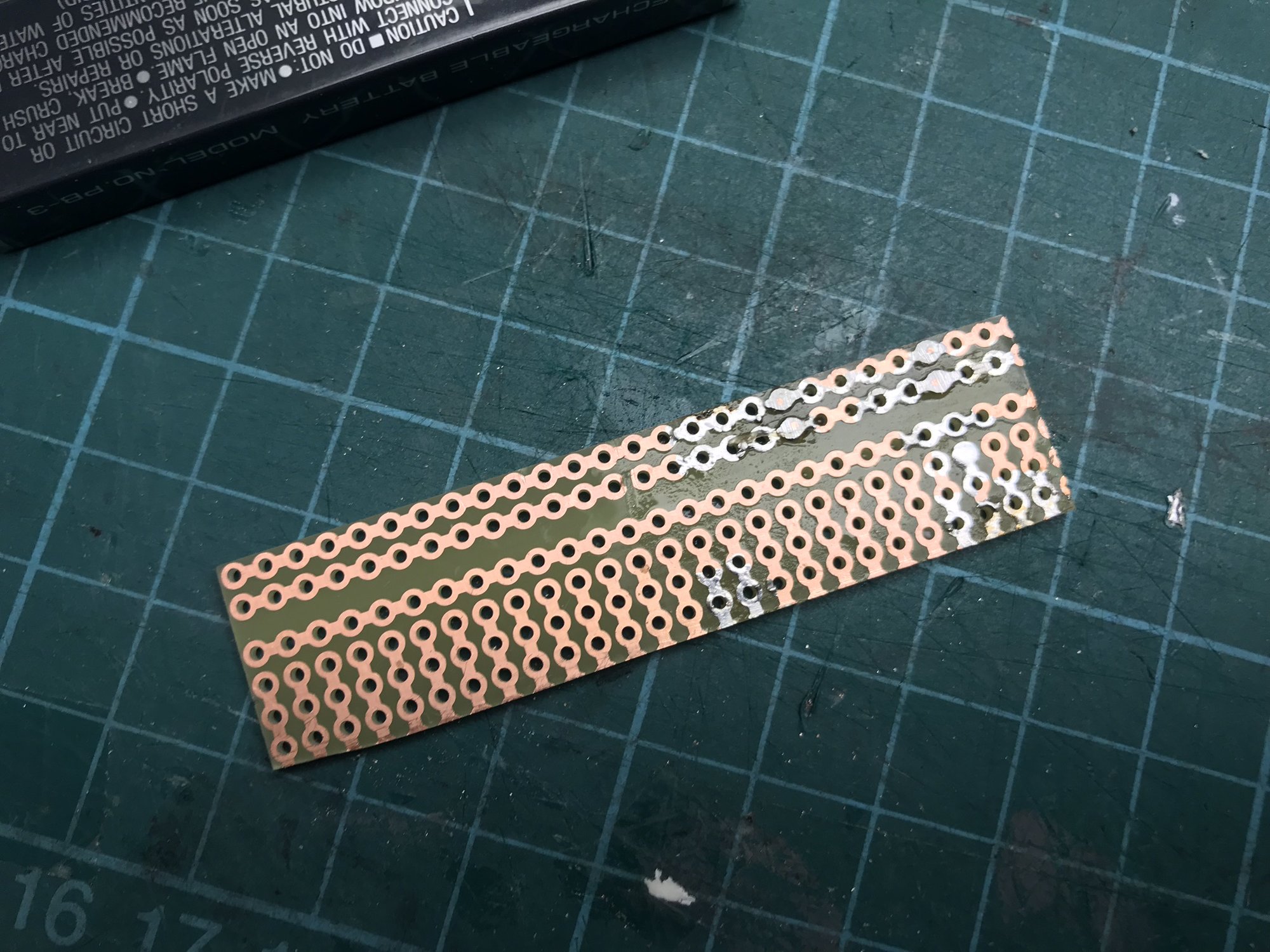

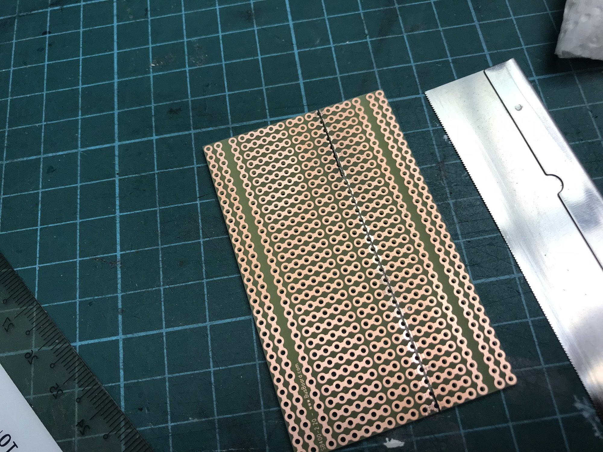

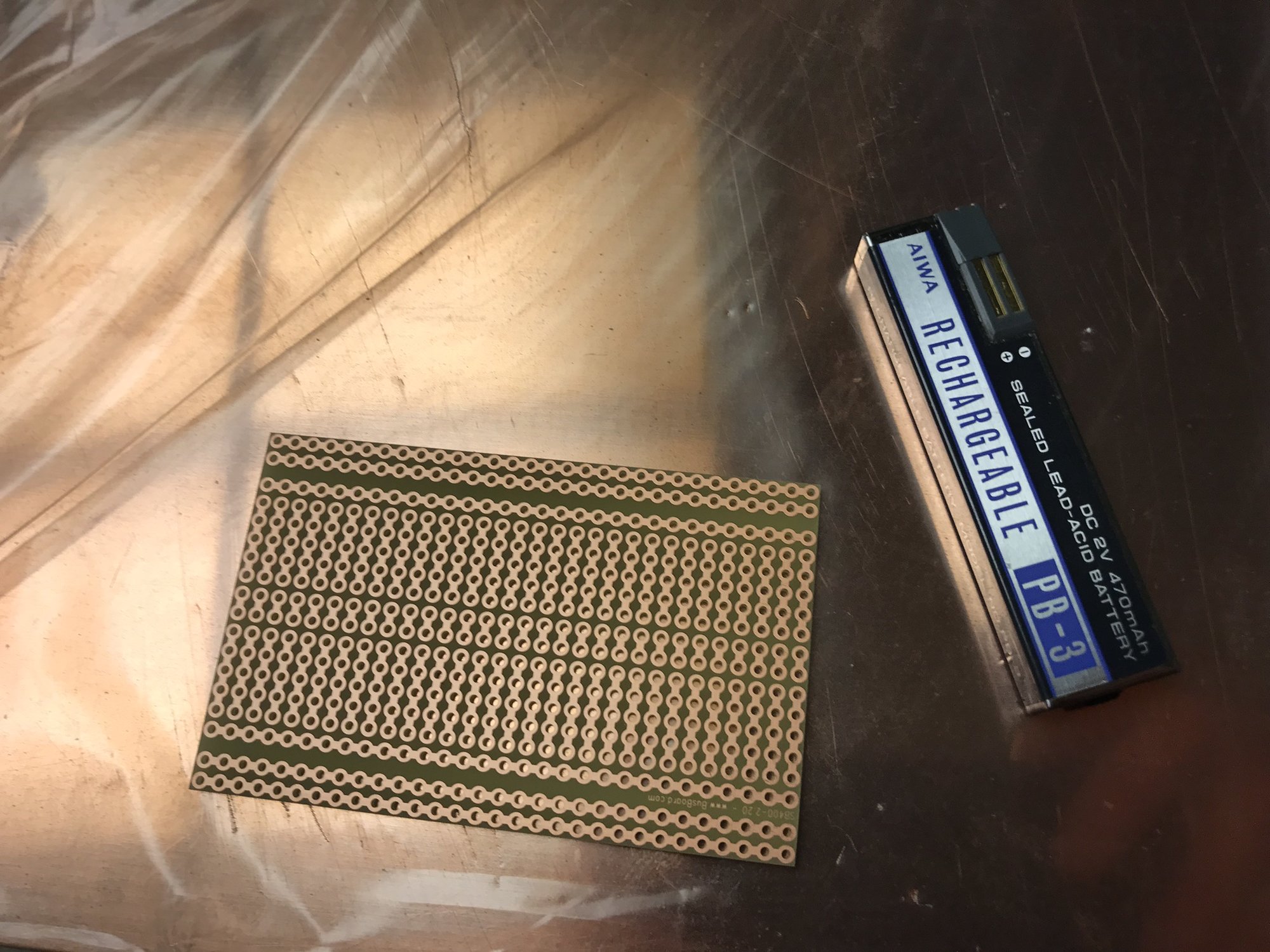

    The first step is to cut your Stripboard to the same size as the original battery. I used a PE Saw, but a rotatory tool like a Dremel will work too. Ensure that you have at least 2 power rails of your Stripboard at the edge where the connectors will be. Mark out this area on the component side of the Stripboard.
    Mark out the shape of the battery and Saw/Cut, or score and snap like I did.
    CAUTION: Do not inhale PCB Dust! Wear a mask if using a Dremel, and clean all the dust up immediately!

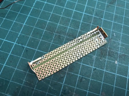

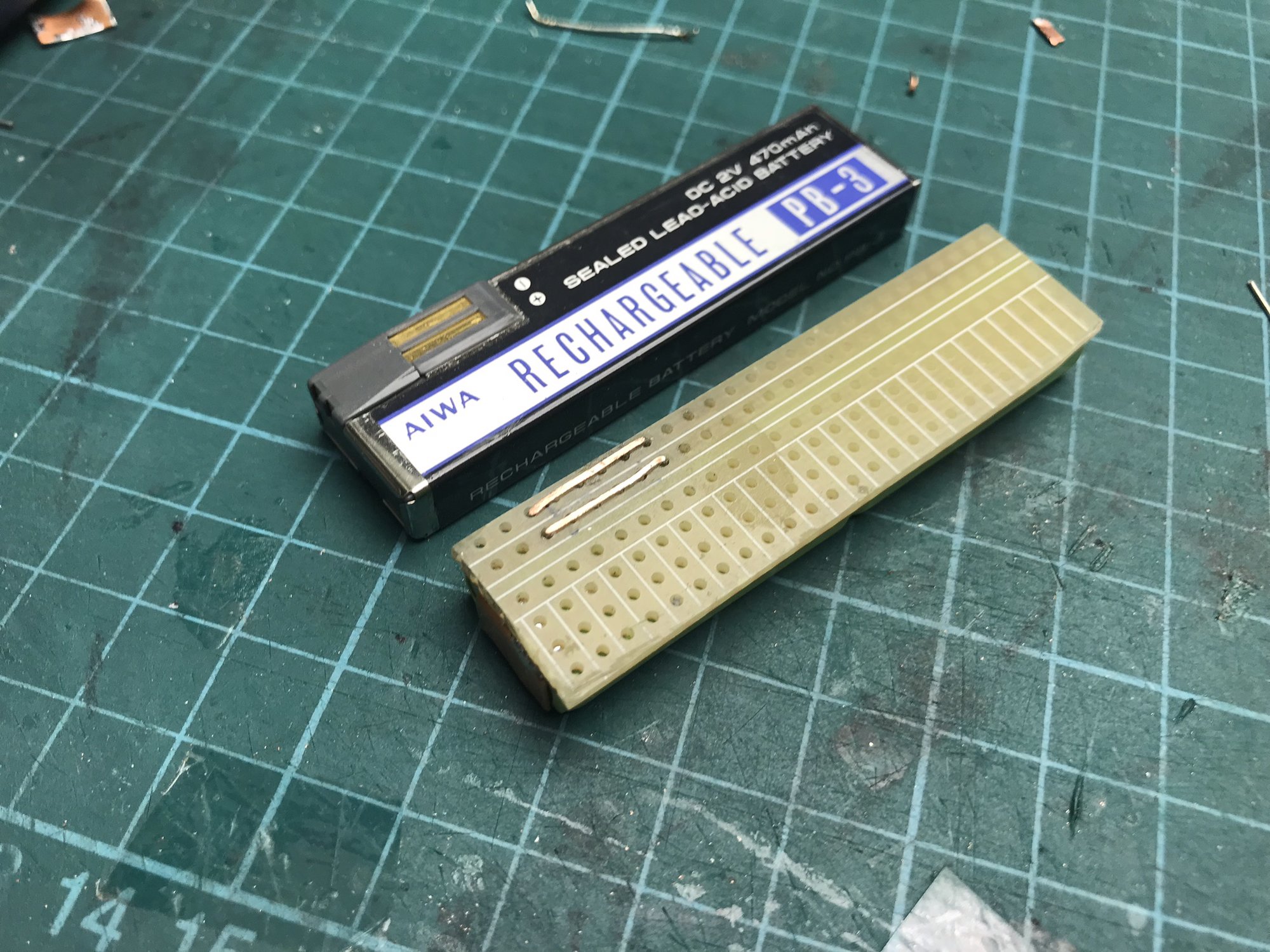

    Next step is to add Copper Wire to the contact area, and solder to the power rails on the other side. Then file down both sides until they are reasonably flat.

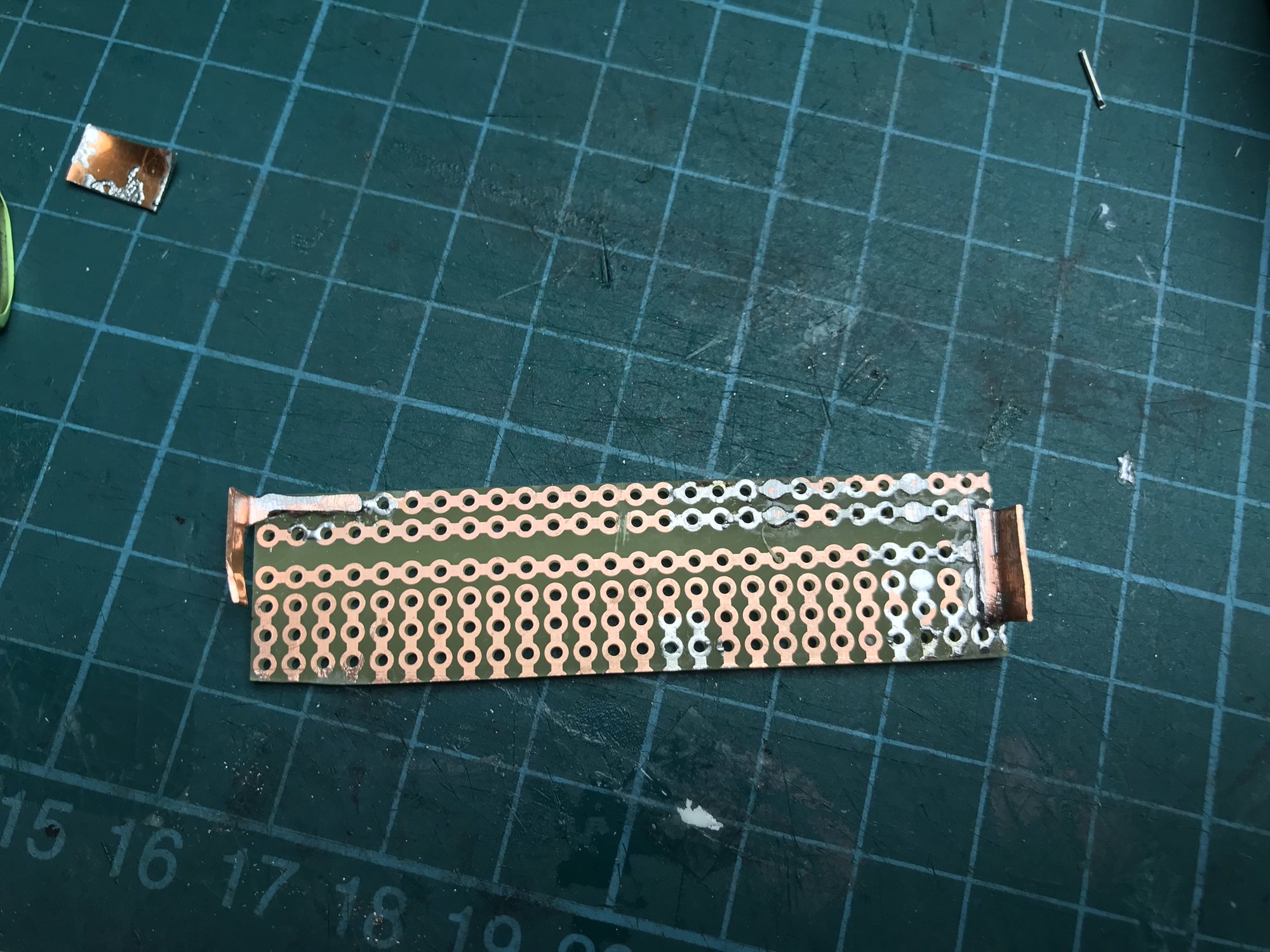

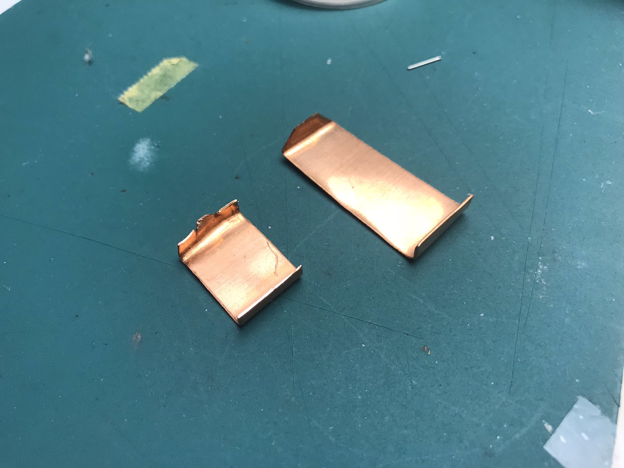

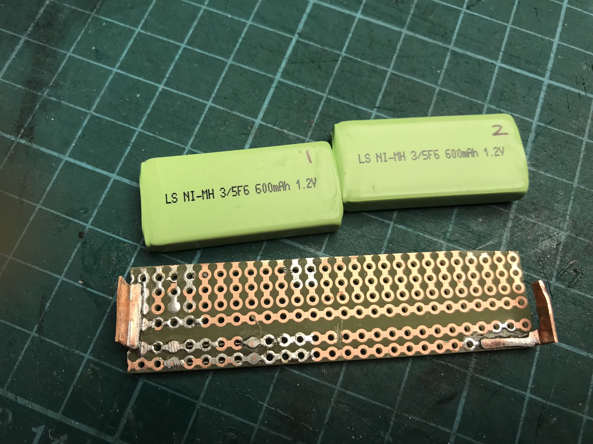

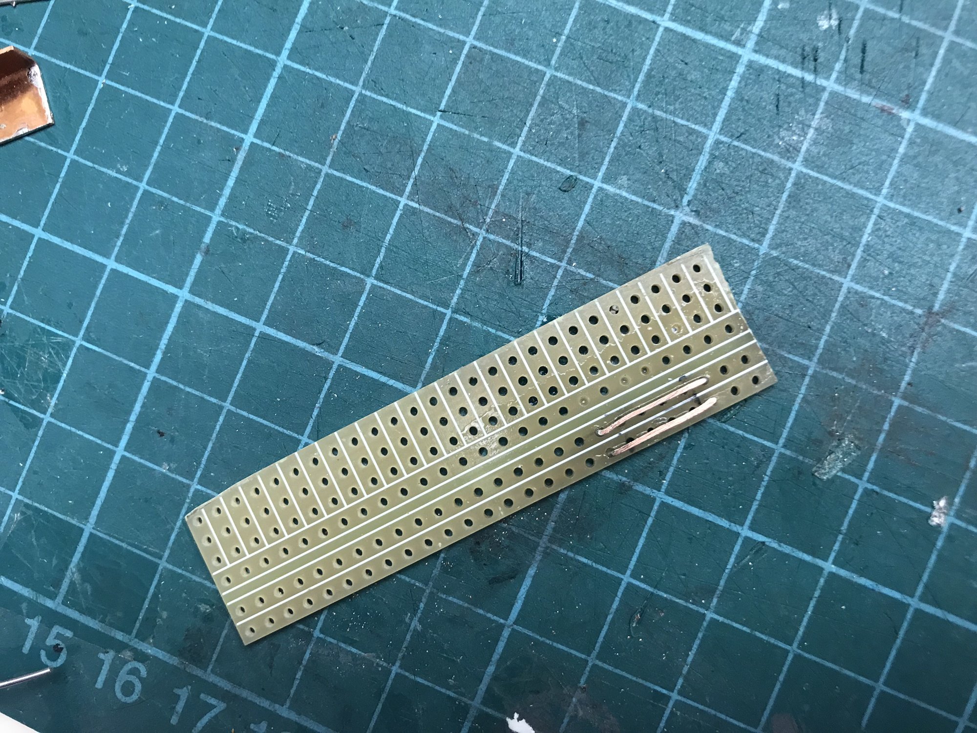

    Next, cut and bend some Copper sheet to make battery contacts for the Gumsticks.
    As the Stripboard has 2 power rails, with Negative on the outer rail, We can solder the copper as shown:
    The Positive Contact is soldered to the inner rail, and the Negative Contact is shaped so that it only touches the outer rail. A small bend is added to the Negative Contact so that it acts as a spring for the Gumsticks.

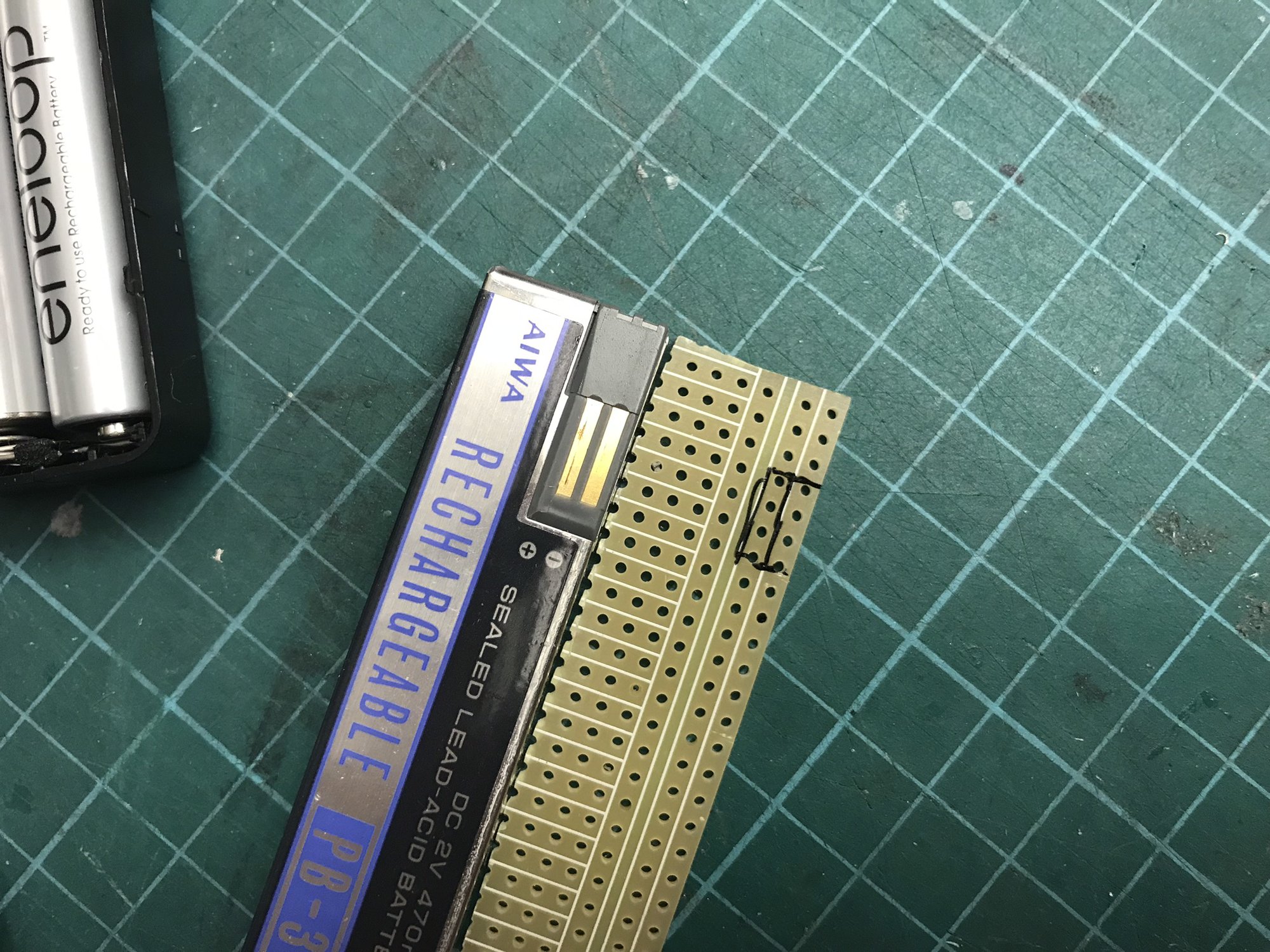

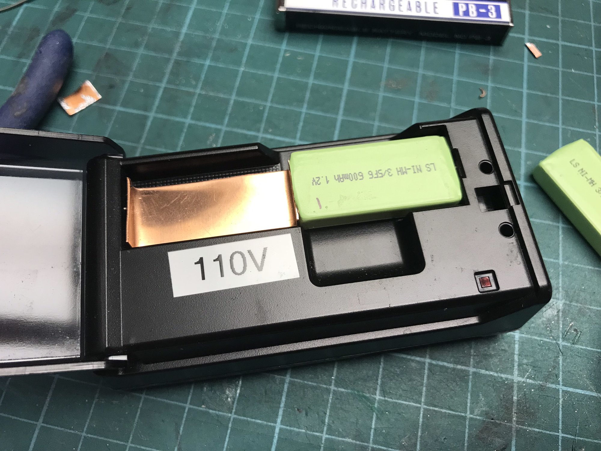

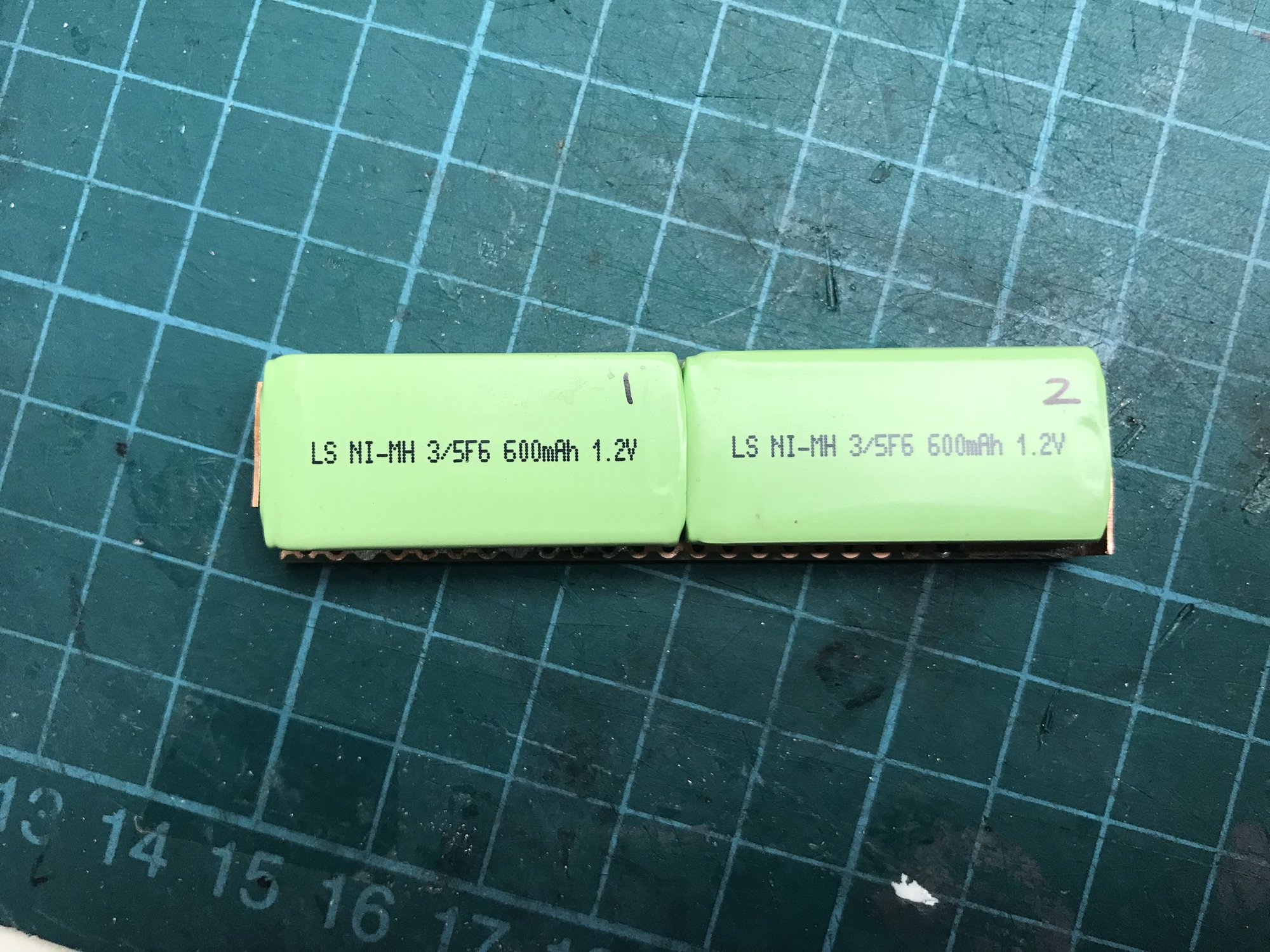

    Test the fitment:
    You may need to modify the size of the contacts/PCB to fit in the Adapter/Walkman smoothly. I also filed the Contacts so that they are thinner at the PCB, as thickness cannot be exceeded.

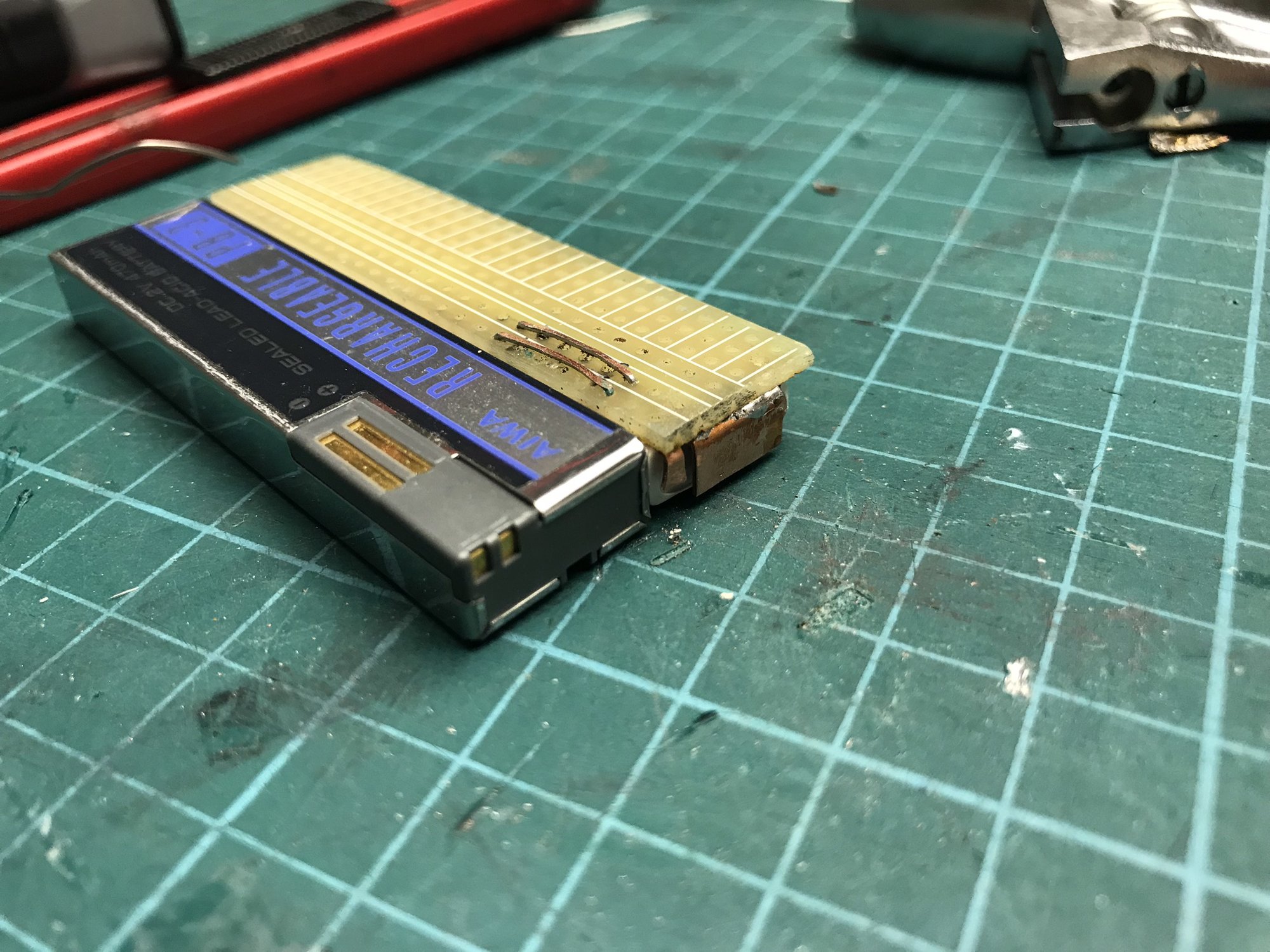

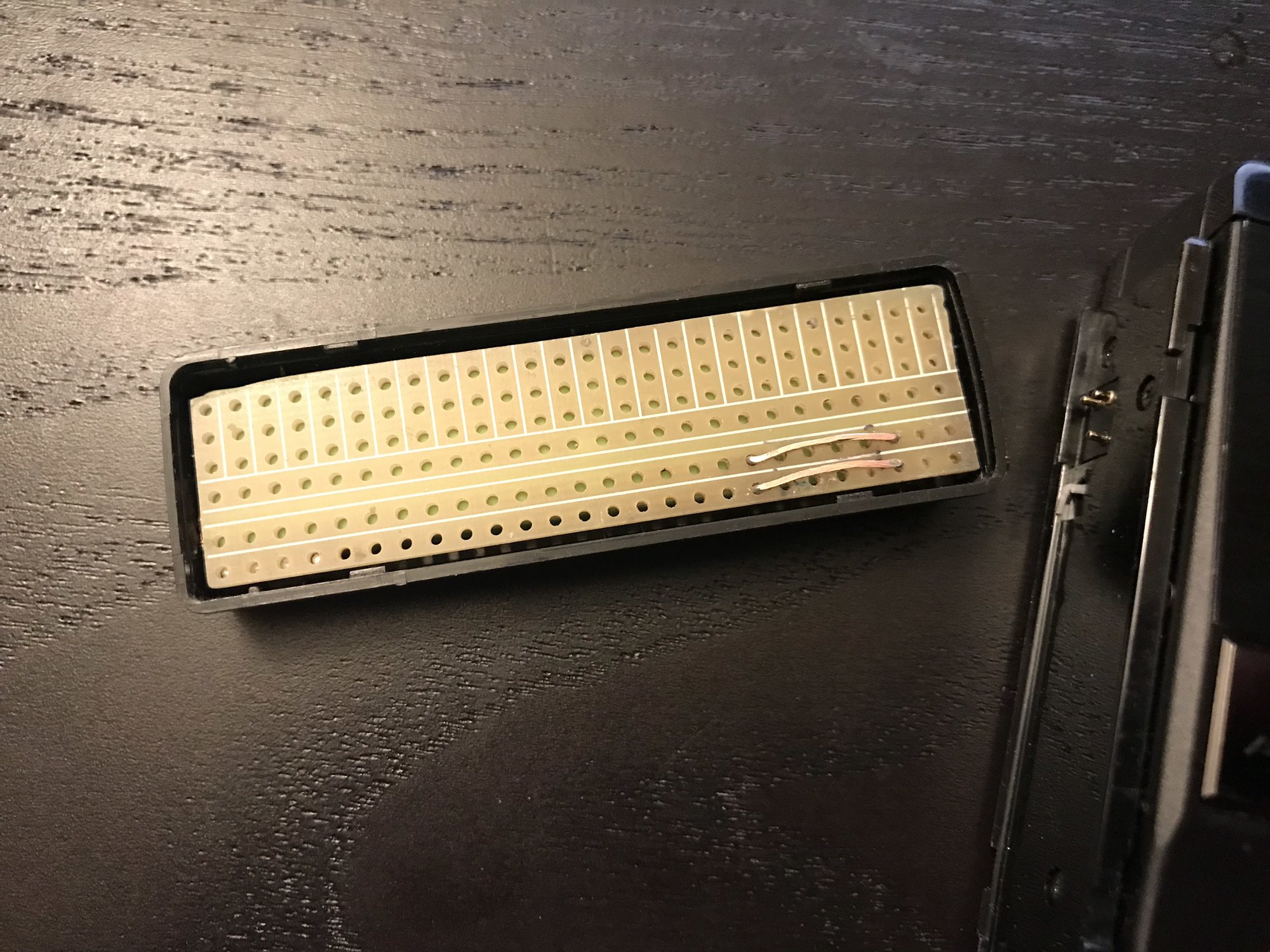

    Next I add 1 more contact for the Vertical Negative Contact of the PB3 as shown:
    I also moved the Positive Contact closer to the Negative, as the earlier attempt was too far away.
    This is why we use a Stripboard with 2 outer power rails , it makes this step easy.
    Adjust the Copper Wire on the top to make the best contact, and epoxy it in place, filling some of the PCB holes underneath the wire. This is to prevent the contacts on the Walkman Body getting trapped.

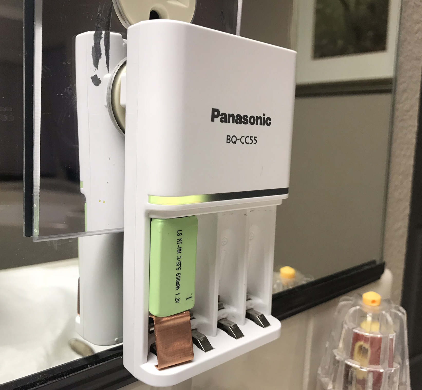

    As for how to charge these tiny Gumsticks, I made a jig out of the copper sheet to use with my Gumstick Charger, or AA Nimh Charger. Smart charger is required to sense when the 600mah Gumstick is full. If you are using a Timer Gumstick Charger, halve the charge time.
