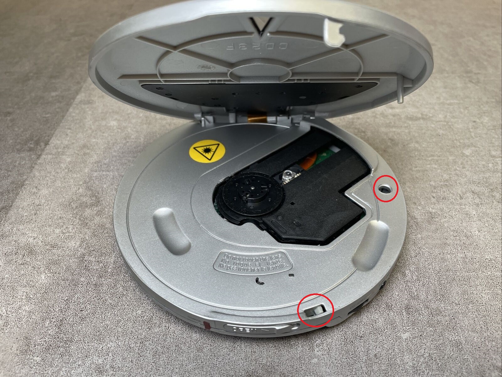

  8. Valentin
    1,956
    Unfortunately, in order to get a direction for the repair you need to check those things.
    From what I see this player is a late generation one, so problems like old grease, button oxidation are less likely.
    See picture attached for button location, it's most likely the one on the right.
