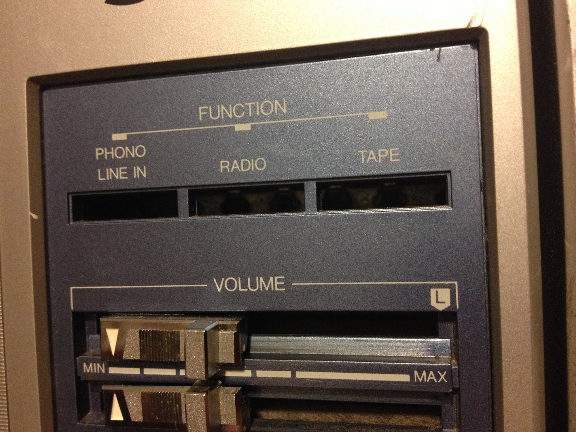

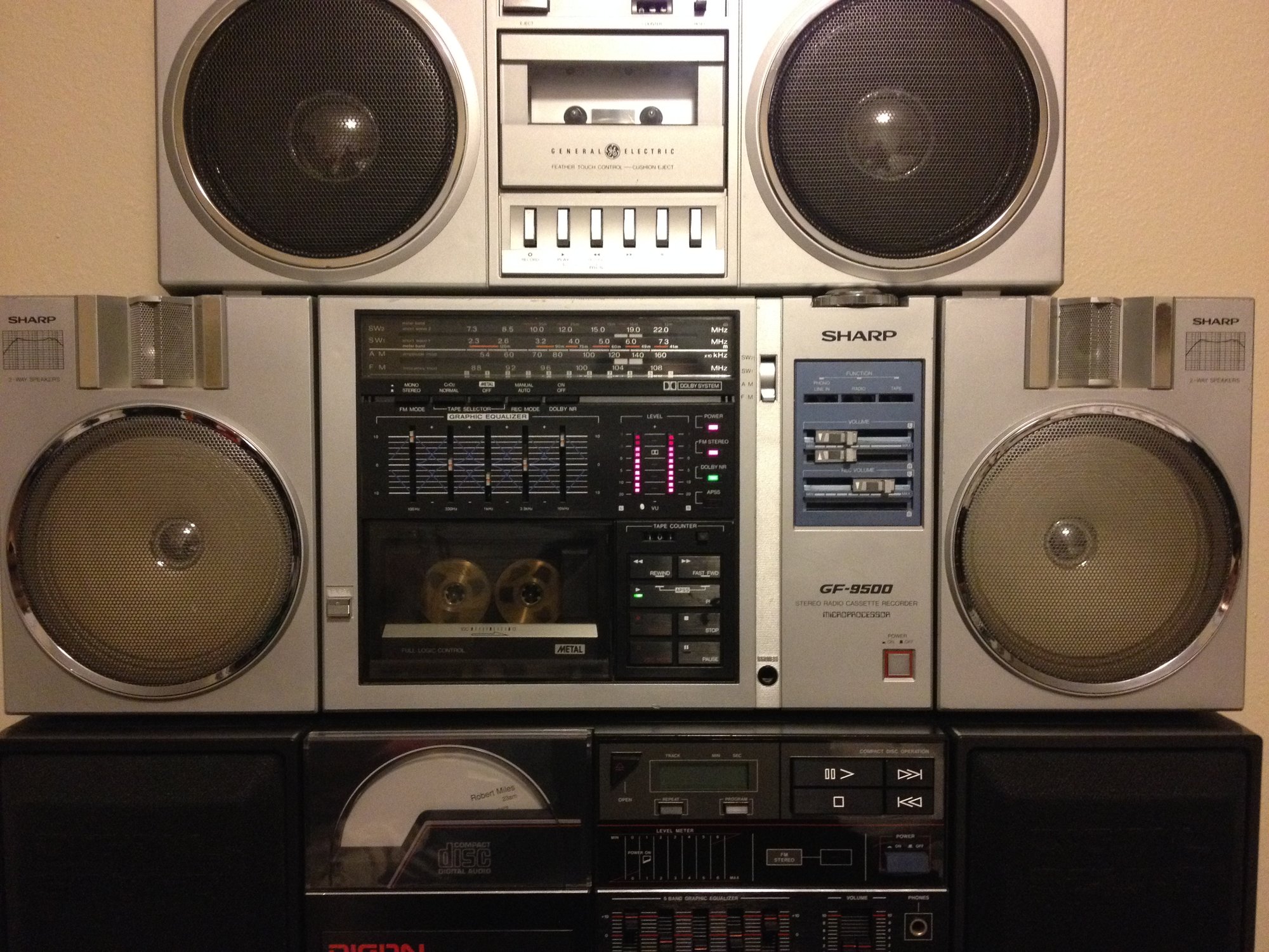

    Just got this Very rare Sharp GF 9500 on the inter web and when I received it, it had one speaker completely busted out out place in the speaker box, the main unit took some serious damage, too, as the three function switch buttons were severed off from the mini plunger switches inside the unit. The power circuit board was broke in two as well. I fixed the power board, superglued the speaker screw mounts back in place, and can at least listen to the tuner on it. An unfortunate ordeal nonetheless. image.jpeg image.jpeg

    That is a rare Boombox looks nice too I just can never get over the things that happen to these radios during shipping it's a crime to destroy something that made it this long just to get bashed up by a dumb mother f**** .

    Glad you could somewhat fix it but still, sucks. How did you fix the circuit board that was broken in two? Run jumper wires to all the traces?
  4. 2channelhero
    2channelhero Active Member
    87
    33
    Eugene, OR USA
