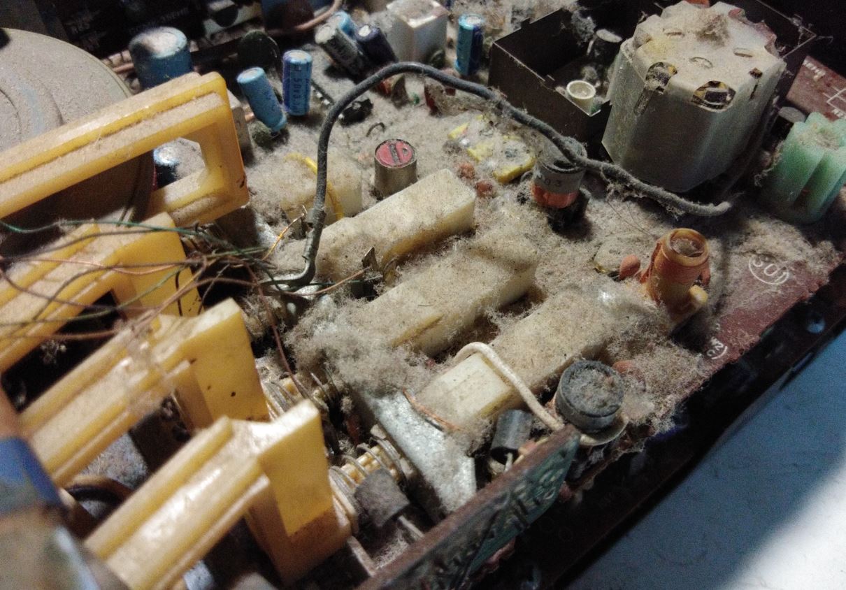

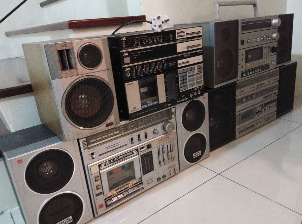

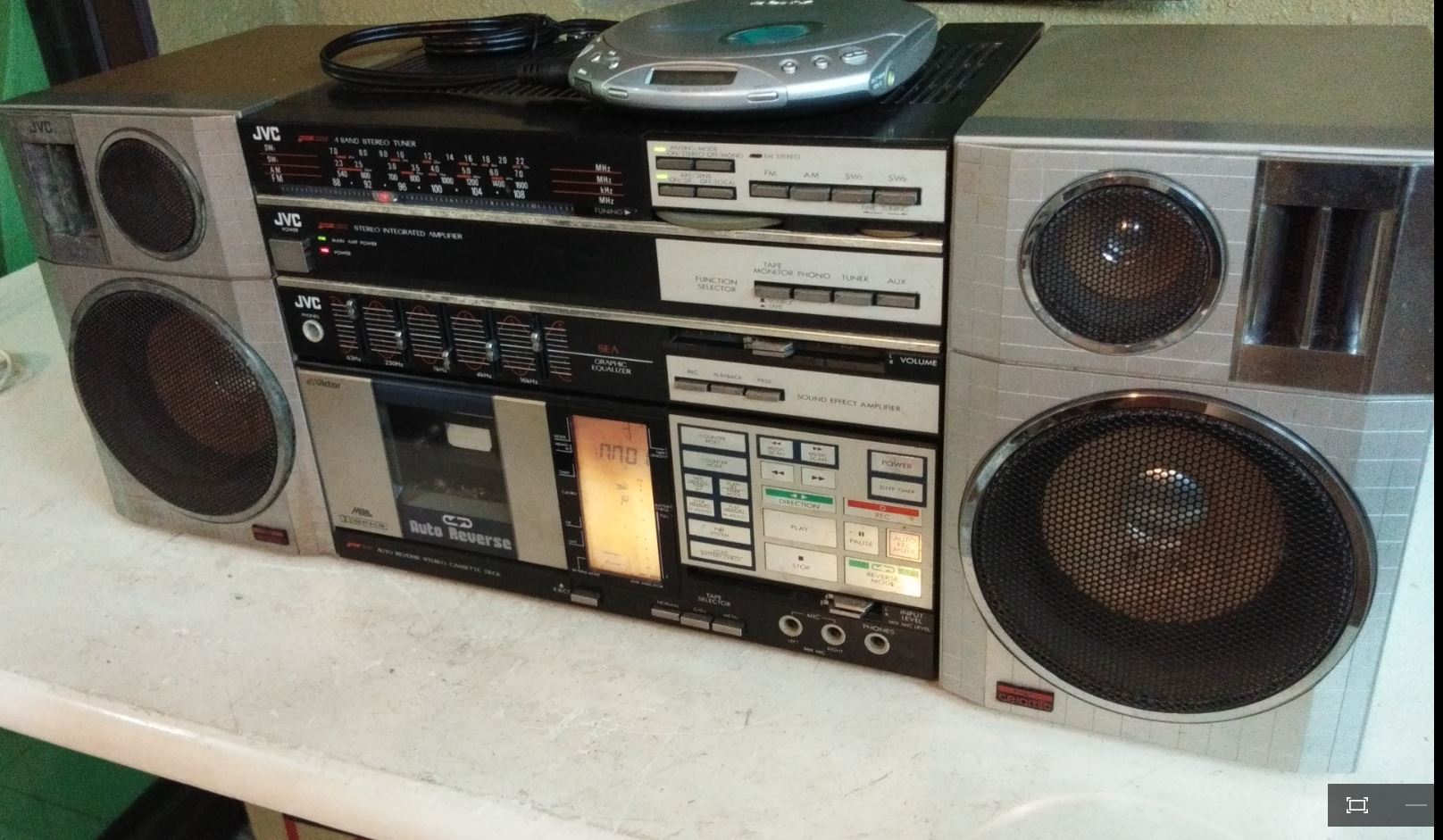

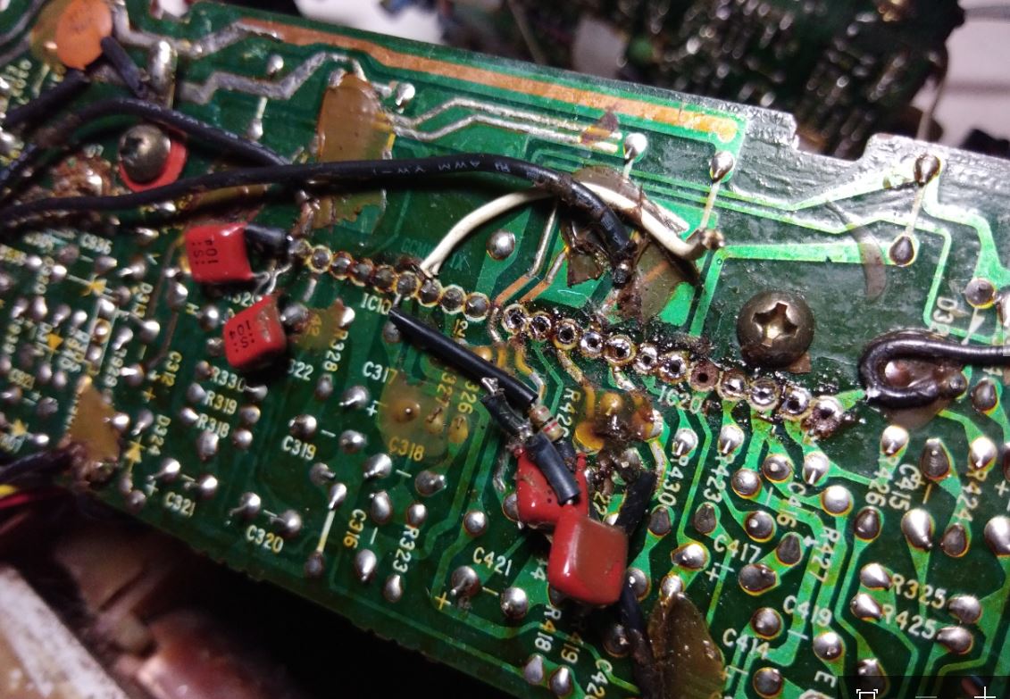

    My house has turned into a boombox repair shop just because of one favor offered!. Our stereo2go member, Mr. Iskandar just can't stop sending me his boomboxes for fixing after I help to restored one of his beloved model JVC PC55 . My lady boss already sounded.. its a matter of time either the boombox or myself will be thrown out of the house.
    Nevertheless, its my pleasure to share with you one of Iskandar recent purchase PC 55 black version but only the main unit without speakers. This unit took me much effort to fix due to its run down condition, switching power supply not working and right side channel no output. The sound is soft and garbled, volume switch crackle and other teething problems. First I need to dust off and contact cleaned all the switches, push buttons, volume pots prior working on the real issues.

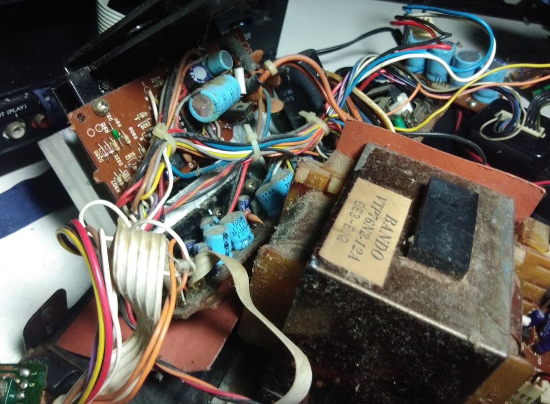

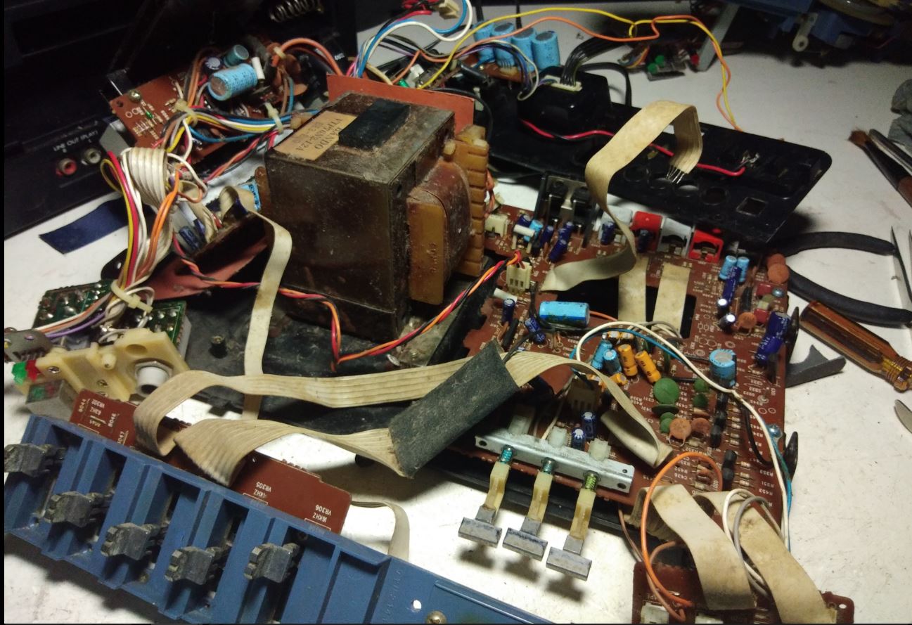

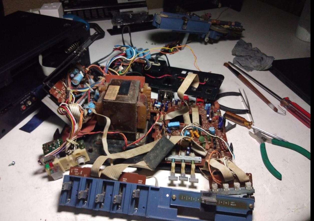

    In order to troubleshoot the problems effectively, I have to teardown the unit up to circuit board level.

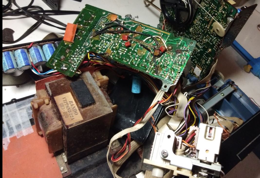

    Checking on the power amp IC and re-solder every single pins due to dry solder for both the switching power supply and the power amp IC.

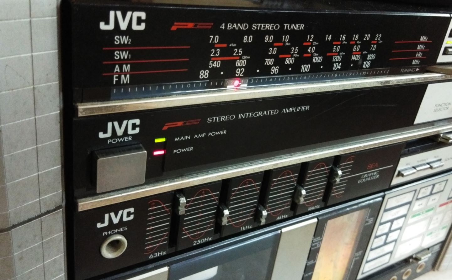

    Finally it's all done, the sound is now at its optimum level powerful and kicking!

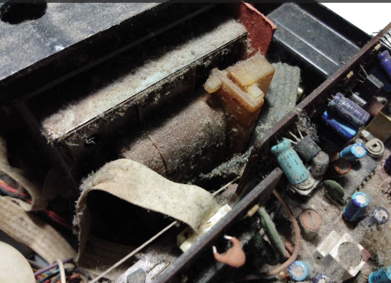

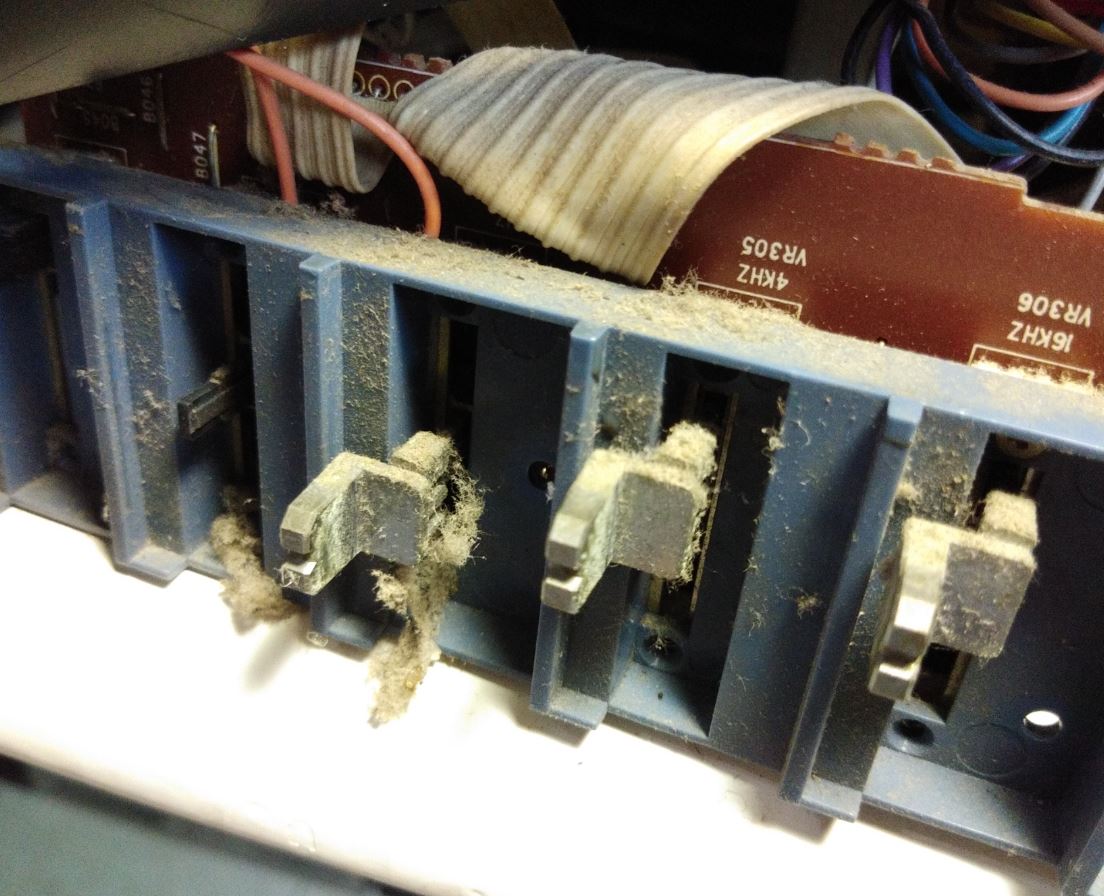

    I forgot to emphasize.. . "Not For Faint Hearted- Warning Graphic Content! ... Lol!
    19,115
    I can't believe how dirty that is, I posted that Pioneer RTR that was similar but they have huge vents on the back, I feel like it was growing in yours. Great work getting it back up and going, thanks for the photos.
