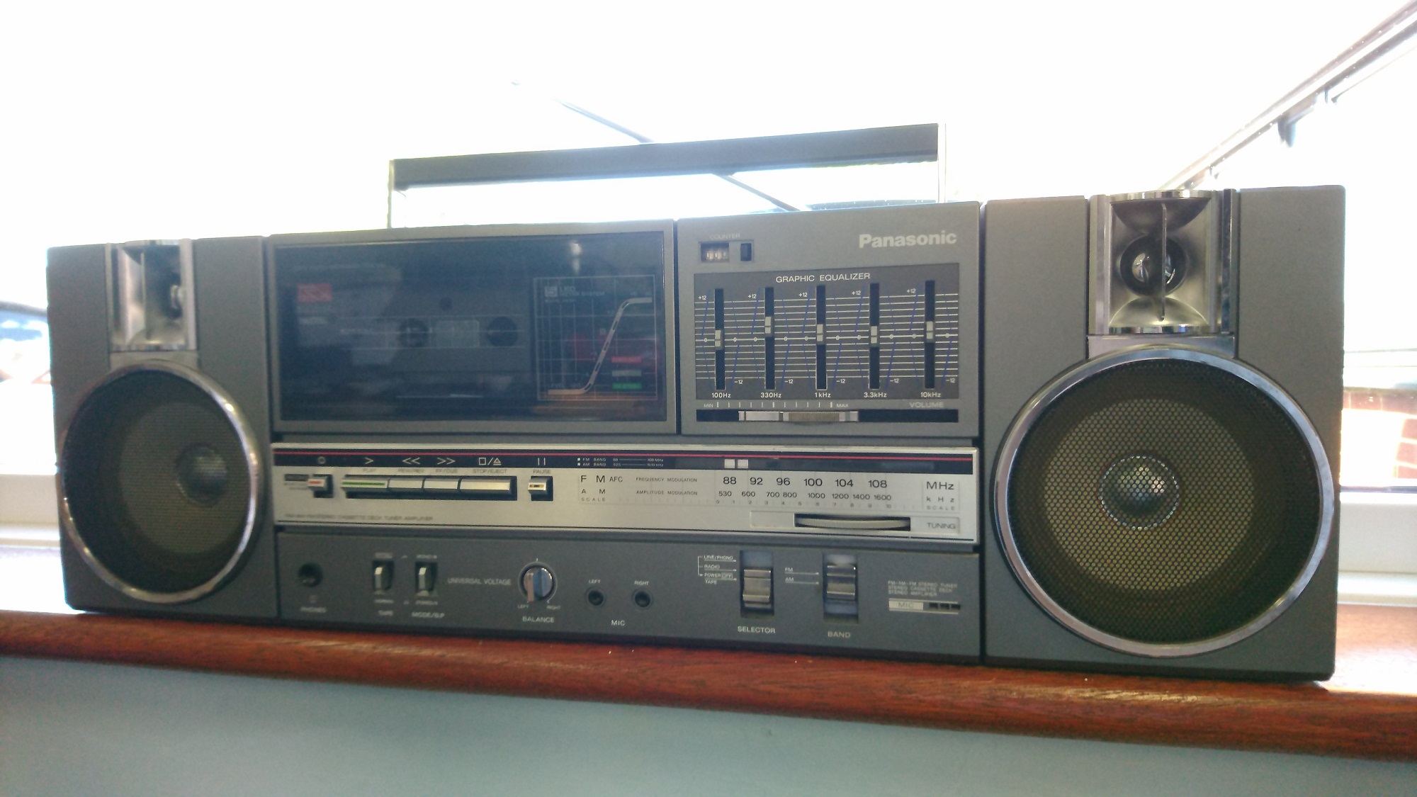

    And now... live... from Galveston, performing in the UK thanks to an international voltage selector... Ladies and Gentlemen... give it up for.... C3-P... oh sorry... RX-C45 ... yeaahhhhh..... 20180517_133532.jpg
  10. T-ster
    1,481
    Boom! Working ok?
  11. Michelle Knight
    Michelle Knight Active Member
    414
    Sussex, UK
    Yup, once I altered the voltage selector. Only tested the radio so far.

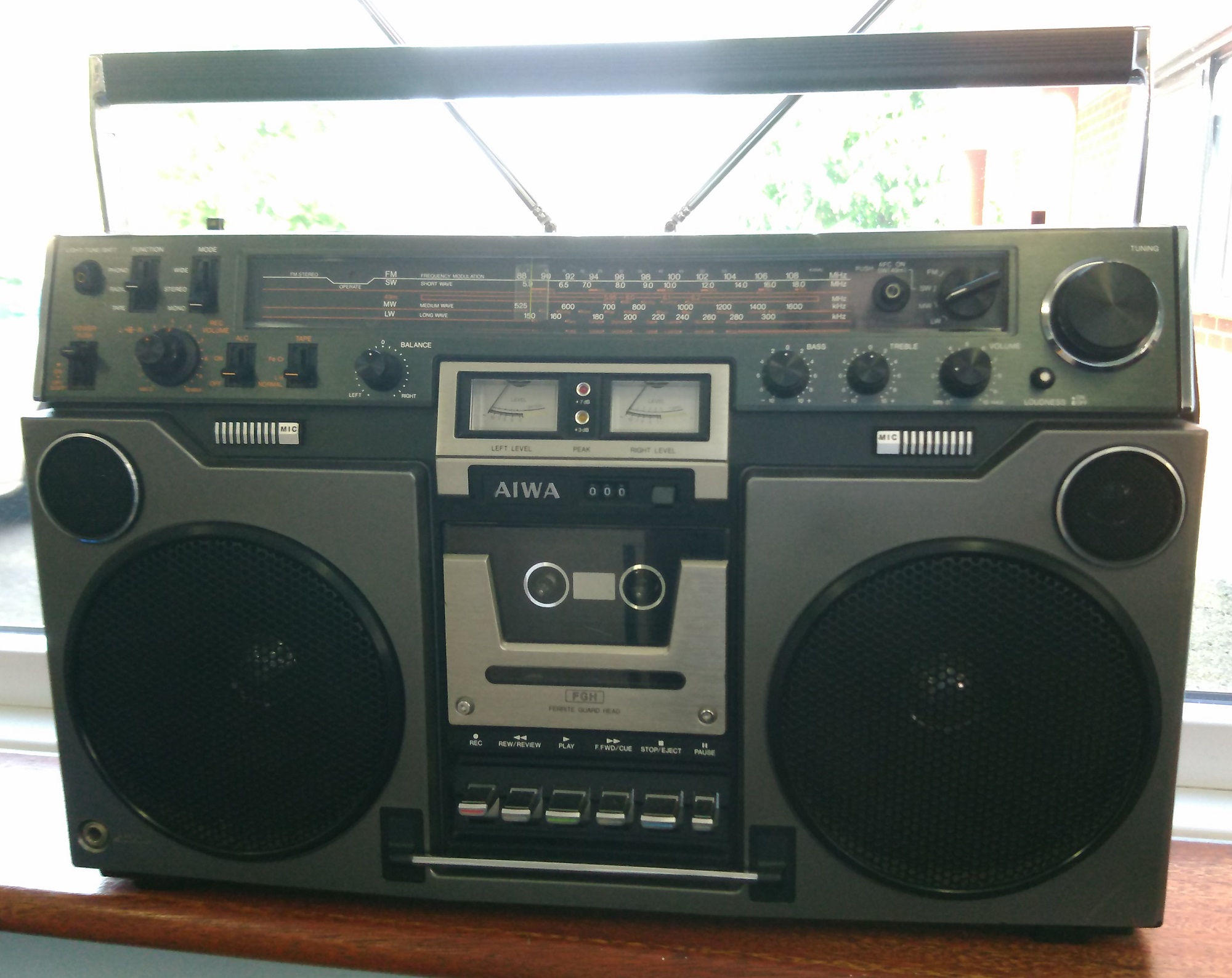

    All hail the mighty Aiwa... I definitely don't want to drop this on my foot.
  14. Michelle Knight
    414
    Sussex, UK
    It is a nice beast, sure. The radio isn't catching on the channels properly, so I suspect that the radio side needs recapping. Also, the rewind on the tape is a bit weak, so that's either a belt issue or perhaps something else. That'll require investigation.
    The Aiwa is also having a radio issue. Reported on ebay as FM not working, but I got the slightest, fraction of a second out of it, before it immediately faded away, so I suspect a cap problem rather than an IC. Haven't tried the tape yet as I'm still at work. Likely approach to this will be to replace all caps and see where I go from there.
