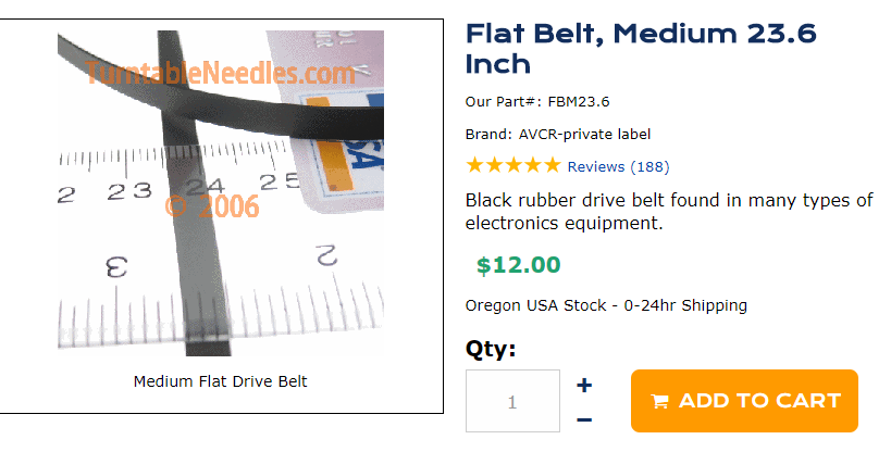

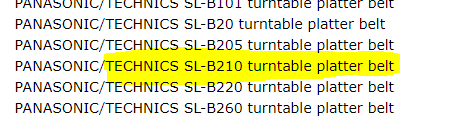

    So a friend of mine found a turntable being thrown out by his neighbour and asked if he could have it. After he got it home he found the belt was missing. He's asked me to replace it but i'm no expert on turntables so need to know the correct size. The turntable is a Technics SL B210. After some research I think its a 23-24 inch diameter belt. Anyone know the exact size and best place to get one?

    Vinyl Engine lists it as part number SFGBZ15R01
    19,118
    That's a nice little Technics, they pretty much cornered the market with their very good looking plastic models of the late 70's. We have a ton of supply stores over here but I don't know if they ship to Australia, a good one is a local shop called the Needle Doctor https://www.needledoctor.com/analog/analog-components/turntables Ebay is probably your best place to go.

    @Boodokhan +1!!! If this belt not available from the dealer, go with turntableneedles, avoid eBay sellers.
    I bought extra belts for my Sondek off ebay, they were correct size but I could not adjust correct speed no matter what I did. The belt was just too soft. The ones bought from Linn (at extra few bucks) fixed the problem. Just my two cents of personal experience
    Boodokhan likes this.
    19,118
    I should have said Ebay is your best place if you don't have any access to a reputable source. Yes, there's lots of stories of bad belts from Ebay out there, luckily I have my own stash and have never had to buy one.
