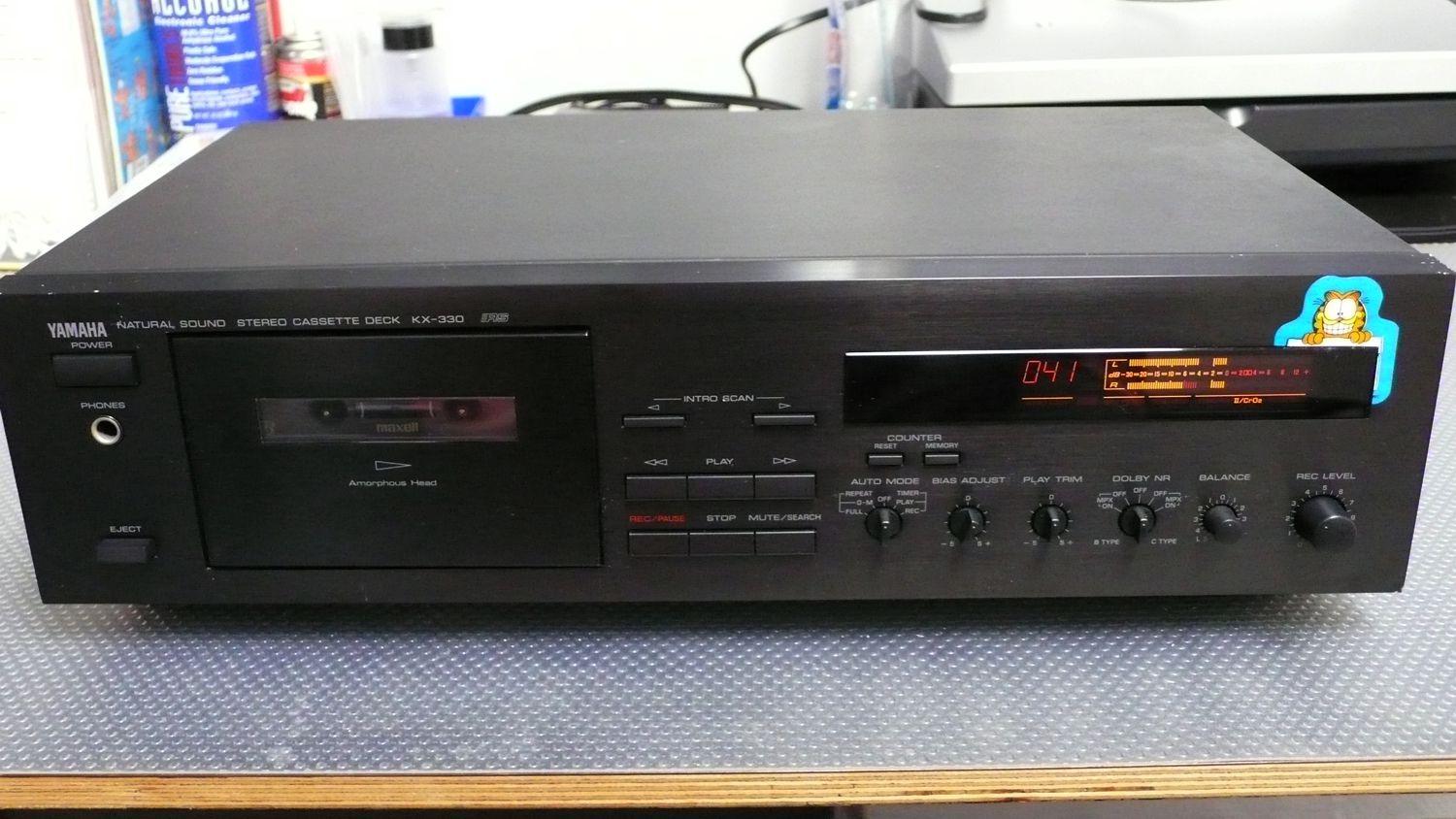

    +1 to that! and WITHOUT auto-Reverse, of course!
    I am quite happy with Yamaha KX-330 purchased locally for $45 cash last year. Bought new belt from marrscommunications.com, but never even bothered to install. After cleaning and rubber rejuvenation, it plays up to specs and gives more than enough quality for boombox replay:

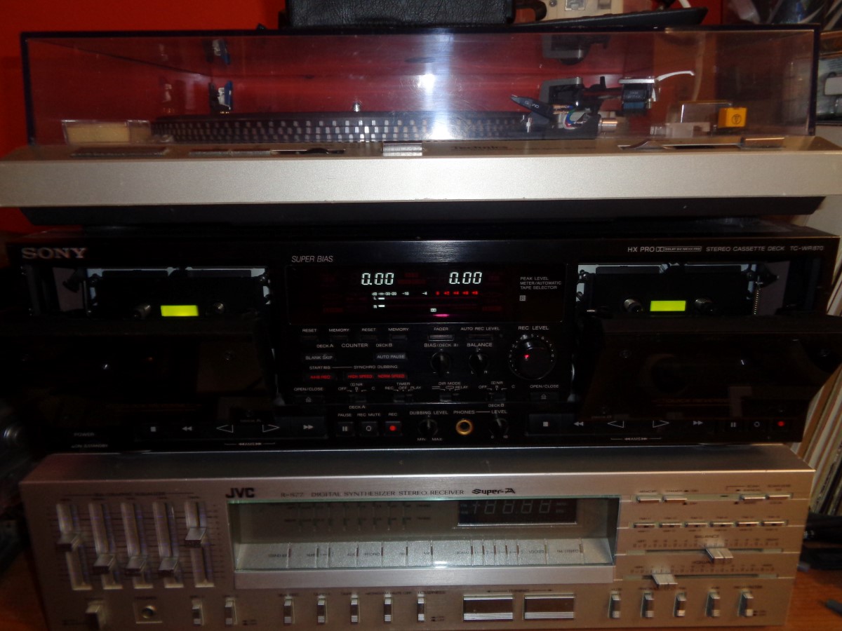

    hemm ... what I'm about to say will make some cringe .:biggrin:... I've had this system for six years, paid 45 euros in a local market ... all three didn't work (now ok) .... Technics SL- D303 Sony TC-WR870 ... JVC R-S77. I use them on a daily basis, I'm certainly not a good example of an esoteric system .... I can already hear the sound purists scream and roll over :beg.... I would never have considered a double cassette with autoreverse having already a TC-k555es and a JVC KD -A7 ... but they were all together and the seller did not want to divide them ... over time I must say that I have re-evaluated the double cassettes with autoreverse for their practicality :hypo
