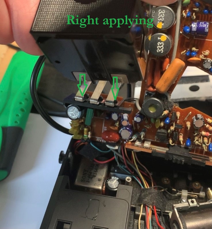

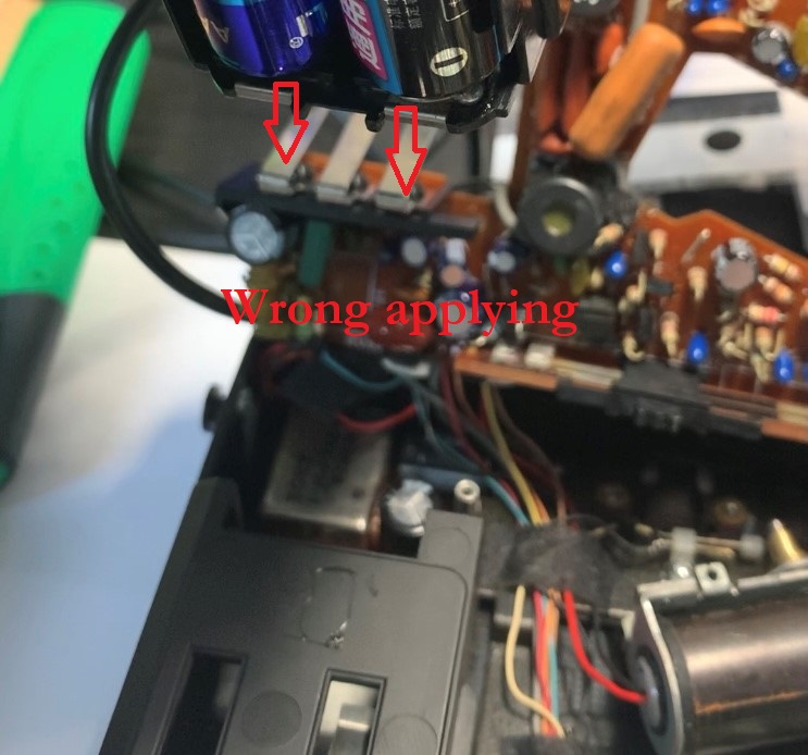

    Now I faced another one problem - little bit sliding of idler that responsible for play - the smaller of two idlers.
    All rubber capstans and belts were bought from Marian.
    There was no problem in unstoppable (crazy) running of motor. There is no super wow&flutter. Maybe servo is undamaged. I applied wrong way just for second or two. I dont know - maybe its undamaged by unknown reason.

  6. Valentin
    1,956
    Oh, I see how you placed the battery holder now that you put pictures. You would have to keep it in a strange position to make contact with the terminals, as they're designed to make contact only when the holder is in the correct position.
    However, it is possible that if you only touched for a few seconds no damage has been done. Batteries have lower voltage and lower current capability than a power adapter, so in theory the chance of creating a damage in this way is a little bit lower.
