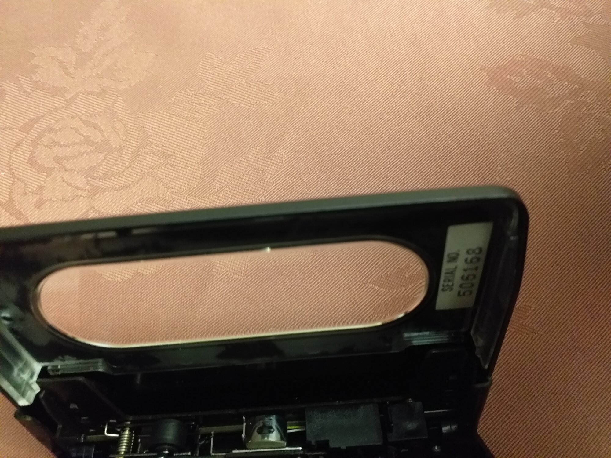

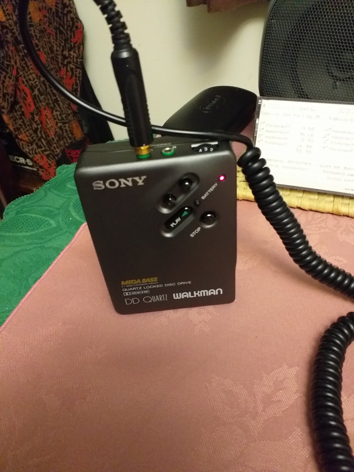

    Not exactly a direct technical question but a query relating to the well known problem of split centre gear in dd series walkmans. I bought my DD-33 back in 1999. In 2008 I went to live in China for 8 years returning to the UK in 2016. While I was away the DD-33 was packed away in it's box and put up in the loft. Since my return I have been using it every 4-5 days. The serial number is 500,000 plus. I have no idea how high the serial numbers go up to. My point is this DD,33 is still working and has never suffered from the centre gear problem. Did Sony reinforce the centre gear at a later date or have I just been very lucky? Just one more thing I never fast forward/ rewind or cue/review on any of my units. Has anyone got any thoughts on this?

    I think you are just very lucky as it has been mentioned already. I have seen others saying such units exist, but I've never seen a DD without a broken center gear myself and I did repair a lot of them.
    Storage conditions do matter in this regard. Not using FF/REW and cue may have helped.
    My opinion is, even in perfect storage and usage conditions, it's still very rare to see such a unit.
    The gear is under a lot of tension because it's molded onto the center disc. Initially, it's very hot, then cools down and shirnks at it reaches normal temperature.
    So, in theory, keeping the load on it to a minimum (only use it in PLAY) can help, however there's no guarantee that this gear will not break in the future.
    Only units with such a center-gear type mechanism on which the gear does not break are the early WM-2s, on which the gear is fully made of plastic (including the disc).
    However, I'm unaware of SONY installing such a gear on DD units.
    Let us know how your unit goes in a couple of years from now, I would be really curious to know.
