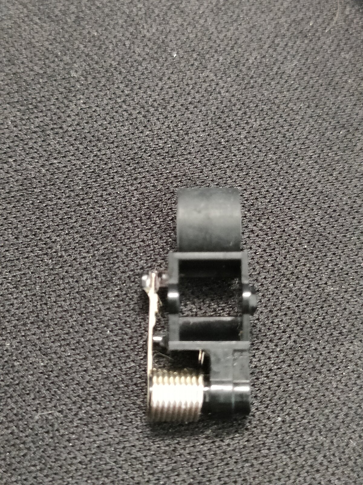

    @TP86 Definetely doesn't seem like a roller problem, but more likely there is too little pressure.
    Fact it halts depending on orientation also suggests that spring doesn't do its job. That 30-40% difference, even though is done by feel, seems excessive.

    It could be the roller that is the cause. It doesnt look too bad but one certainly is shinier visually
    I tested the walkman again after work. With my new calibration test tape the w&f is about 0.24%rms on both fwd and rev and about 30hz distance between then which im happy with.
    What I tend to notice is the fault seems to be comming in when I test some of my old tapes that physically require more torque to rotate the spindals. Im just testing by feel with a pen.
    It seems to struggle to pull the tape on fwd and rev if the tension is too great. I mean it could be the pinch rollers but also the tension from the spring. Im 100% sure capstan flywheel is rotating when tape fails to be pulled.
    Any suggestions in what I could try next? It looks like you can buy new pinch roller rubber portion on ebay but like you said when I install it theres a good chance it will make things worse

    @TP86 It's unclear to me if there is a correlation between that shinier roller and the problem (doesn't seem to be ?).
    Cause now you say both sides have a problem with some harder to spin cassettes.
    At this point I would indeed change the pinch rollers, just to see if that fixes the problem. For reference dimensions are 6 x 5 x 1.5mm (outer diameter x total height x pin diameter).
    Definetely buy complete assembies, not just the rubber as that is almost guaranteed to create eccentric assemblies.
    Even if the new rollers are to be eccentric, you should at least have an idea if the stalling problem is fixed or not even if W&F may be higher.

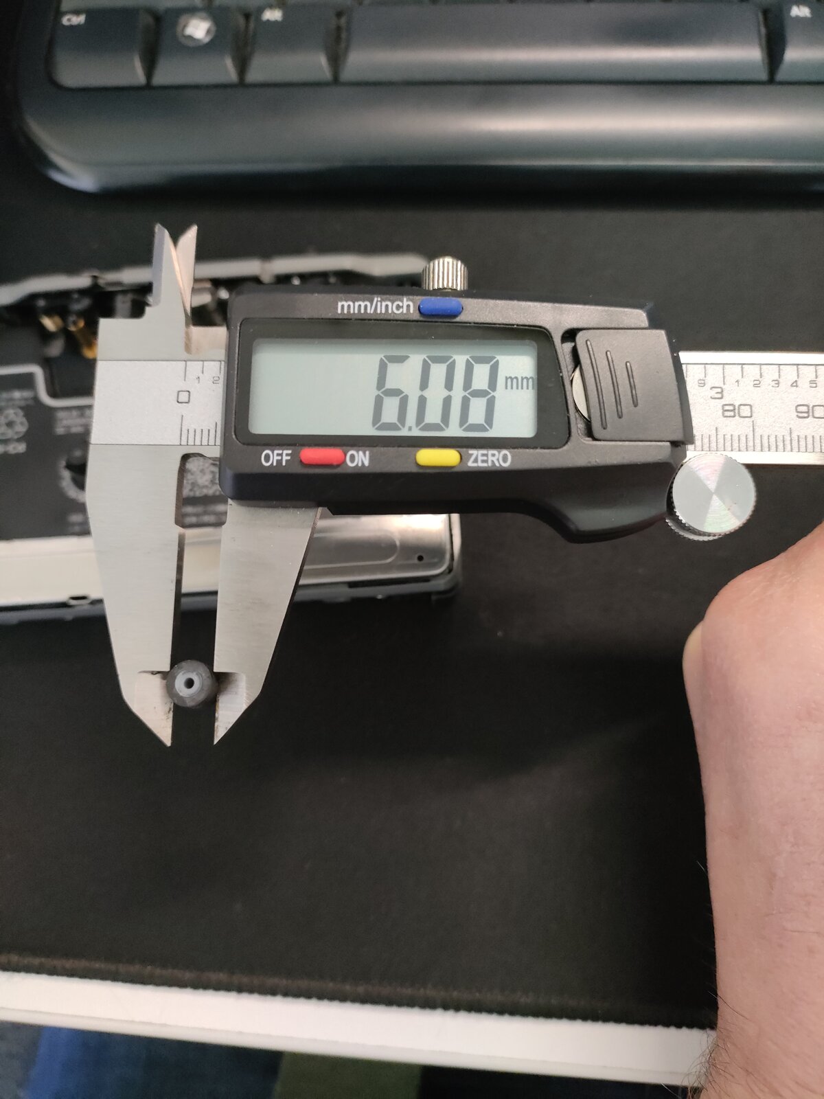

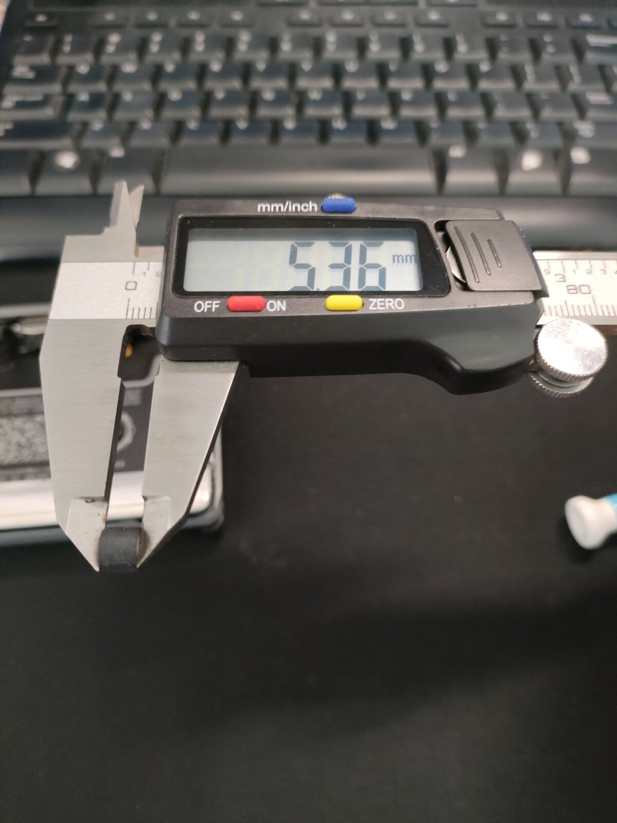

    Hi Valentin. I ordered some 6mm x 5mm x 1.5mm from China and I recieved the incorrect size: 6.22mm x 5.38mm x (not sure inner diameter but looks ok)
    The problem is because the full height is 5.38mm (0.38mm above spec) it doesnt physically fit. I am pretty annoyed. It seems to be not only the rubber protruding past 5mm but also that plastic inner piece so there no way to slice anything off.
    I have a feeling I wont be able to get my money back on these too as its hard to prove they are the wrong size. Any one who reads this, be weary of ordering pinch rollers from China as the dimensions are far from accurate
    I took the existing one out by the way and outer diameter 5.55mm and full height 4.92mm. Im not sure if that 5.55mm tells us they have worn down 0.45mm or not. Anyway not much I can do until I order some more reliable seller

    Only potential solution is to sand the plastic hub, 0.2mm on each side, assuming the hub is significantly taller than the rubber.
    In regard to dimensions, height has to be a bit smaller than the actual specification, since there needs to be some play in the bracket.
    The 5mm is supposed to be the height of the bracket, while 0.08mm is the allowed play.
    Same thing goes for the pin, hole has to be a little larger than the 1.5mm pin to allow a tiny bit of play.
    As for OD, that usually won't match exactly, but would expect it to be closer to 6mm (like 5.8-5.9mm for example).
    That 0.45mm less may be the reason why tape doesn't have traction at the roller, since these rollers don't have a lot of tension to begin with.
