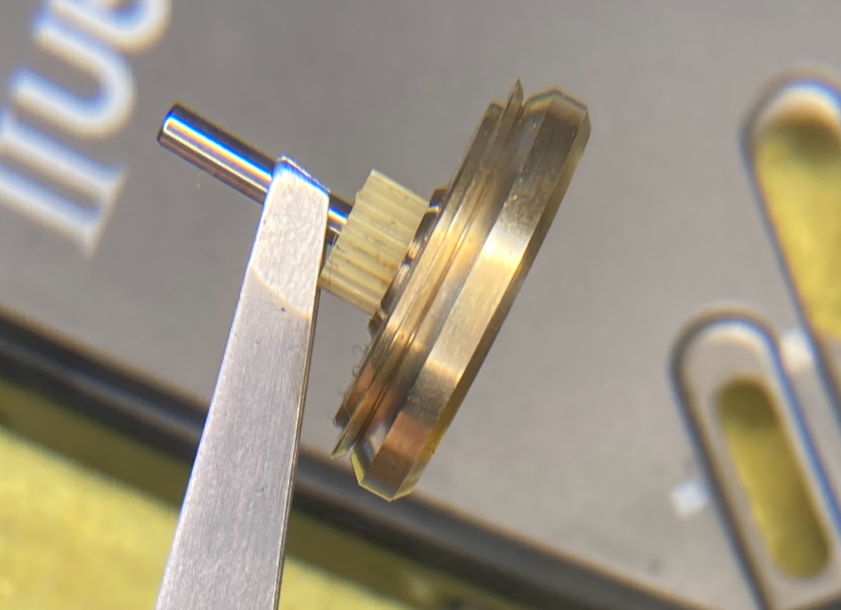

    Center Gear & Clutch: This unit has that thick plastic center gear and is not cracked. I still completely disassembled it and polished the clutch to remove all patina, just in case.

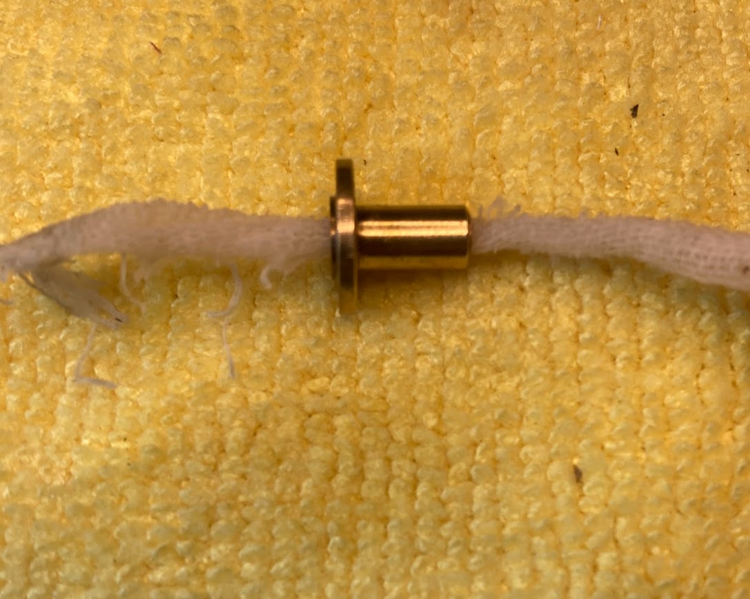

    Mechanicals: Cleaned and relubed the capstan bearings, greased the appropriate points, and added a few drops of oil to the motor shaft.

    There are really only 3 other things that can cause increased W&F:
    1. Worn capstan bushing. This is a common cause of increased W&F on belt drive units.
    While usually a problem mostly on thin players with small capstans, it's something to be considered.
    It can best be felt where there is a no oil inside, so for testing purposes you may clean and install it (without the retainer) completly dry.

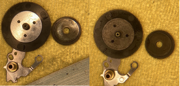

    The Clutch: Could a sticky clutch be causing this excessive drag? I polished the surfaces (see the before/after photo below), but now I'm second-guessing myself. It rotates smoothly but with some resistance. Since I don't have a known-good frame of reference, I'm not sure exactly how much resistance is normal.

    A frozen clutch can create excessive drag, but if that was the case you would see:
    - very high takeup torque, to the point of tape slipping past pinch roller;
    - current consumption would jump only with a cassette inserted and would be normal without (which isn't the case here);

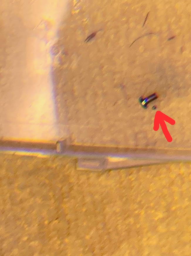

    However, I did find a strange thing during my last teardown. While cleaning the parts, I looked inside the clutch shaft and discovered a tiny, loose ball bearing stuck to the wider, lower side of the shaft. In this picture, it is near the PSB screw to show you its size. I managed to pick it out with a toothpick. I have no idea how it got there or if it's an accidental "migrant" from another part of the mechanism. I see nothing that small on the schematics...
    I'm going to tear the mechanism down one more time to carefully double-check the reassembly and see if I can pinpoint where the friction is happening.

    Just a casual observation, I do not see the film washer that goes between the center gear hub and driving gear assembly in your image. Just want to ensure that it's not missing. Cheers. Norm
