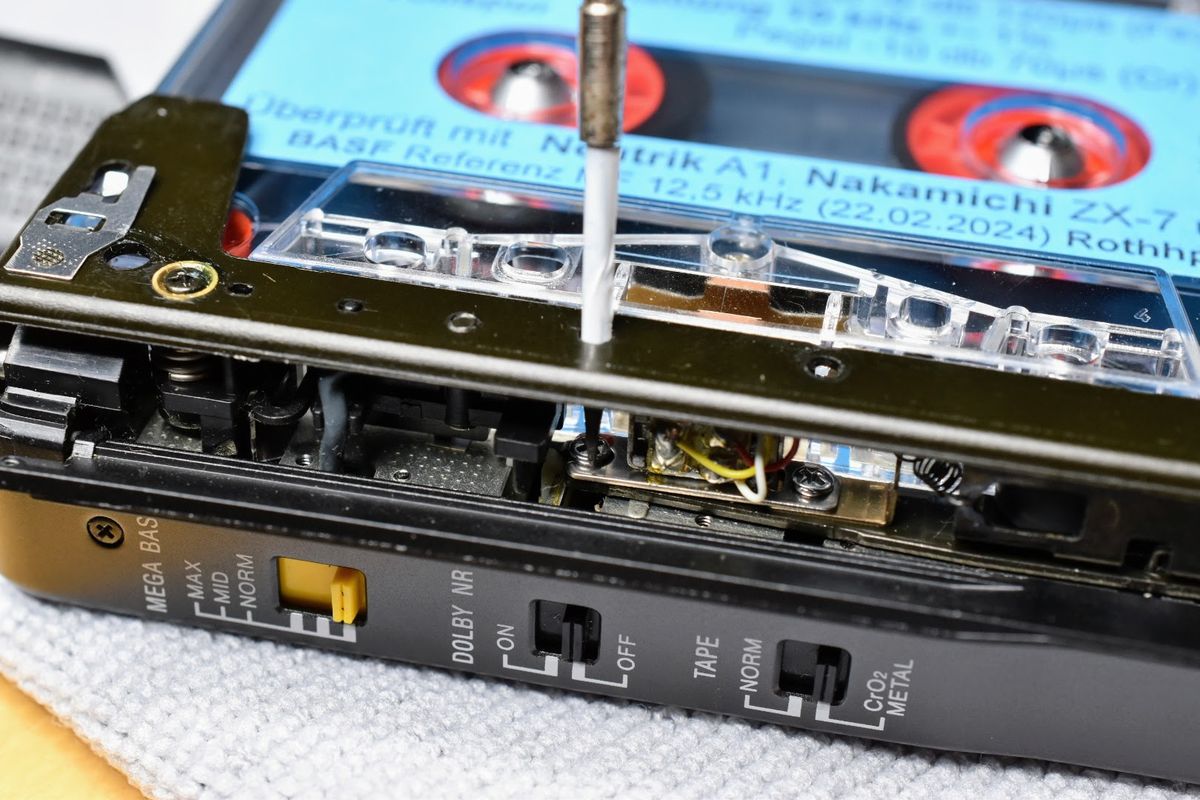

    The DD33 is first to get up onto the operating table.
    Forceps please nurse....

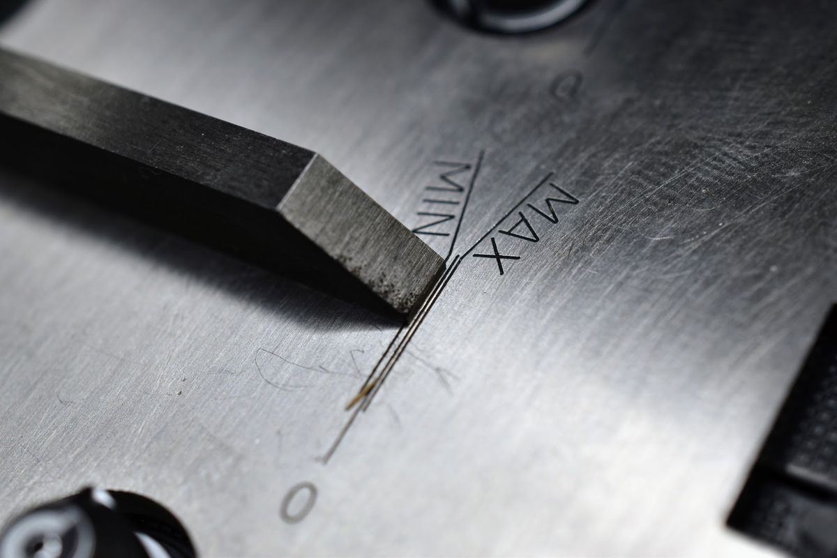

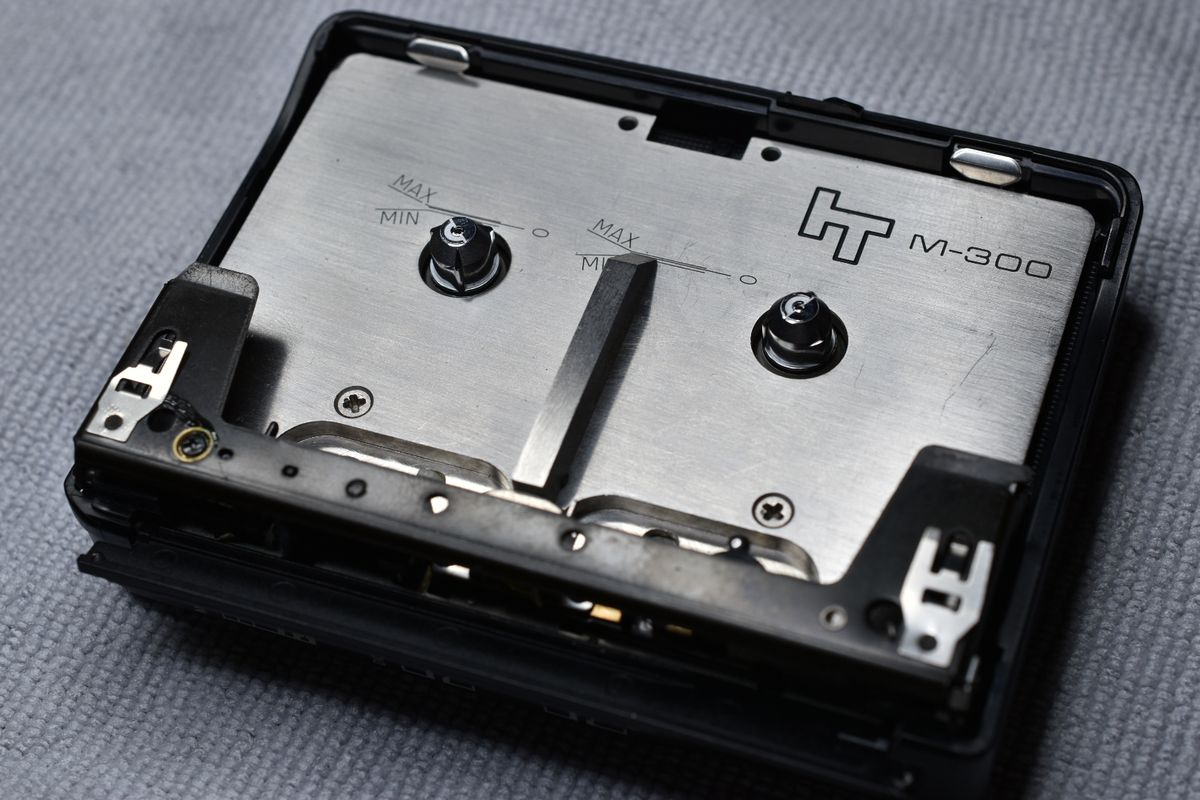

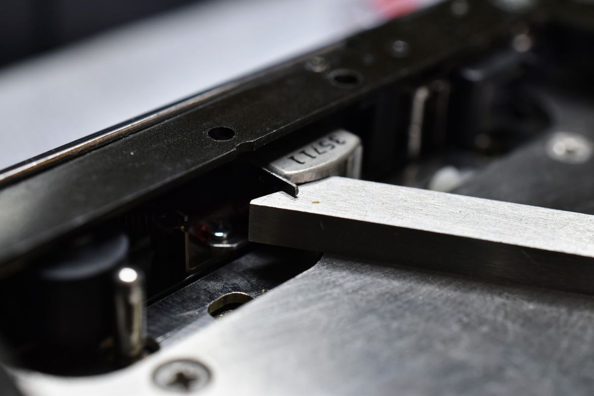

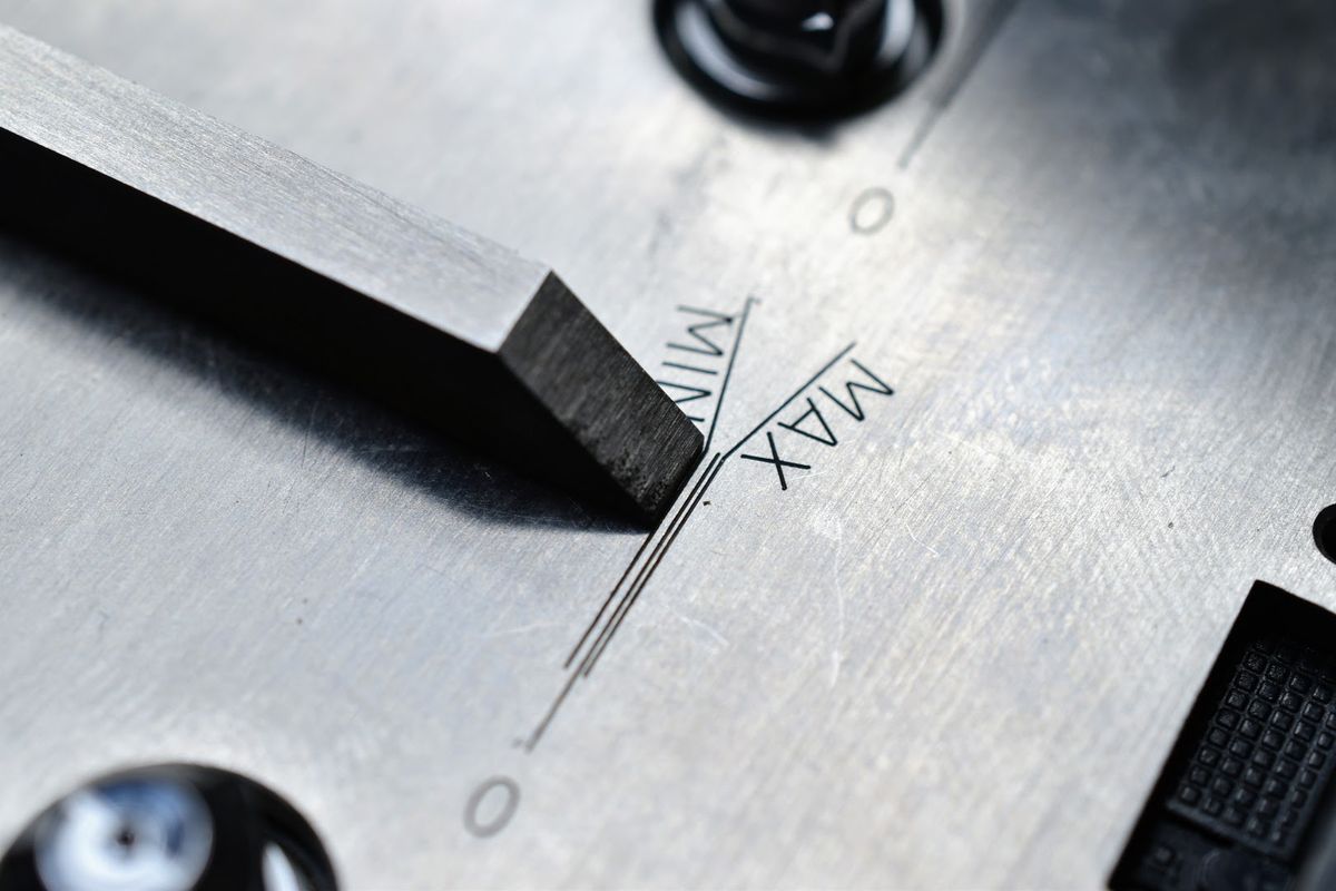

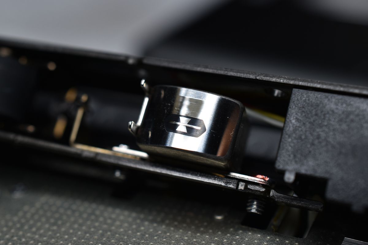

    Head height spot on
    head penetration depth right on the minimum but no issues - sounds good and levels are fine
    head looks great, no spurious-looking grooves or pitting

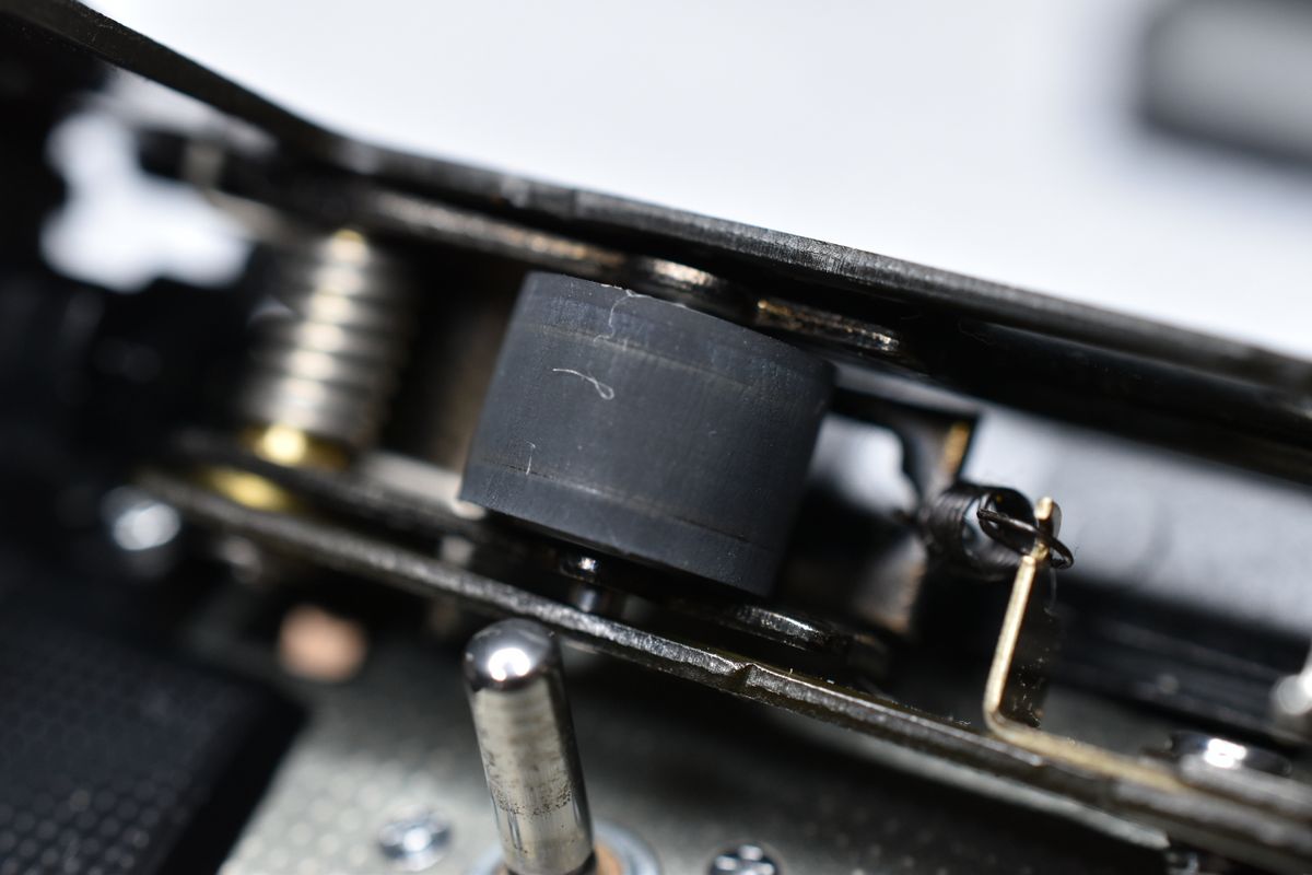

    ..as does the pinch roller after a good dousing with Naptha

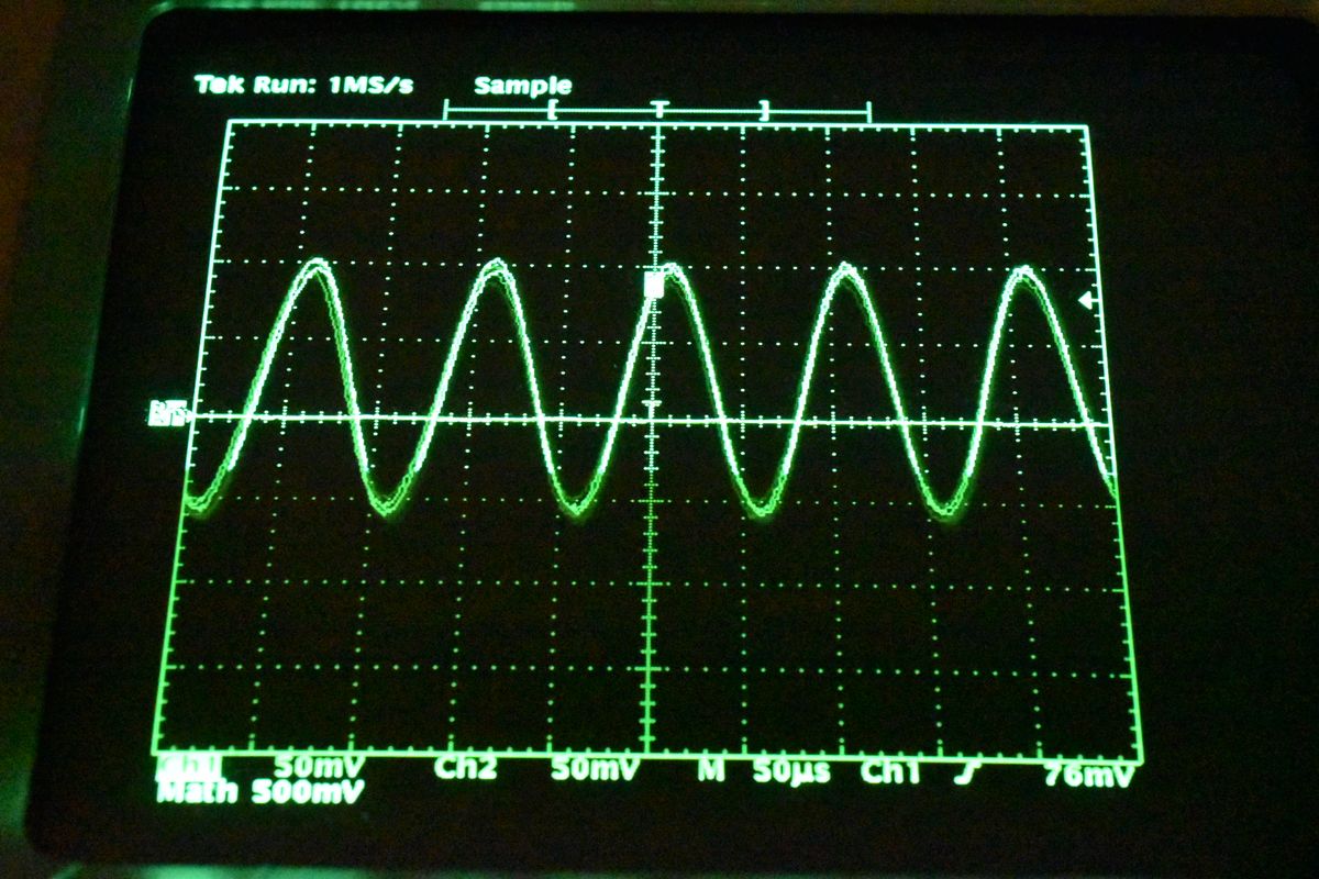

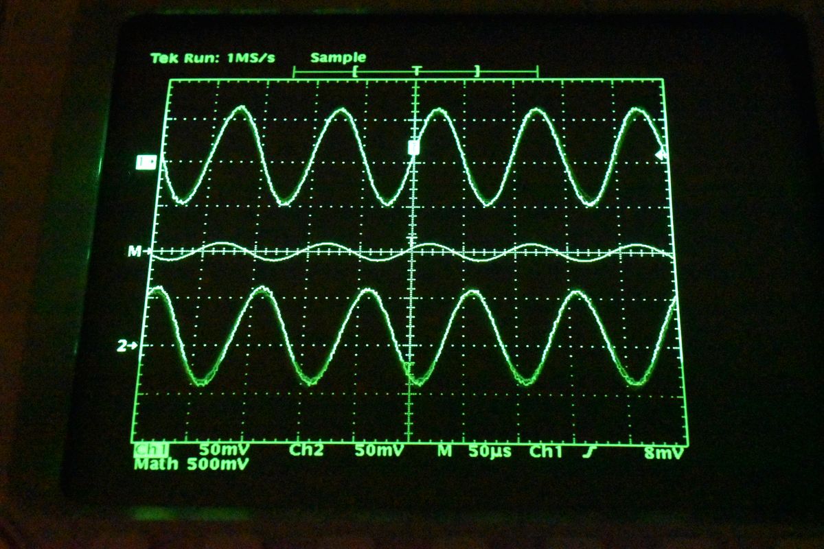

    ...but oh dear, what's this? Here's why it's lost its' sparkle. Azimuth needs adjusting
    The DD33 azimuth adjustment is a hair-trigger of an affair. It sort of reminds me of that 'Operation' game we played as kids 'You need a avery steady hand!' lol
    That's better. Nicely back in-phase and no channel disparities. Nice one.

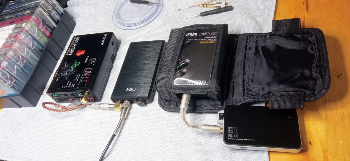

    The FiiO E11 is a good match for the DD33.

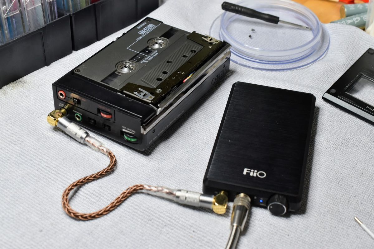

    Next up is the D3.
    Whereas the DD33 is a good PB machine and pairs really well with EDM, DnB etc, the D3 by comparison has a more 'mature' sonic presentation, perfect for acoustic and other 'grown-up' genres of music and it's also actually a great little recorder to boot!
    Scalpel please nurse...

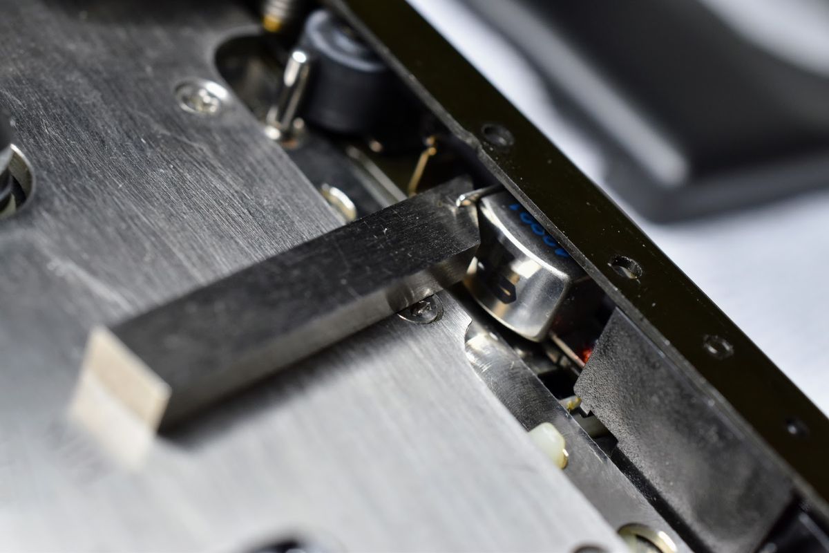

    Head height fine
    Penetration depth nicely positioned between minimum and the mid-point

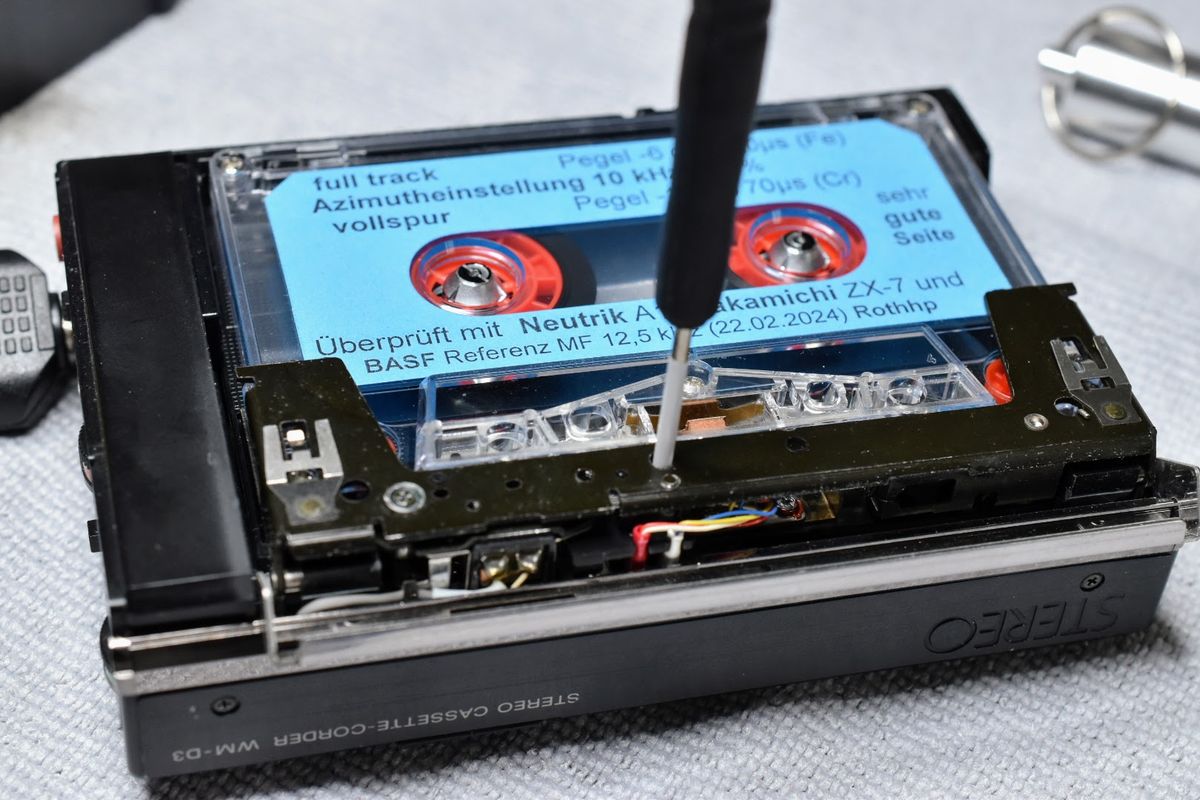

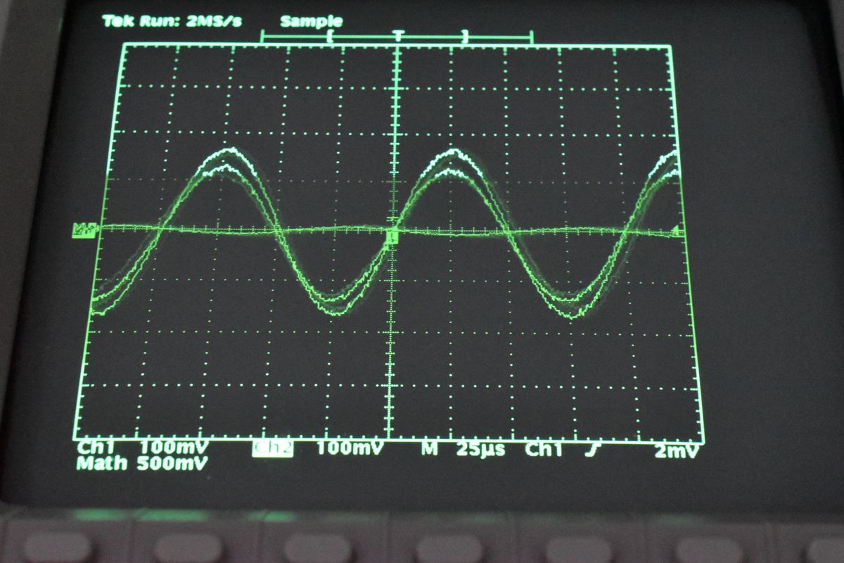

    time to tweak the azimuth a bit
    back in-phase

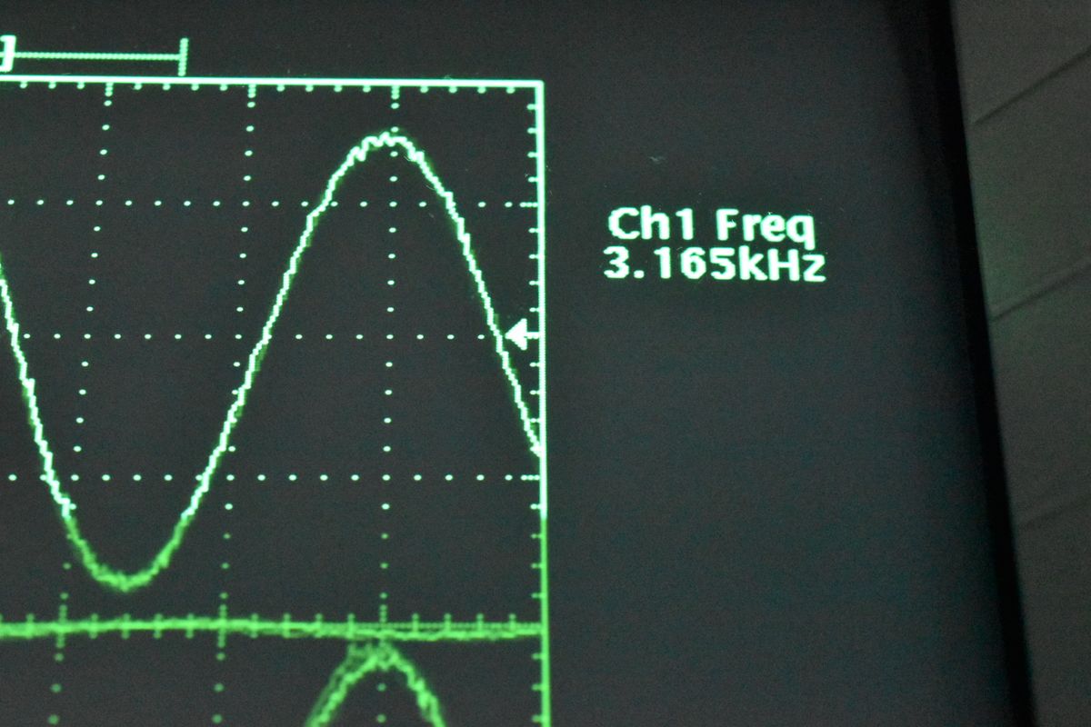

    speed ok
    I pair the D3 with a FiiO E12 and I learned to refrain from automatically using the 16dB gain switch like I used to in preference to just increasing the volume at the 0dB gain setting. The lower frequencies seem to benefit from this and sound a bit more controlled and defined.
    all done!
