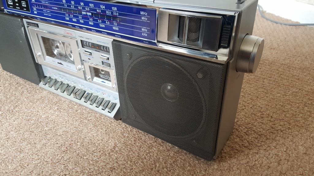

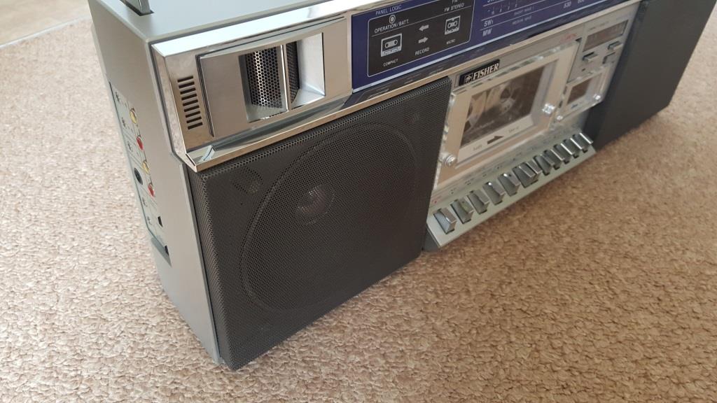

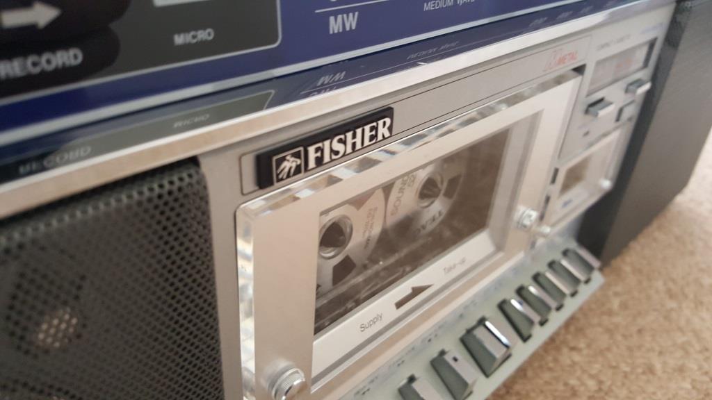

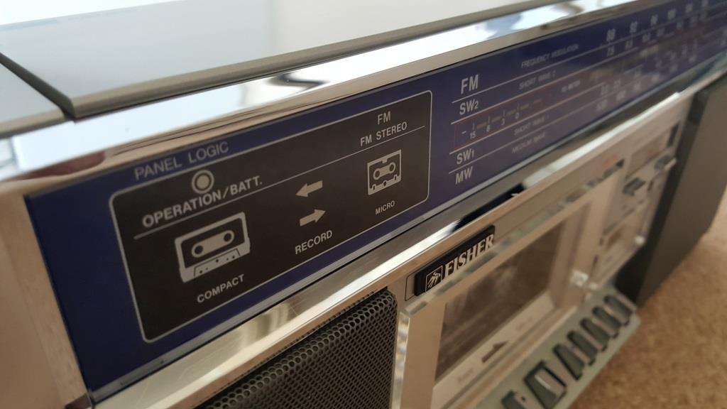

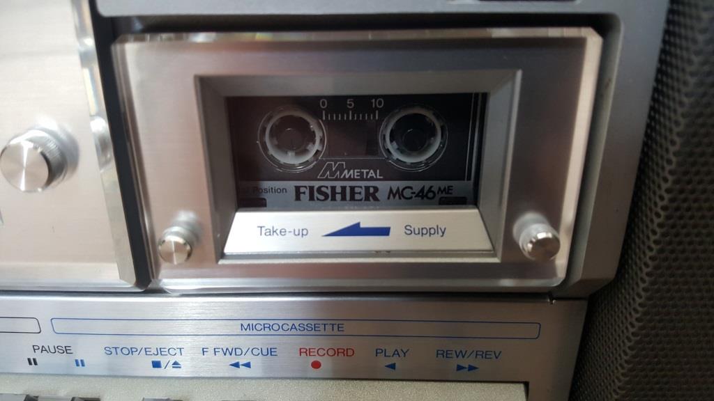

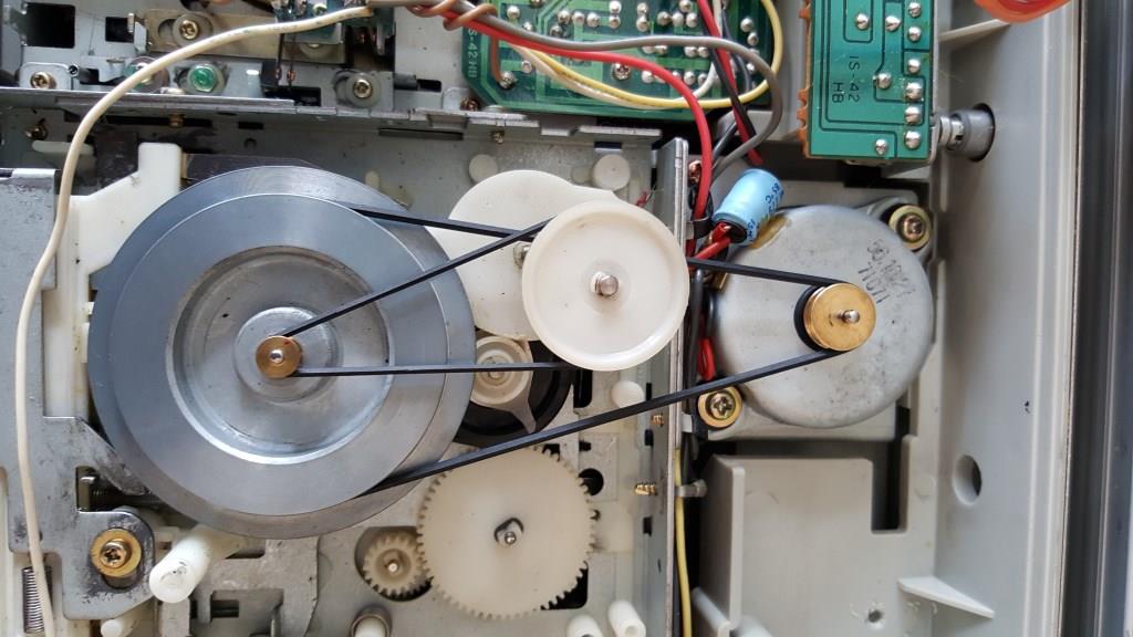

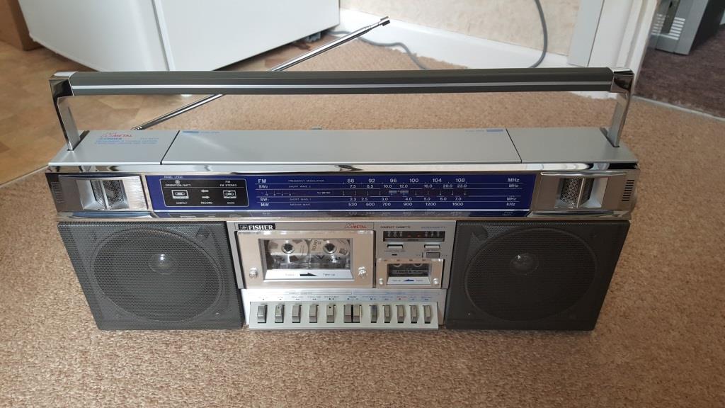

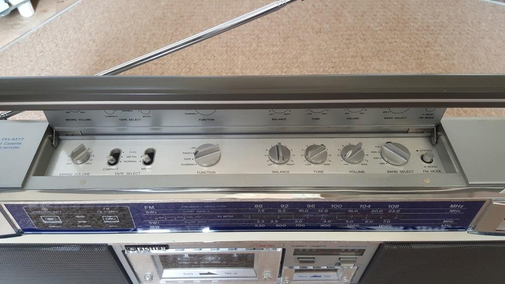

    Always wanted one of these as I have a large collection of stereo microcassette players and recorders, but only two mini boxes a Fisher PH-M88 and a Sanyo M-X66.
    It was described as fully working except the microcassette deck would not record and this was the case.

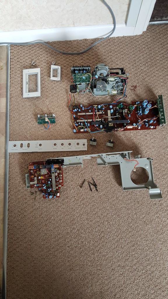

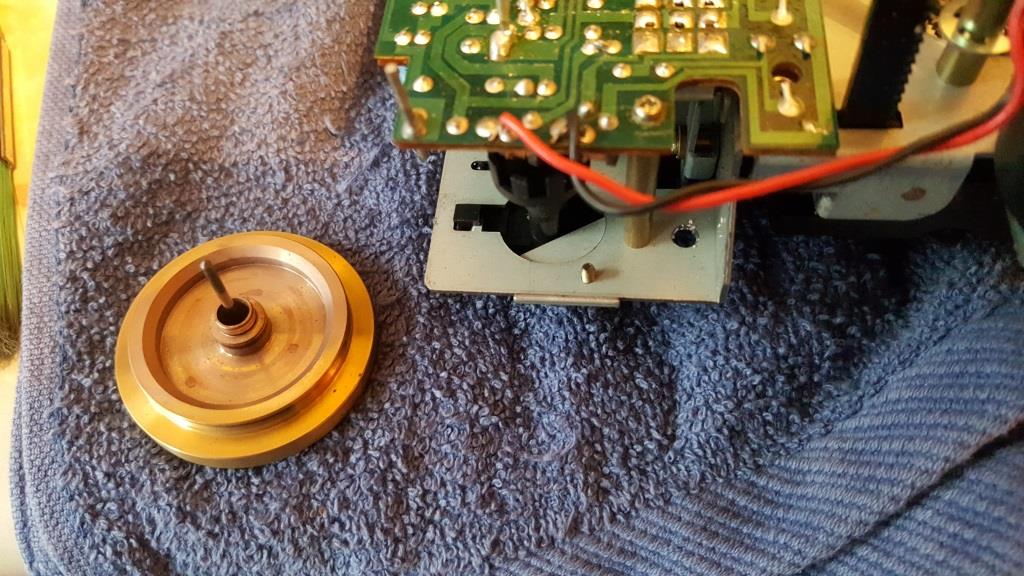

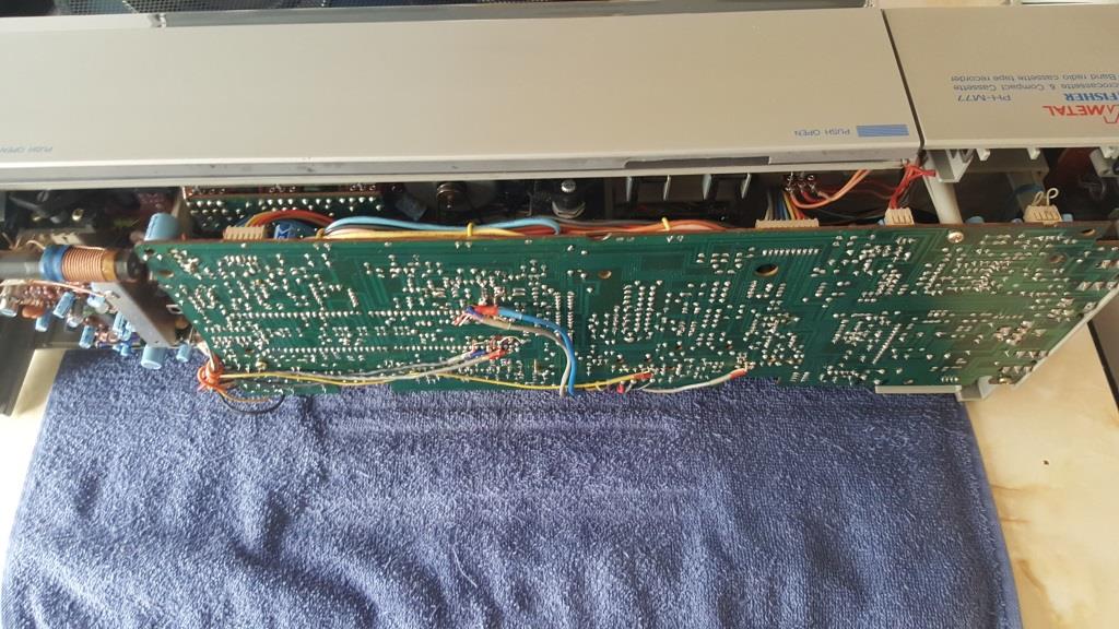

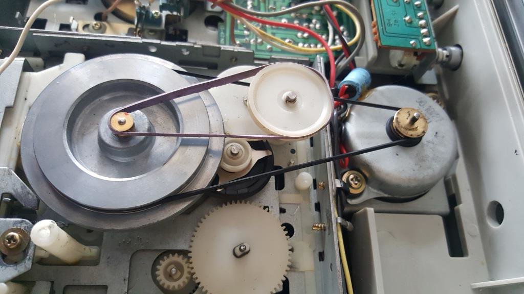

    Although the standard cassette deck worked fine something didn't seem quite right, so whipped the back cover removed the main circuit board and a metal cover on the back of the deck. One of the belts had been replaced with an elastic band, why do people do this? Also all the old belt residue had not removed from the pulleys so cleaned all these up and fitted a fresh set of belts.

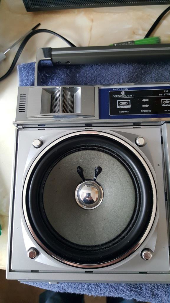

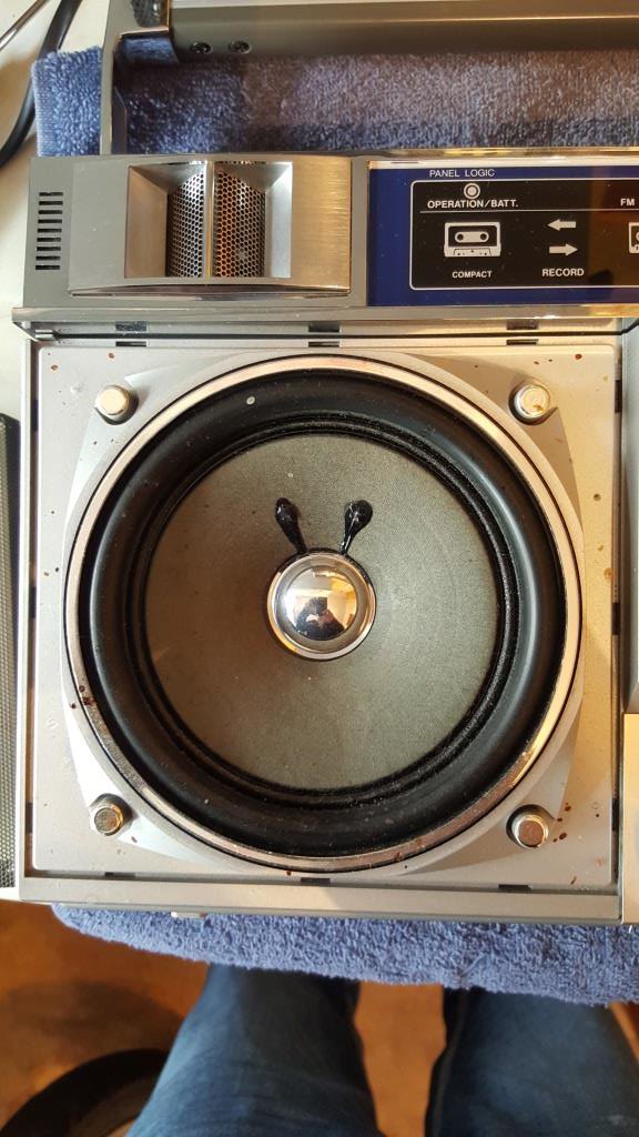

    I wasn't going to do anything else to it as it was very clean, but there was some dirt behind the speaker grills like something had been splashed through them, this was bugging me. So decided while I already had it apart to completely strip it remove the speaker grills and clean behind them.

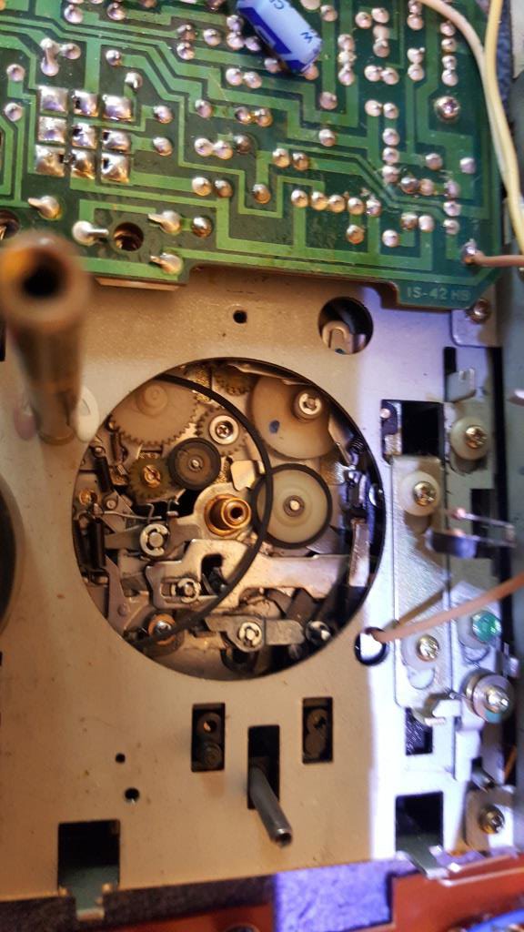

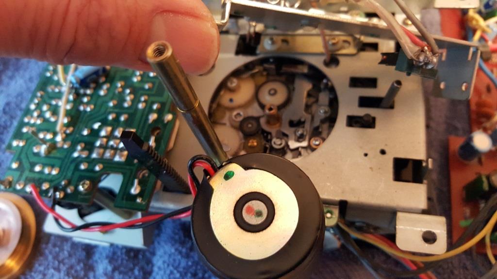

    Since it was now in bits thought I may a well re-belt the microcassette, it only uses one small belt and rubber tyres so cleaned all these.
    The recording problem with the microcassette was that when the main board had been put back on, the record arm had not been located properly in recording bar, simple fix.
    So here are some pictures of the work done and the end result a very nice box :biggrin:
