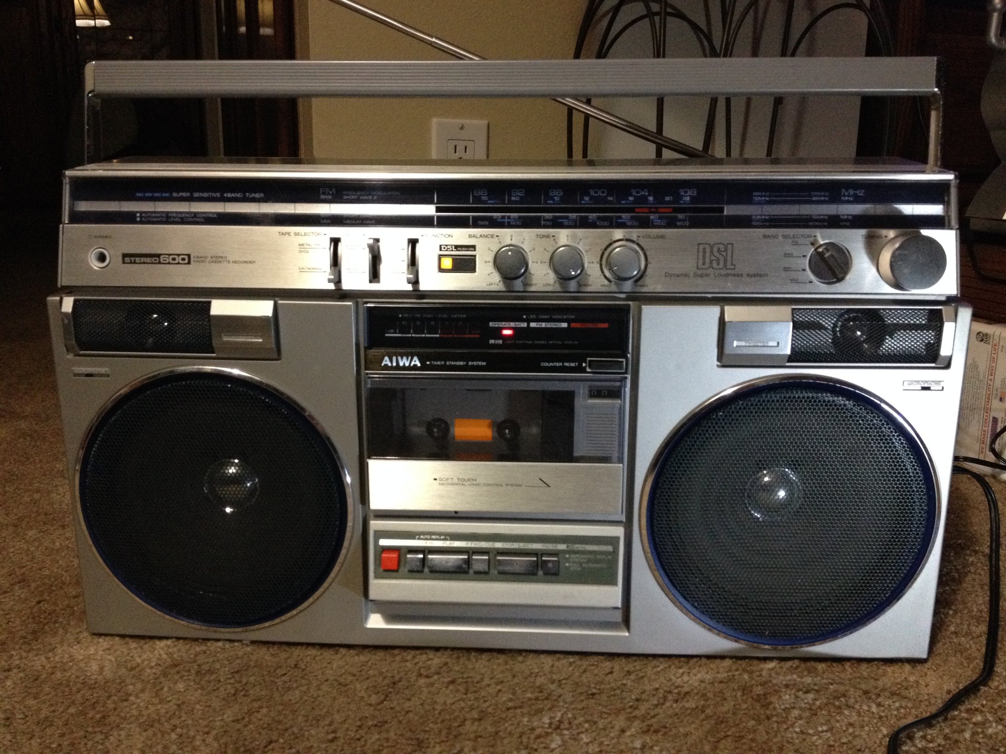

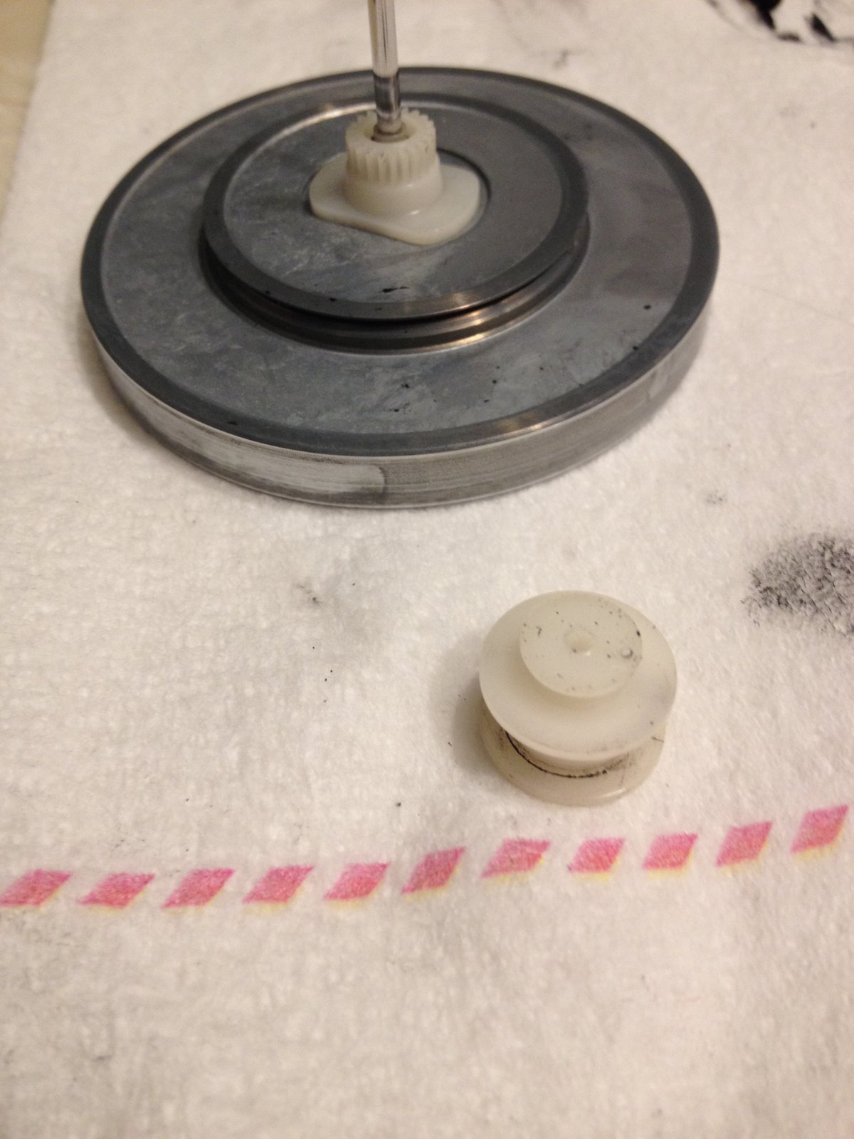

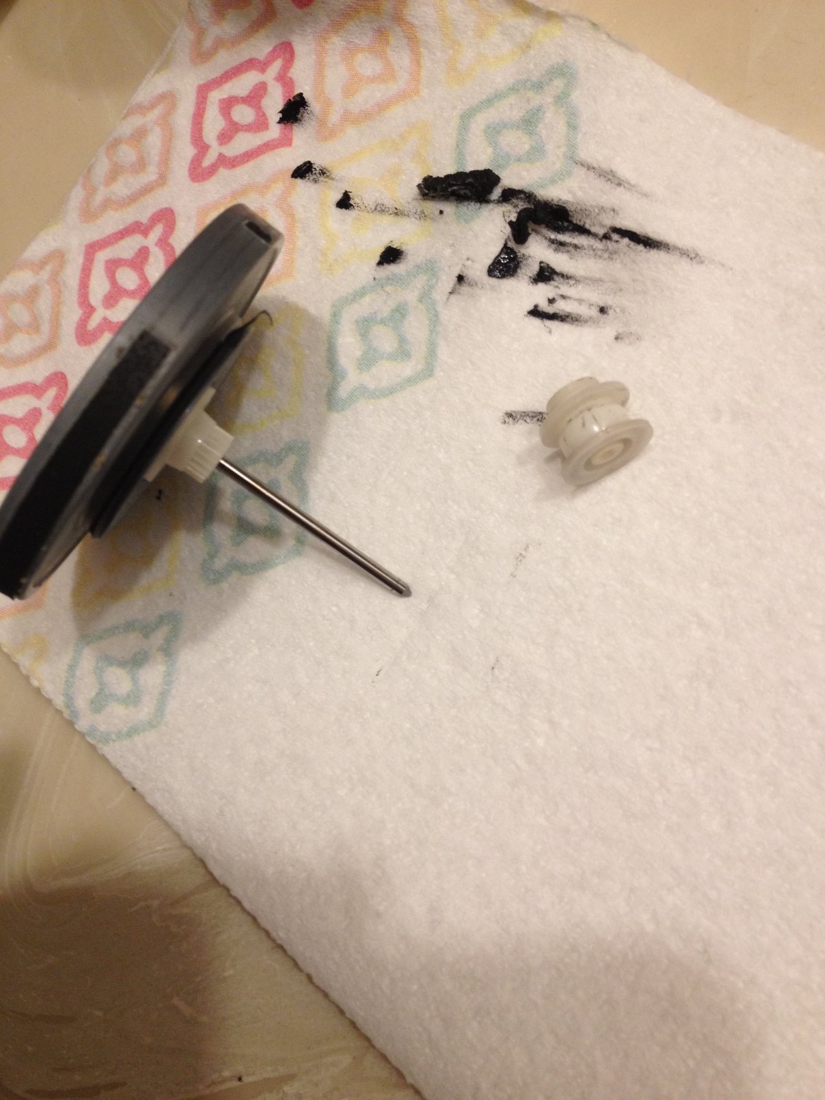

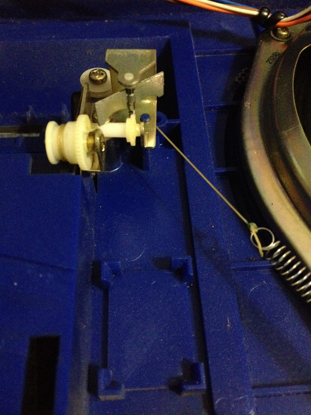

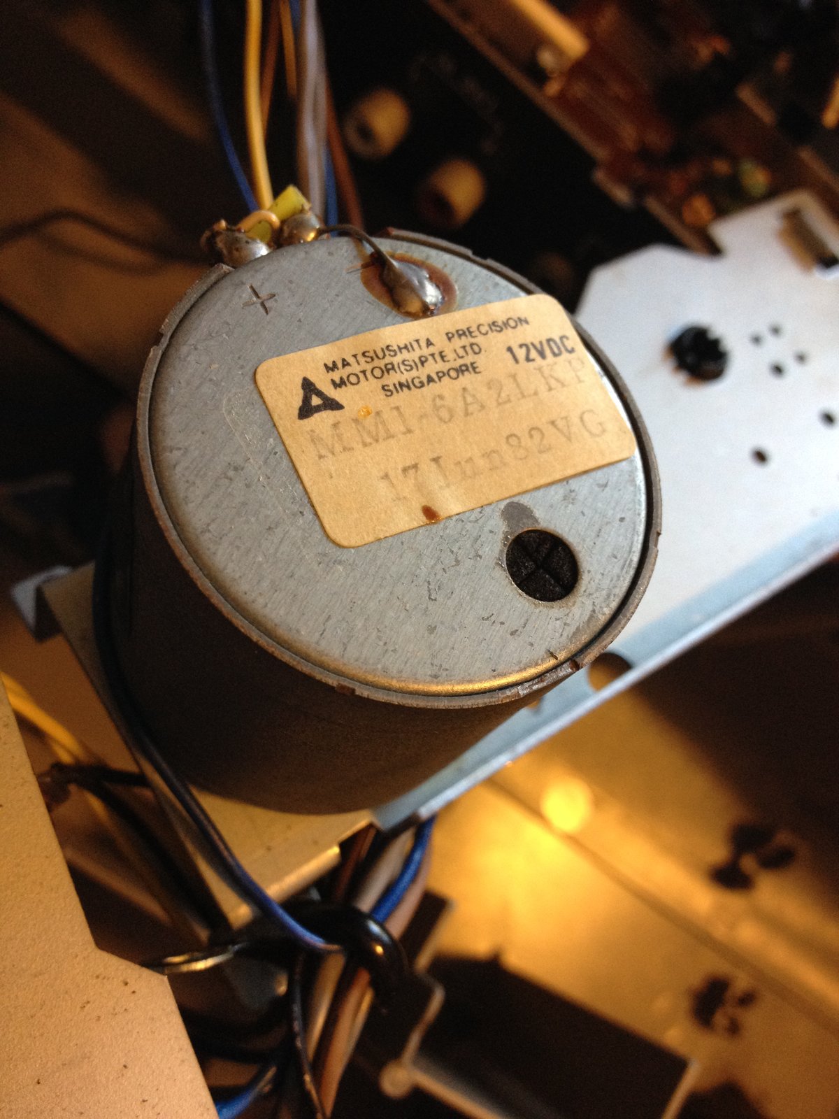

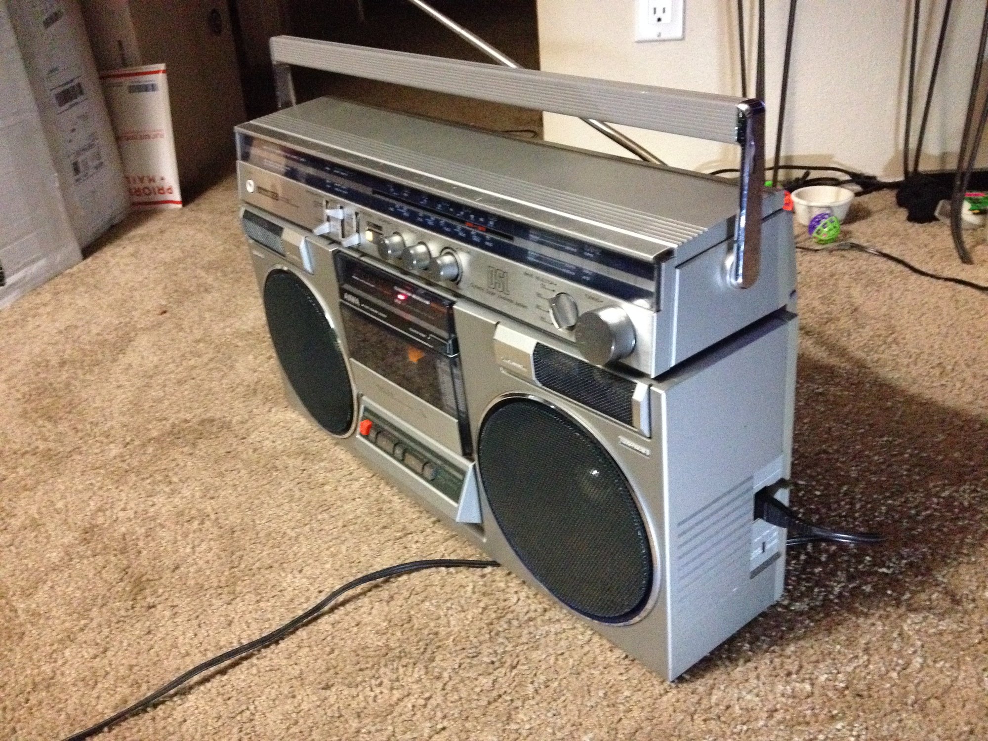

    image.jpeg I recently scored this attractive and shiny Aiwa CS-600U and it has an amazing sound quality for just having a tone knob, but with the DSL button pressed in, the bass is excellent! It just needed new belts as the originals turned to gooey tar! The cassette drive motor was bad as well and I have ordered a new one. image.jpeg image.jpeg image.jpeg Removing the gooey belts image.jpeg All clean! image.jpeg Bad motor :( image.jpeg Really cool music box air damper soft eject mechanism!

    Where did you order a motor from mate, do you have a link?
  3. 2channelhero
    2channelhero Active Member
    87
    33
    Eugene, OR USA

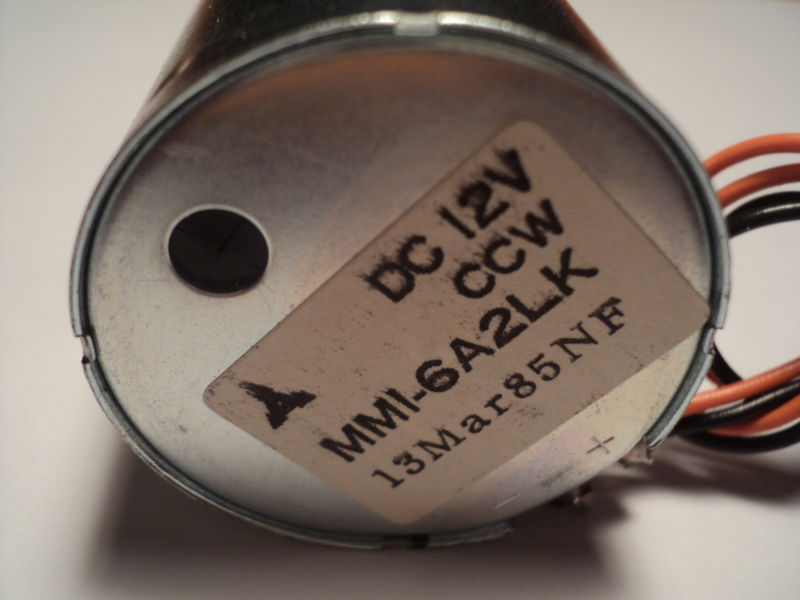

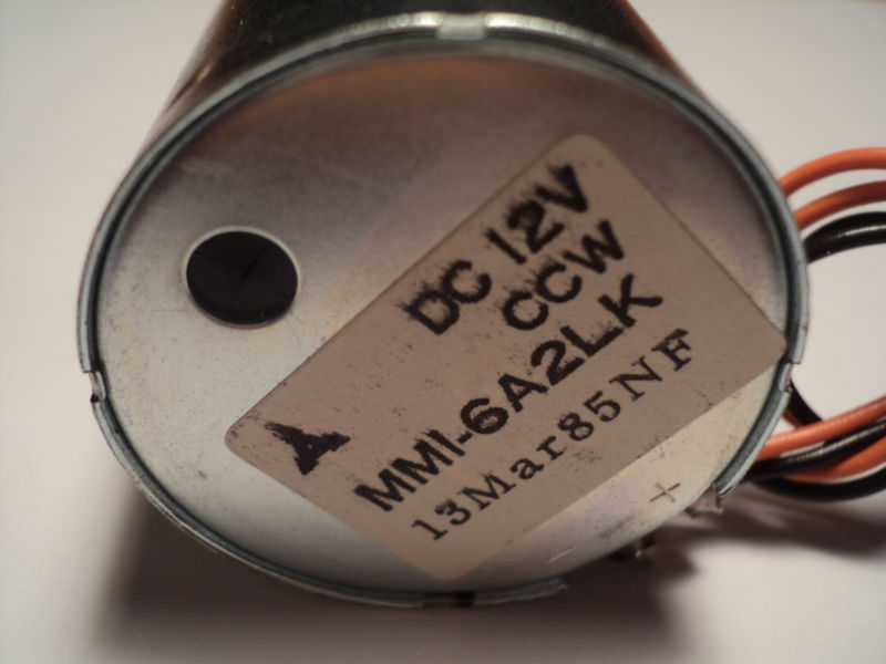

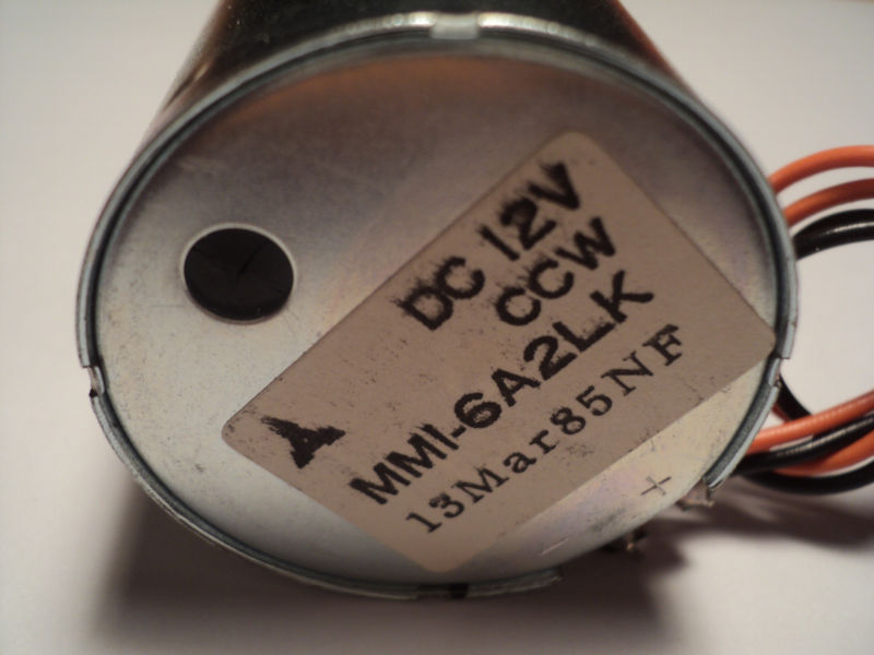

    The seller's name is cassetteconnection(1874) I had one motor the same size, but it was spinning the wrong direction, so I found one with the same number as you see in the pic, And I'm hoping it will work. (Haven't received it yet) And for any newbies to this kind of thing, you can't reverse polarity as there is a speed control circuit board inside the motor housing and you'll fry it. image.jpeg

    You CAN reverse the polarity if you are prepared to very carefully prise the cap of the motor, withdraw the entire assembly (really easy) Then desolder the pos & neg pins, lift off the motor servo board rotate it 180 degrees - Then drop it back over the motor power connectors & resolder them!! Ease the motor back together & Viola!! Your motor is now the opposite rotation of what it was & you can of course still use the servo pot to fine adjust the speed :biggrin: :biggrin: :biggrin:
    Done it many many times over the years - just be gentle popping the lid off where the servo board is. .
  9. 2channelhero
    87
    33
    Eugene, OR USA
    It's funny you mention this. I just accomplished the exact thing you mentioned yesterday, putting a new motor in a box I just got, but only having the reverse polarity motor on hand. A pair of needle nose pliers on the edge of the cap by the connections, and a slight twist and It came right off! I have a solder sucker that is always useful to get the servo board off.
