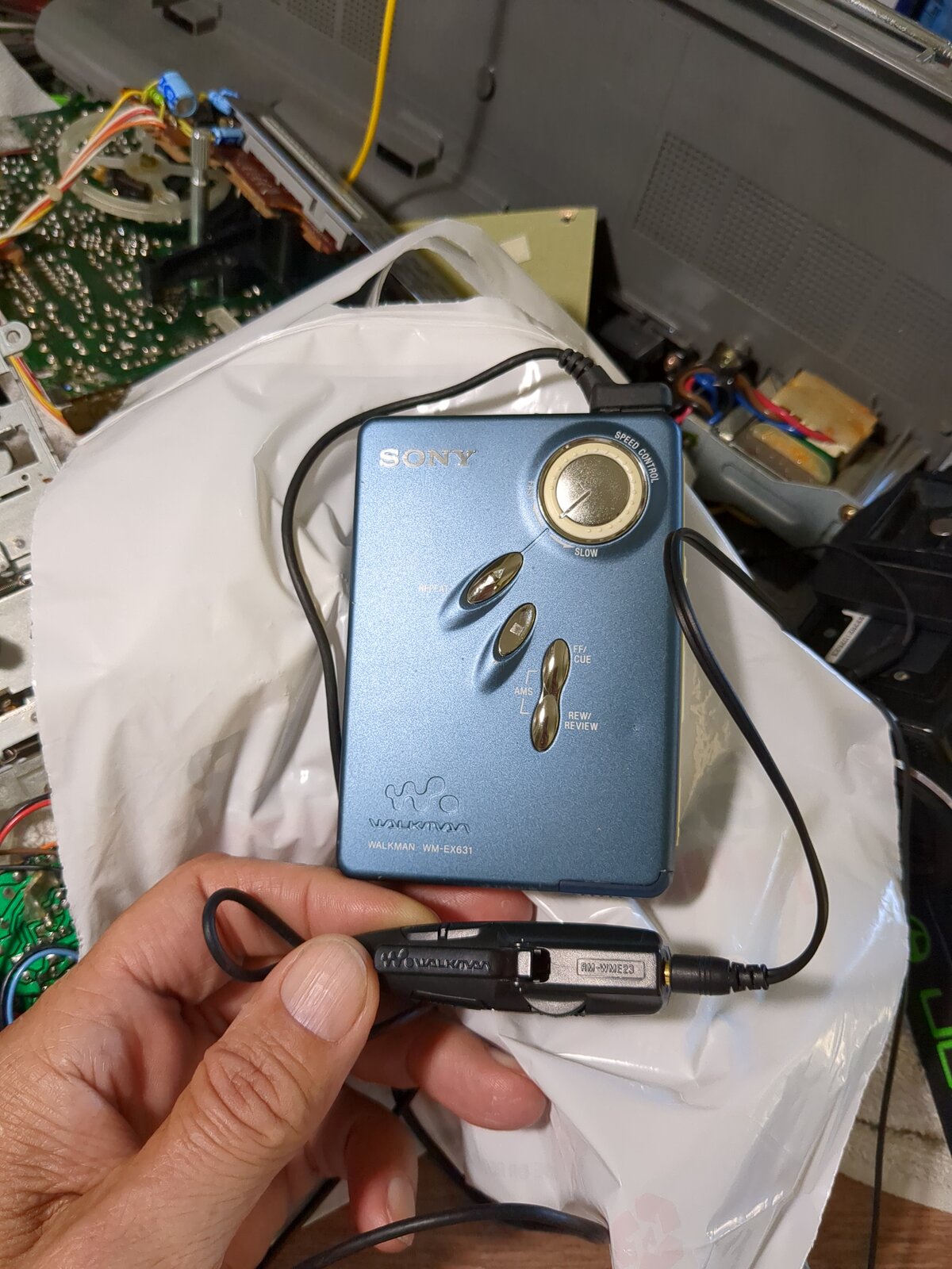

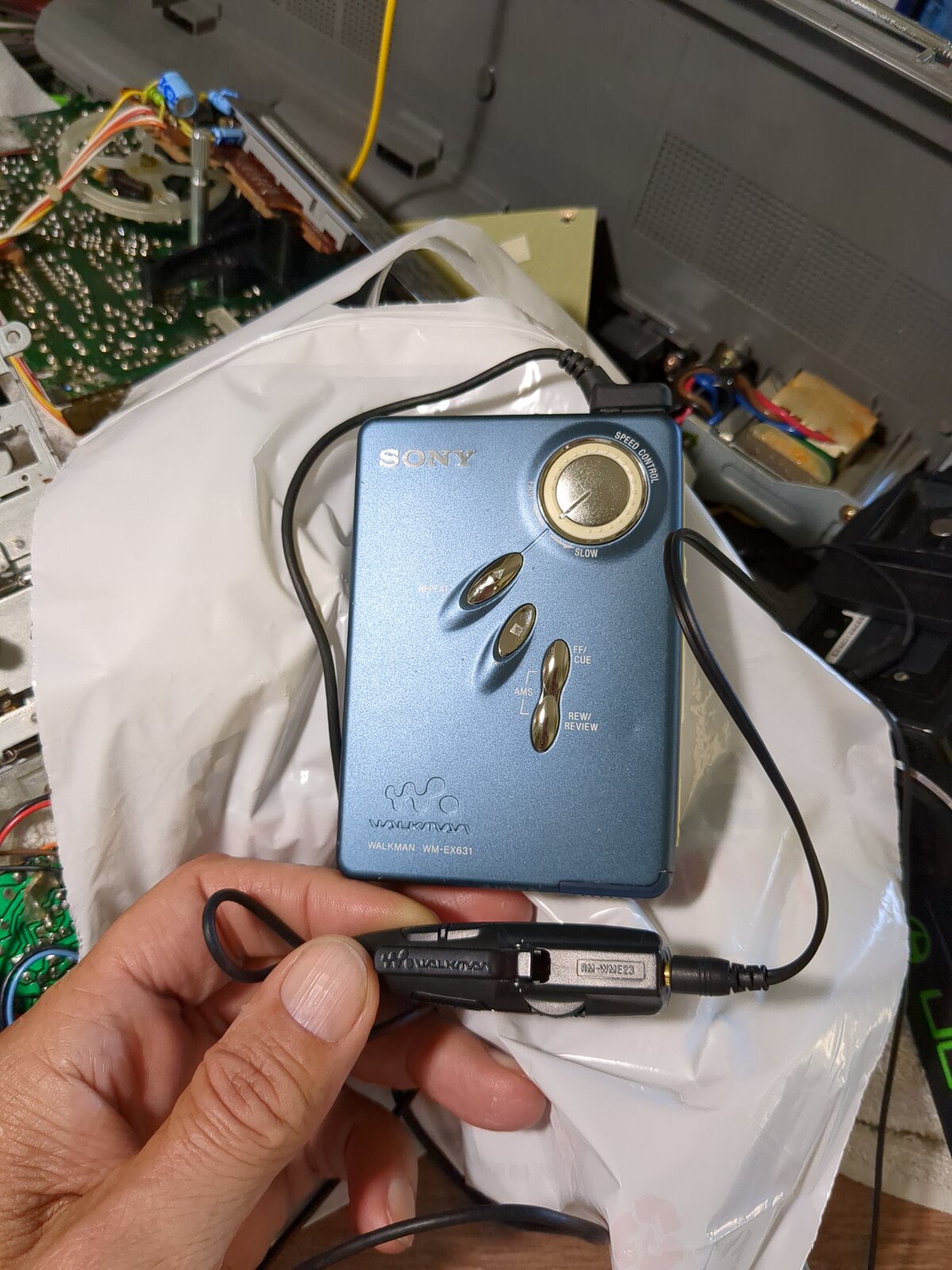

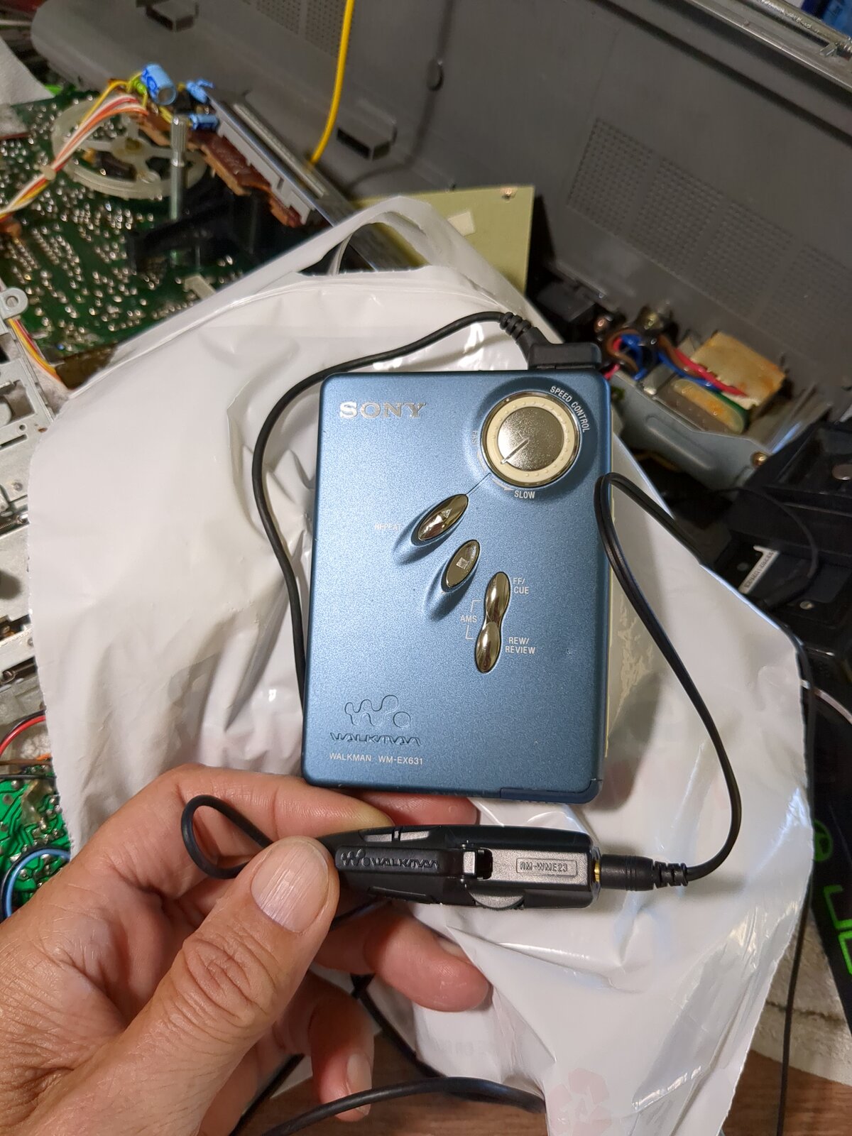

    Fx290 I don't think I have that but I don't know what it looks like because there's no picture in this thread. But here is a picture of the ex631 because there's so much talk about this model. Here's another fresh picture 17248625502201662442257402866880.jpg
    Like I said, I'm a visual person and I may have a 290 model and not know it because I have over 100 Sony walkmans. Not too many are identical except for the wm10 models of which I have 15 or 20. I'm not sure and then I have a lot of the f10s and then everything else is individual. After that I might have twofers of the high-end models.
