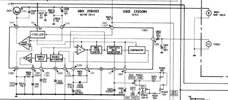

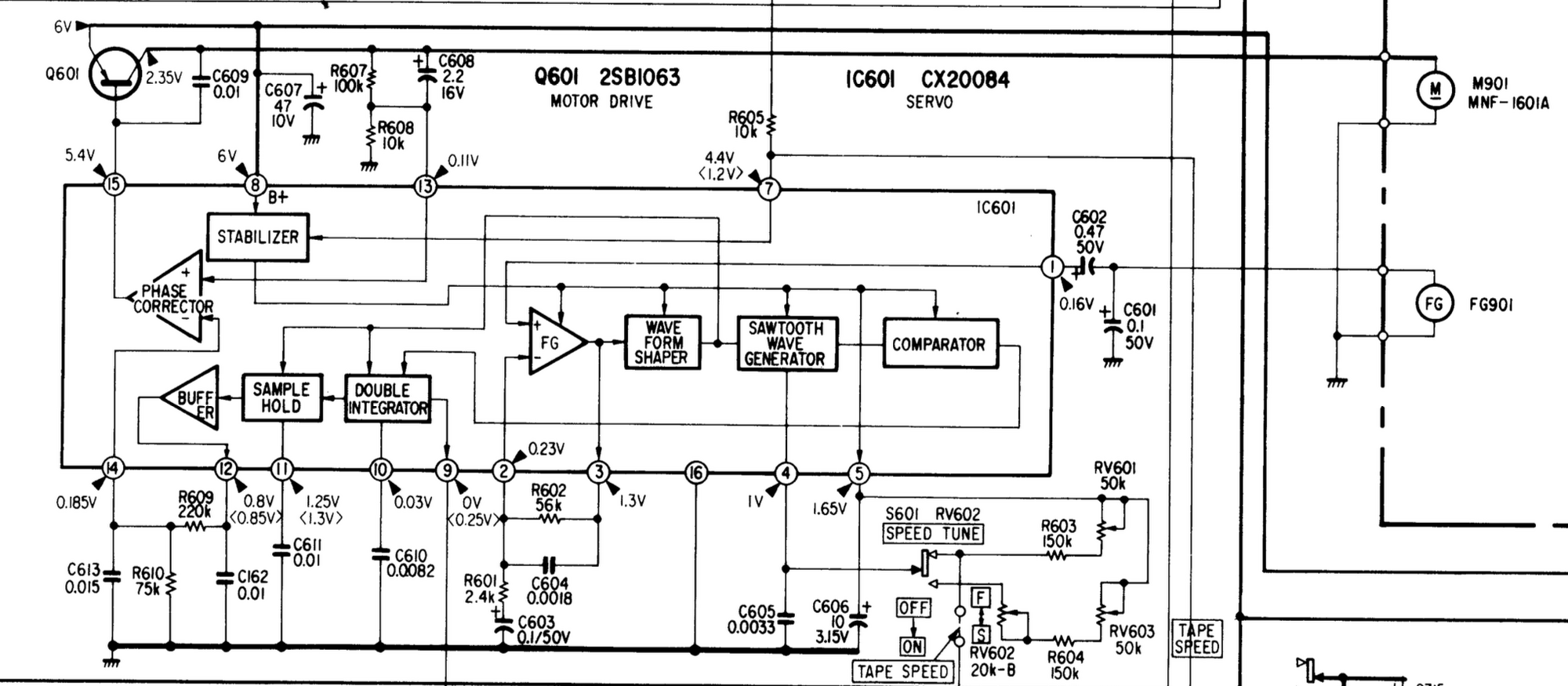

    Screenshot 2026-02-17 at 15.20.18.png View attachment 56864 View attachment 56864 I got a nice WM-D6c that is in very nice condition. 99% mint.
    Unfortunately the speed is much too high. The CX20084 is 100% (1,65V on pin 5).
    The base of Q601 gets 5,4V from pin 15. The emittor is 6 V and the collector should be 2,35V, feeding the motor. But it is also 5,4V, so the motor runs too fast. So it looks like the Q601 is bad. Is that a common failure?
