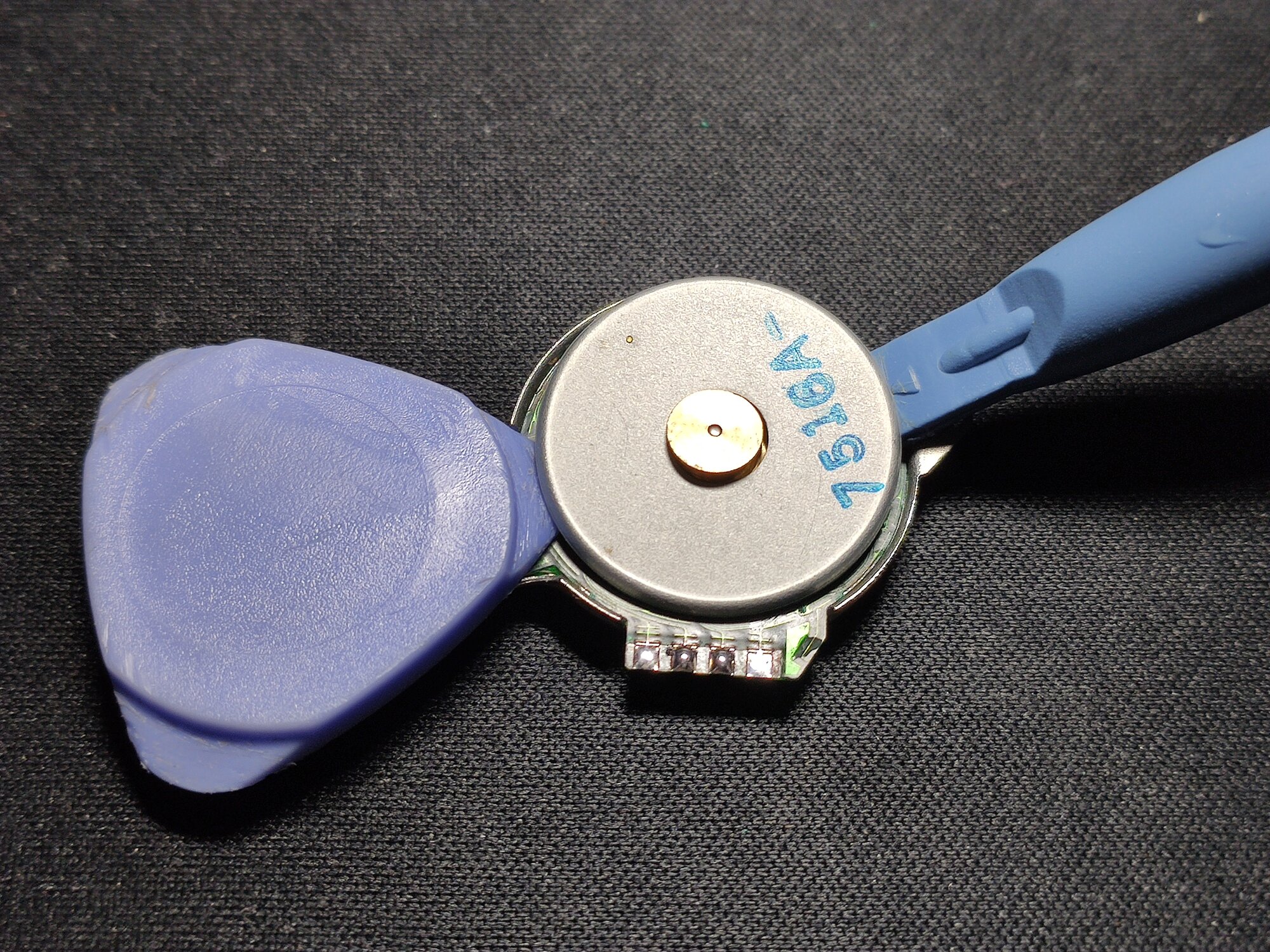

    2. Using 2 plastic spudgers, remove the top magnetic disc. Pay attention to line up the hole of the disc with pulley, otherwise it will get stuck in the pulley.
    It's VERY important to pull just the top disc, without the bottom one together with it. To obtain this keep one finger on top of pulley while pulling the disc.

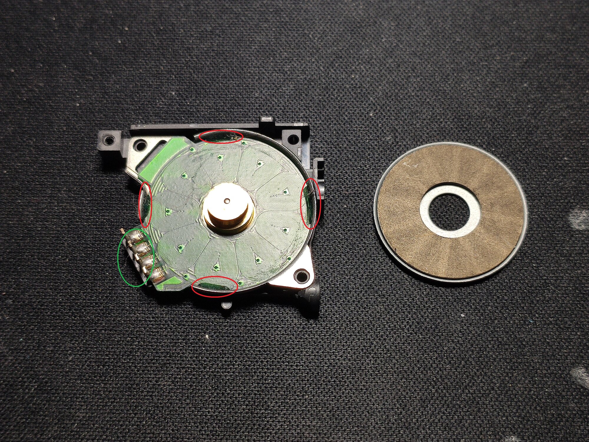

    3. Using a sharp tool remove the glue that attaches the coils PCB to the outer cage (marked red). Pay very careful attention, as there are very thin traces close to the edge.
    4. Desolder the outer plastic part with pins from the PCB (marked green).
    5. Remove the PCB.
    6. Remove the rotor.

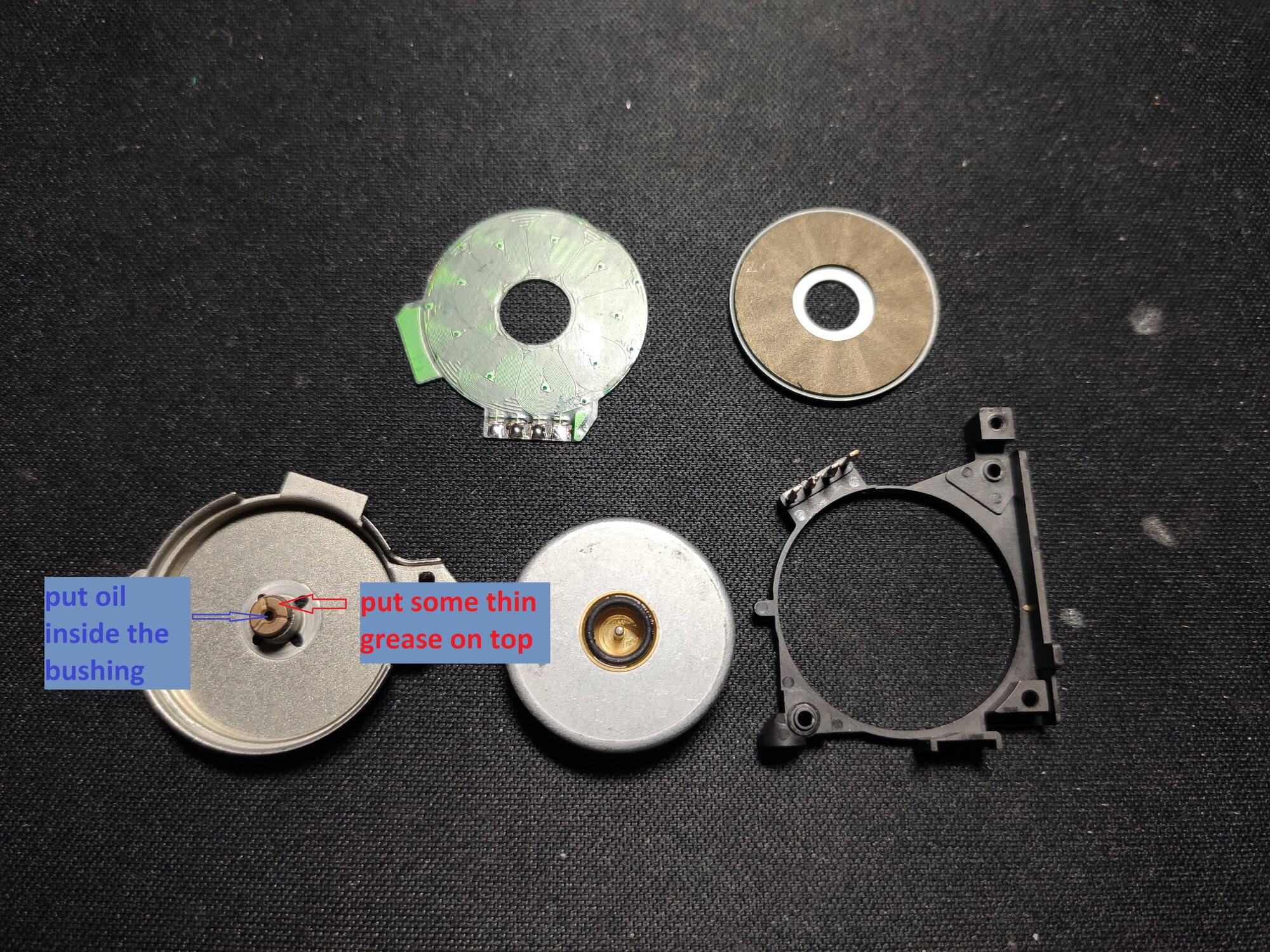

    7. Clean the shaft of the rotor and the inside of the bushing with a cotton swab immersed in IPA.
    8. Put oil inside the bushing. I recommend using watch oil. Make sure it gets to the other side, on the pastic plate.
    9. Put grease on top of the bushing, where it makes contact with the rotor. I recommend using a very thin grease, like SW-92SA or similar. You can put oil if you don't have thin grease.

    1. Step 2 is very important, top magnet will not come off unless 2 prying tools are used. Despite the magnet is strong (neodymium), the top rotor can be taken off relatively easy.
    Failing to do this can detach the brass pulley from the bottom magnet, making it eccentric.
    2. Also in regard to step 2 it's VERY important to pull just the top disc, without the bottom one together with it. To obtain this keep one finger on top of pulley while pulling the disc.

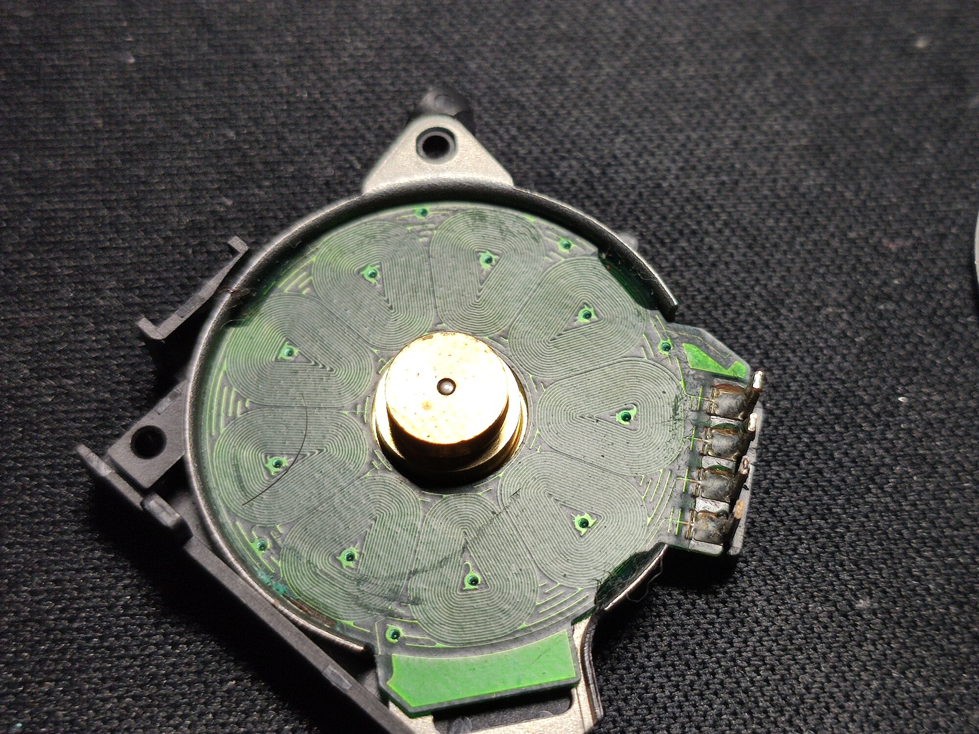

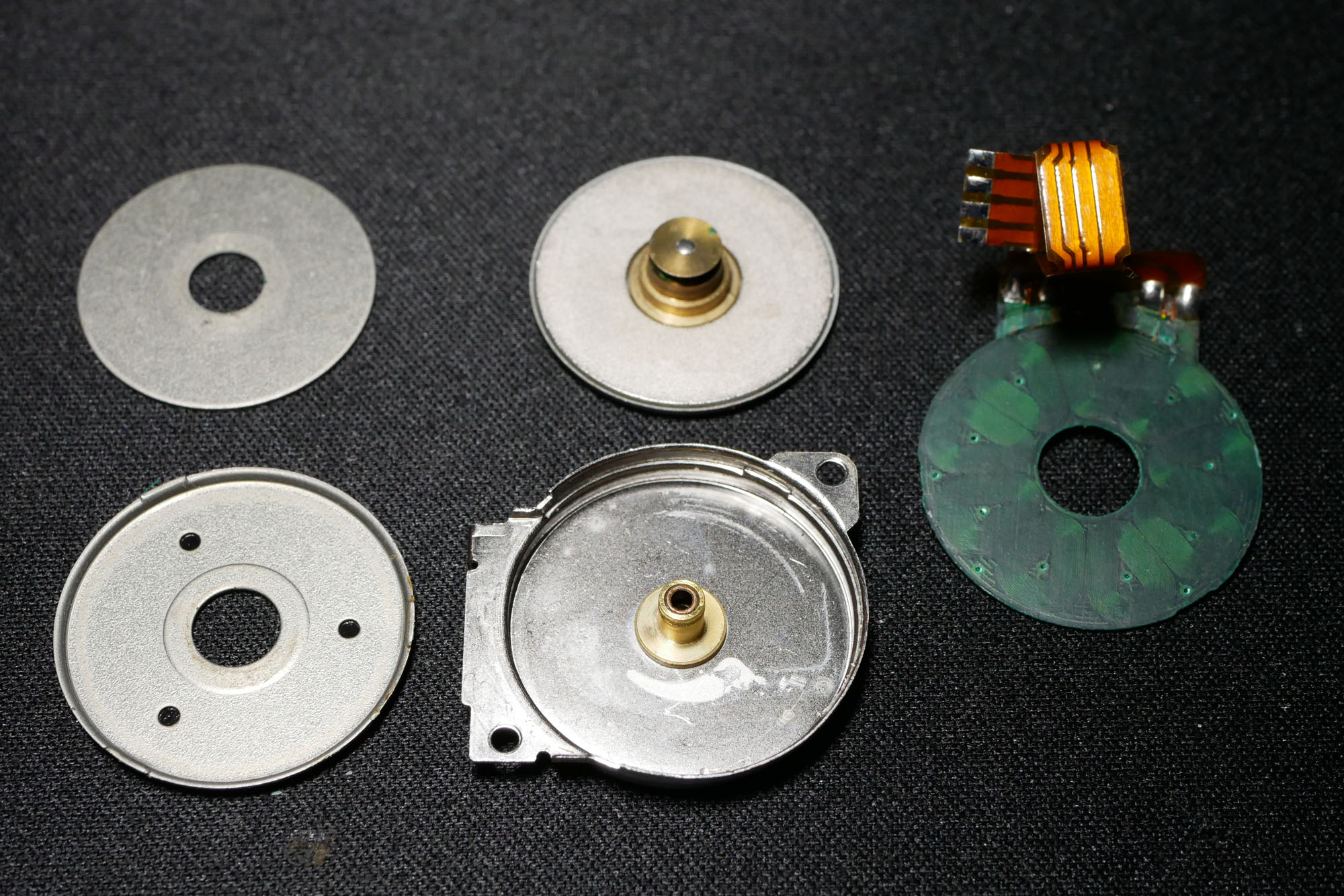

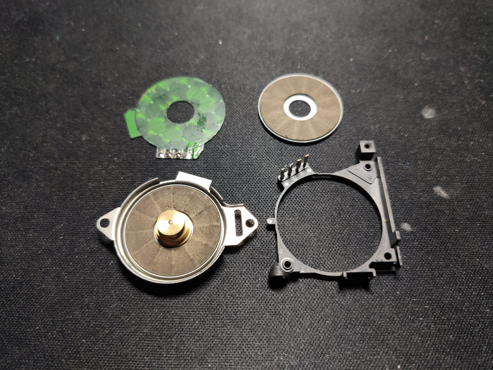

    Want to add some clarifications, especially in regard to points 3 and 5, as these are the most diffcult from the entire process.
    3. When removing the glue, you need to be very careful to not damage the coil traces. A sharp metal tool is needed, like the tip of a pair of tweezers of a very sharp blade.
    However don't freak out if some small chunk of the PCB breaks off, that can happen but traces will remain intact.
    Heating the chassis with a soldering iron will also help in softening the adhesive.
    5. After the visible glue has been removed, the PCB will not come off without force as there is still glue underneath in the areas shown in attached picture.
    What I have found to be very useful is heat the chassis of the motor right below those areas with a soldering iron and then very gently pry off the PCB starting from those 2 areas.
    In some models, the glue in this area is very stuck and not heating the chassis beforehand will break the PCB.
    Even if you have broken the PCB, the traces are usually still intact. So take your time and remove the remaining part carefully and you will be able to put the motor back together.

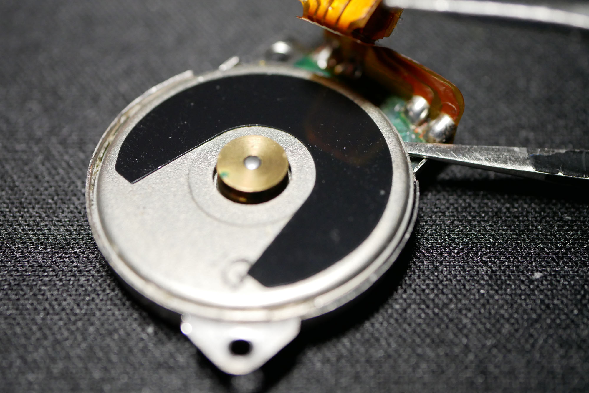

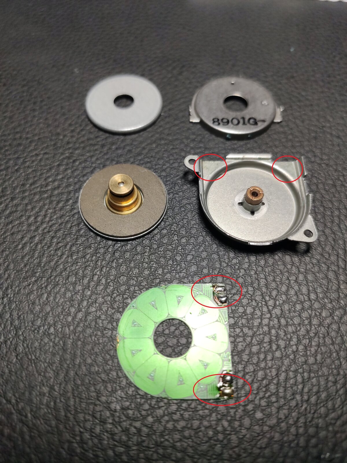

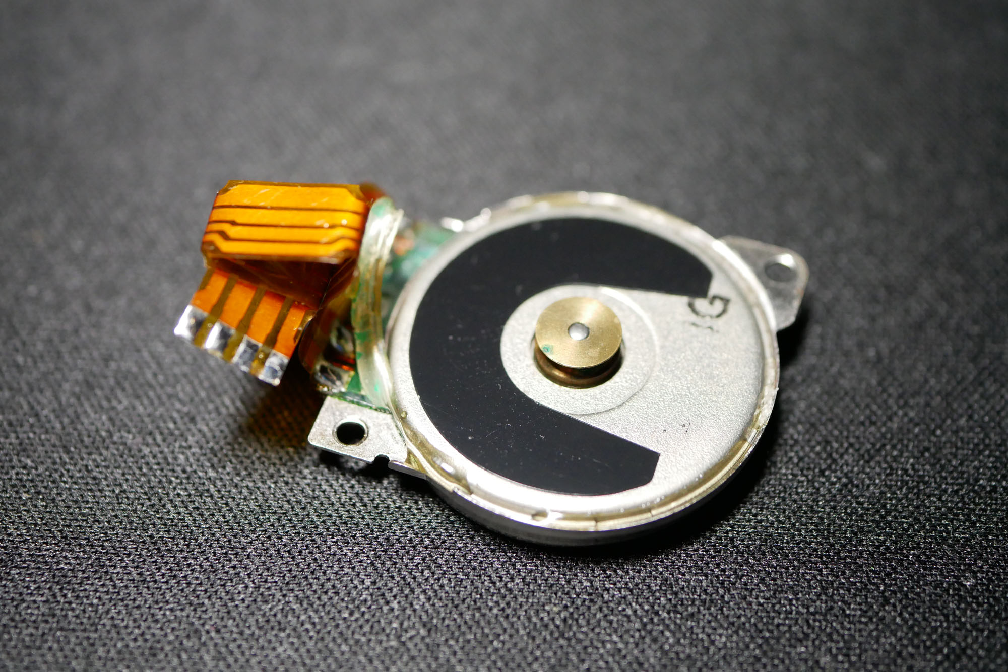

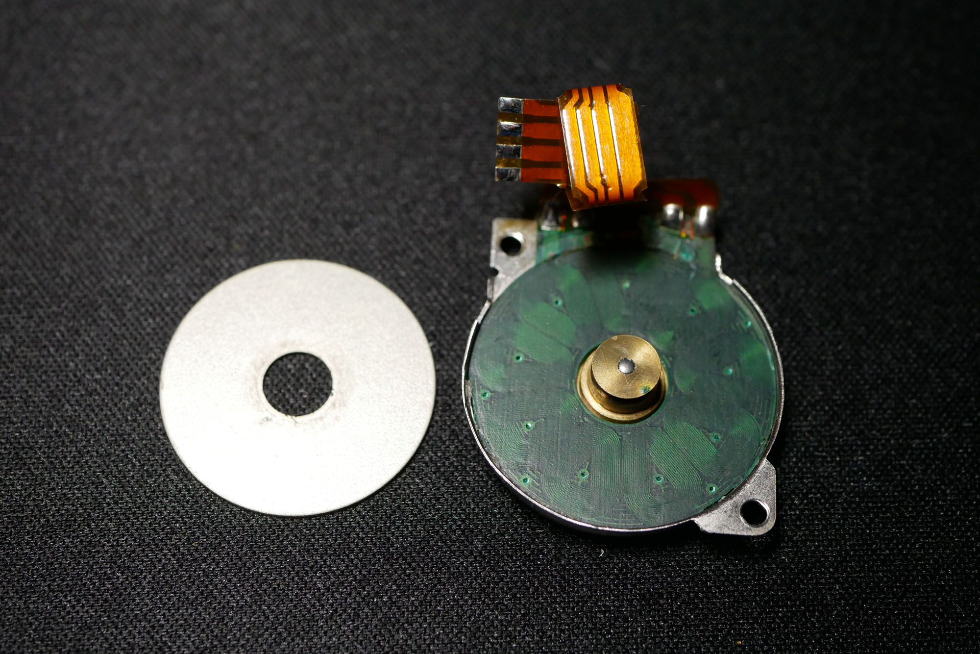

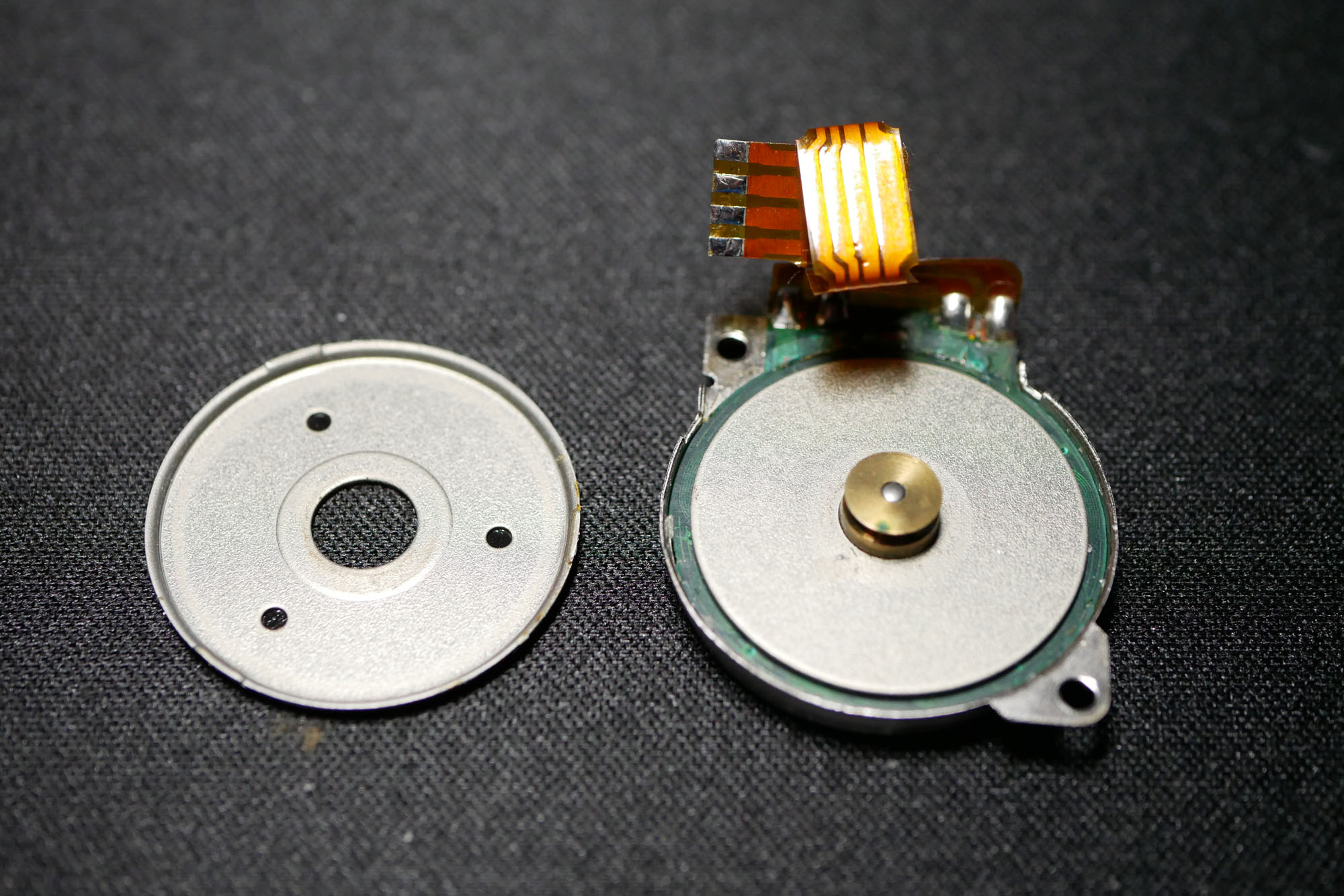

    Here are some images with motor used on WM-EX60/EX70/EX66/EX77/EX88/FX707.
    Motor is very similar to the ones depicted above, only differences being the case and fact rotor has only 1 magnet not 2.
    Unlike one shown in first post, the PCB is not glued on the case on this one, hence easier to disassemble.
    For easier removal of glue, heat the case with a soldering iron.
