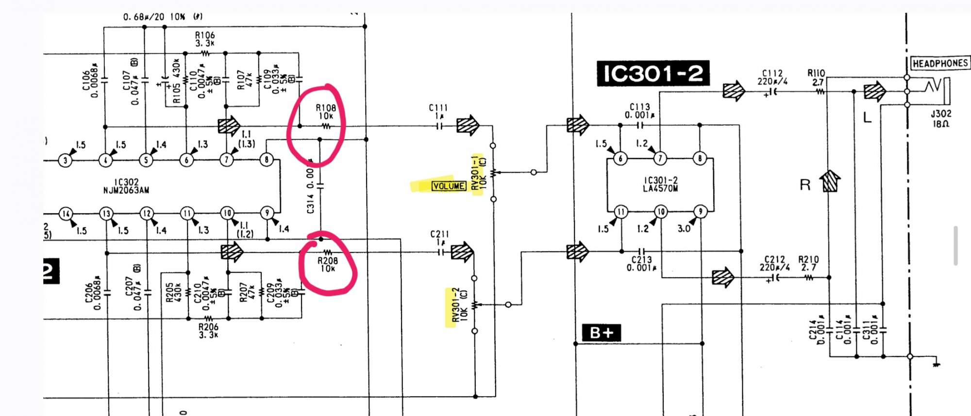

    There are 2 main ways to fix your problem: increase the series resistors at the output (this will change the frequency response) or to linearize the volume potentiometer.
    Second is prefferable since I assume your main problem is you are only using 30-40% of the range volume potentiometer has.
    For doing that you can add a resistor in series with potentiometer wiper (10K).

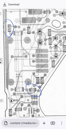

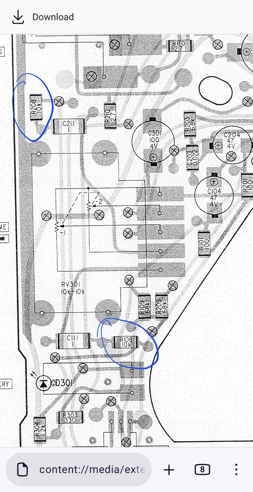

    The pot is actually 2 pots in one.
    There are 2 10k resistors prior to the knob, so that's what I was considering modifying assuming an additional 5k~10k would make it do. This being said, there are two smal caps between these resistors and the knob. Under this circumstance, does it still make sense to raise the resistance of these 2 resistors?
    Screenshot_20261007_095925_My Files.jpg Screenshot_20261007_094922_Firefox.jpg
    (Resustor highlighted in blue, the knob is the component with 5 rectangular tabs)
    Well this what my analysis came to, ...until I removed the shiny new Duracell Ultra installed while servicing the dd10. I installed some duracell (not fully charged) nimh battery and all of a sudden the volume went back to acceptable levels.
    I have to say that relying on a weaker power source seems a far less troublesome approach than messing with the PCB...

    You need to put the resistor in series with the cursor rather than increase the value of R108/R208 to 20k.
    As for the alkaline vs NiMH, volume shouldn't vary that dramatically between 1.5V and 1.2V/cell.
