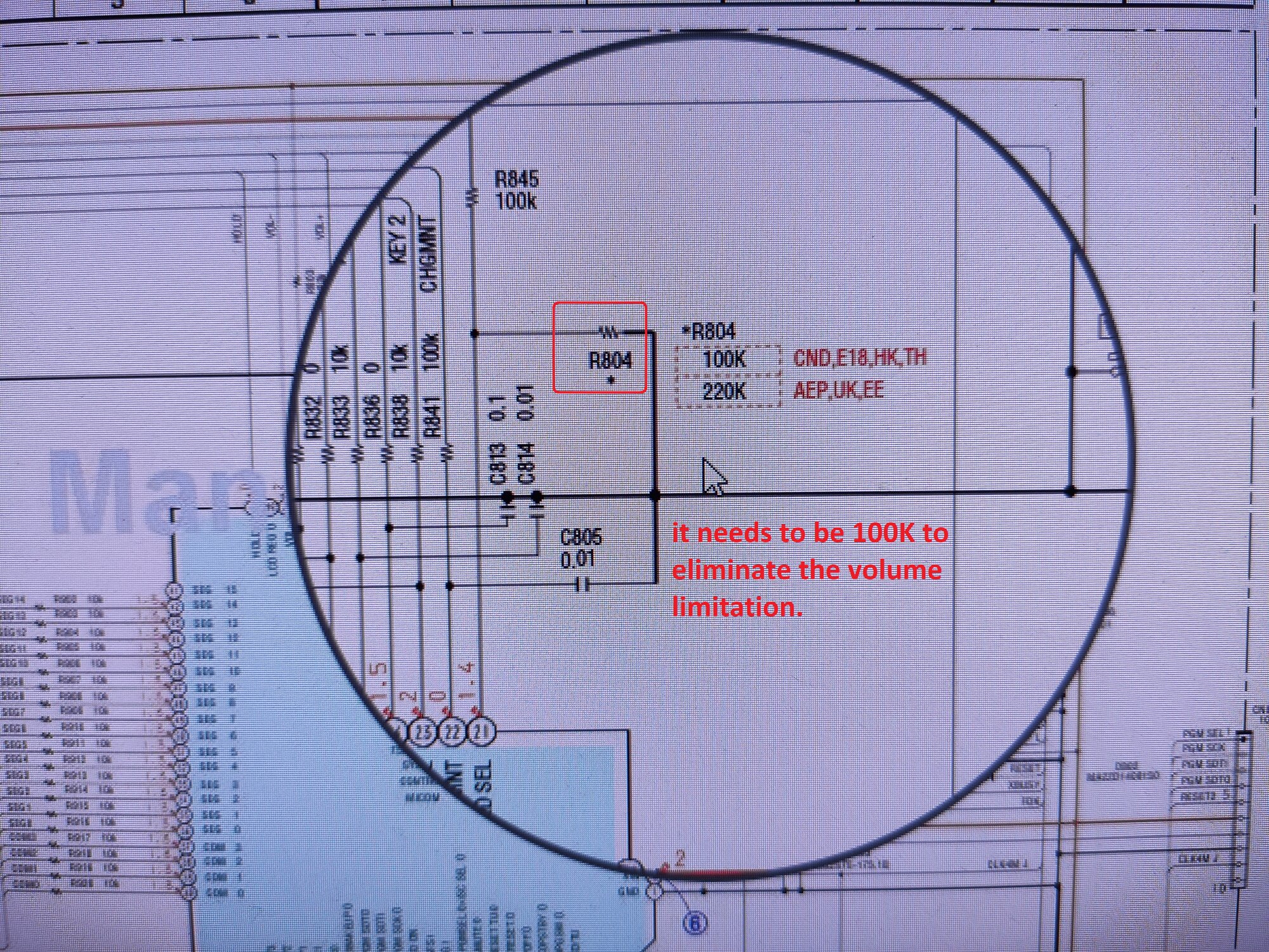

    Models sold in EU are limited to 1.5mW x 2, compared to the rest of the models who output 5mW x 2.
    At 1.5mW the device is only useable with sensitve IEMs, being unable to drive any bigger over-ear headphones at a decent volume level.

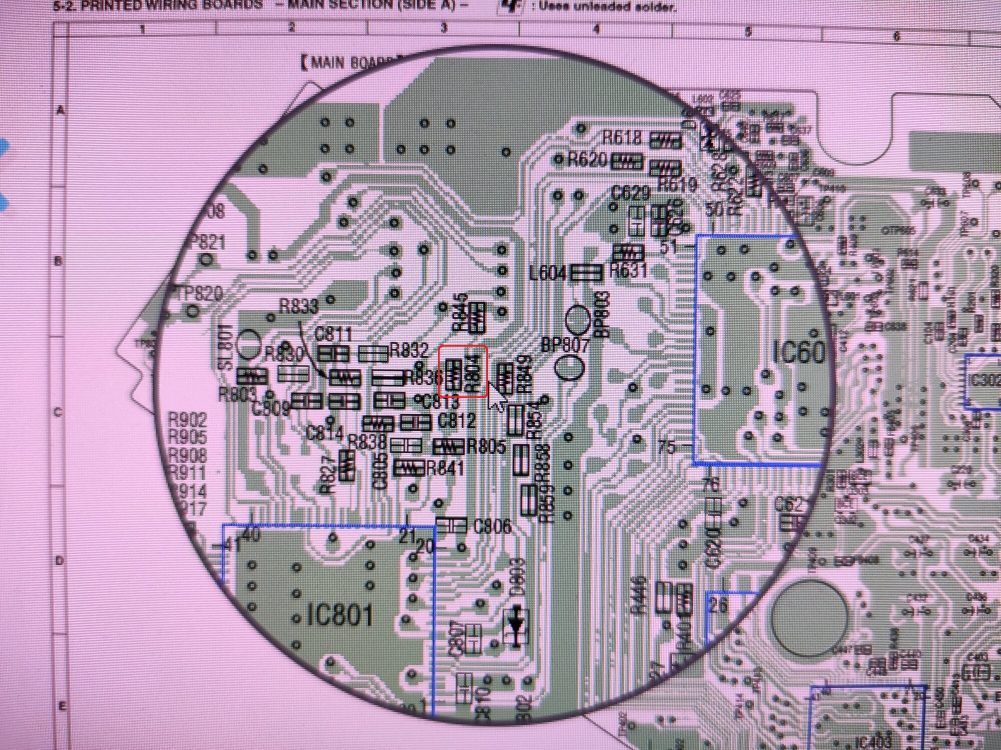

    Other Discmans in the series have same problem and solution is similar, just that the resistor which need replacement may be in a different postition. You need to check service manual of individual unit to confirm this.

    NOTE: R804 will measure significantly lower when measured in-circuit, so if you want to just check, you need to desolder it first.

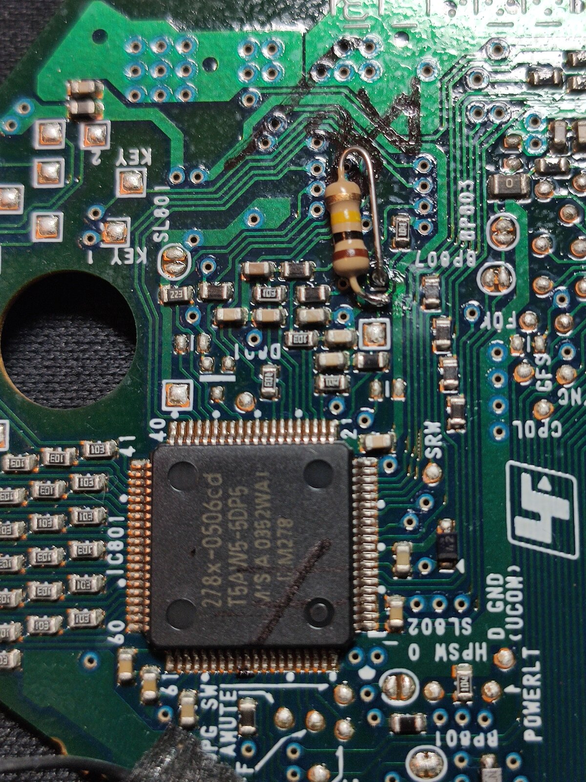

    4. Remove R804 and replace it with 100K SMD resistor 0805 package.
    Note that I used a 0.25W THT one for testing purposes only.

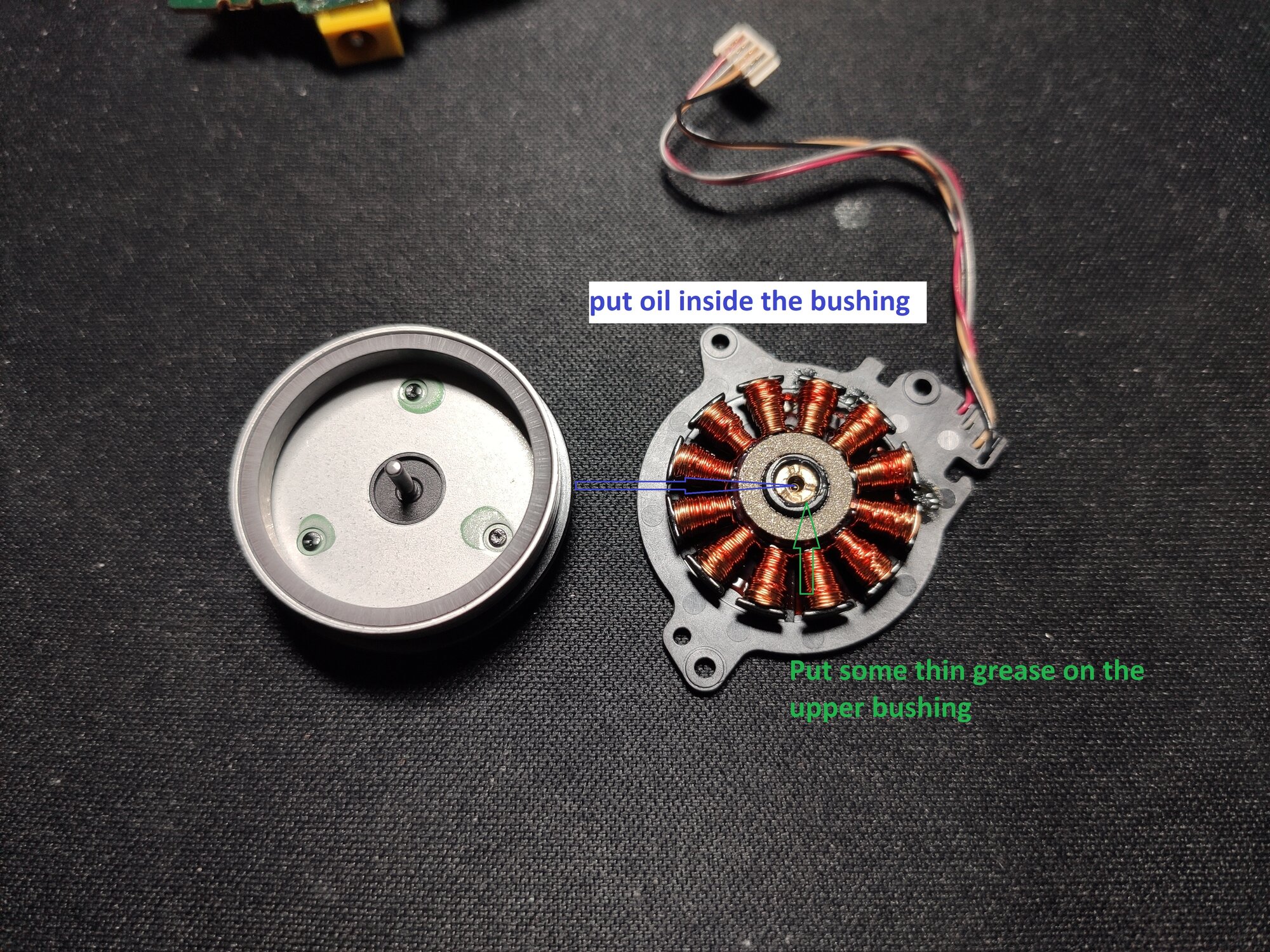

    6. Remove the spindle motor and lubricate it.

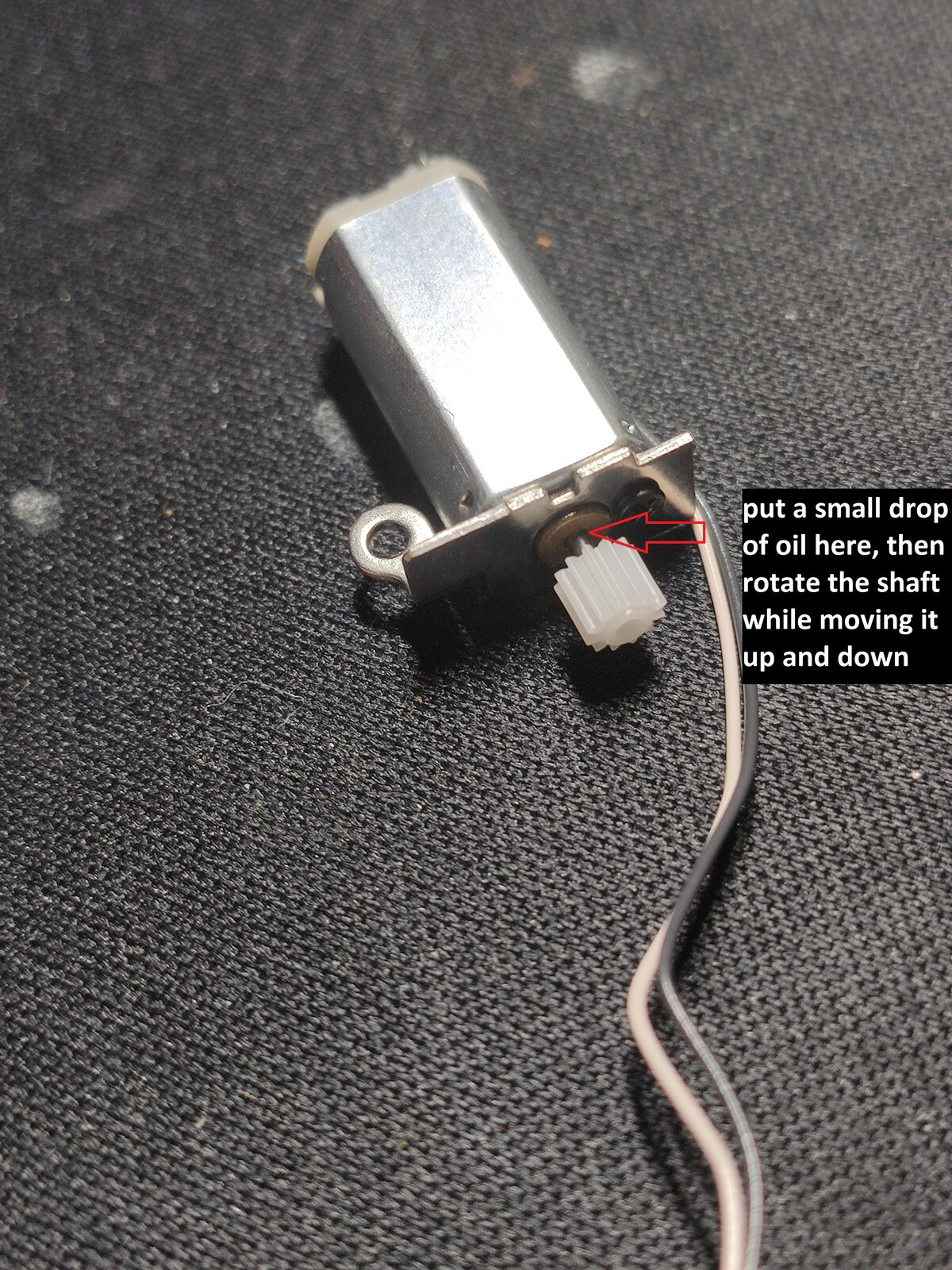

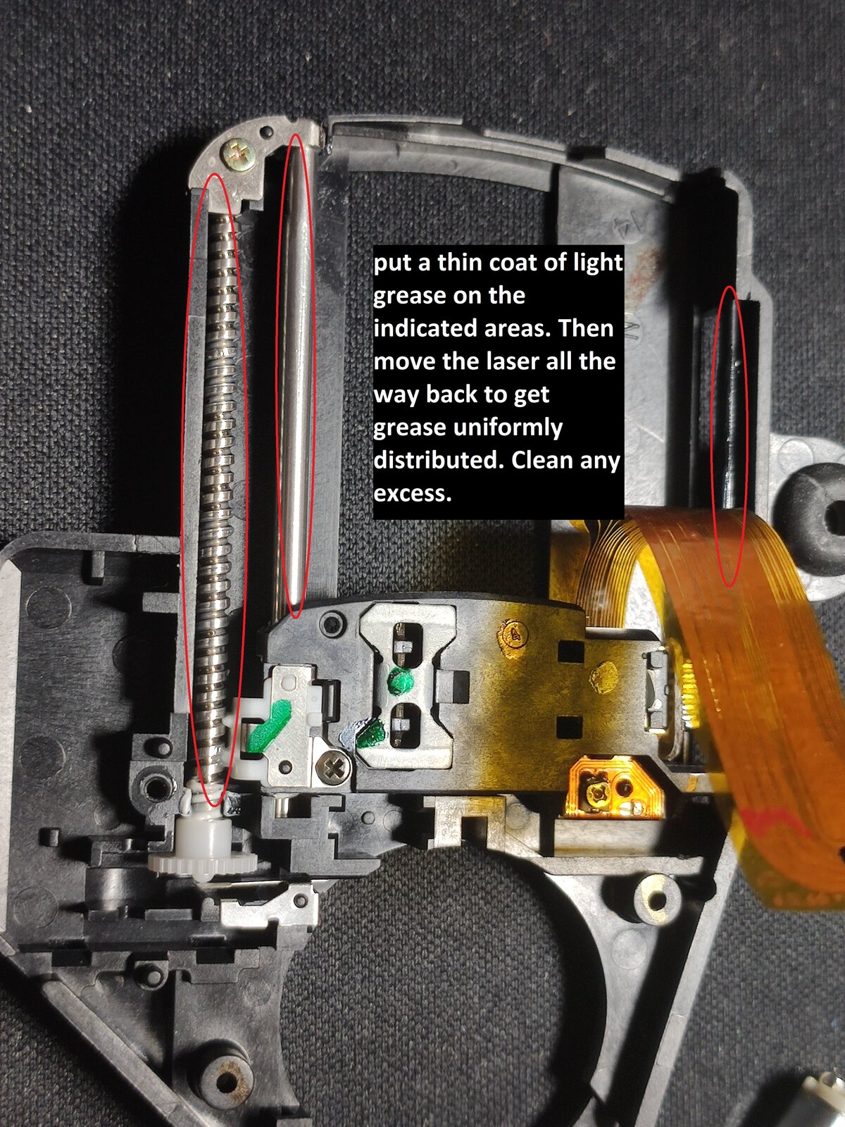

    8. Lubricate the sled motor, sled and laser rails.
