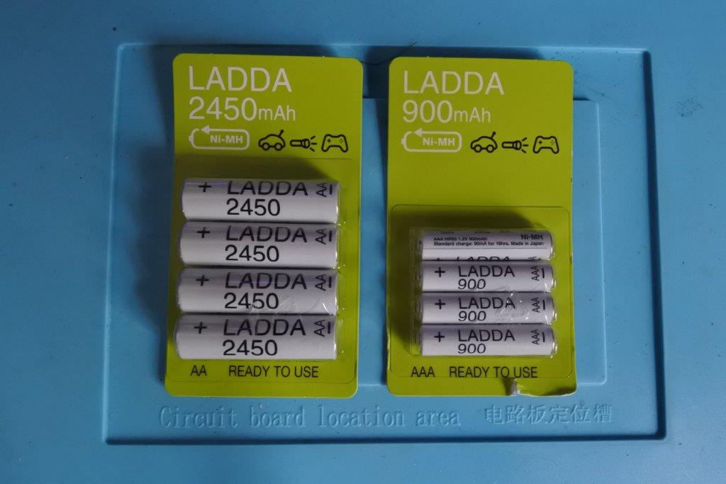

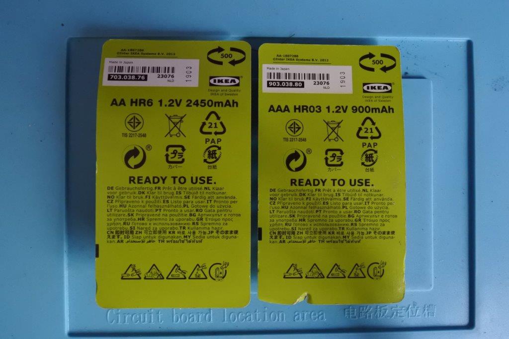

    I splurged on some Ikea Ladda Batteries and was happy that both AAA and AA are Made In Japan which may indicate Eneloop Manufacturing. I was going to order them from Amazon but I've been hearing stories about counterfeits and the price has been going through the roof on them lately. The Laddas are 2450 mAh compared to Eneloop Pro's 2550 mAh but they're 2.5x less expensive.
    I think the last time I bought Ladda AAAs, they were made in China so this is a welcome addition but they were very low on stock.
