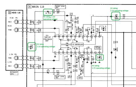

    Rule of thumb is the rating should (ideally) be twice the operating voltage or more. We also have space constraints in most cases.
    Will take the AIWA HS-PC202 as an example, but this is true for most slim walkmans where size of the capacitor is the biggest concern.
    While of course when restoring a walkman one should check the original rating and operating voltage, for the vast majority of scenarios
    4V rating is good as most of these slimmer walkmans operate on 1.5V, 2V (some AIWAs) or 3V (2 x AA/AAA cells).
    Also most capacitors will work at lower voltages than the supply rail.
    Not to mention in practice designers don't always use caps with ratings of twice the voltage.
    See the example attached of TC-D5 series from SONY which use 220uF/10V caps on the main +/-9.4V rails.
    And guess what ? These units still work after 45 years with no hum/noise.
    While I do replace these 2 caps when I service these units with 25V rated ones since new 25V ones are same size as old 10V,
    I did measure some of them on the LCR meter and they're not that far off from new ones.
    There are many situations where the rating can be lower than original and still have enough margin left.
    As for working for a shorter period, in theory that's what is going to happen if they're operating very close to the rating.
    In practice I've seen many such cases (not talking just about walkmans here) where such caps have lasted for a very long time.
    For the most part, using common sense is important: don't use a 6.3V rated cap in a 6V circuit. However using a 2.5V rated one in a circuit that operates at 1.5V will be fine.

    1. This is a list of the most commonly used capacitors for walkmans that actually or usually require recapping. In other words, this is for walkmans afflicted by capacitors that are known to fail. As it happens, most of these are of the slim late 80s to 90s variety, and virtually all of these run on low voltage. In fact, most of these are originally specified with 4v and 2v caps for the larger values (especially 220uf and 100uf).
    2. In these machines, size is the biggest constraint, Especially height. This list is meant to help those casual users recapping these machines find suitable caps (which are slightly more difficult to find) with no effort. Caps of larger sizes and voltages are much more readily available and you should have no trouble finding them yourself whatsoever. For example, an enthusiast model that definitely needs recapping is the JX707 and its derivatives. Guess what? Nothing over 5mm will fit on that model without slightly or significantly bending the board due to space constraints. You only had 1 choice of SMD cap that would fit which is the Nichicon UZS series and that's gone now. (I was supposed to add the UZS to this list but that cap went EOL before I could be bothered to do so, Chemicon MVY was the other option, also EOL).
    4. I'm assuming that the person reading this list is at least reasonably competent with electronics and would not use a lower voltage cap than what is specified or required. Very few walkmans that actually require recapping due to capacitor leakage or drying out require higher voltage caps. Off the top of my head, other than some very early chonky models, the DCC portables are the only ones that must need a recap and need some higher voltage caps.
    5. I'm assuming you are offended by my list as you are interested on recapping your D6C based on what you've messaged to me about recently. The D6C is one of the few models that do use some 6v and higher caps. However, The D6C does not usually require recapping, especially the through hole version. Unlike other DD units the 1st gen D6C (which uses through hole caps) is not known to have capacitors drying out or leaking, unless you are in a high temperature and humidity country where the aging is accelerated. Capacitor failure on the later SMD revisions is relatively rare and I've only had to do that once on a 3rd gen unit, and that unit was from a high heat/humidity country. Even if you need/want to recap a D6C there is a lot of height/space available and there is no real need to create a list of capacitor models for it as there are so many options! You should have no problem sourcing caps that would fit from any major supplier. Again, since capacitor failure on the D6C is relatively rare, I'm assuming that if you have the knowledge on diagnosing that it is a degraded capacitor at fault, you would also be familiar with sourcing caps.
    6. I do not recommend blindly recapping a machine unless that it uses capacitors with a high rate of failure, or have clear signs of failure (leakage). While there is no harm in doing so (unless one is inexperienced with soldering and you damage the board), it is generally a waste of time. So, how does one know when recapping is required if there are no clear signs of failure? Measure the capacitor's ESR, and capacitance. If the ESR is much higher than expected and the capacitance is very far off (20%), then it is worth recapping (and you might as well do the whole machine when it comes to portables).

    @bub: I'm not at all offended by your list; the 4volt caps just seemed wrong to me. Then I realized that not ALL walkmans have a 6-volt rail like the WM-D6C does, and so 4 v caps would be fine in those units. Replacing ALL the polarized caps (84) in a WM-D6C would be a LOT of work and expense; it's just that I have had SO much trouble with aging tantalums in the past that I am quite leery of their performance. BUT....if it ain't broke, don't fix it, so I'll leave 'em be for now.
    Cassette2go likes this.
