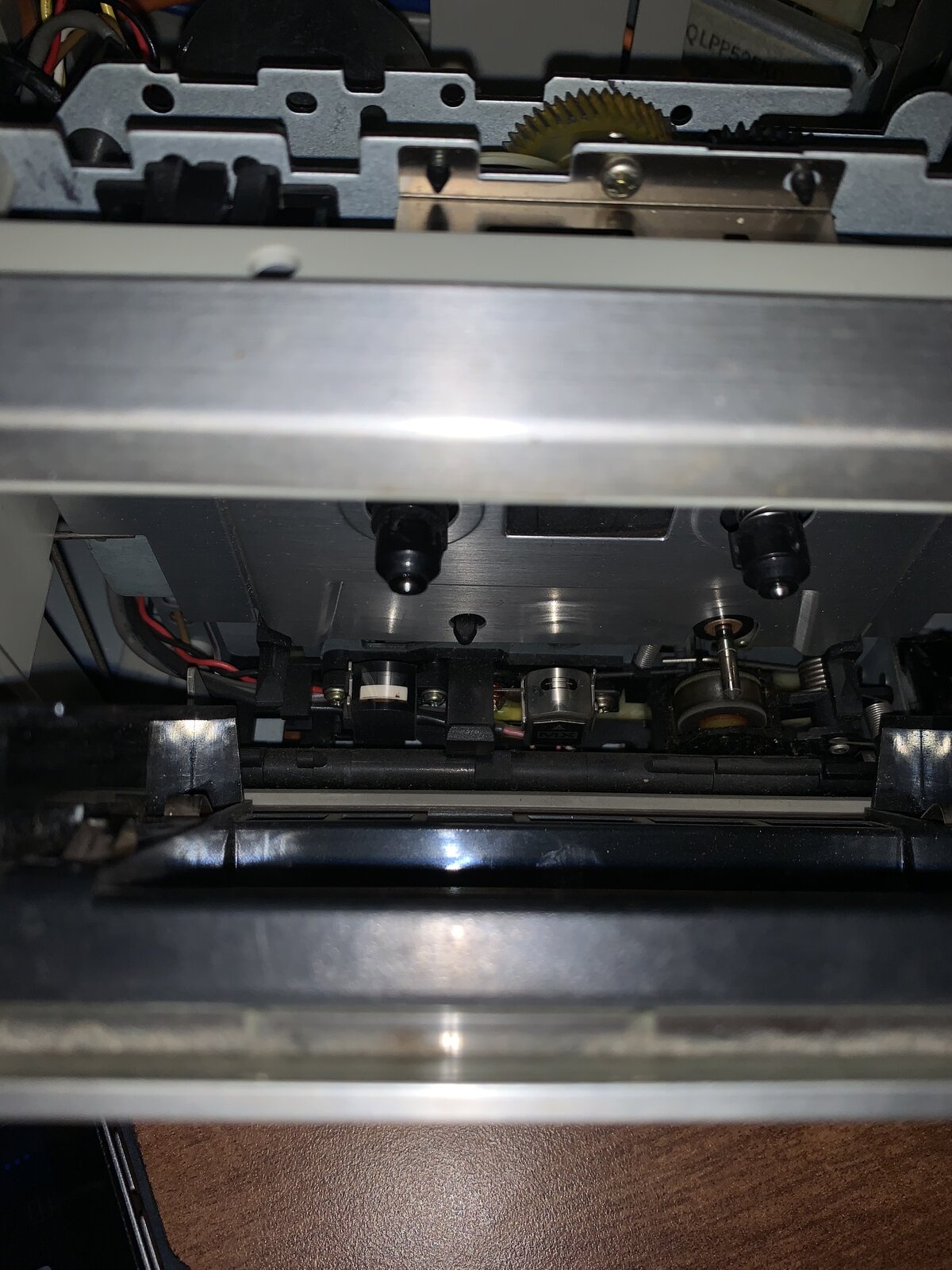

    I have a pretty good understanding of general electronics, just new to audio equipment. I used contact cleaner on all of the front switches and dials (bias select, dolby nr, and the input select) and also the trim pots for the recording current inside the deck. If I turn the right side potentiometer way up, it fixes the issue, but I don't really consider that a fix. I attached a picture of the heads, and it looks like there's some kind of smudge on the record head where the right channel would be. I haven't gotten to cleaning them yet, I will see if I can find some isopropyl around here.

    If I can find my multimeter, I'll give that a try. It turns out the both the erase head and the recording/play head were rather dirty, with some brown crud (maybe stuff from the tapes) on it, I'm going to hope that makes a difference.

    I'll be damned, cleaning the heads was actually the fix! It's not perfect, the right channel is still very slightly lower than the left, but I can adjust the pot just a little to the right and everything's hunky dory. I appreciate everyone's help!
