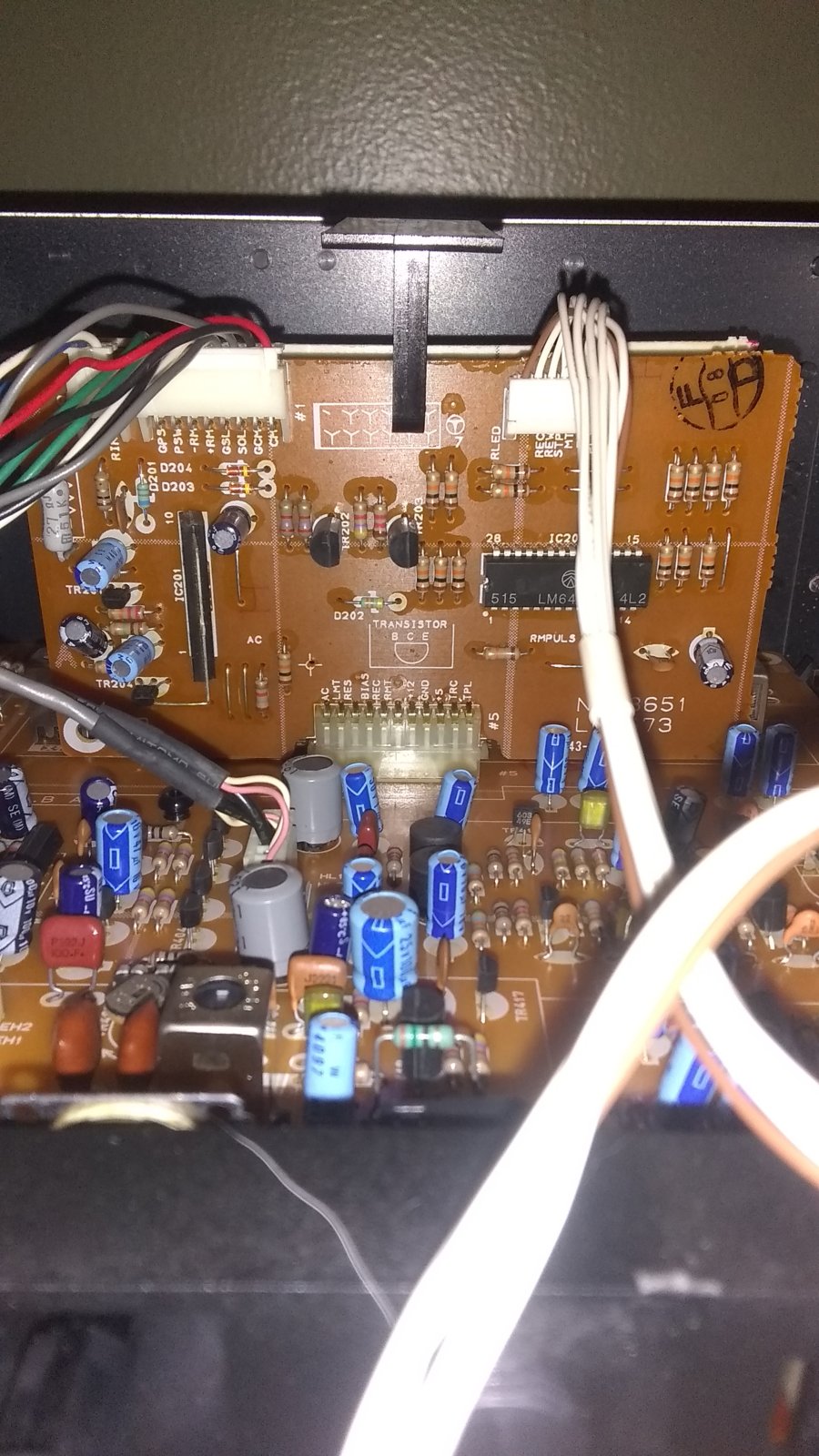

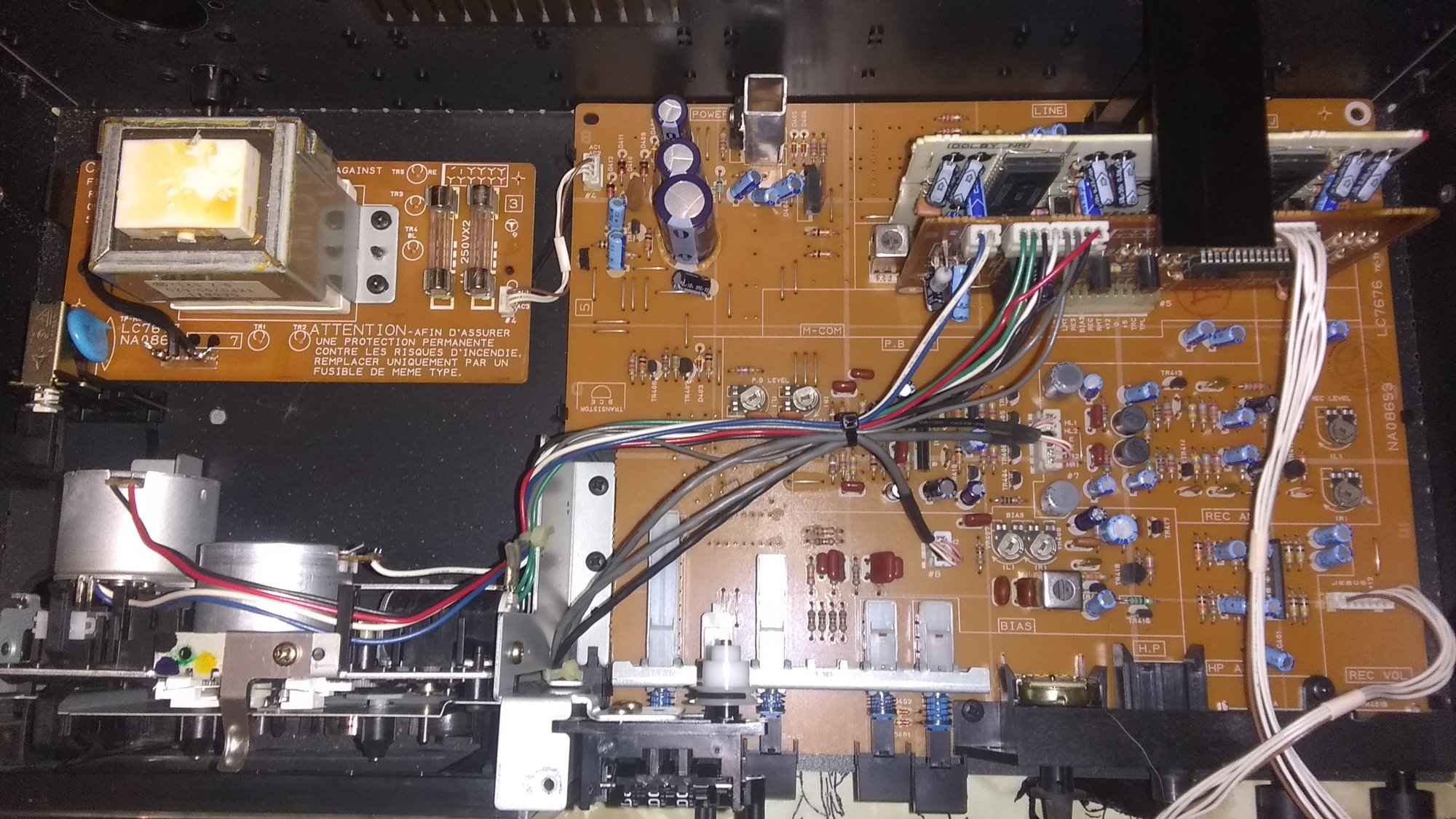

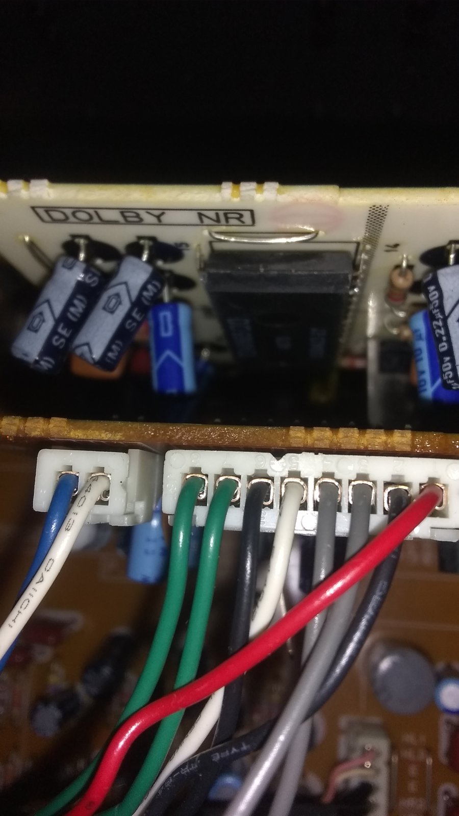

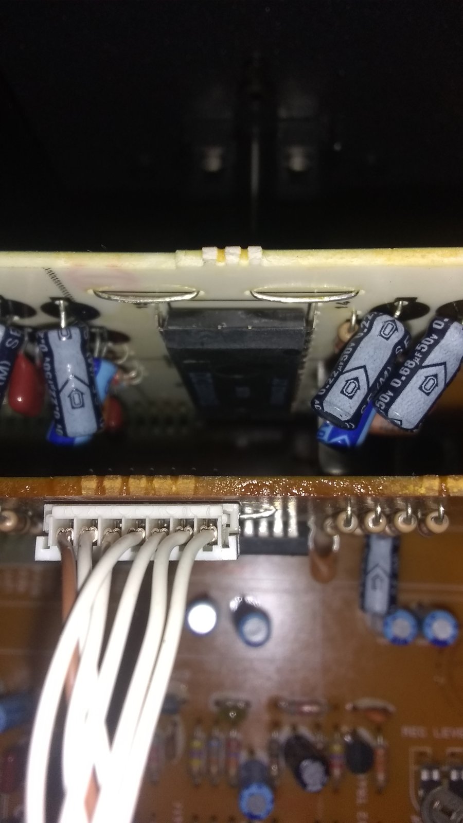

    My vintage Yamaha K-220 won't record all of the sudden. I keep trying to press the record button, and it does not active, even with the plate off. Play, reverse, fast forward, and stop all still work. Checked the fuses, and they look fine. Have no clue what else to look for. Any advice would be strongly accepted, this stereo is a family heirloom, and I want to try and restore it before resorting to replacement. Here are some interior photos....
