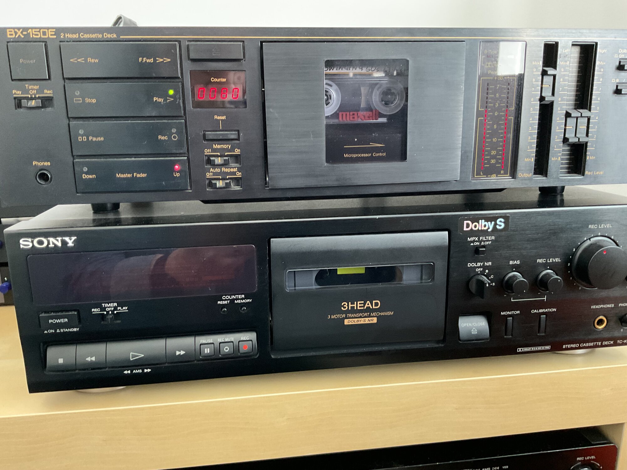

    Hi l was having problems with outputs on my BX-150 the left channel stopped working.The VR101 which is left channel I overdid the adjustment and broke off top of the pot and no longer works.
    I know it will work if I could get a replacement for the VR 101, wondering if anybody could help.

    I have fixed nakamichi 150 I ordered the pot and unsolderd the bad pot put the new one in and works fine
    I have to say I’m not to good at soldering but I got by.
    A couple years a go I fixed motor on cassette lift mechanism the motor had seized and took apart and fixed it so all is well now.
    Anyway thanks for the help
