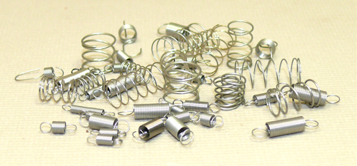

    There's a few places to get bulk springs, you may have to cut the ends off and get them to size. Sometimes you have to stretch them because they start out compressed.
    http://www.smcelectronics.com/vcrmech.htm

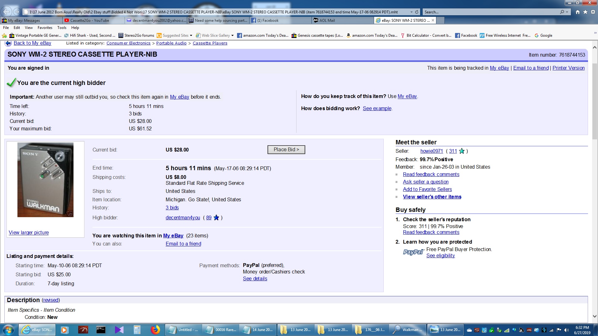

    Sony Walkman WM-2 in Ebay I am winning Sony Walkman WM-2 in Ebay I am winning.jpg

    P.S. I did not WIN that above Walkman & Nor do I have this model wm-2.
