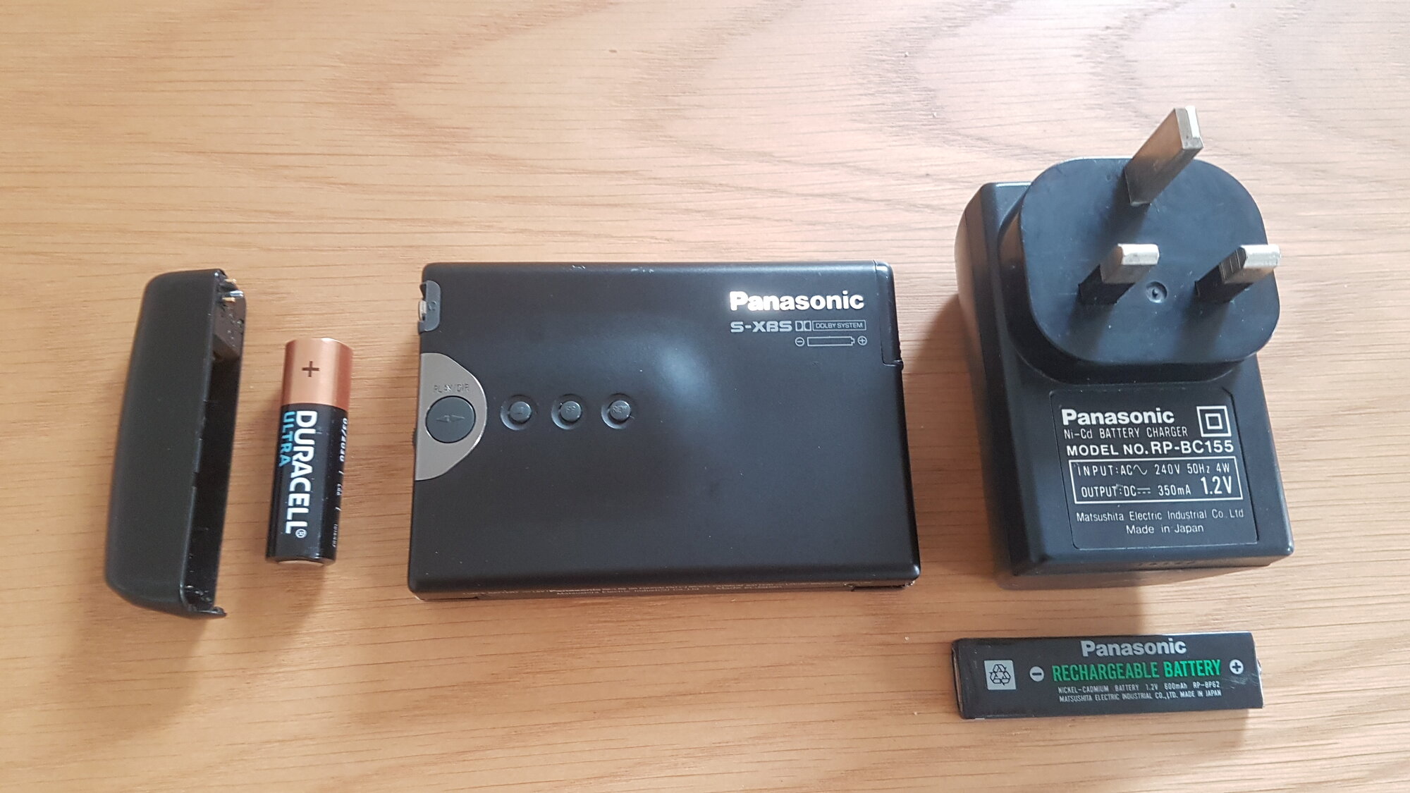

    This is not what I expected, reviewing old threads one of the problems by using a NiCd charger with a NiMh battery was the too long time of charging it.
    I was waiting black friday to make and order for a intelligent charger but this make me wondering if it has sense

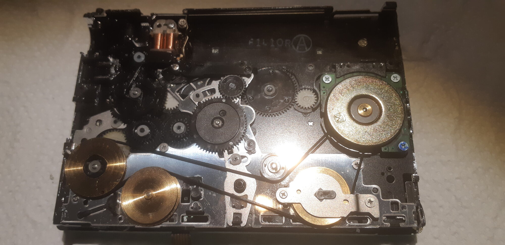

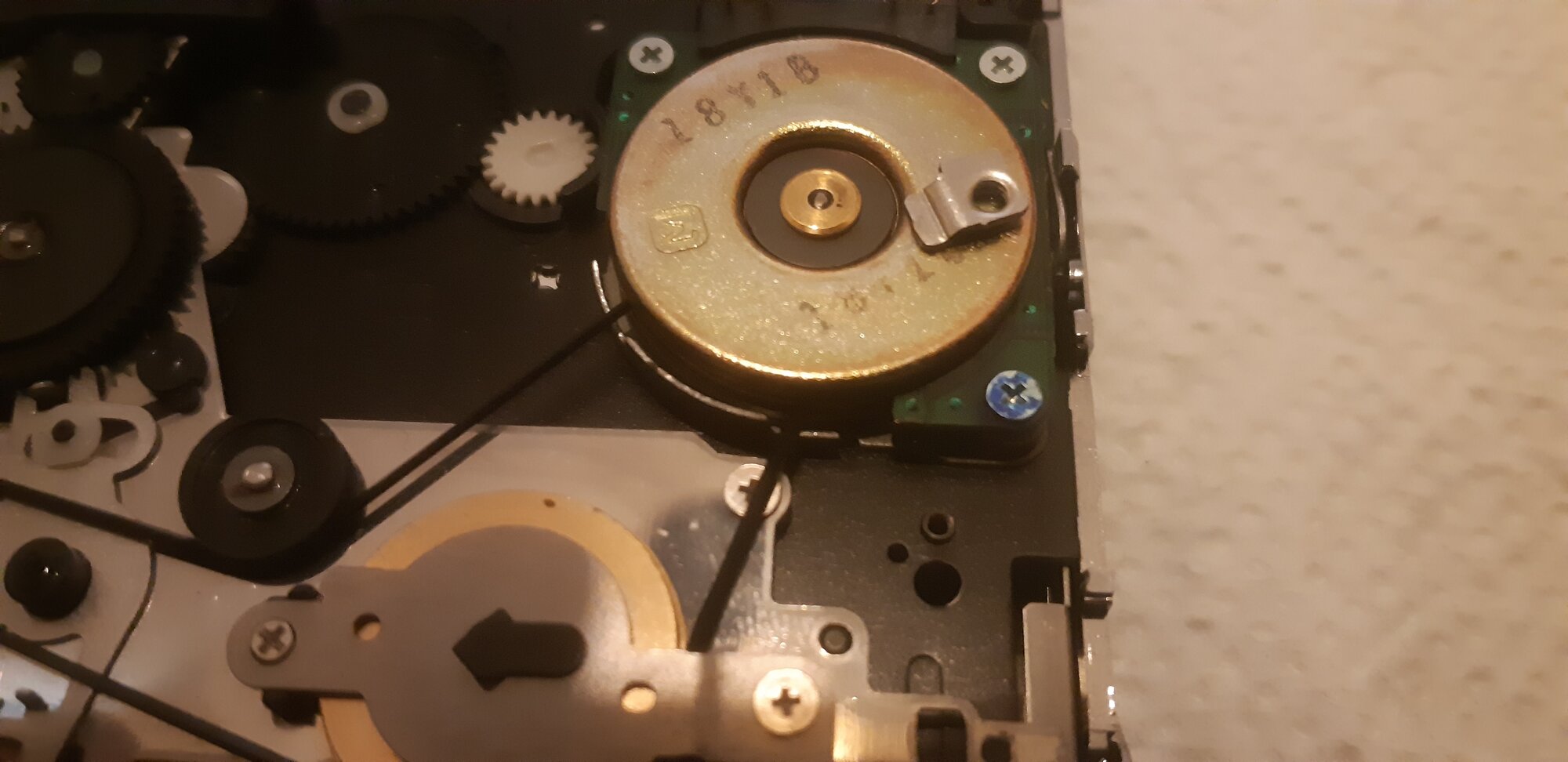

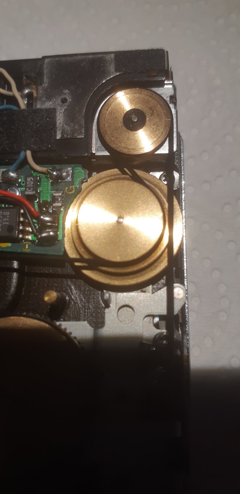

    I took a better pic of the belt, it seems thinner enough, althought as soon as I get the new belt I'll try

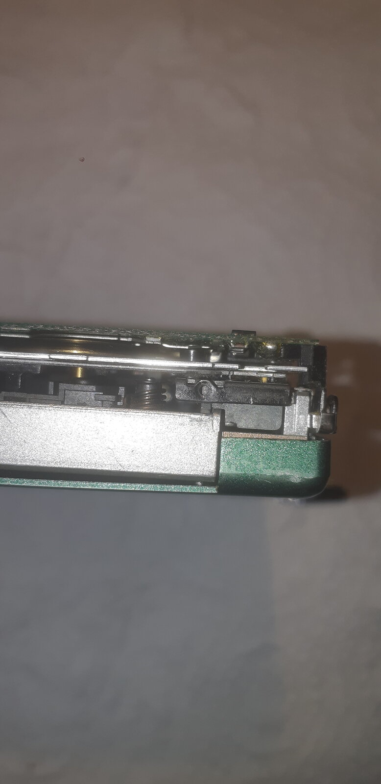

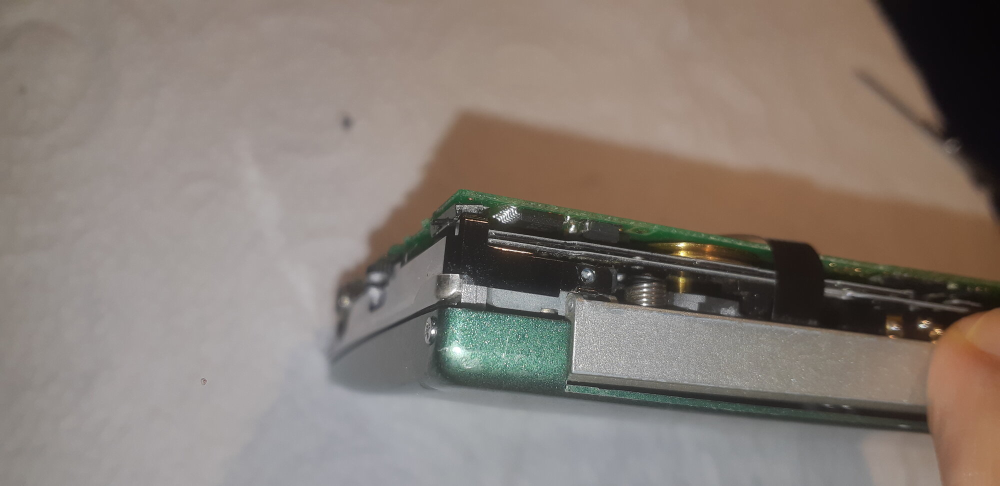

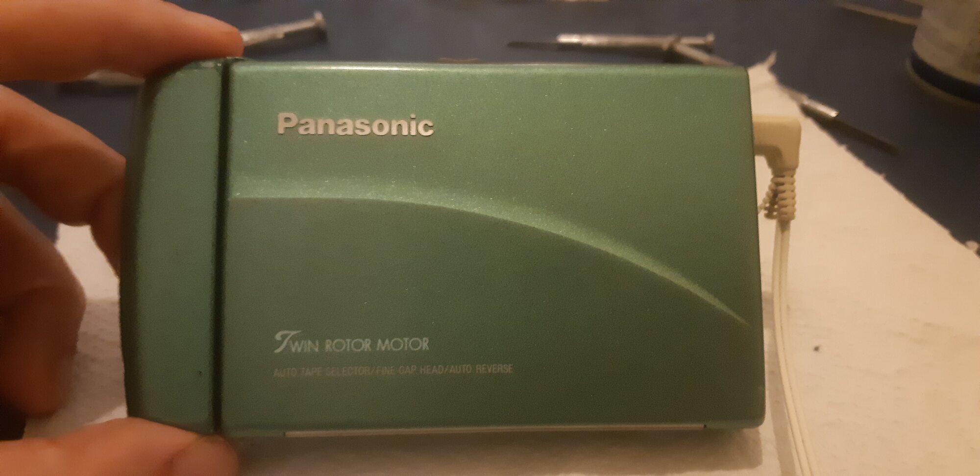

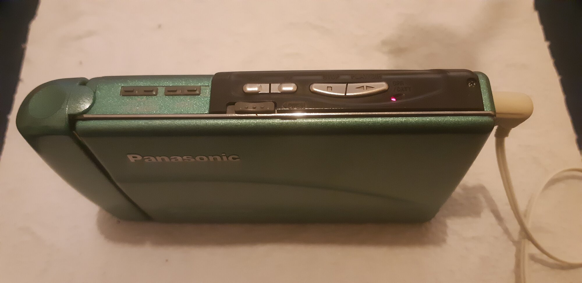

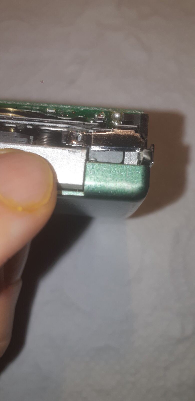

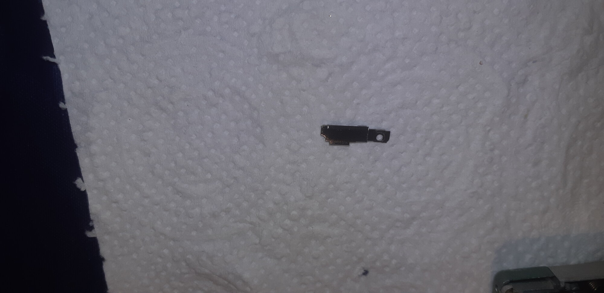

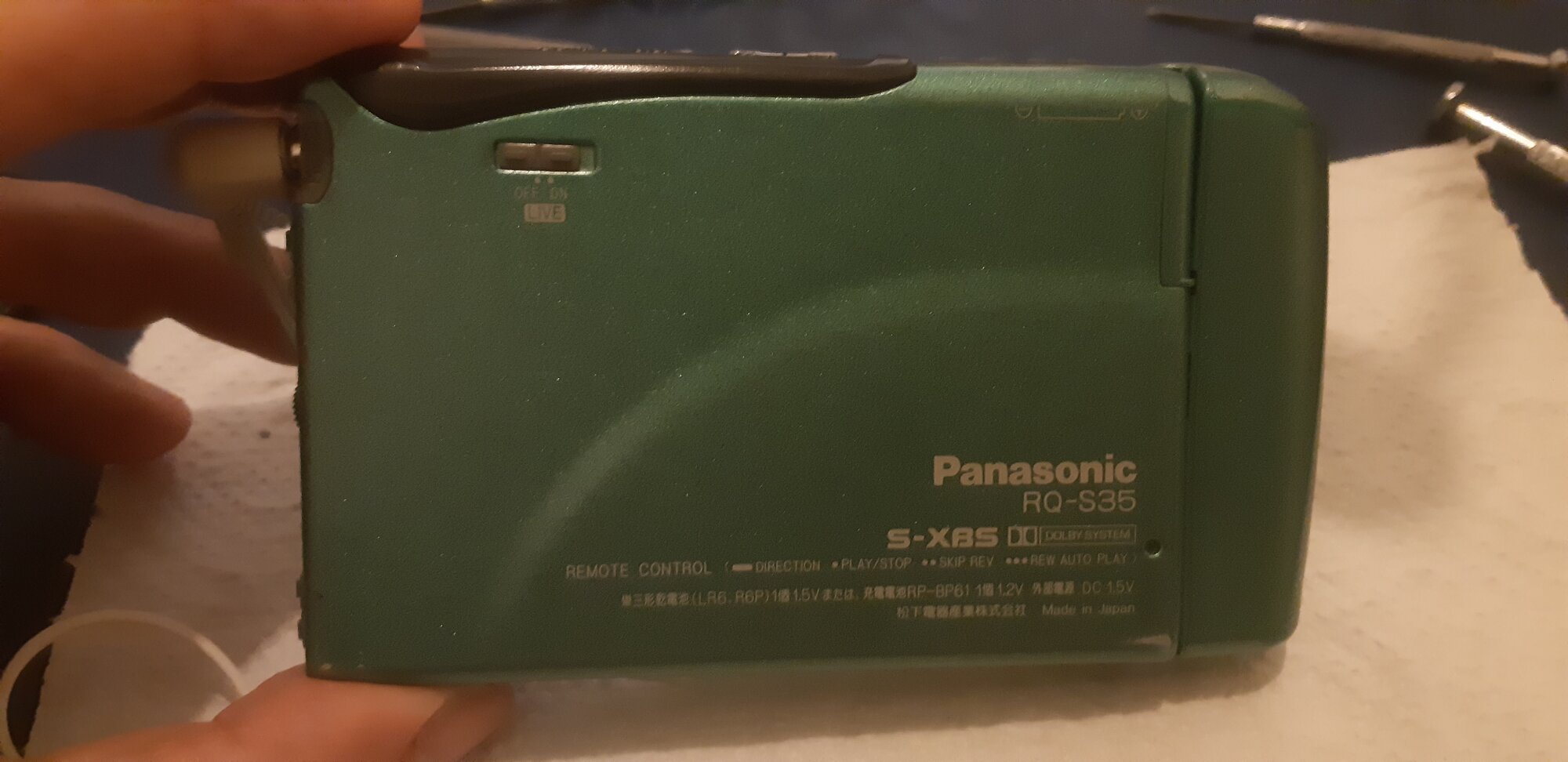

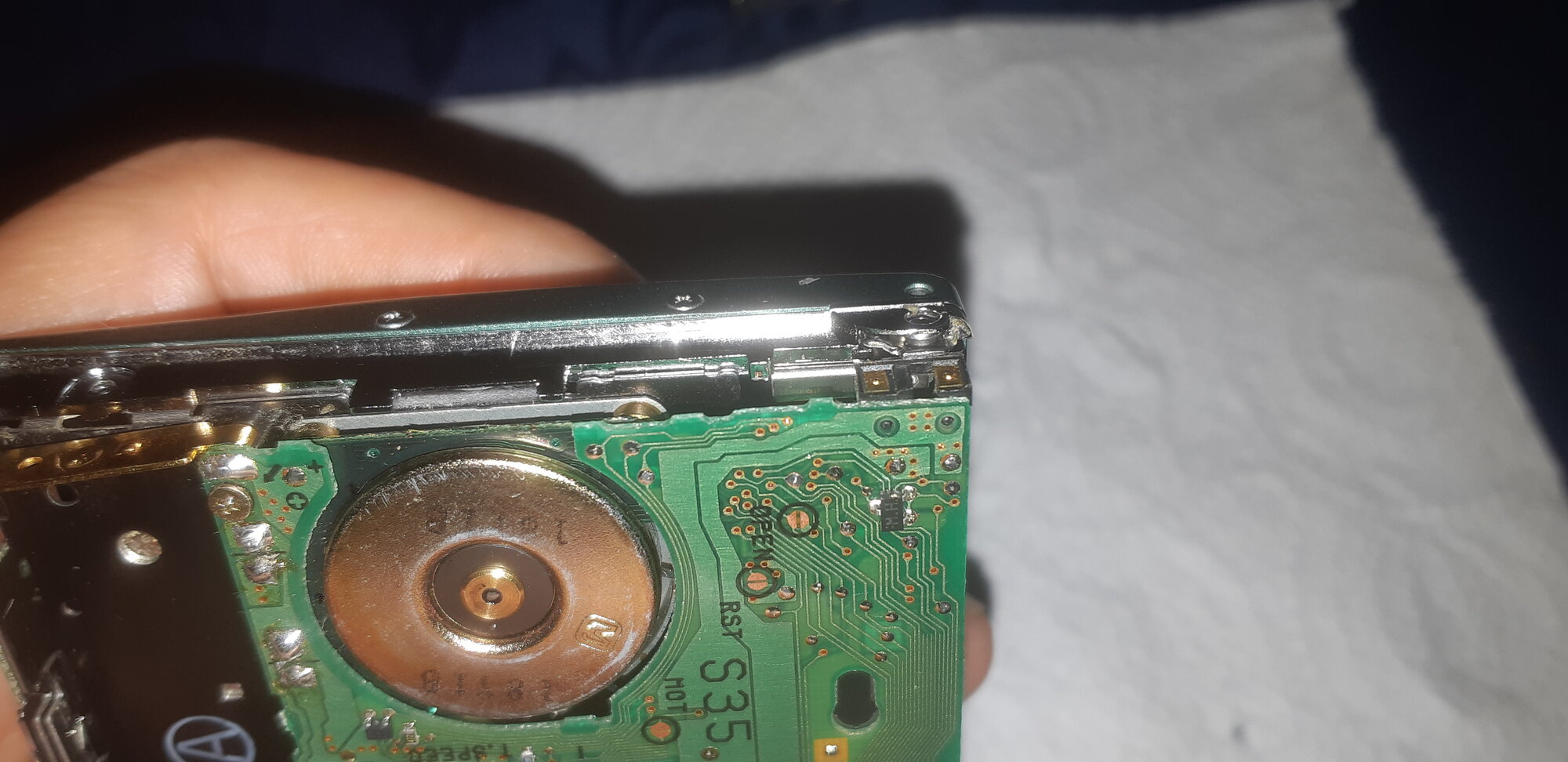

    20201128_174350.jpg 20201128_180334.jpg 20201128_180359.jpg Panasonic RQ-S35, I ordered a new belt at Marian's, this weekend I had working on it. The seller noticed me that the battery box doesn't fix properly, He holds it to the unit with a rubber band. When I opened it I found this

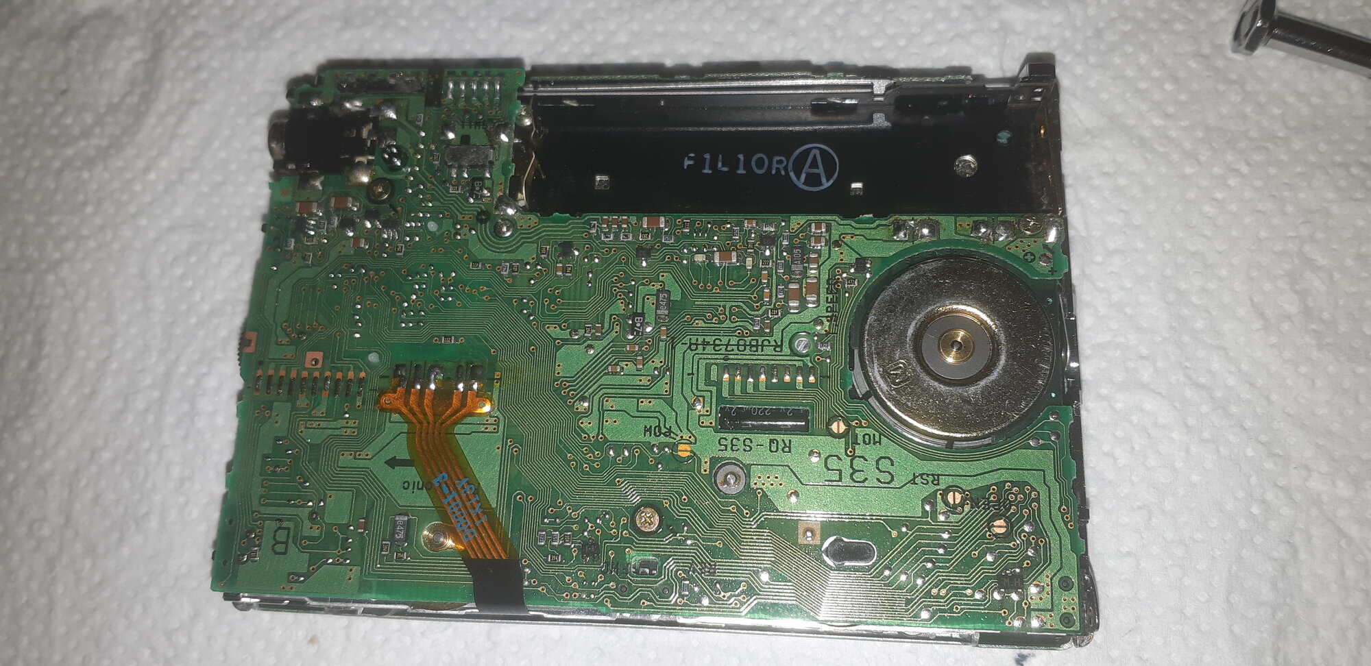

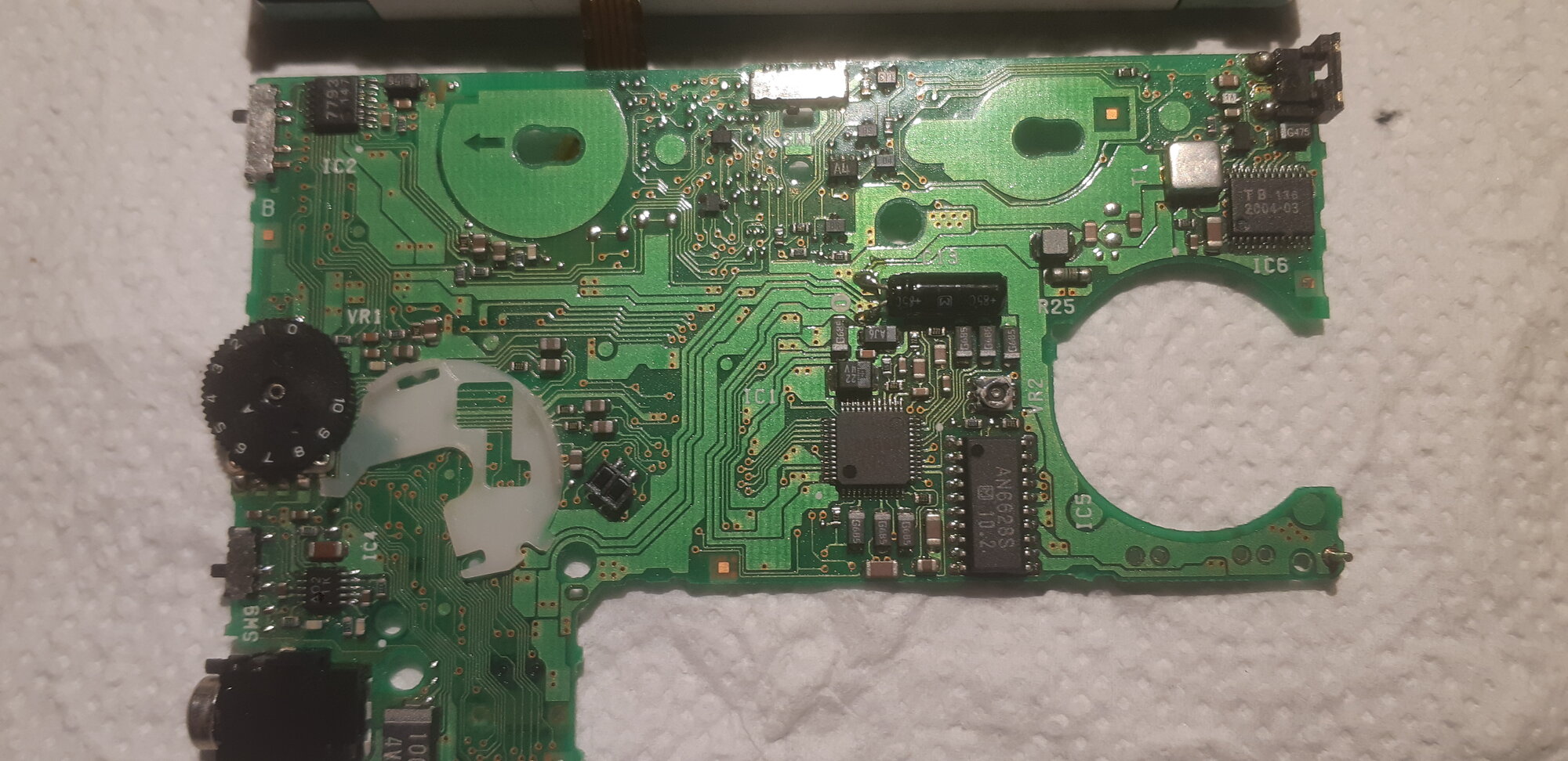

    Putting on the battery holder and the broken part 20201128_180302.jpg 20201128_180423.jpg

    Only overlap I think there are missing parts to get all together

    As I'm aware one pinch roller has a dent, and this makes only side B works I have orderd at Mariam's two pinch roller. Side A is not stable and has a big wov & flutter

    I bought a Panasonic RQ-S45 last week, I've just opened it up and it looks similar to your S35. I need to replace the belts and of course the tricky bit of removing the pcb first.
    Thanks for this - much appreciated :thumbsup2:
    "the pcb was desoldering: 4 solder points motor, 2 points solenoid, one more for Ac (I think so) and I have to desolder 4 points for the tape selector"

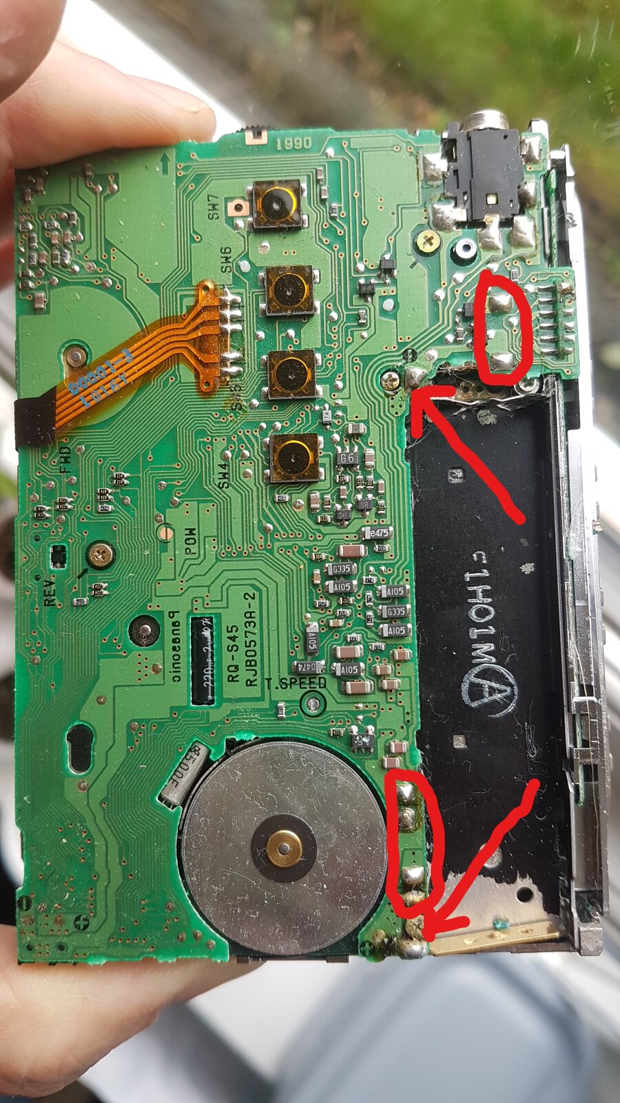

    You can see the corrosion here - hopefully the other side of the pcb is OK.
    I've highlighted where I think I need to de-solder (circles). Do I also need to de-solder at the battery terminals (arrows) or anywhere else?
  20. JUAN ANDRES MONTIEL DIEZ
    JUAN ANDRES MONTIEL DIEZ Active Member
    199
    Spain
    Battery terminal (+) next to the motor soldering points is not necessary to desolder in RQ-S35, I think so in RQ-S45, but the other (-) next to the solenoid points yes. Fortunately it appears that the tape selector has another configuration in RQ-S45 and you don't have to desolder it. Then you have to remove the screws over the pcb.Deoxit for the corrosion, and IPA for the pinch rollers. Belt is the same for both and you can get it from Marian. Pinch rollers are problematic, in my case once I replaced the belt the unit has speed issues, the tape slips in one direction. I replaced the pinch roller's rubber but the issue continued, from a donor unit, in this case a RQ-V520 I bough for 7€, I swapp pinch roller's chassis and the issue dissapear. The other side plays a little slow, the donor unit didn't have the other chassis in good shape.
