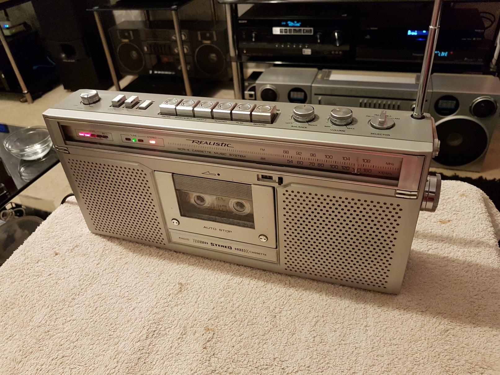

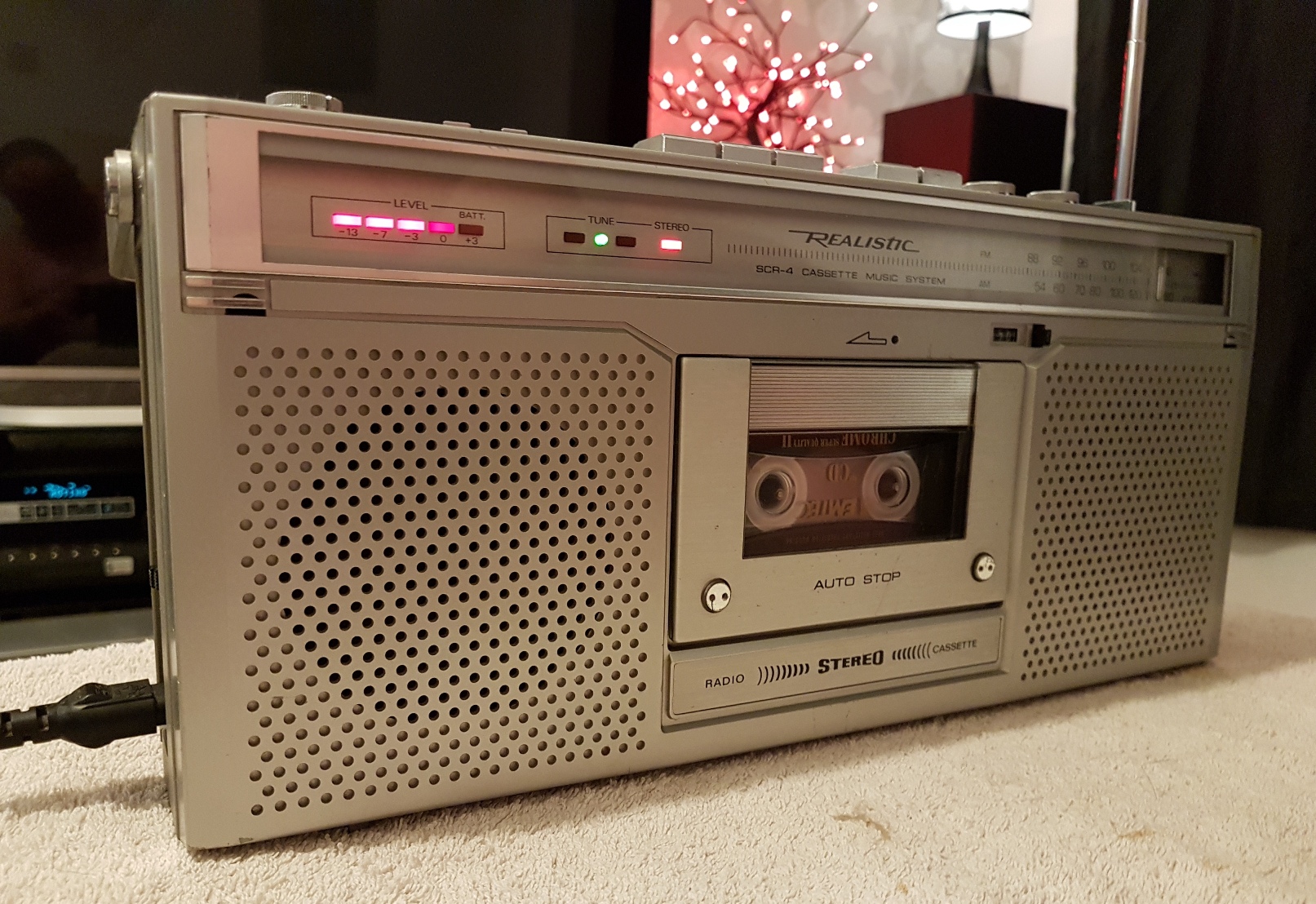

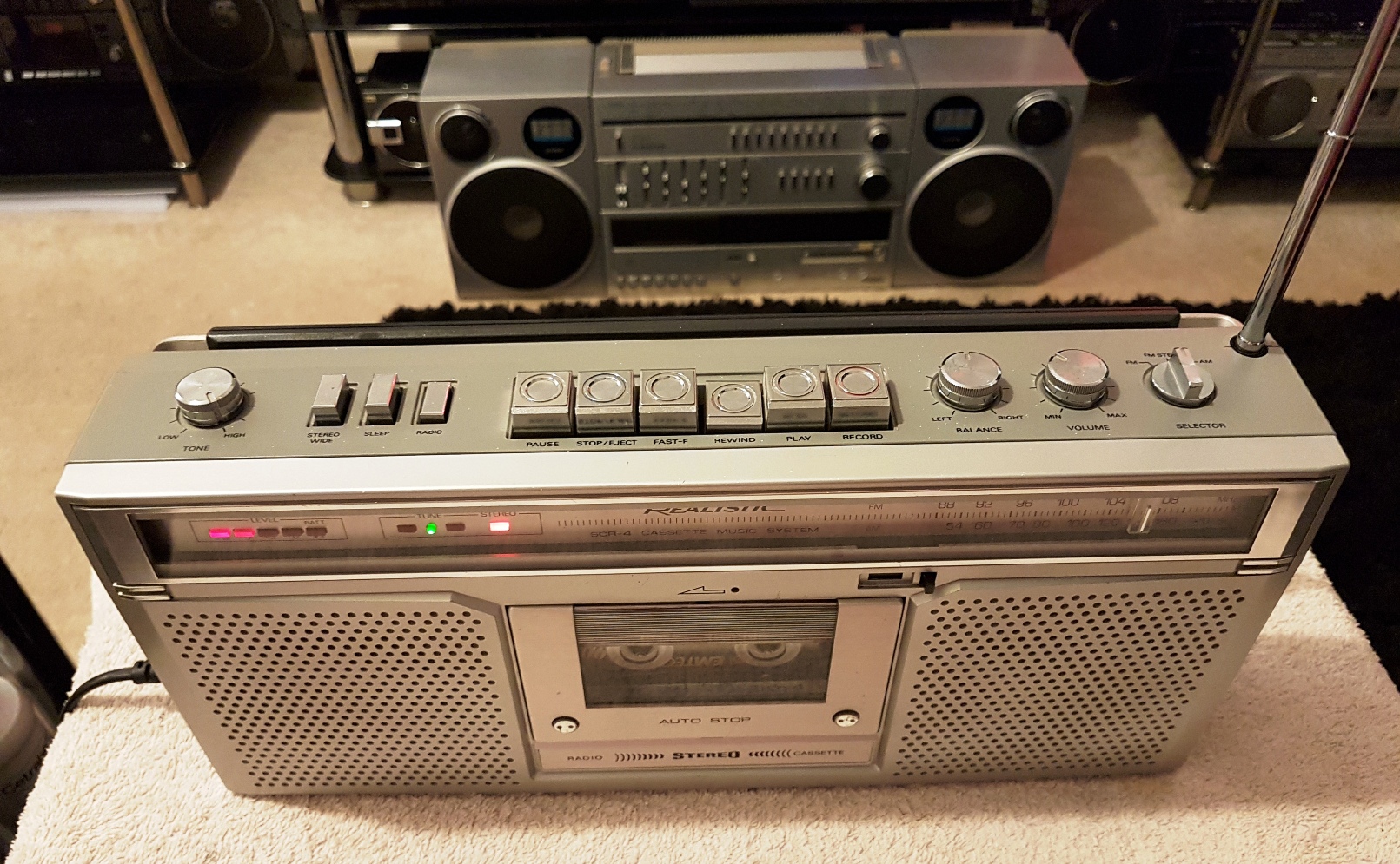

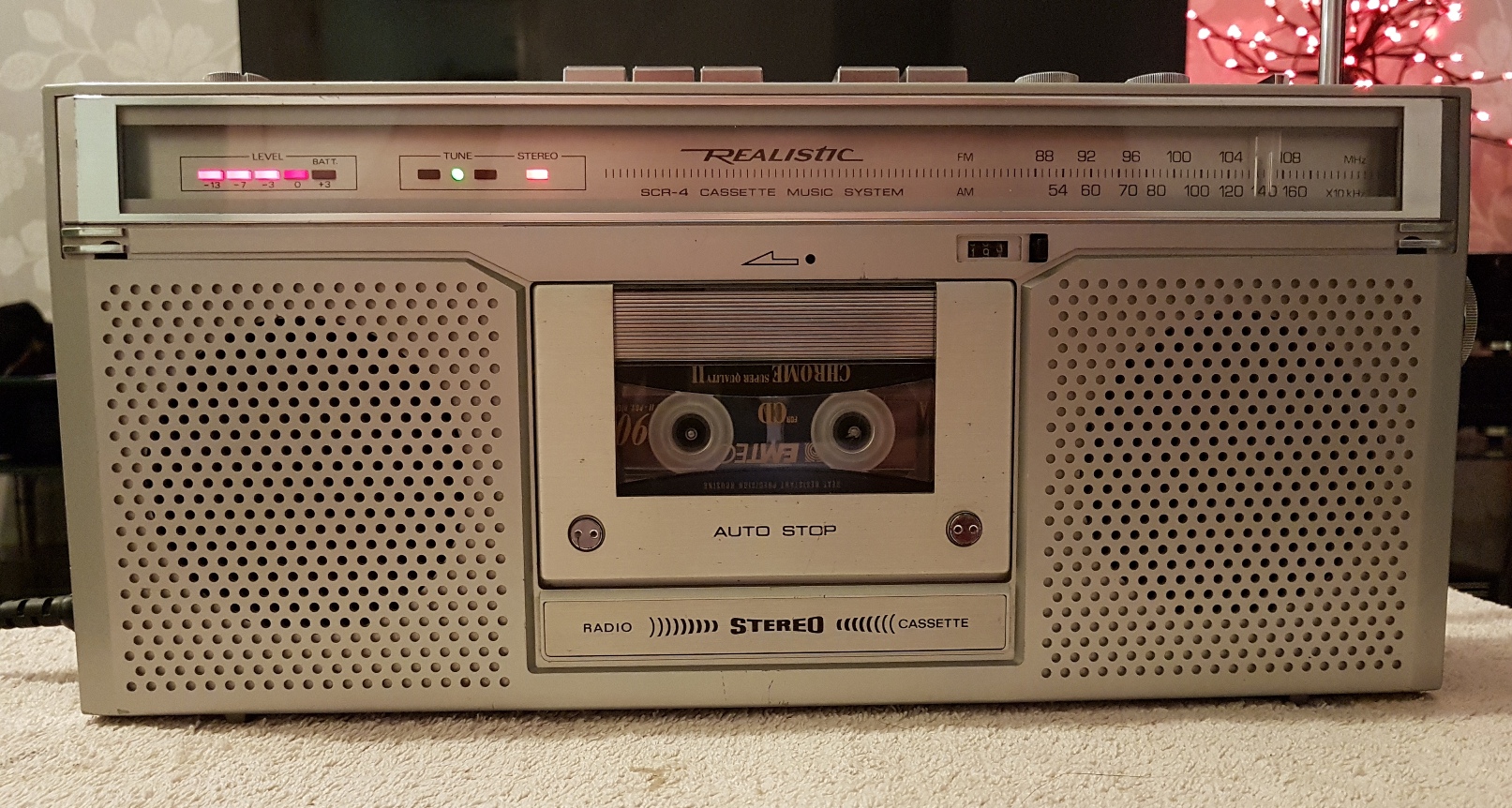

    Well I'm Back After A Disastrous Last Week [​IMG] [​IMG] [​IMG]
    Everything went wrong that could go wrong - Ended up damaging 2 wirelesses that now need much more work than they did & I was ready to throw in the towel & stop repairing/restoring for good! [​IMG] [​IMG] [​IMG]

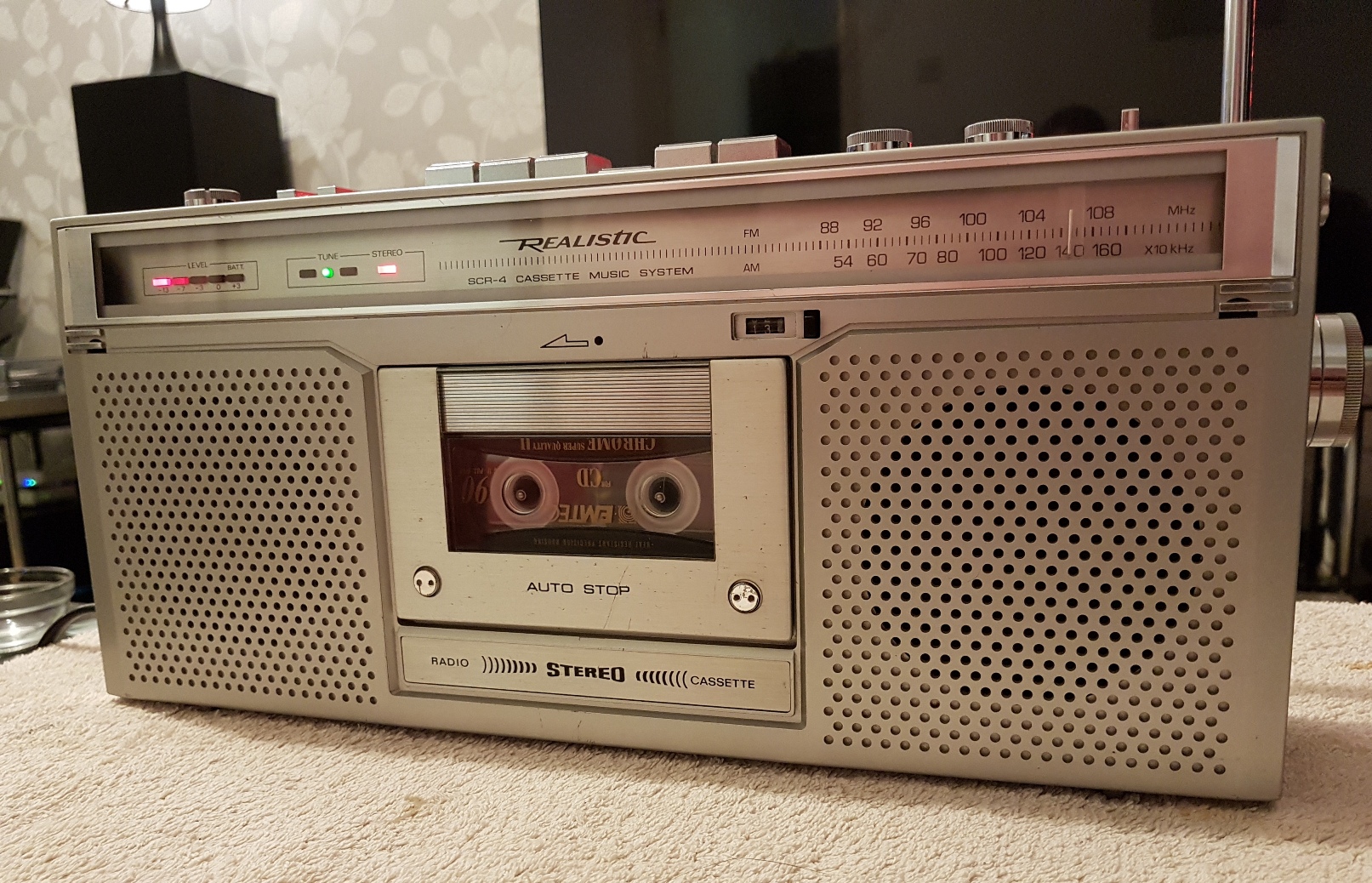

    This week saw the arrival of 3 more machines, one I have been after forever in mint condition, also a Toshiba RT-S782 which is in bits awaiting new belts........& this one!!
    Now those who know me from the forums know that anything from the early 80's in silver & with pretty led's are something I usually have to save & here is one I used to want as a kid but was way overpriced (Everything was in Tandy) & no one wanted to buy me one [​IMG]
    Paid little more than postage for this one & always wondered what the build quality was like.........

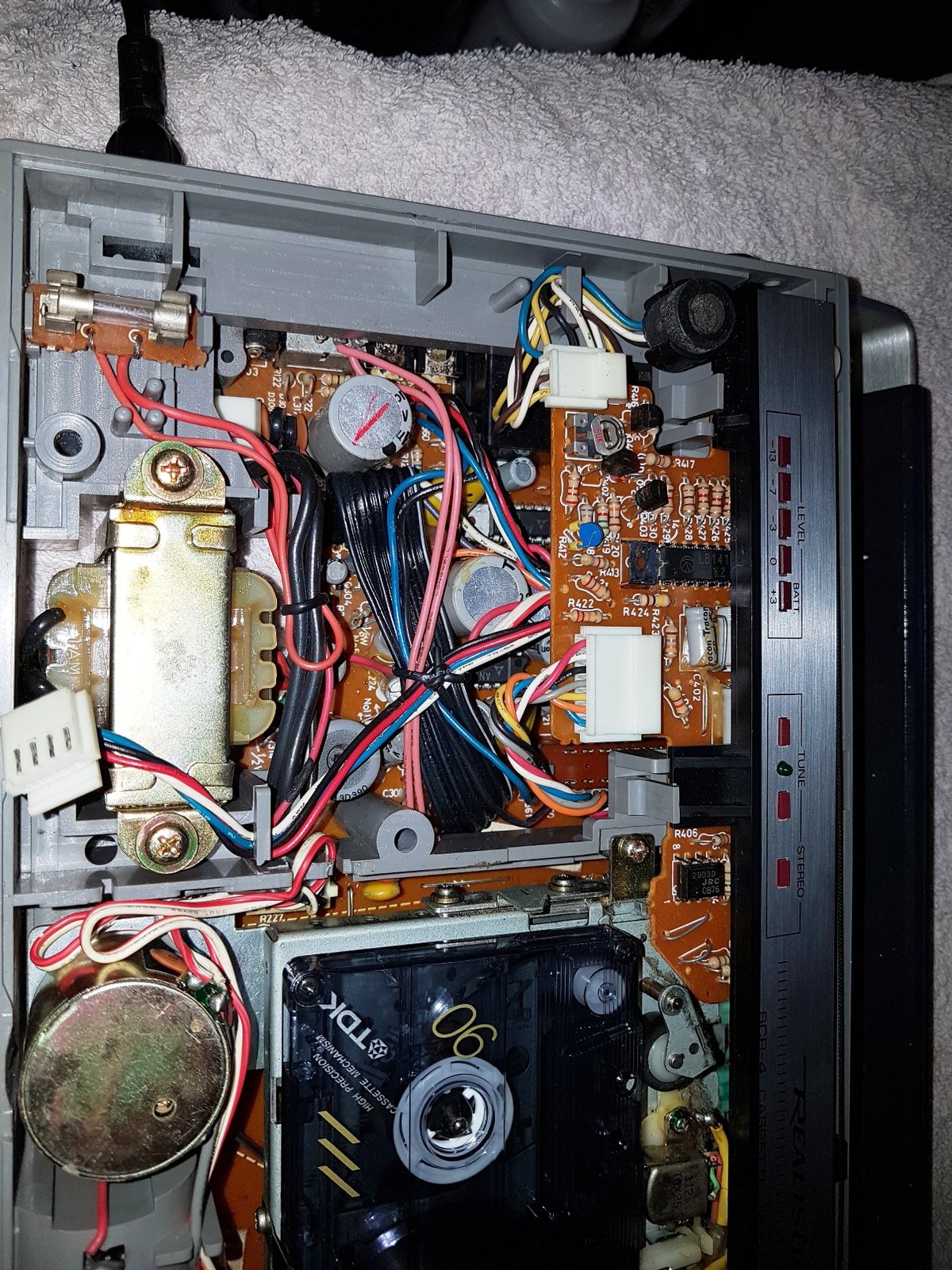

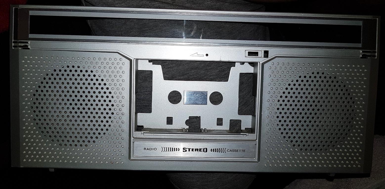

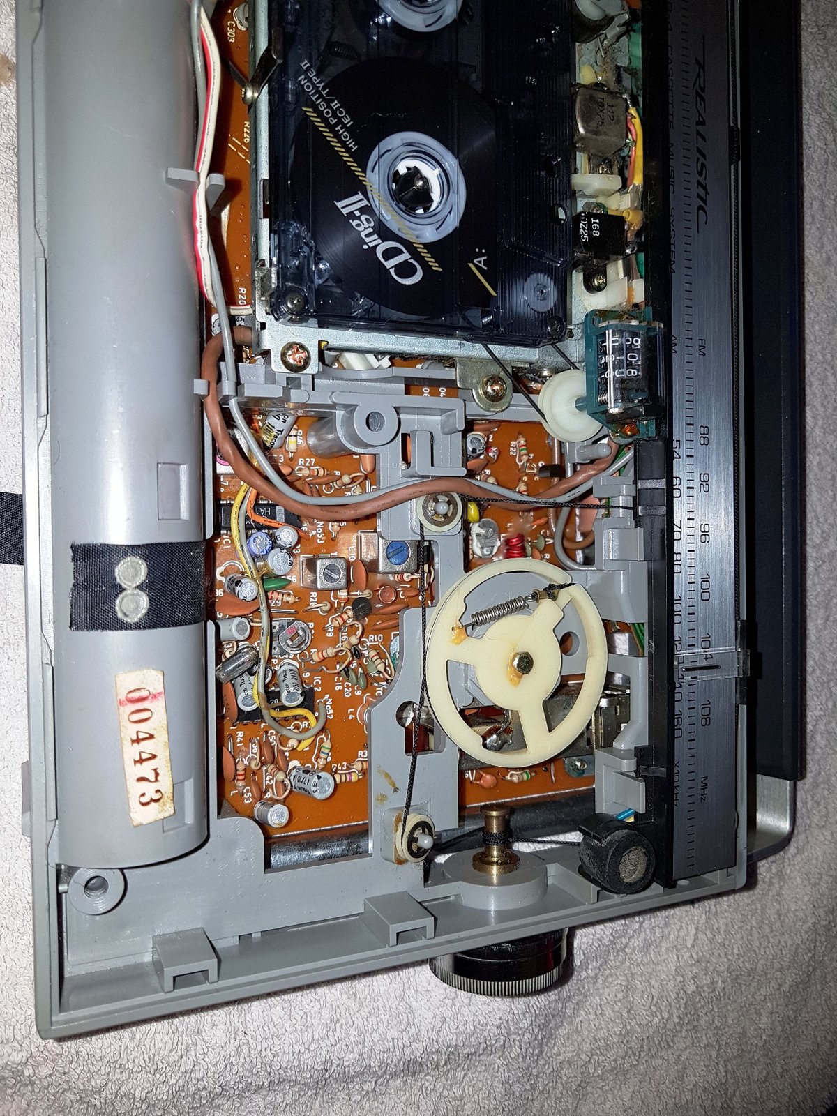

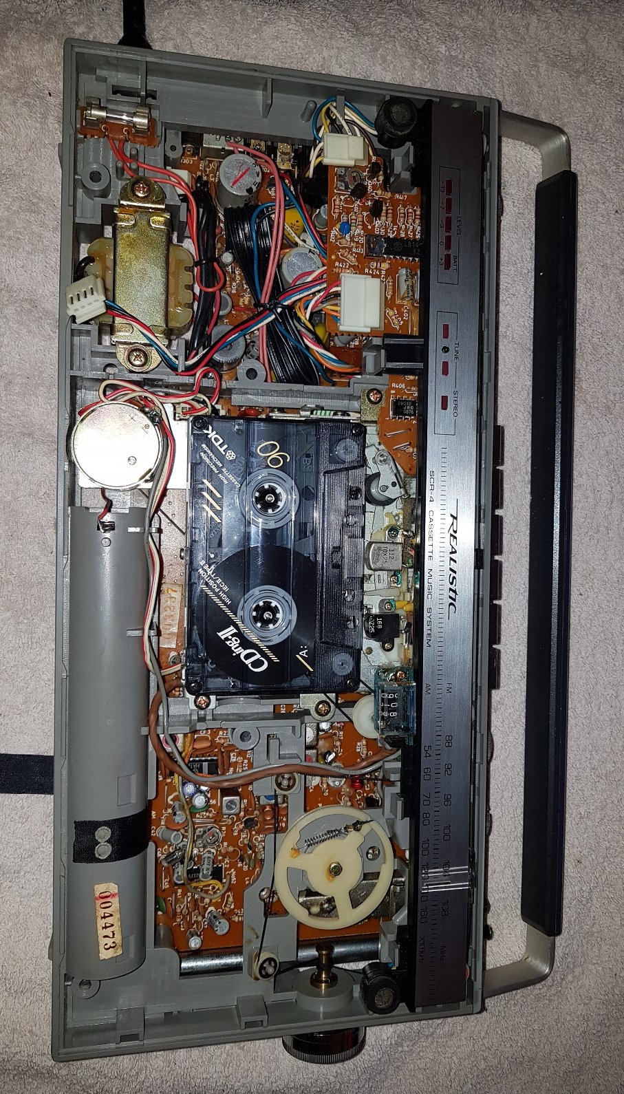

    I was very surprised to find that it was a delight to work on, everything unplugs & tape deck was removed in a few minutes to replace belts etc!
    All switches & pots sprayed while apart - Both front & back come off these giving excellent access to everything [​IMG]
    Cleaning as I reassembled it didn't take long & condition is stunning considering it's nearly 40 years old!!
    Motor speed & azimuth were both way out as is often the case with budget stereo's of the time, both easy fixes while still apart!
    All that was left was to re-purpose a spare antenna to fit & look right as original had been broken - this took around 20 mins to achieve & after a really good test in all modes, it was time to close her up & start playing music again [​IMG]

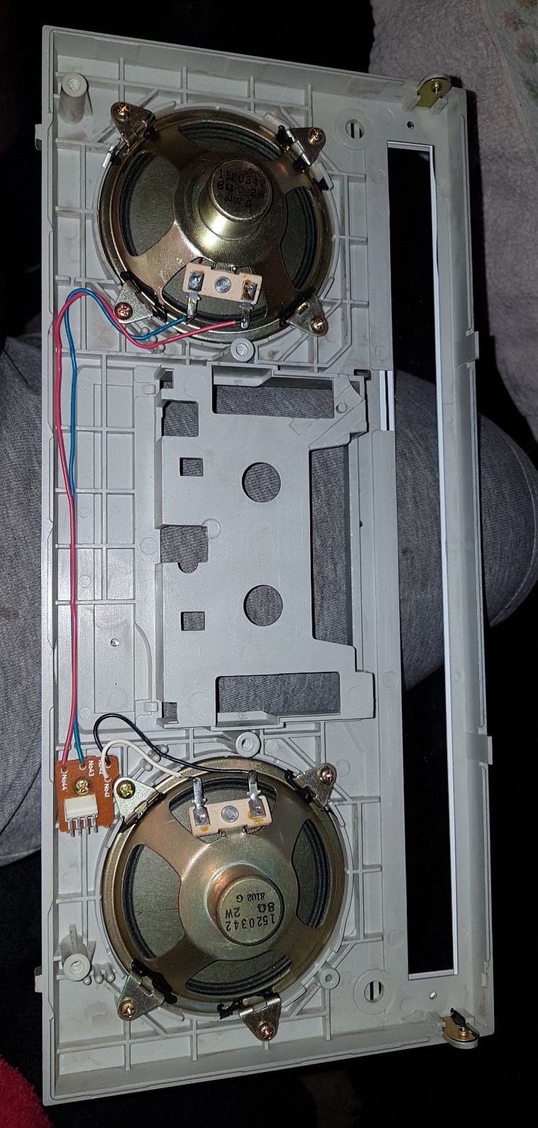

    It's what you expect from such a tiny stereo with small magnets on the speakers - I have lots of spare drivers & am tempted to change them - We will see................
    It looks & sounds brand new & I am thinking maybe I'll stay doing this for the time being..............last week really put me off what with this fucking illness I live with every day, it can be easy to want to give up!!
    My friends tell me it won't be possible to give up [​IMG] [​IMG] [​IMG] so watch out for the repaired Tosh & a really special arrival of 1 I already own but this latest arrival is pretty much mint & I am delighted with it although it needs a tricky repair so that will be interesting!!
    For Now:
    Et Viola!!
    Realistic SCR-4 Stereo Radio Recorder - May 2018 (1).jpg Realistic SCR-4 Stereo Radio Recorder - May 2018 (2).jpg Realistic SCR-4 Stereo Radio Recorder - May 2018 (3).jpg Realistic SCR-4 Stereo Radio Recorder - May 2018 (4).jpg Realistic SCR-4 Stereo Radio Recorder - May 2018 (5).jpg Realistic SCR-4 Stereo Radio Recorder - May 2018 (6).jpg Realistic SCR-4 Stereo Radio Recorder - May 2018 (7).jpg Realistic SCR-4 Stereo Radio Recorder - May 2018 (8).jpg Realistic SCR-4 Stereo Radio Recorder - May 2018 (9).jpg Realistic SCR-4 Stereo Radio Recorder - May 2018 (10).jpg
