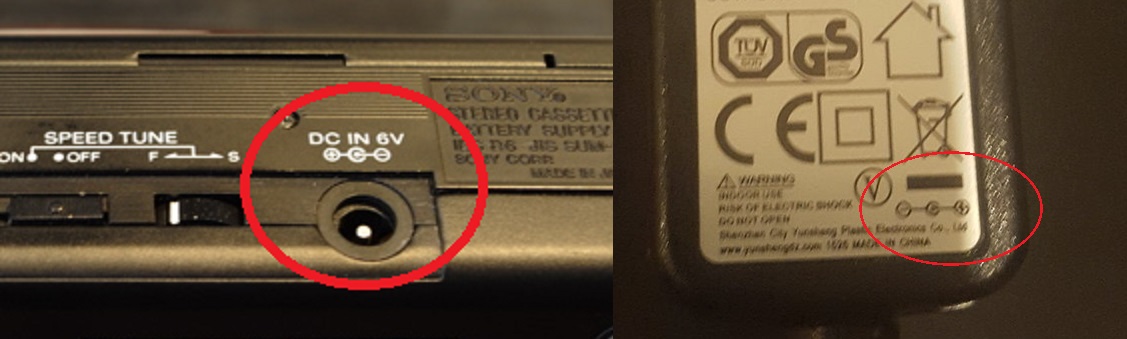

    I am unsure of the polarity of the external power supply.
    Here is a picture of the power supply, it is modern.
    Do you think that it is this?

  4. TooCooL4
    3,240
    Cannot see in your pic, but the D6C uses centre negative polarity.
  5. Machaneus
    Machaneus Well-Known Member
    479
    Athens
    It can't be seen clearly but looks like the polarity is wrong .
  6. T-ster
    1,465
    Yes, definitely looks like the wrong polarity adapter was used.
  7. Command8
    Command8 Active Member
    375
    London
    Now that i think about it, i don't think external power has ever worked on this machine. I could be wrong
    I checked and you are correct the + and - are inversed.
