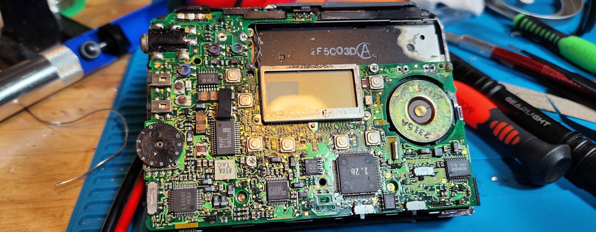

    I will upload a pic of the circuit board. There was battery acid but not on the circuit board. I used a Samsung headset to test all my walkman. I was suppose to buy a pair of walkman speakers.

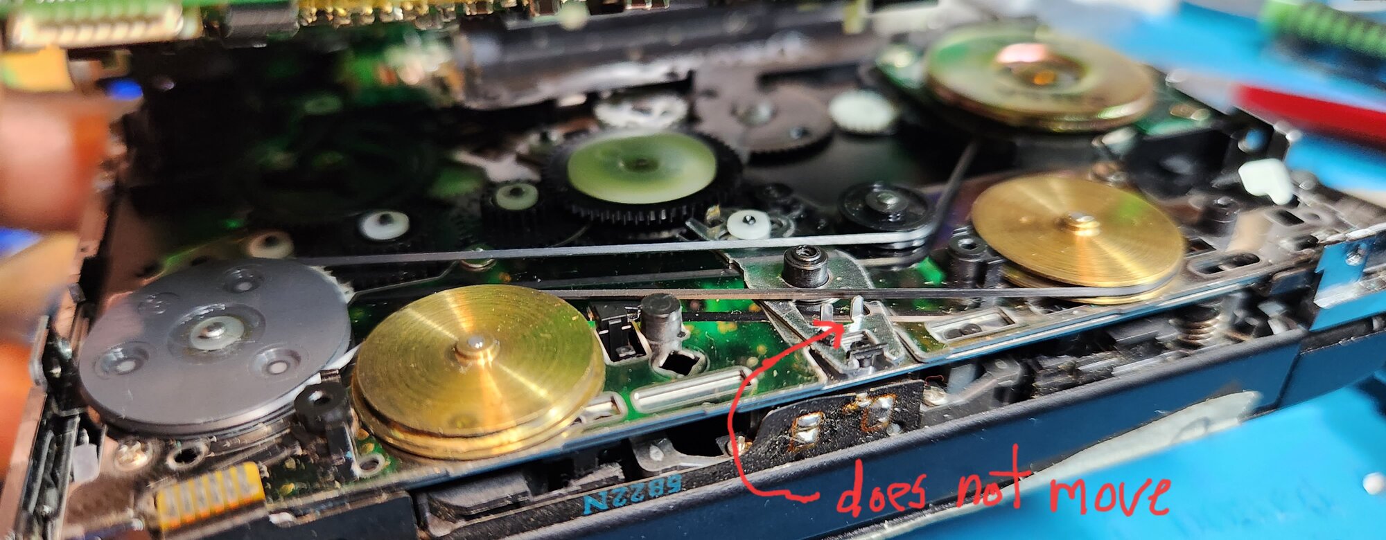

    I have open right now to inspect everything. I made sure I deoxit the ribbon connector and the mechanism switch. What I did notice was the part of the mechanism that suppose to move the switch side to side was not moving. I kept manually turning the motor in both direction but it won't move.

    For the FWD/REV lever to move, you need to engage the solenoid first, otherwise the mechanism will freely rotate without engaging play mode.
    The PCB looks fine for the most part, although that battery positive terminal I would desolder, clean very well and re-solder it with fresh solder.
