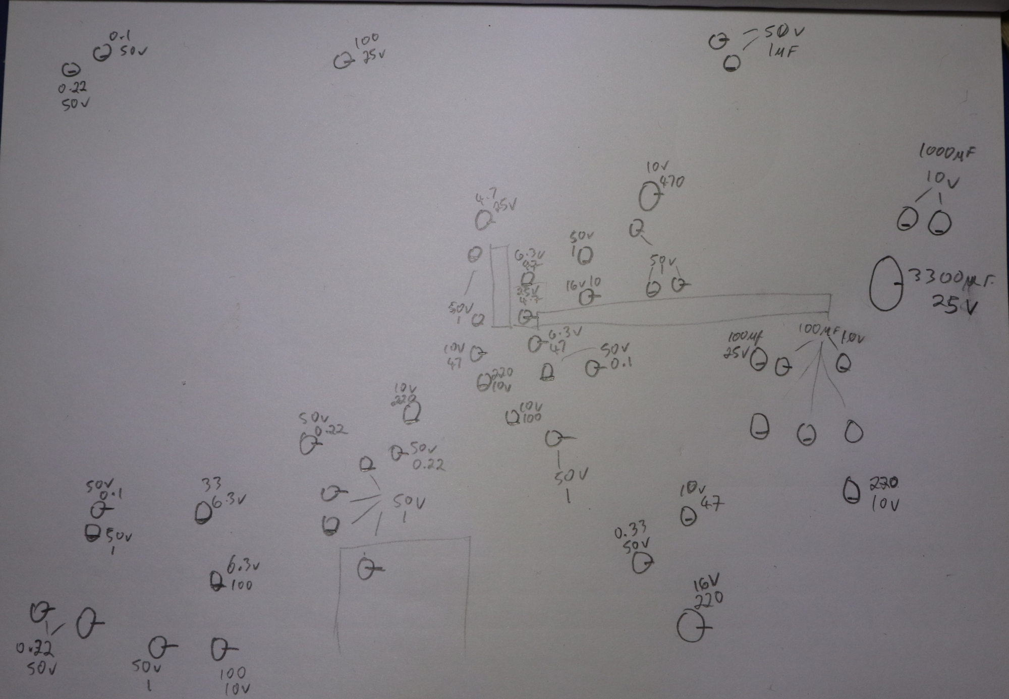

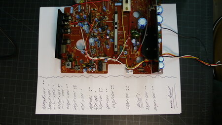

    Is this right? Picture attached, but I'm scratching my head. Some readings are at 47 muf, some at 4.7 muf... er... at the moment I have little confidence in my reading the caps correctly to be sure I've got the right numbers before I move forward and attempt to do some ordering. I've been watching videos of people recapping this unit and they don't seem to have that many different caps by their side when they do it. Can someone boost my confidence in my reading here, or else point out what I've done wrong so I can re-do it please?

    Have you got a service manual ? A quick Google suggested one is available on Stereo2Go.
    With a service manual I would simply print out the relevant sheet and check the capacitors as you remove them in case it there are differences (unlikely but possible).
    Don't forget that electrolytics are polarised so have to be fitted the right way. Older through hole capacitors tend to be more reliable but I suspect my 1976 Amerex cassette recorder needs some replacing.

    Yes, I do have the service manual... however the capacitor listings only list a partial value. They are listed instead by part number and although I do sometimes get hits, I get geoblocked. UED.Net for example, geoblocks. I can use a cache page to get at the list, but if I click on any of the links, I'm dead in the water. I can use Web Archive to get at those pages, but usually they are then to part numbers and usually they are also out of stock and don't actually detail the value of the capacitors anyway... like this - https://web.archive.org/web/2021020...ued/viewItemAction.do?itemCode=MSCECAG25E0R47 - yes, it does nark me that some places like UED seem to have shopping lists of all the caps I need for a unit, and I can't buy the things from them.
    So I'm stuck with having to do a manual search of the board and work it out.

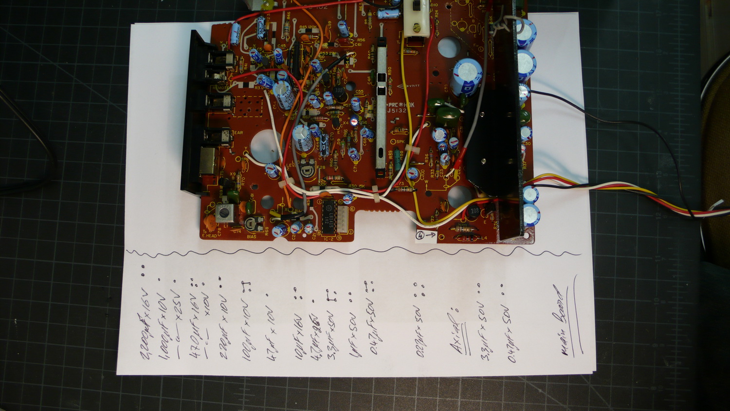

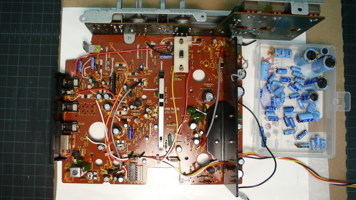

    For a bbox I did full recap only once - for RC-550 "El Diablo". Having SM gives extra confidence that even in the worst case you won't have to buy another one to check cap values.

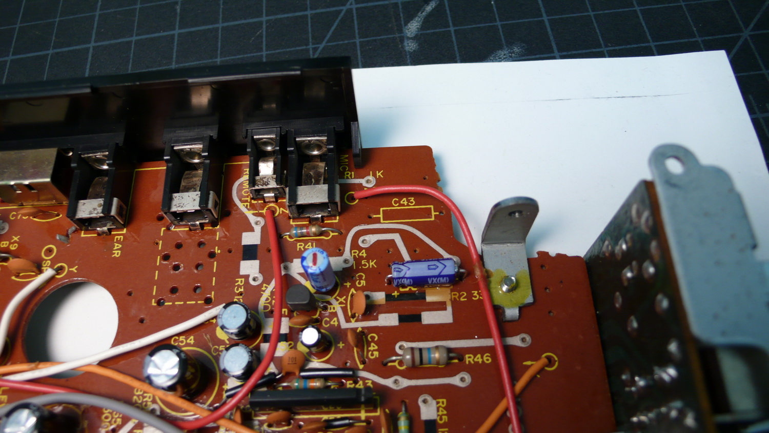

    I do not remember actually notating each cap on the board, but just made a list of all the caps used (marking them in Red as I counted) and then recapping only same value caps at a time. And double-checking their values as I pulled them out!... The only "danger" to look for is to check if polarity is marked on the board. If not (axial C43 @ the second photo) then photographs of the board before recap helps; if no photo then you have to pull out SM.

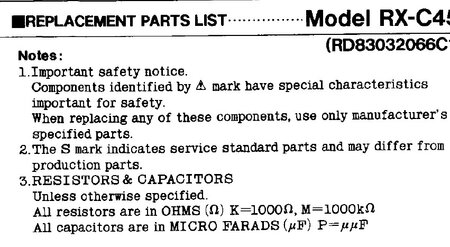

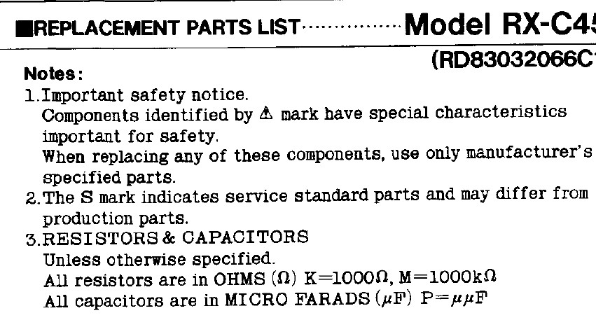

    I just looked at the service manual and to me the schematic shows more information than the layout or parts list.
    For example C139 is labelled 10V1000 which I guess is 10V 1000uF which sounds right for a speaker coupling capacitor.
    The parts list says "all capacitor values in uF"
    P is Picofarad. They seem to have not used the intermediate nanofarad (which is the same as 1000pF or 0.001uF)

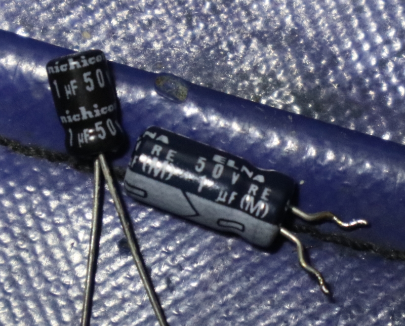

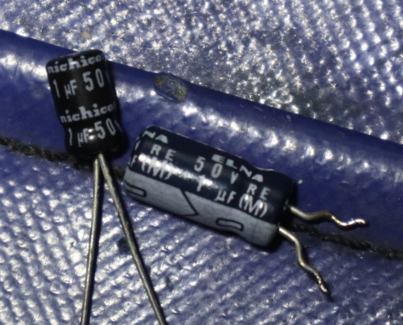

    I am replacing what I think is a like for like cap... but the replacement is small enough for me to consider whether the (M) by the side of the 1 muf symbol means I've actually got the wrong replacement cap? Or is the replacement just a better/smaller cap and the value is correct?
  9. Longman
    4,014
    Capacitors have shrunk quite a bit over the last forty or so years. Otherwise Walkmans would have stayed the same size as a TPS-L2 and mobile phones would still be the size of a brick. Of course we won't know if the new ones last as well until forty years time.

    Thanks for this. I think what's confusing me even more is that the new 0.1 muf 50v cap (not pictured) is a little more than twice the size of the 1 muf 50v cap. These sorts of things are making me scratch my head... but common sense says that physical size is only loosely related to capacitance.
  11. Longman
    4,014
    It is actually unusual for anyone to use electrolytics less than a couple of uF these days, so they probably didn't bother making a minature version. Last week I was going to suggest that you swapped the low vale ones for something like Polyester but then read a thread on a HiFi forum in which people were saying that isn't always a good idea especially if you are familiar with the circuit. They also might not fit easily.
    High value ceramics aren't a good idea as their capacitance changes with the applied voltage.
