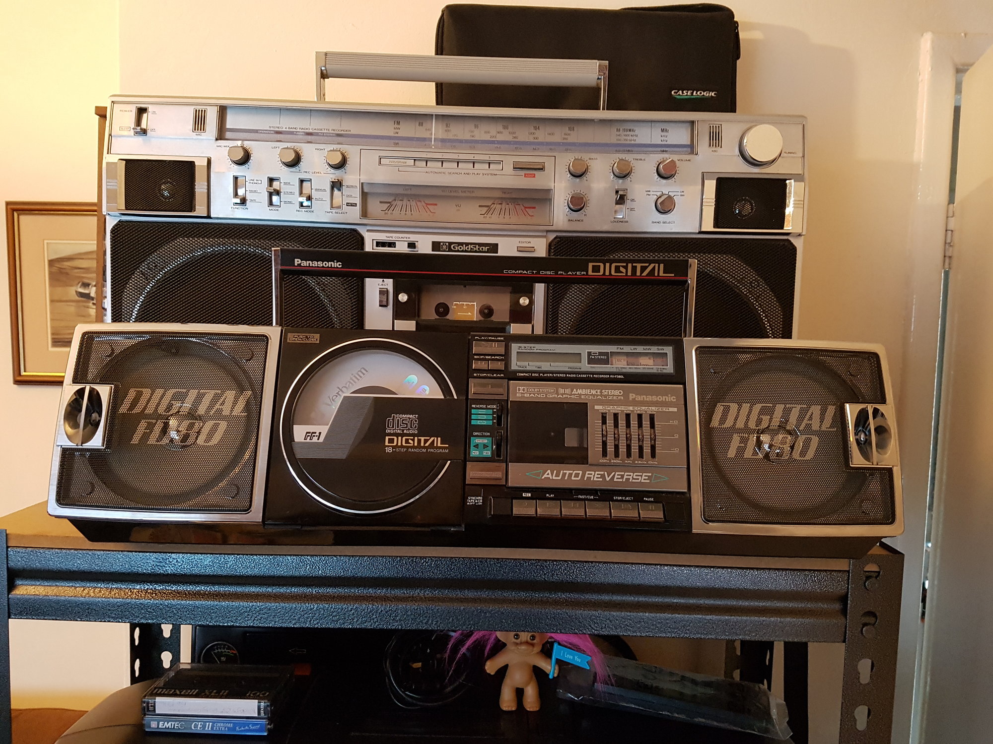

    So i admired one of the in Rahrah's pictures and as i have tons of cd's i thought i ought to get one. Picked this one up cheap, advertised as fully working but of course on delivery tape did not work and all controls crackly plus lots and lots of white dust in the crevices.
    I stripped it down, which is a bit of a pain in the ass just because of the switch sliders and the way they attach. Rebelted, cleaned and lubed the deck and all was mostly well. I didnt have a correct belt for one of the ones inside but it still felt good so i replaced the main drive belt plus the one for fwd rew, when i put it back together it plays beautifully but if you hit the switch to switch tapes sides it starts to chew. That belt will need switching out at some point... no biggie as i'll just flip the tape manually if i need to.
    Putting it back together was a bit of a pain but ok in the end. Annoyingly i caught a piece of trim under the speaker after cleaning them so you can see it poking in the top left speaker, i'll sort that out when the other belt arrives. Still cheesed me off though.
    Anyway, great sounding box, cd, line in and tape. Love it.
