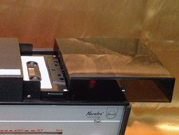

    The bad news is that it's missing the transparent cassette section cover and the plastic ivory/plastic cassette control button , I have a friend who makes a living out of 3D printing and he is willing to help .
    We know that to achive real (smoked) transparency the cover will need a great deal of post processing and a clear coating .
    Now all we need is the 3D files for these two parts , I know it's a long shot , not only this is an extremely rare boombox but even if someone has it he must also be willing to get in to the trouble to scan the parts , either way I'm leaving the message here just in case.

    Can you perhaps take the missing cassette button from a standard old EL cassette recorder? :scratch2: I think that should fit easily. These recorders are also much less rare than this boombox. You won't be making the transparent cassette cover with a 3D printer. I don't think that will ever work. A laser cutter, smoked plexiglass and glue are a better solution for that. Or a vacuum former. Only in that case, the material will be considerably thinner than the original.

    As far as the cover, you could take a smoked or gray acrylic (or polycarb) sheet, cut with woodworking tools to size and solvent weld the joints for a decent cover. With polycarbonate you can also "flame polish" the edges. There's lots of videos on YT of the process for both.

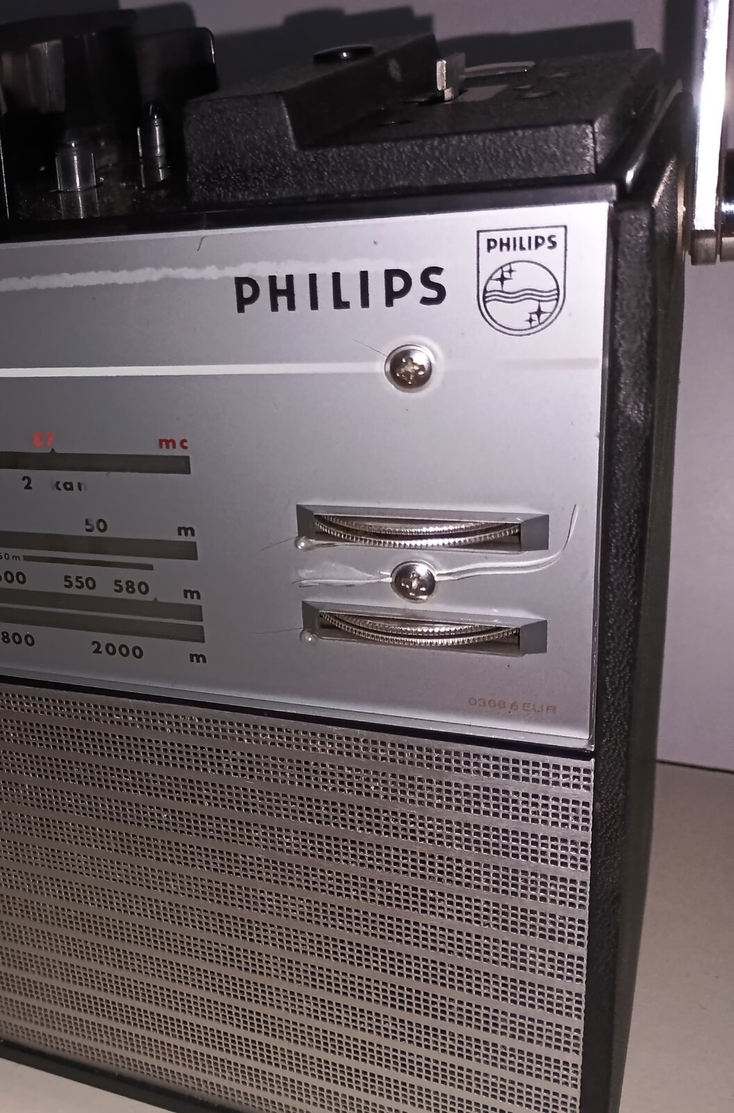

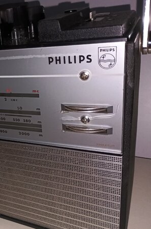

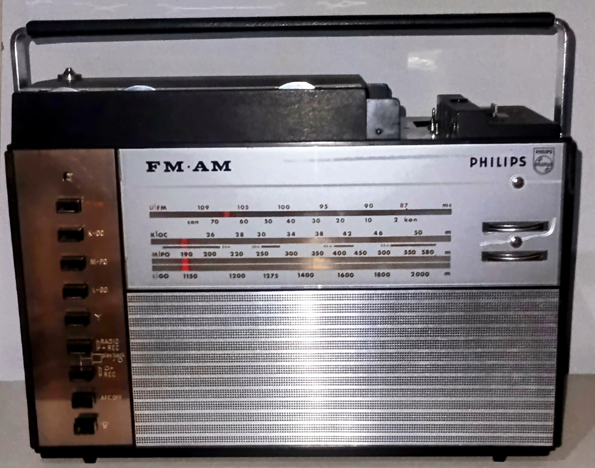

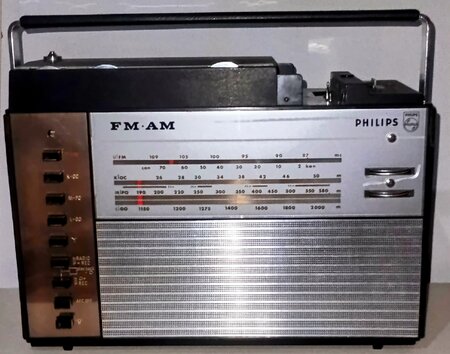

    The detailing is going to take a while , it's very thorough and the process is slow but here is the progress so far.

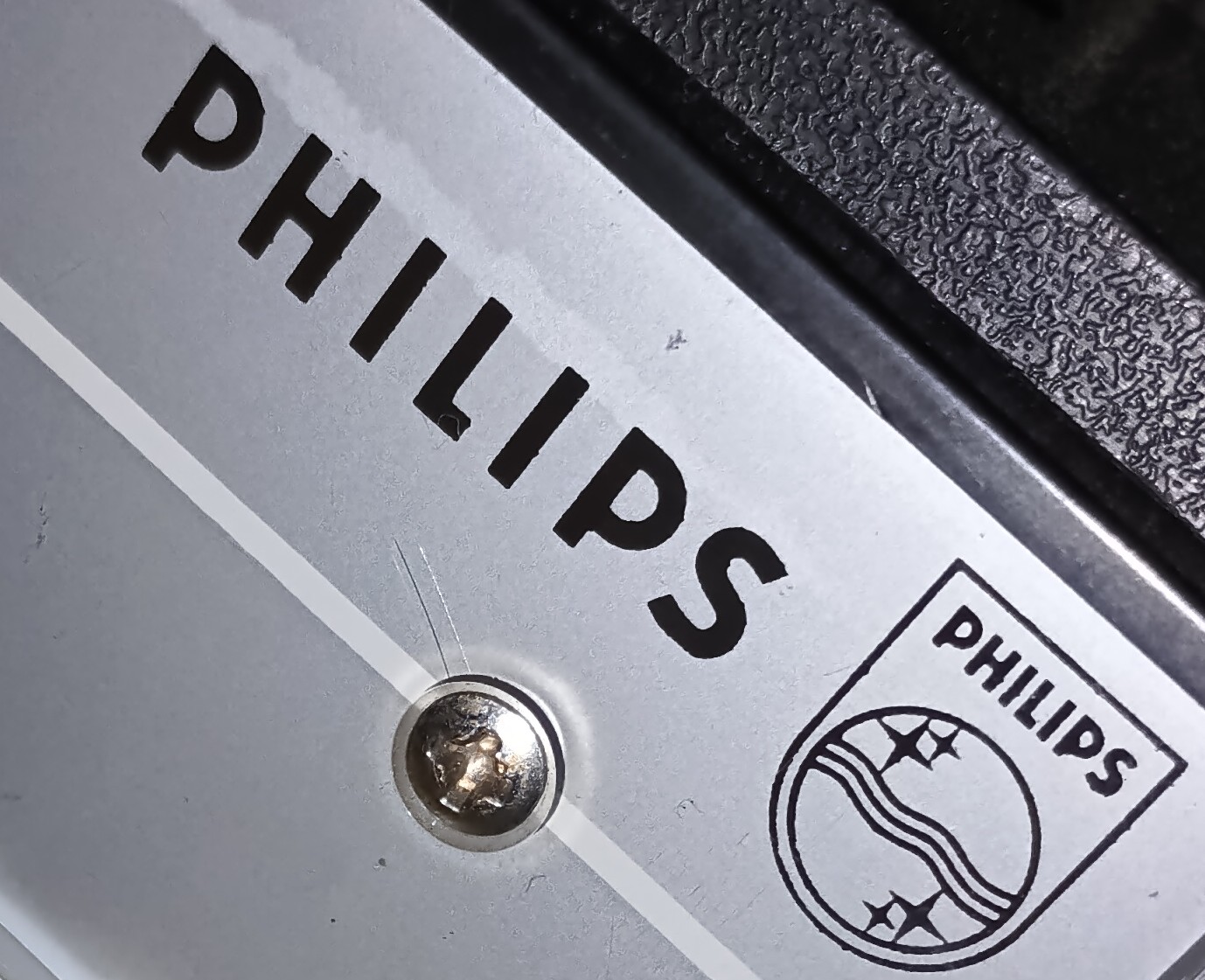

    The texture of the upper plastic cover is mimicking leather which is pleasing to the eye although very difficult to clean properly the "valleys" of the texture .
    And yes I polished the inside of the screw head. :nodding:

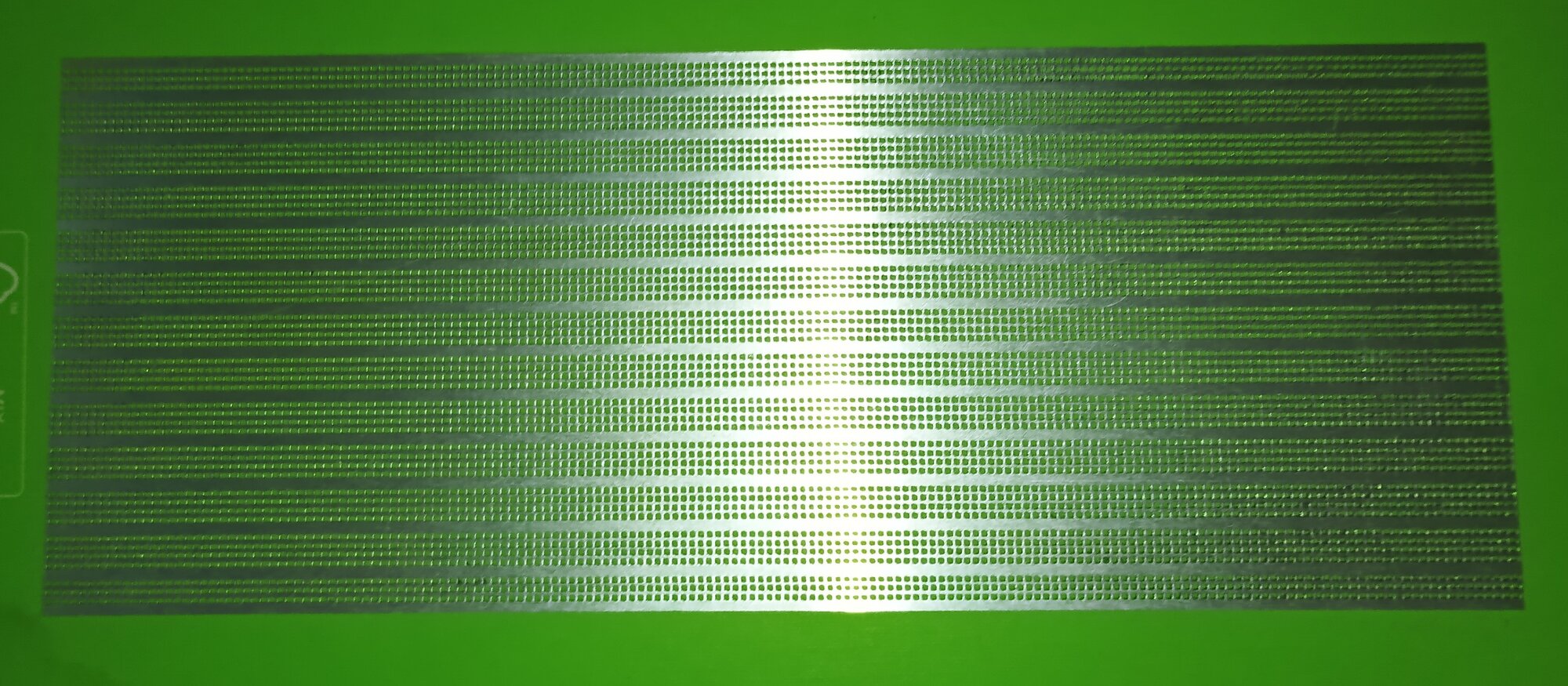

    The speaker grill mesh was a bit challenging , not only I had to straighten it out but I had also to remove the thick layer of glue that the previous owner had applied and as if that wasn't enough I had to remove also the glue from the square holes of the mesh with countless toothpicks !

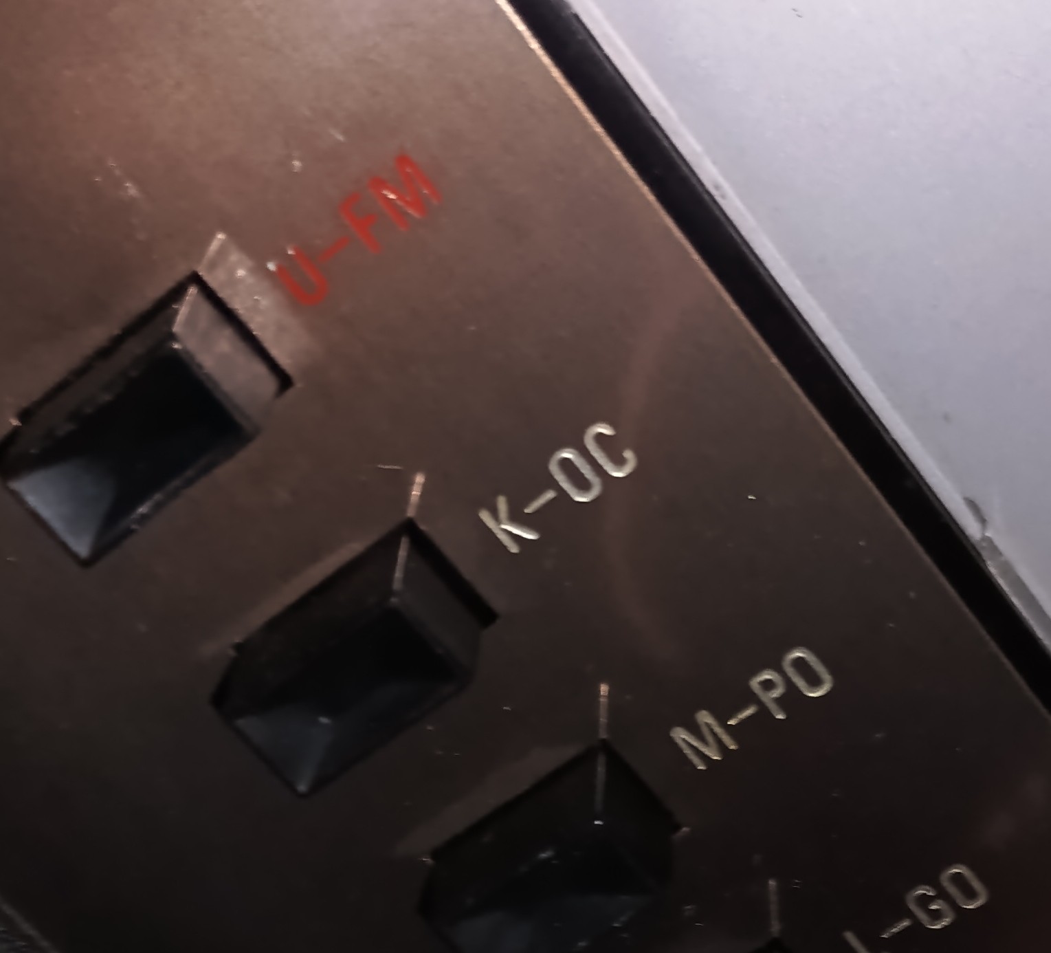

    This is a quality product , I had to be very careful not to remove the paint along with the dirt from the U - FM , this part presumably is photo etched , no silk screening here , built for heavy usage.

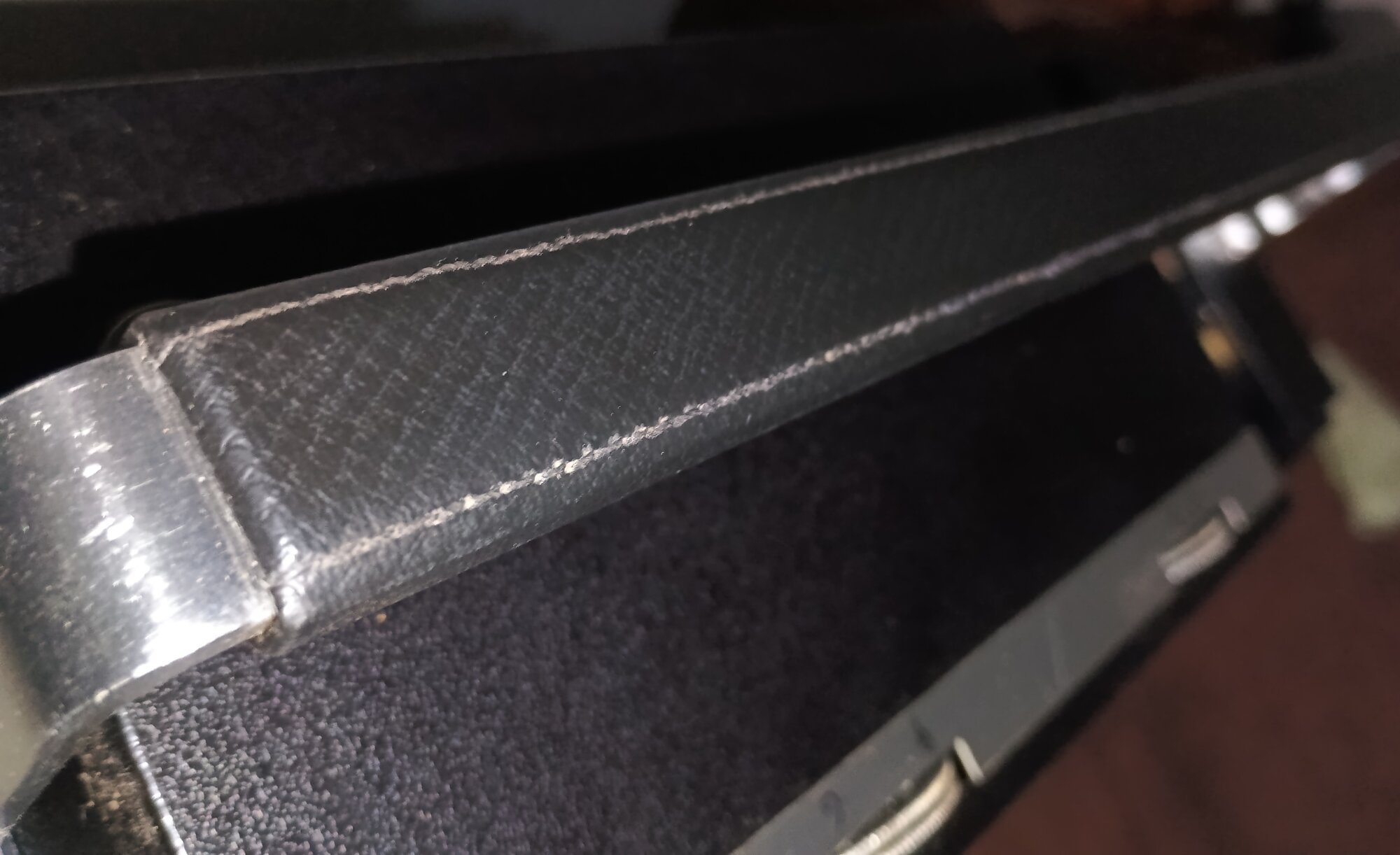

    I love this handle, brushed metal plated and probably real leather , rather time consuming cleaning this part also.

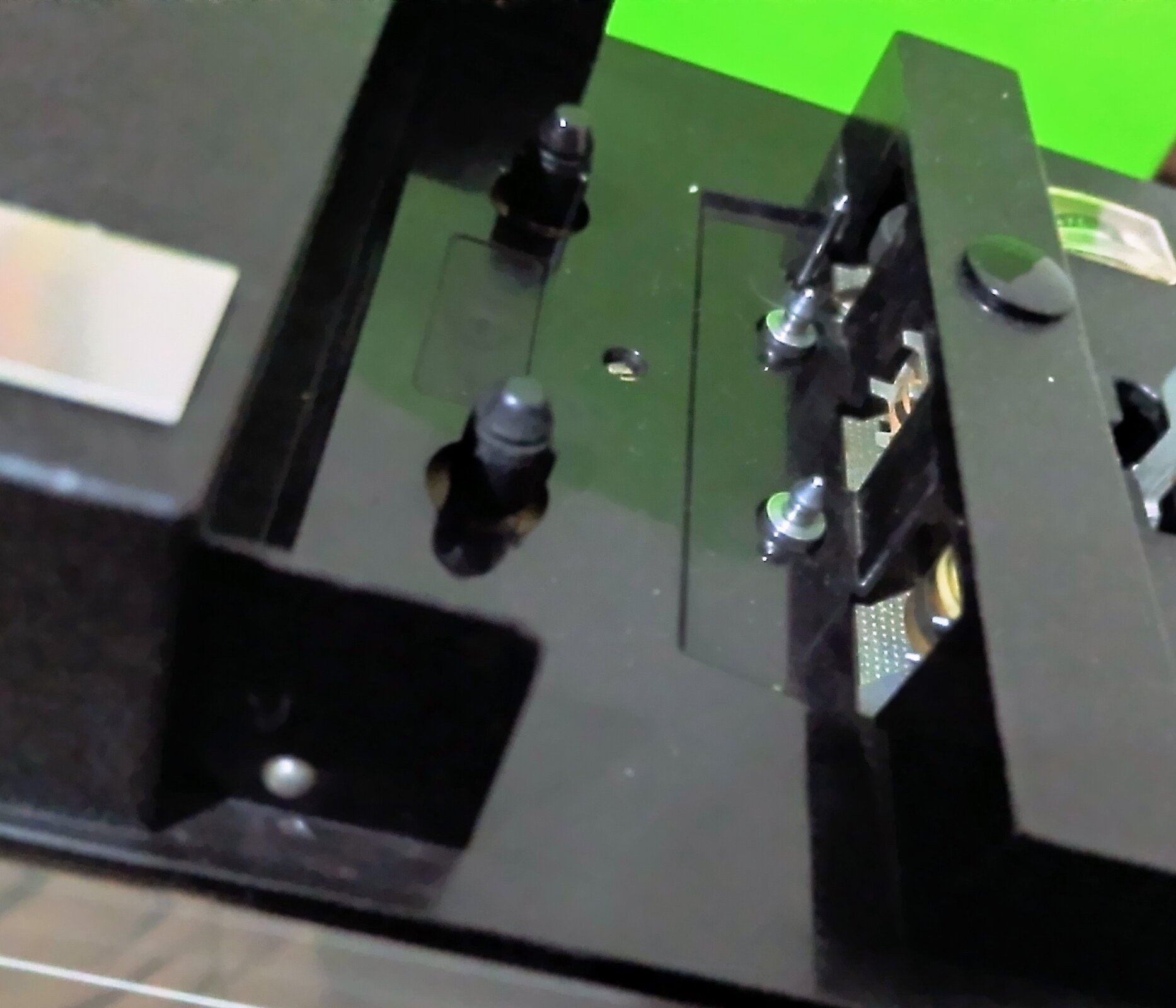

    The plastic surfaces of this boombox seem to have a satin finish from the factory , perhaps I over polished the floor where the cassette sits but I had to remove a stain probably from a cleaning agent or something .
    Somebody in the past 60 or so years overtighten the screw with an outcome that sadly I can do nothing about it.

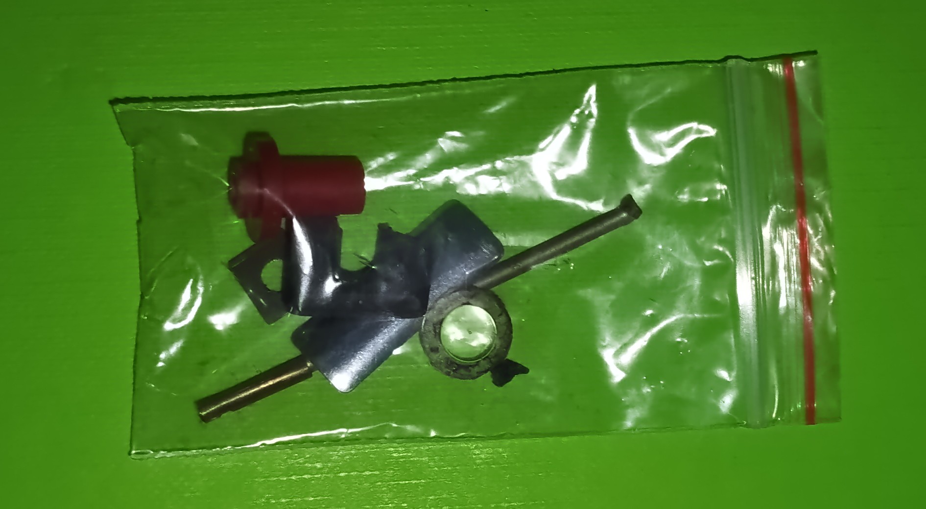

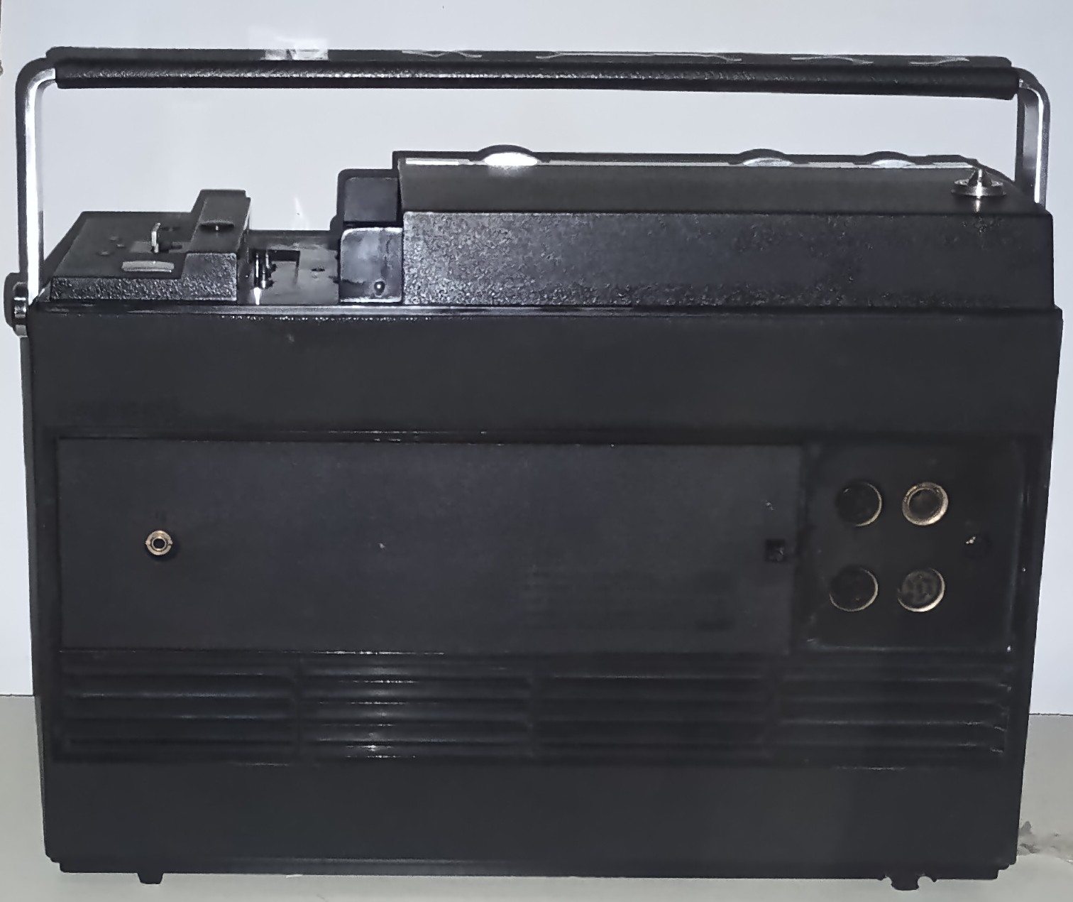

    I'm not satisfied yet with the cleaning of the vinyl leather that is wrapped around the sides and the back of the boombox which is partially disassembled externally for the moment , some tiny parts you don't see in the photos are waiting for the final assembly. :)
    Thank you guys for the advice regarding the cover :thumbsup: , what I'm actually looking for is to replicate it otherwise it doesn't bother me that much.

    It almost looks like a cassette case cover, I wonder if 1/2 of one would fit? I'm still doing fidget toys with the new 3d printer but I did get some translucent filiment to play with.

    Didn't think of that I'll try it .:)
