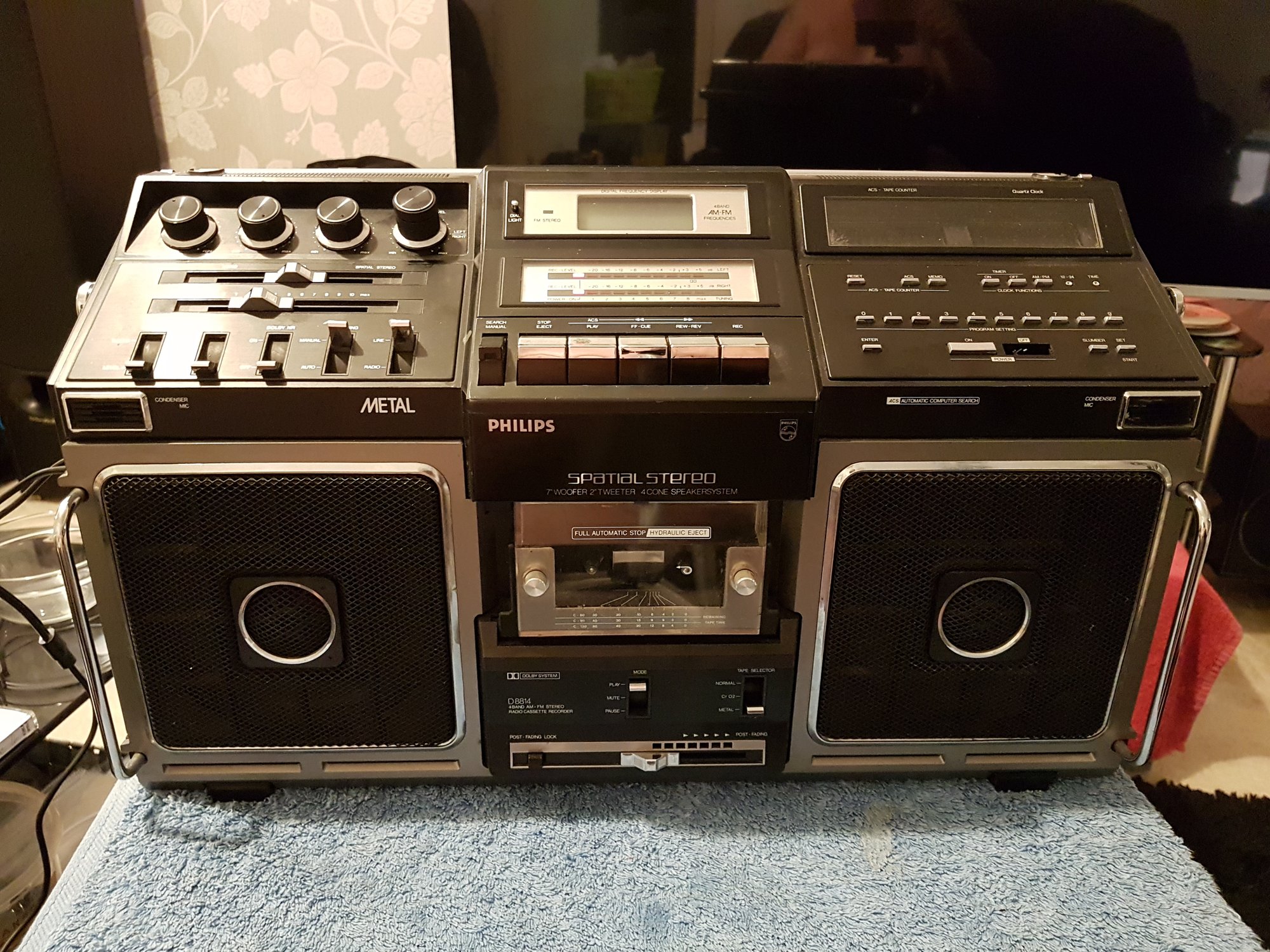

    You will remember I put this up for sale last week!!
    Well.............
    No Longer Is It The: Los Blancos Elephantes! [​IMG] [​IMG] [​IMG]
    I have been tinkering with it & thanks to advice from a couple of Facebook stereo groups, I found a fractured wire that feeds the clock - looked connected but inside the insulation, the fracture was complete so no power which I am told it needs to power up! After a battle with very brittle wiring & f**king Mickey Mouse solder (where can I buy some old school 80's or 90's solder??) It powered up & it needs belts but it works now & I am keeping it unless I change my mind but that's unlikely (Just being honest) There will be a follow up thread to the one I an writing on the main forum soonish!!
    These are quite a machine with lots of bells & whistles - Lets see if I can rebelt it & fix the power switch!! I could end up with a fully working elephant!

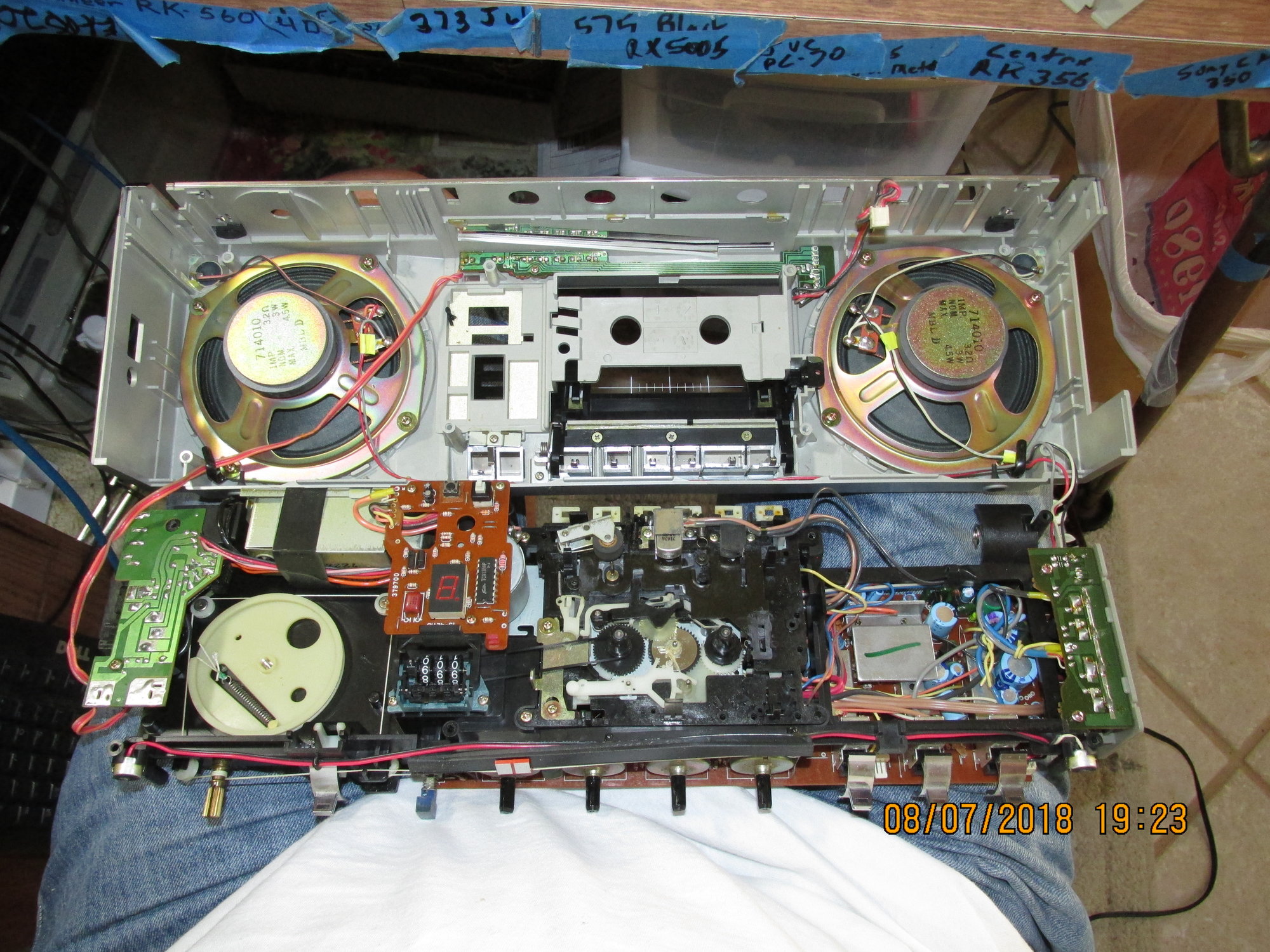

    Yes, as promised at Boomboxery I will post my photos on Elephant surgery: I made so many that its hard to choose the relevant ones... Those spring-loaded multipins were the worst idea, thankfully not too many of those, and not all of them got bad on mine... Have yet to get my first Aiwa to see what a real pain in the butt feels like, but following @Michelle Knight blog I am not too eager to investigate! ;)

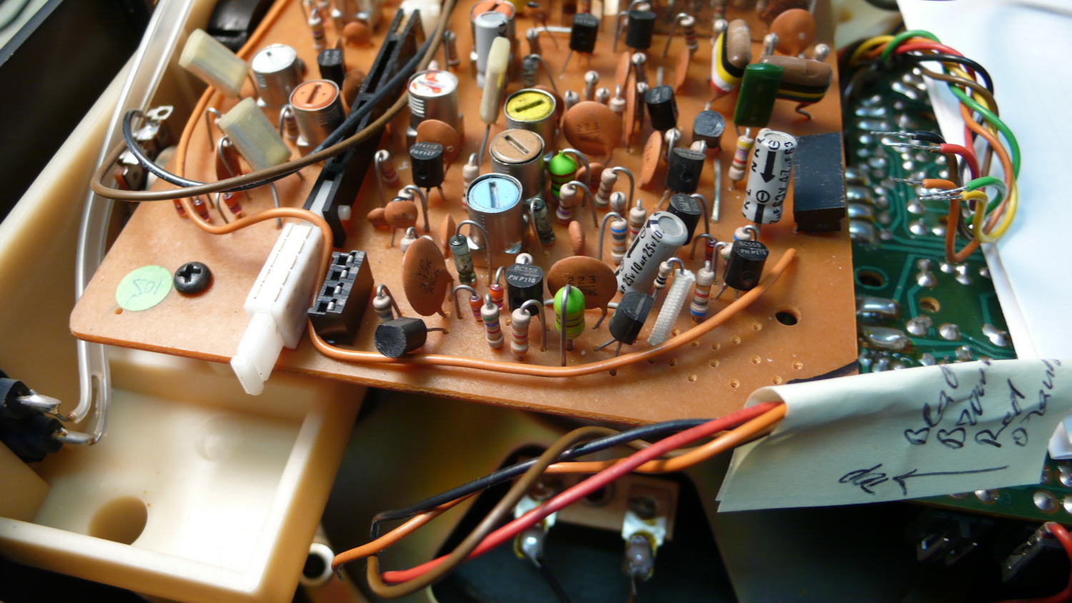

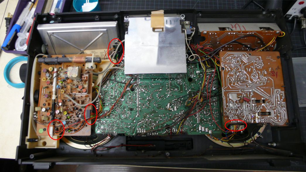

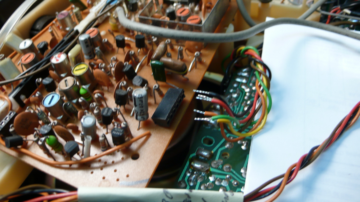

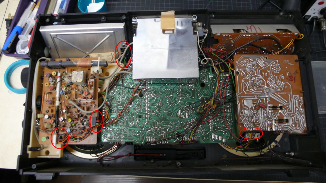

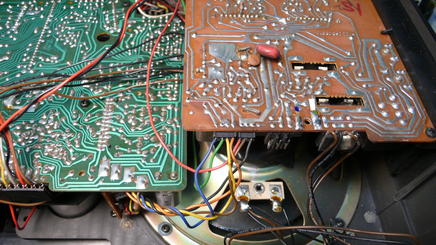

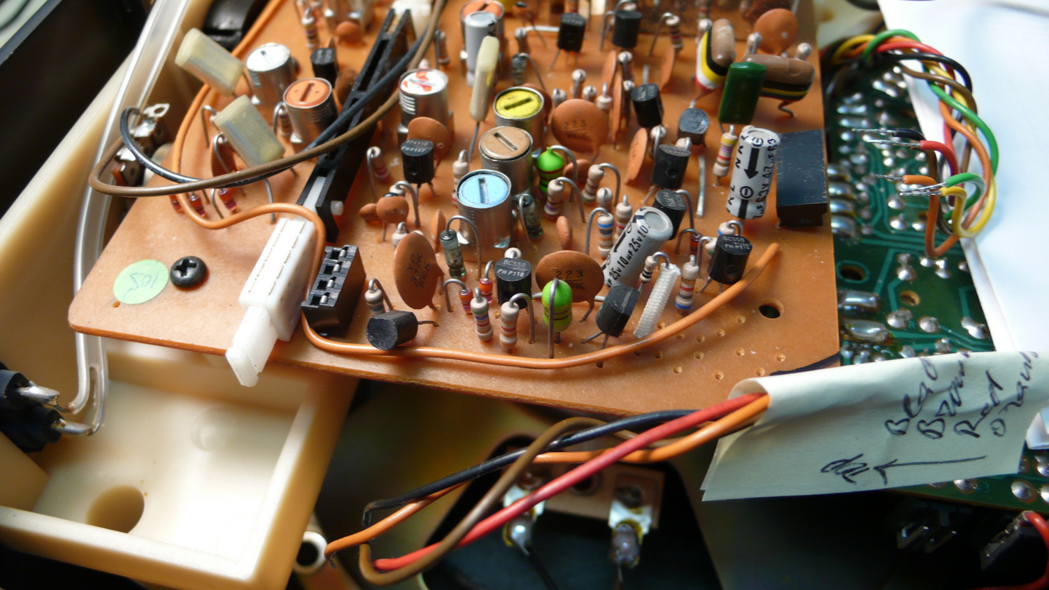

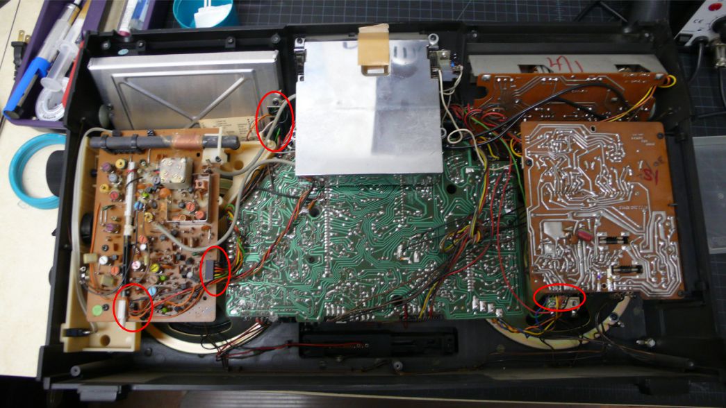

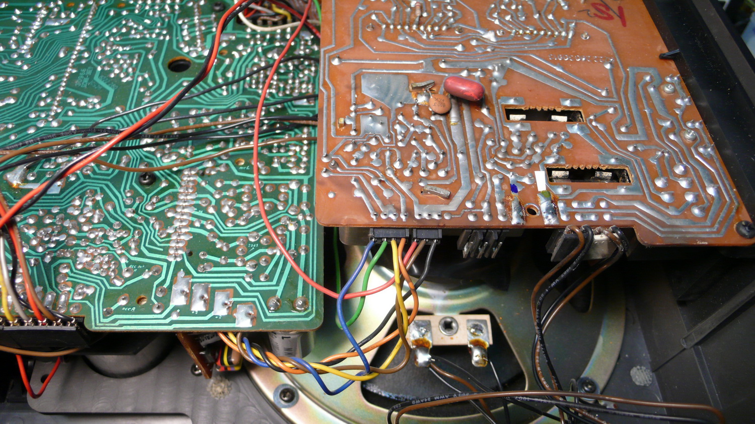

    not multipins, sorry! there are no pins, just bare wires held by leaf-springs. the worst offenders on mine are here:
    insert a tiny flat screwdriver before pulling out the wires

    just get your hands on one of these models either Sanyo M7790 or the M7790K and attempt
    to re-belt those as there are very few multi-pin plugs only for the mics and the speakers after that you have to un-screw or on solder stuff to get to the deck

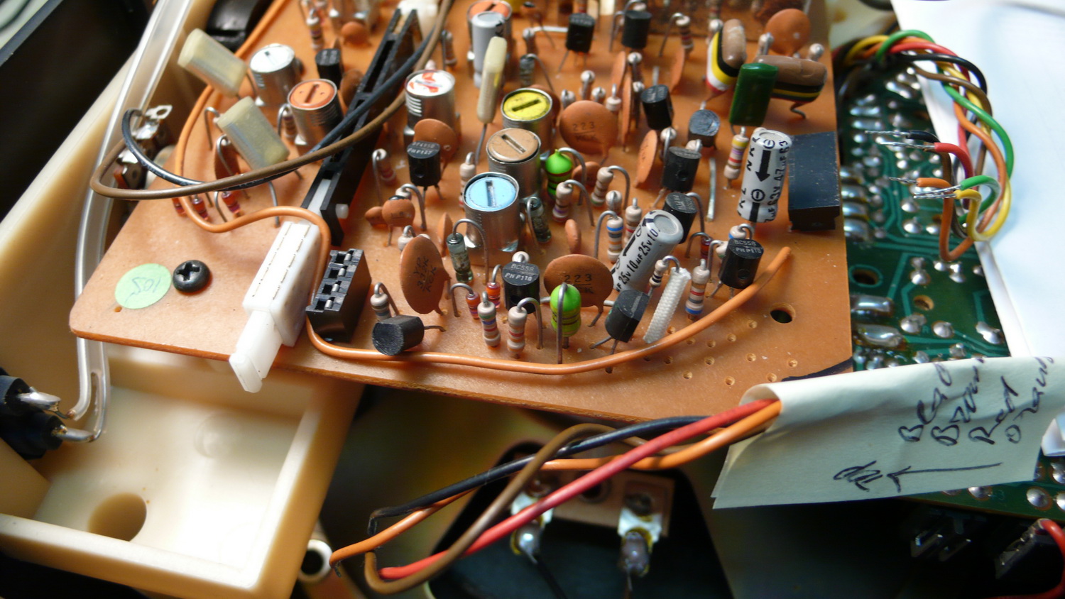

    bear with me,... should upload my resto photos of ON switch tomorrow! I did not take photos of some crucial steps while stripping down its control panel (u-Computer according to the SM), so now have to use CorelDraw to mark the screws one should NOT touch!!!
    and Yes, once you pull out the mainboard (rec-board per SM), cassette mech is all yours! ;) It has one dreaded amber-coloured gear, but on mine it is still solid!! Miracle???, or (hopefully) just the same color as those crumbling ones in all Philips/Magnavox bboxes!?!?
