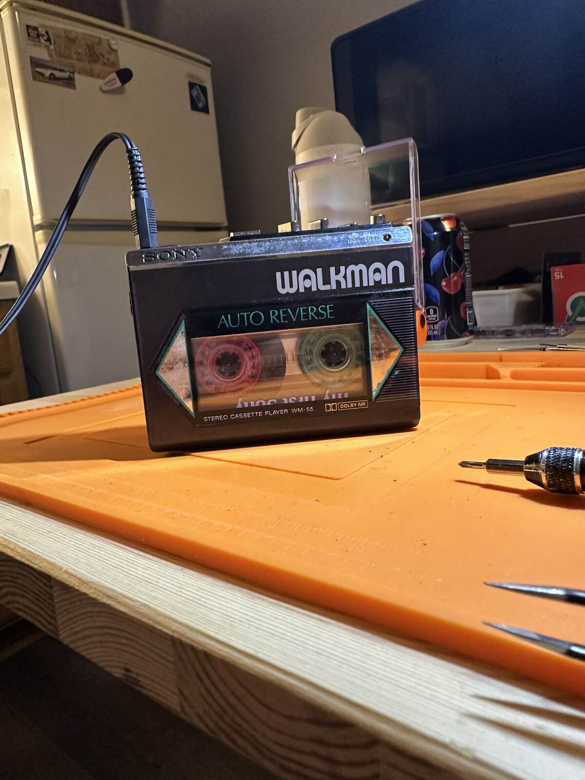

So I'm currently working on a WM-55 which I plan on replacing the rollers in. Currently the A-side roller moves up and down freely on the plastic shaft and creates w & f when rubbing against the top of the assembly. Before I disassemble anything though, I wanted to know if there was a way to tell which direction the pin that holds the roller in place should be removed. I know on some models this doesn't matter, but I've also made the mistake before of removing it the wrong direction and then it never fits securely in again. I didn't see anything mentioned in the service manual about it but I'm more wondering if there's general advice about which way it should come out? Thanks in advance!

I see, thanks for the info! On any machine I replaced the pinch roller on I drove them upwards from the bottom, so it looks like I've been doing it the right way this whole time. Good to know that the small drop of glue method is Valentin approved, I did have to use this once. The WM-55 is up and running incredibly smooth
