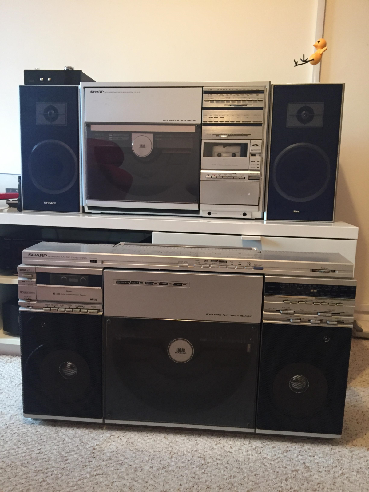

    I love collecting punk reocrds and last year found out about the Sharp linear tracking boom boxes, and knew I wanted one. I managed to get a 2nd hand Vz-3510E for £25 that wasn't working. With a little TLC, new belts and a bloody good clean I got it all running again.
    I now have a VZ-2500 that I want to replace my 3510E with, but I'm having issues with it. I've replaced all the belts but the record player is playing slow on side b at 33 and 45rpm, the a side plays fine at both speeds. I had to adjust the speed to get the a side right as both sides were slow, and now its just the b side and have no idea of how to fix it. (I have limited electrical skills)
    Any help or advise would be appreciated.
