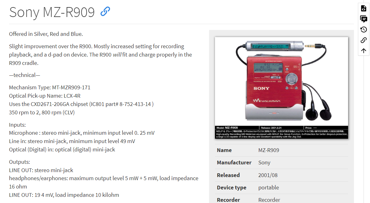

    I just picked up a Sony Mindisc player/record MZ-R909 and want to know what kind of cable do I need to purchase in order to be able to record from my minidisc into my computer? I look at the Line-Out option on my minidisc player and I can't figure out what type of cable will suit. Any help and advice, much appreciated.

    When you want to record from the M-R909 TO another device, use the analog out (headphone jack, 3.5mm) to something else like a 3.5mm or 2xRCA (tulip, red-white usually).
    Recording from another device TO the minidisc device can be done via optical (mini-toslink on the R909) or analog (again 3.5mm on the R909).
    https://www.minidisc.wiki/equipment/sony/portable/mz-r909

    As this is not a NetMD capable device, you simply use a analog cable (3.5mm jack) from the headphone out to your PC's input as described above: most likely it is a female 3.5mm port in your PC.
    It looks like you can set the sound output to headphones output and true line-out.
    For the best quality you might want to try both options; however, using MD devices with my amplifier, I always set them to line-out.
    If I remember correctly, you can only set it to line-out when the 7-pin connector (on the remote) is not inserted.
